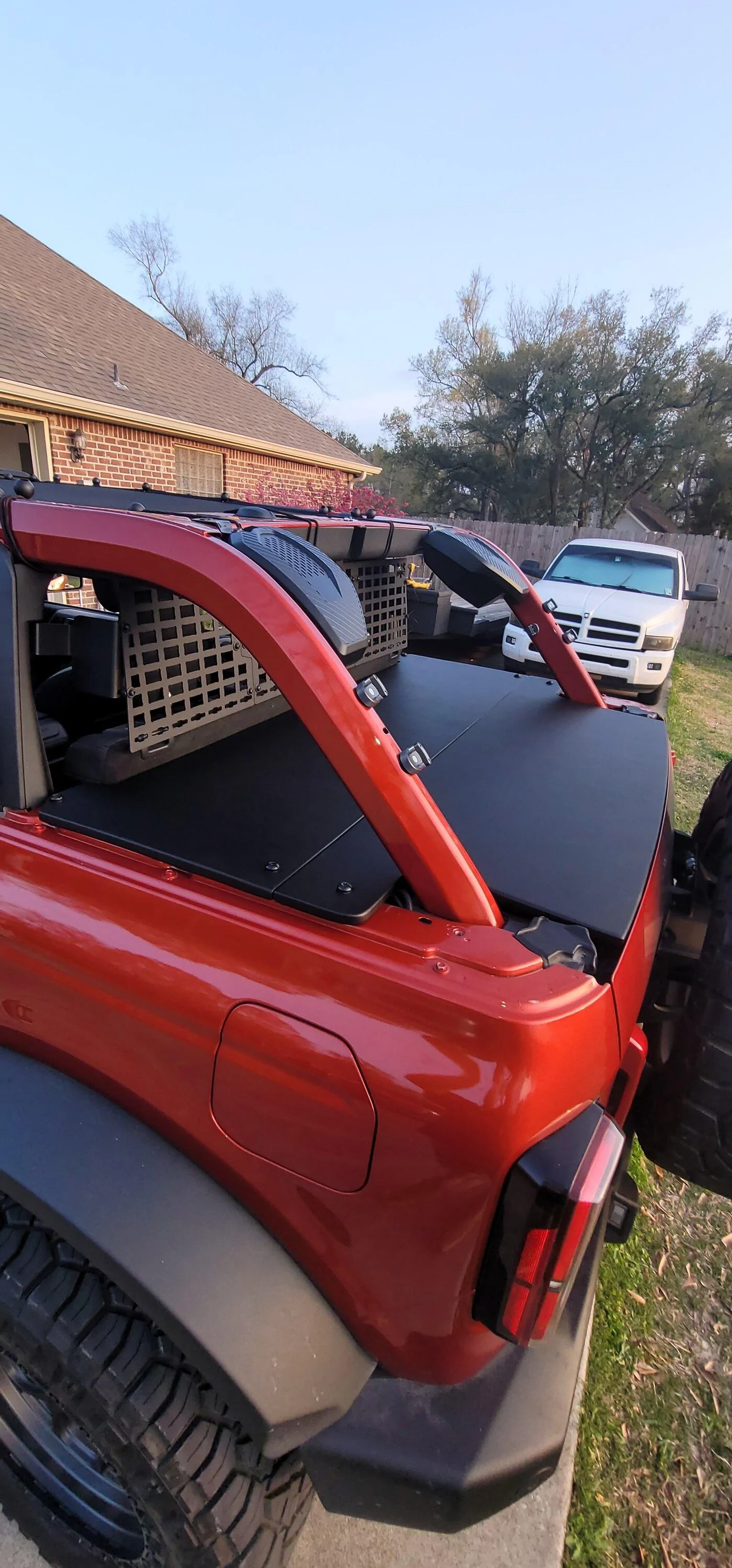

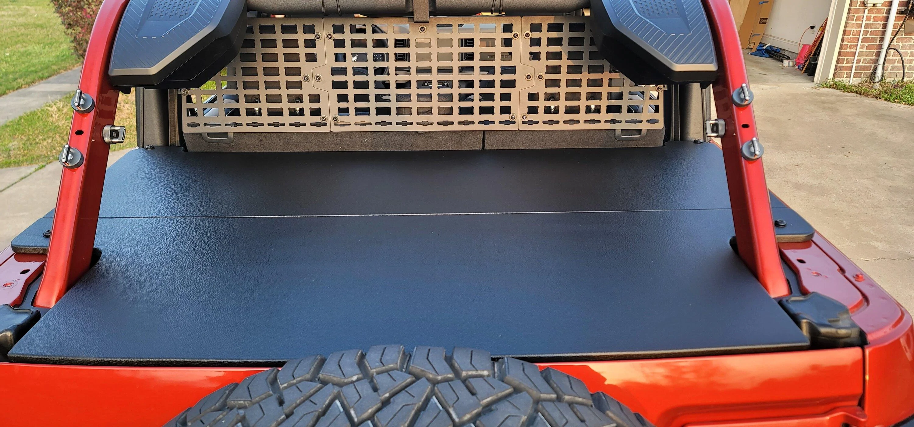

Like others, I have been disappointed in the available options for tonneau covers, so I finally took it upon myself to make my own. It is made of 5/8 plywood, some square aluminum stock on the underside for rigidity, a little body filler, wrapped in black marine grade vinyl, and held in place by the factory hardtop bolts. Hopefully it'll keep things from walking off when I have the top off.

I actually had that thought, but unfortunately the little side wing for the bolts on the rear section hit the roll bar stopping it from folding.

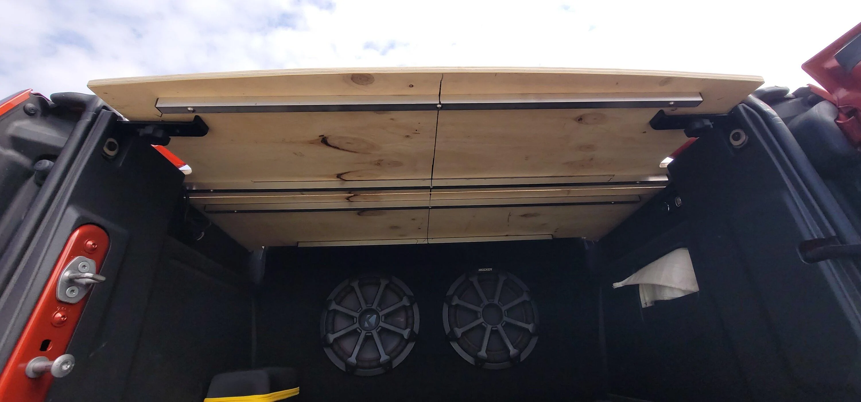

If you cut a new front piece, and include the two bolts on the rear piece, then you can put a hinge where you have the cut now, and be able to lift and secure from underneath. When I made mine, I used the side as a template and ran it all along the side to the tailgate. Then I made a flat top with hinges, secured under so no one can open it unless truck is unlocked. Hard to see in my pics, but it is strong, and secure when the top is on or off. Also made a top so when I have my fridge in, it is also secure when top off......

@CUZICAN what pet barrier / metal window grid is this? Can you still recline the rear seats? I looked at a couple like this, but you could not recline.
I'm pretty sure it is the Broaddict one, I can verify when I get home. My seats are reclined all the way, but I did have to make a small mod to make that happen. I just picked up a couple spacers and a couple longer bolts and installed them in the lower hole, causing the panel to sit at an angle. It's still really close and the panel would rattle against the seat on bumps, so I wedge some padding between the seat recline lever and the panel and all is quiet now.
