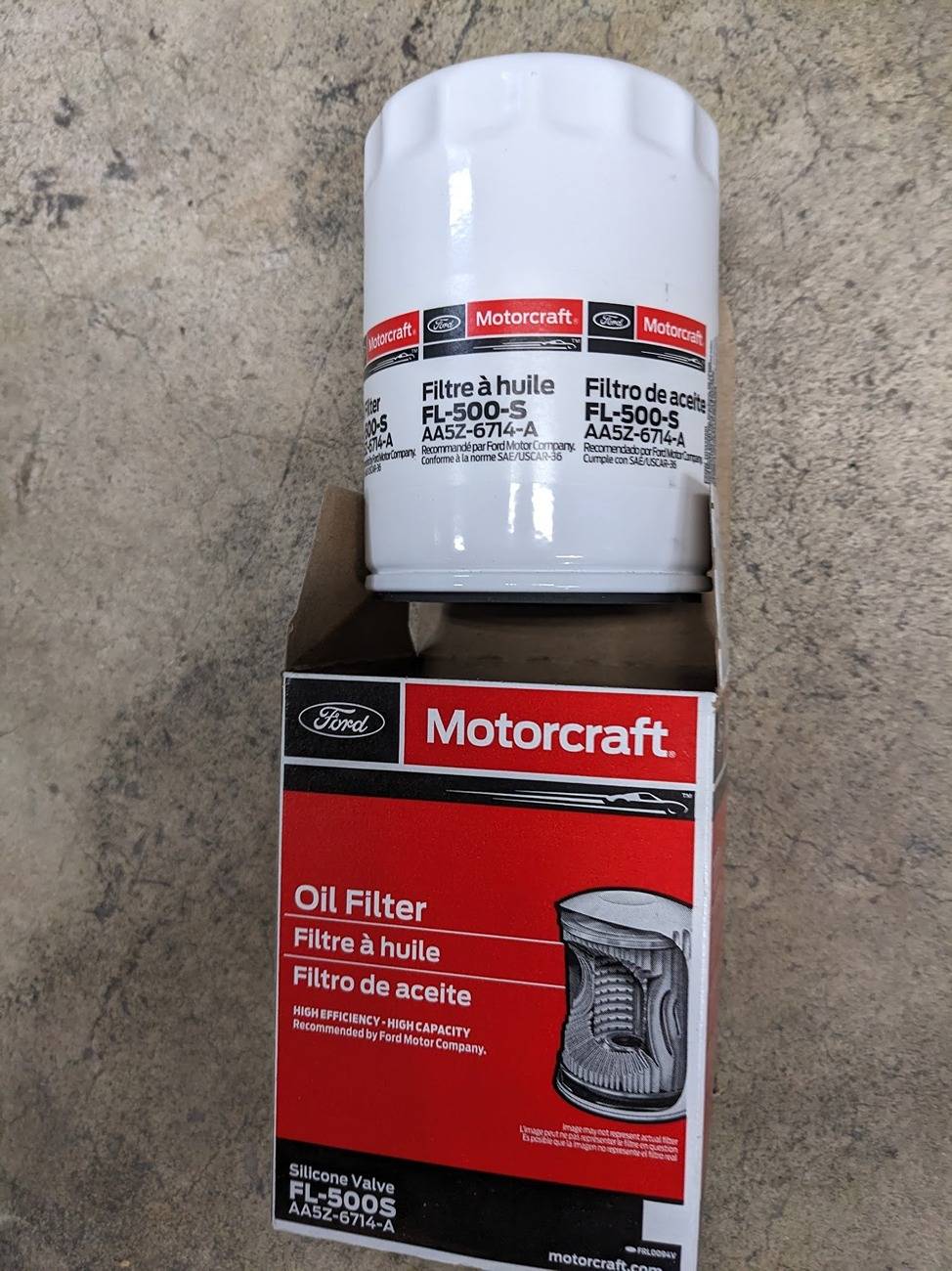

FL-500s does fit
Ford Bronco 2025 2.3 oil filter change from pre-2025 (FL-2127 and FL-500S both fit) PXL_20250620_163645389.MP
The FL2127 oil filter will fit too. It is the same as the fl500 just a bit shorter in length. The FL-500s was on the shelf at my local auto parts place and the FL-2127 would need to be ordered.
