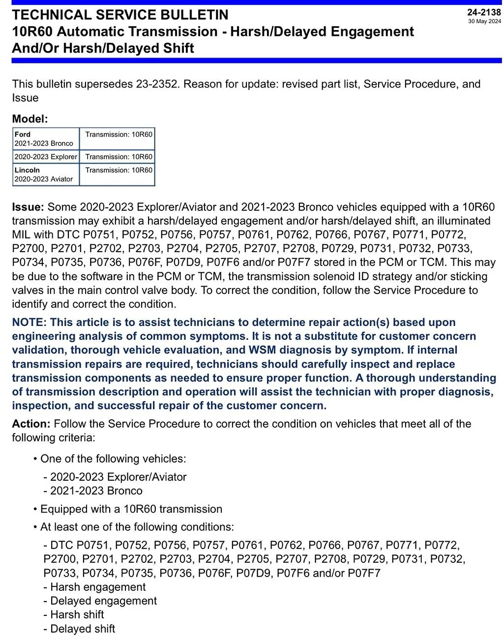

There’s a TSB for various shifting concerns. I’d bring it to your dealer.
Is there somewhere I could look up these TSB's? I have really abrupt 2-3 shifts under normal acceleration and am curious to see if they mention anything like this.
Ducati1098
9,907
22,975
Midwest
Ford Bronco 10AT - 2-3 shifts "issue" IMG_5016
