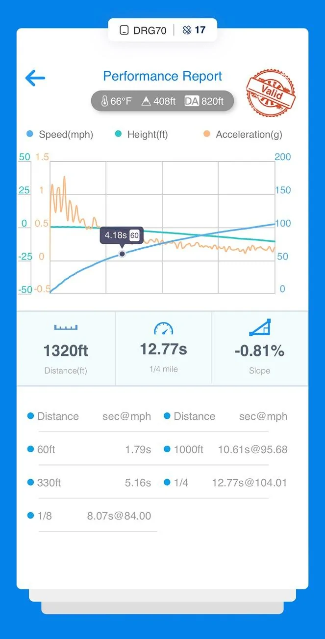

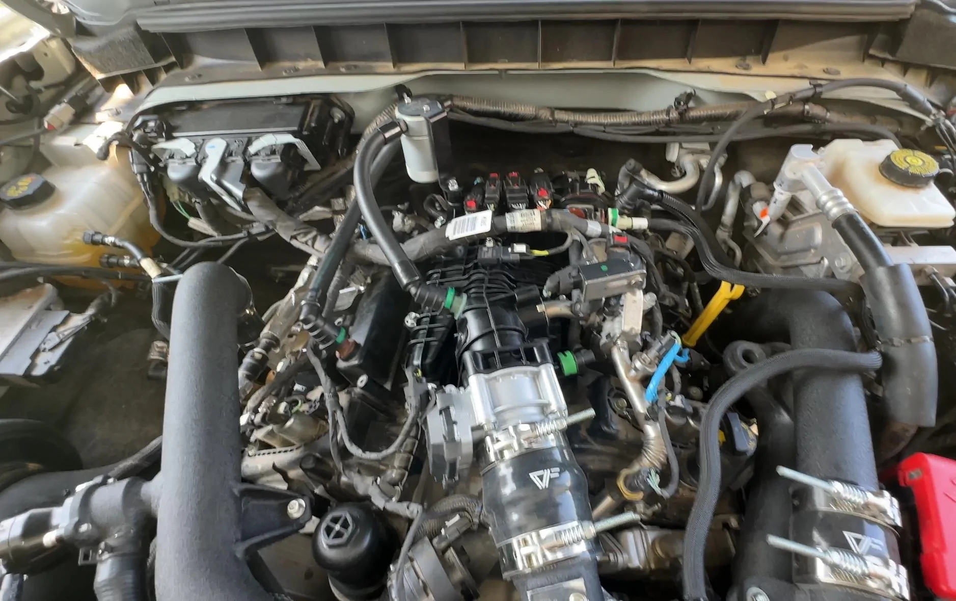

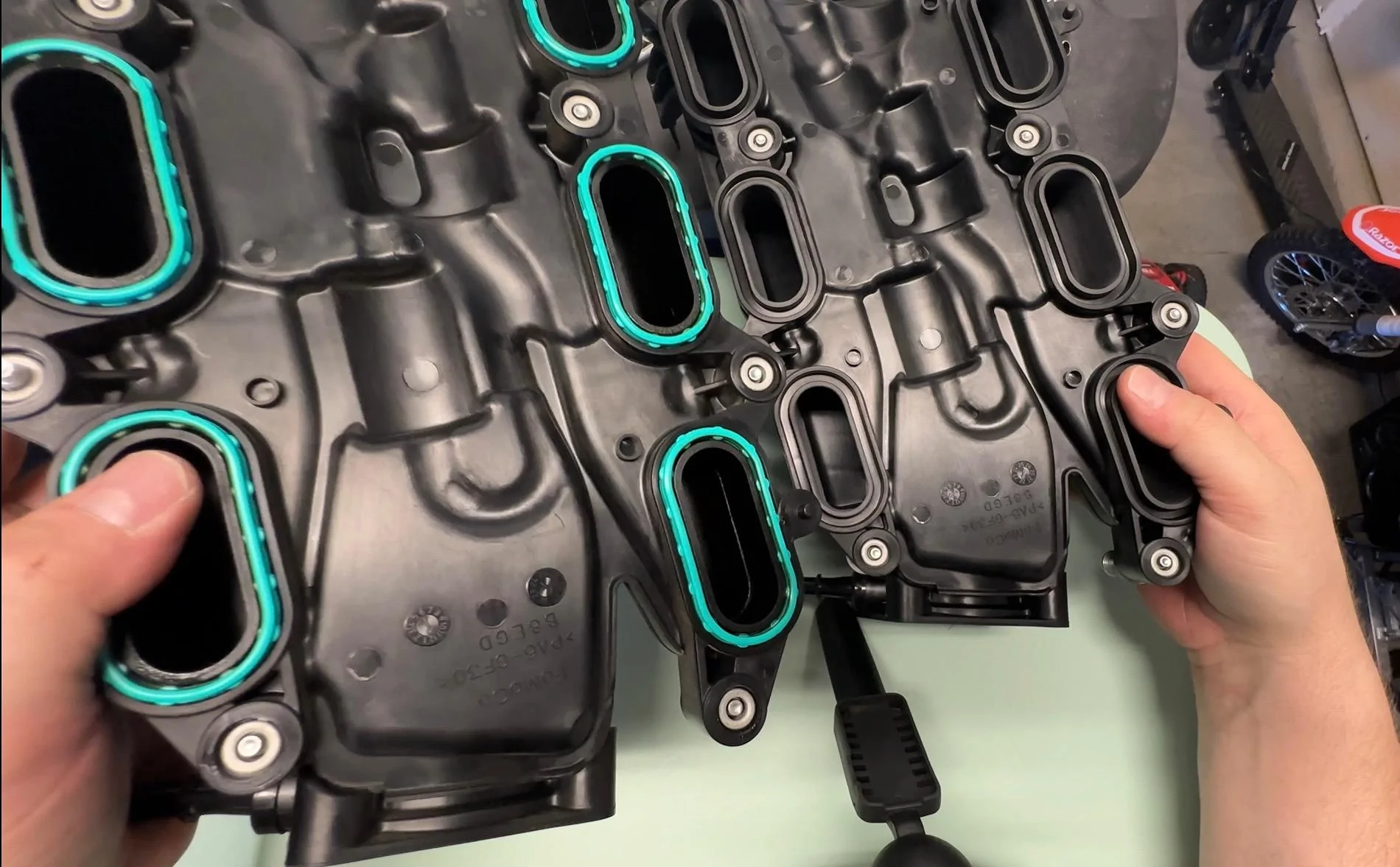

Installed the ported manifold last week and It wasn't that bad thanks to the instructions provided by @Ducati1098
I'm still waiting for my tune to be revised, but it's safe to say the ported combo added some power. It's even noticeable just daily driving. Gets up to speed without straining as much and the bronco just feels lighter. She wants to move :)
I'll do a separate write up on the install and the comparison, but i went from a 12.89 @ 103 MPH to 12.77 @ 104 MPH. Similar temps and DA via the Dragy app. Also, 0-60 in 4.18s :)
