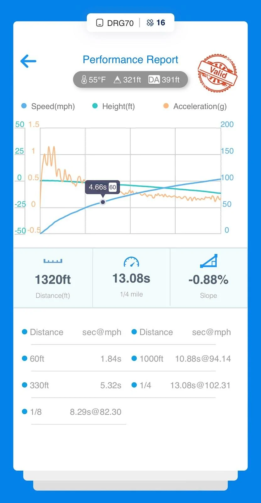

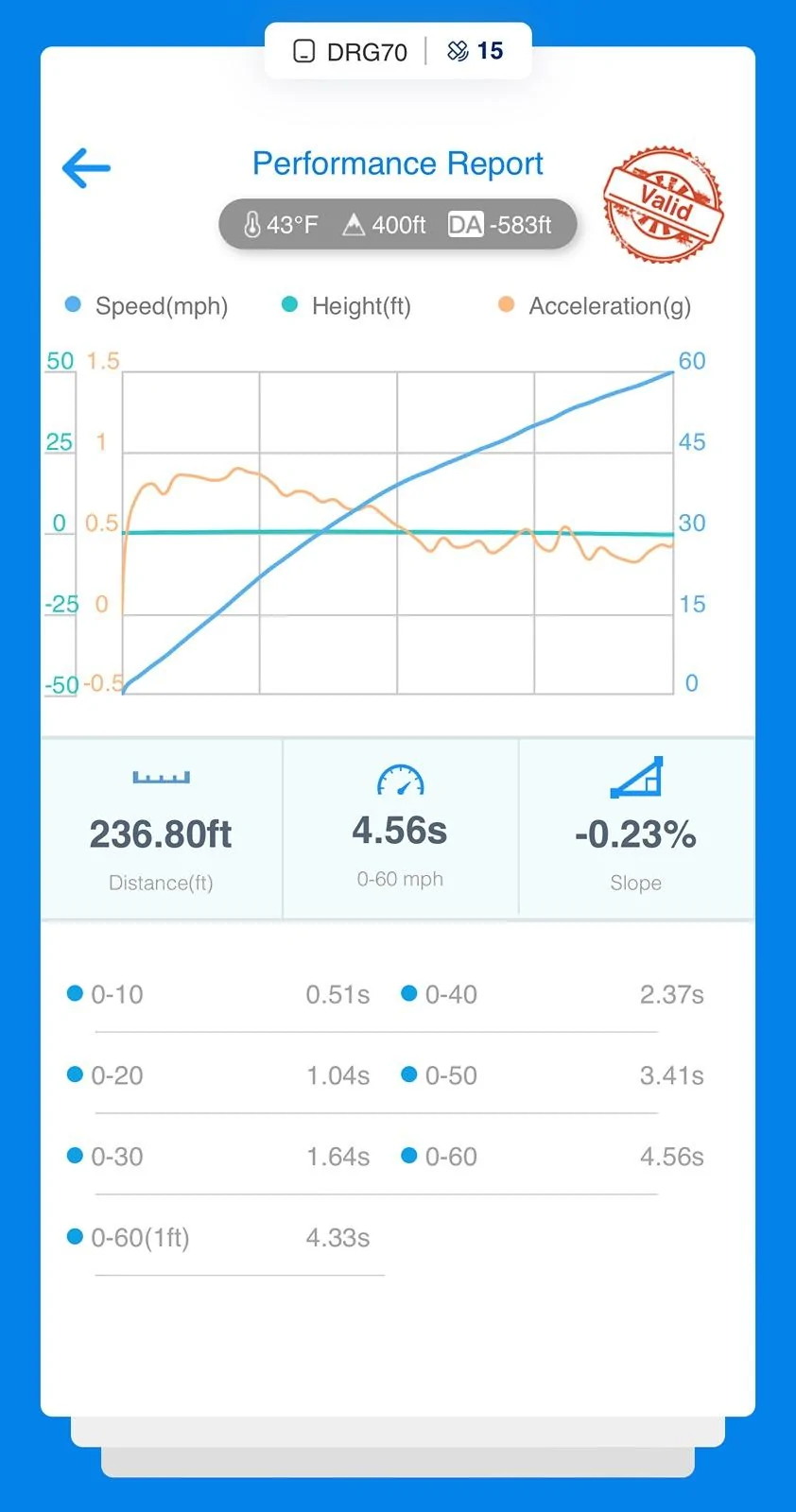

Quick update. Working with Adam at ZFG to get the E85 tune dialed in. We ran into some misfire issues, but hoping we can get them rectified soon. That said, a 12 second Bronco is more realistic than you think. There’s still more room in the E85 tune and she’s already scooting with up 21-22 PSI of consistent boost.
My best 0-60 and 1/4 mile thus far.
