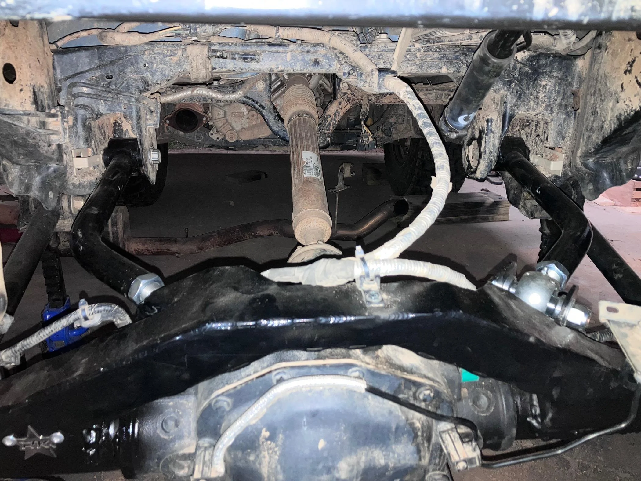

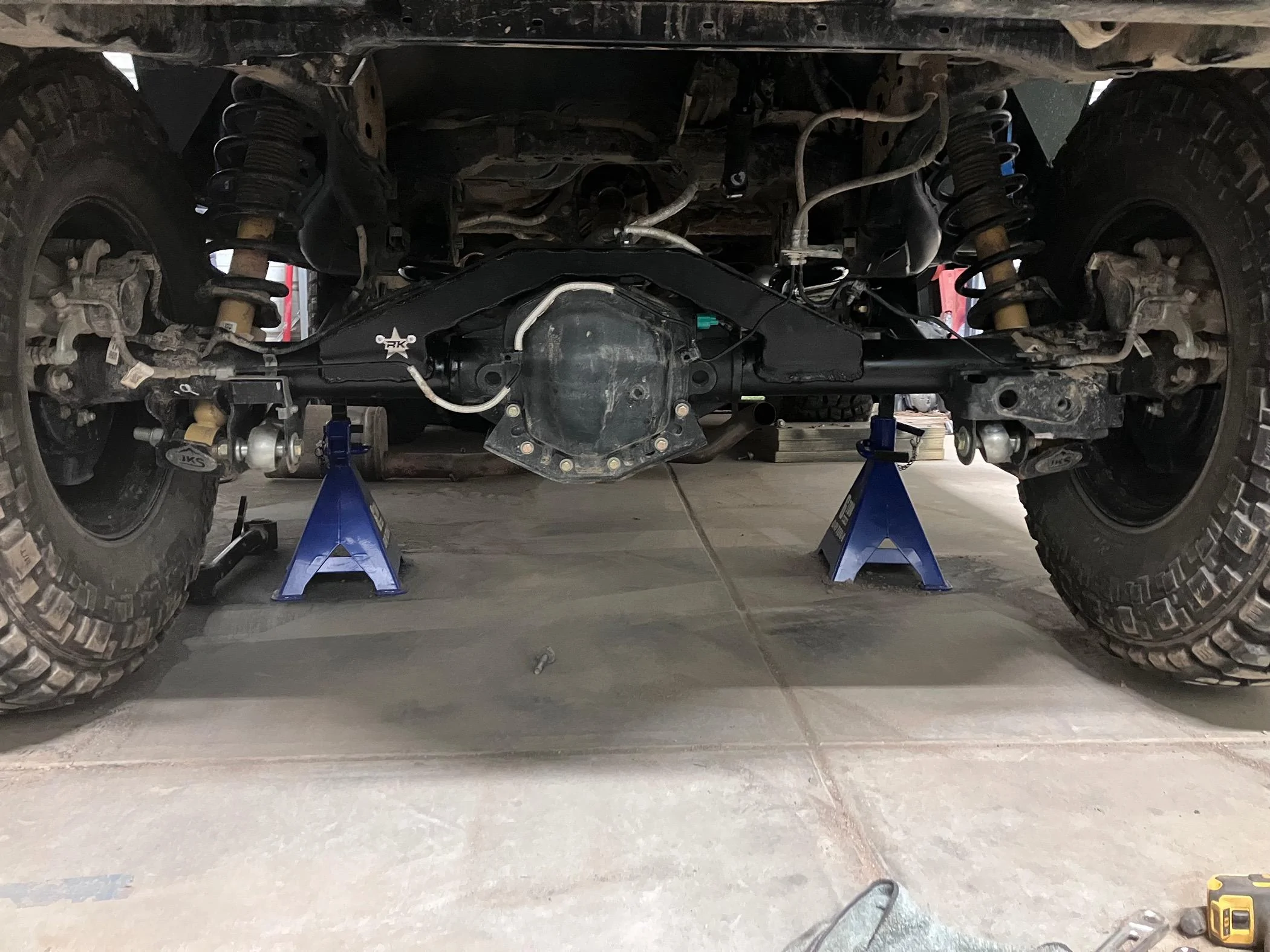

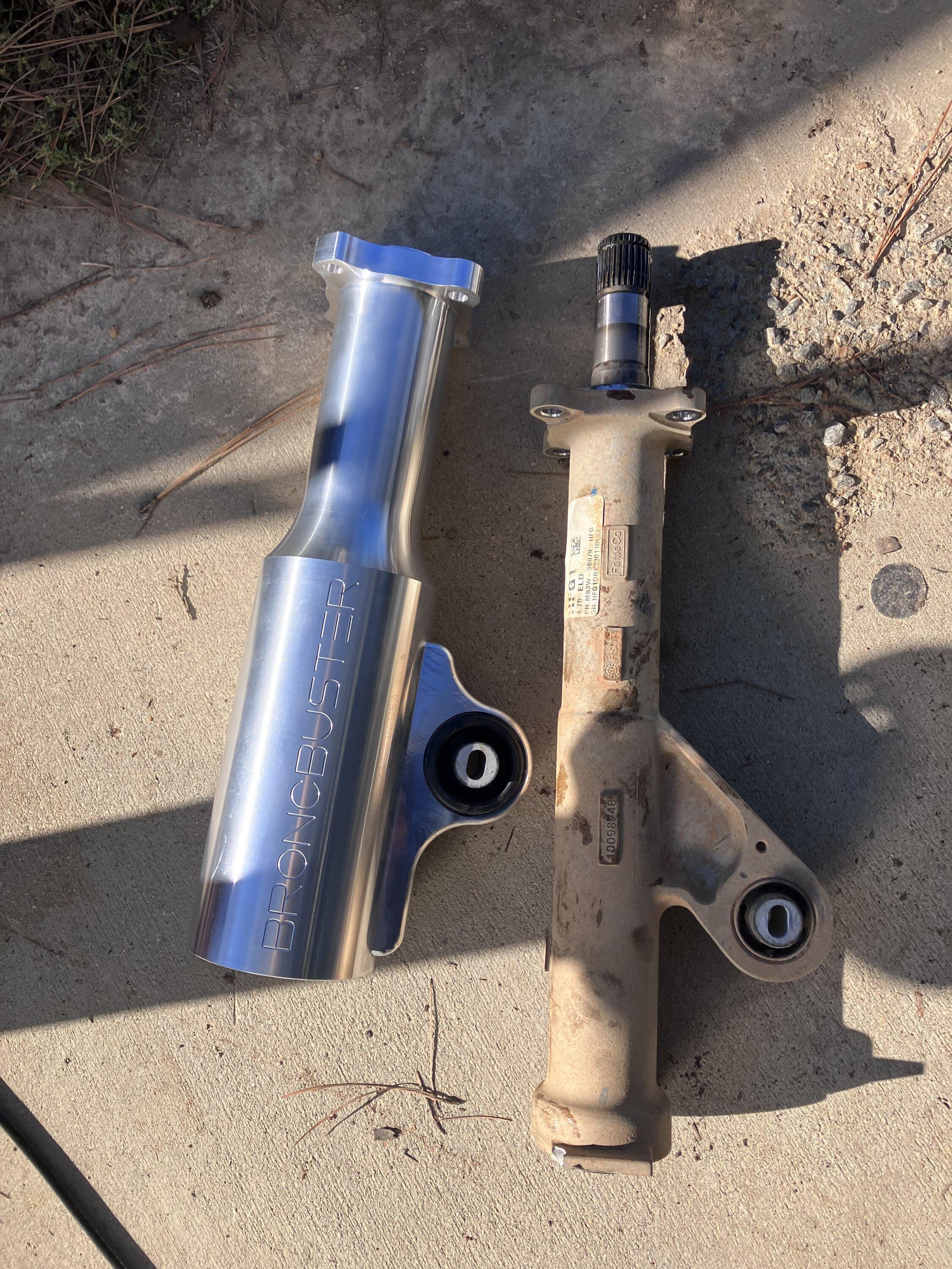

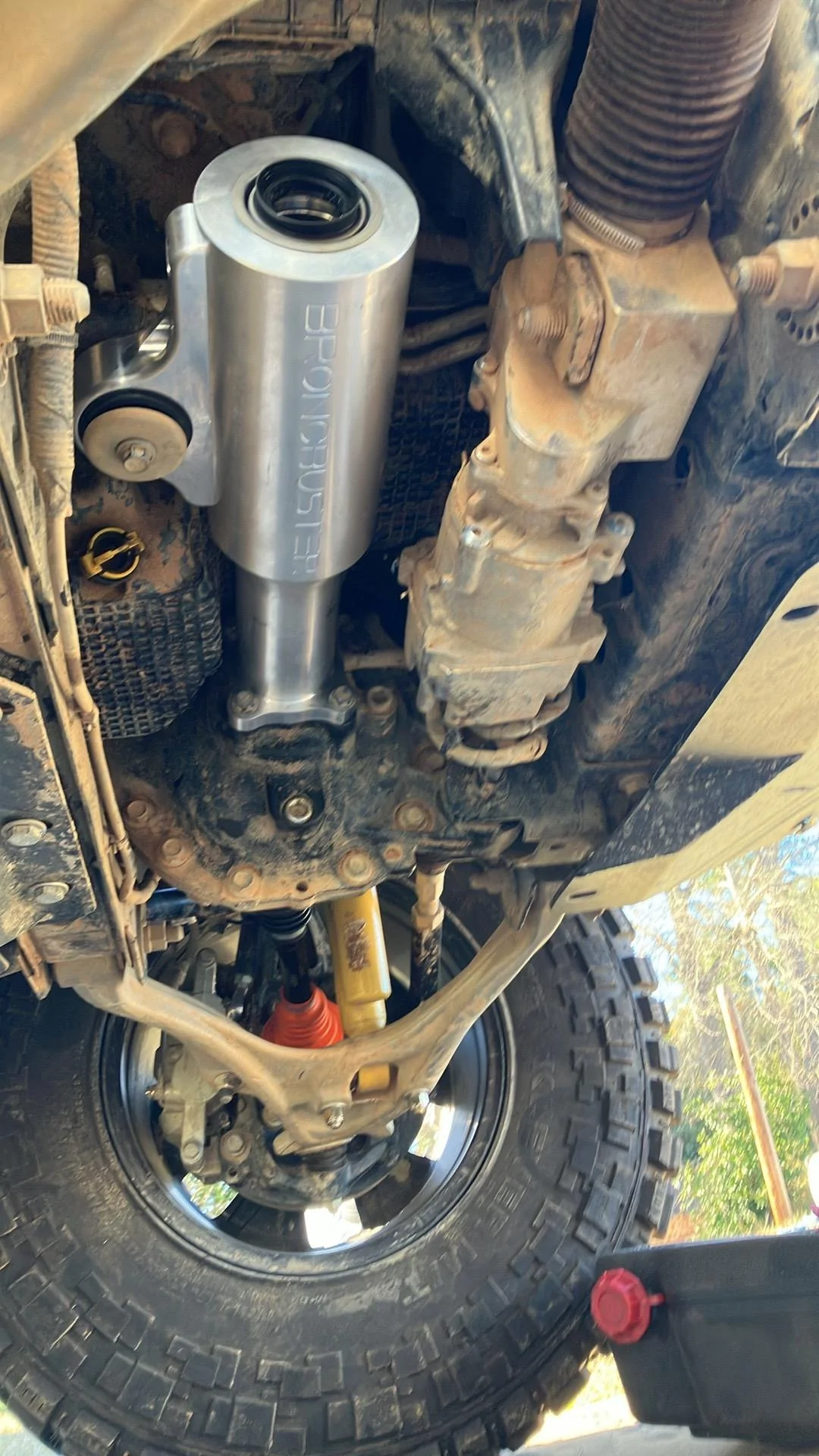

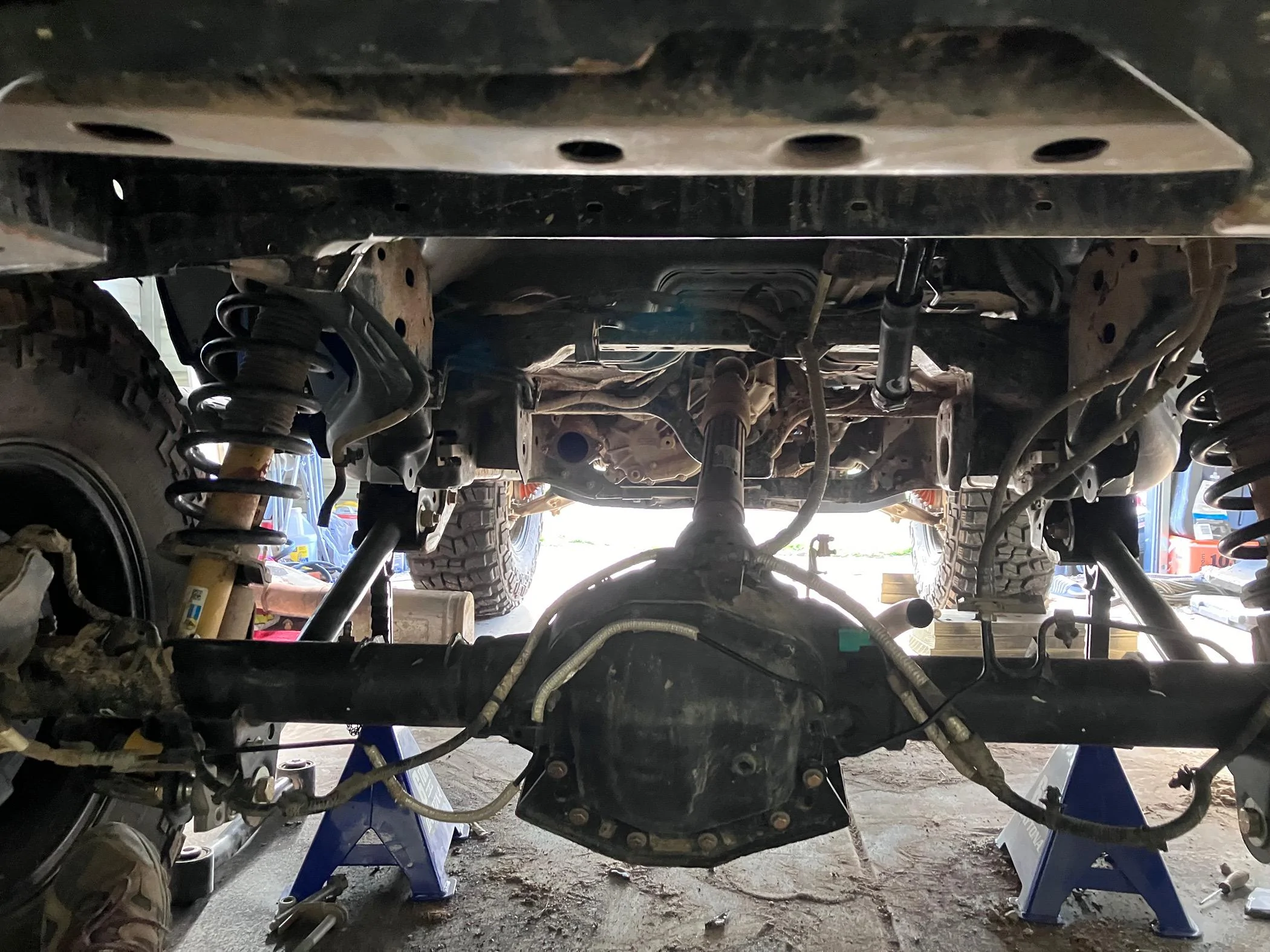

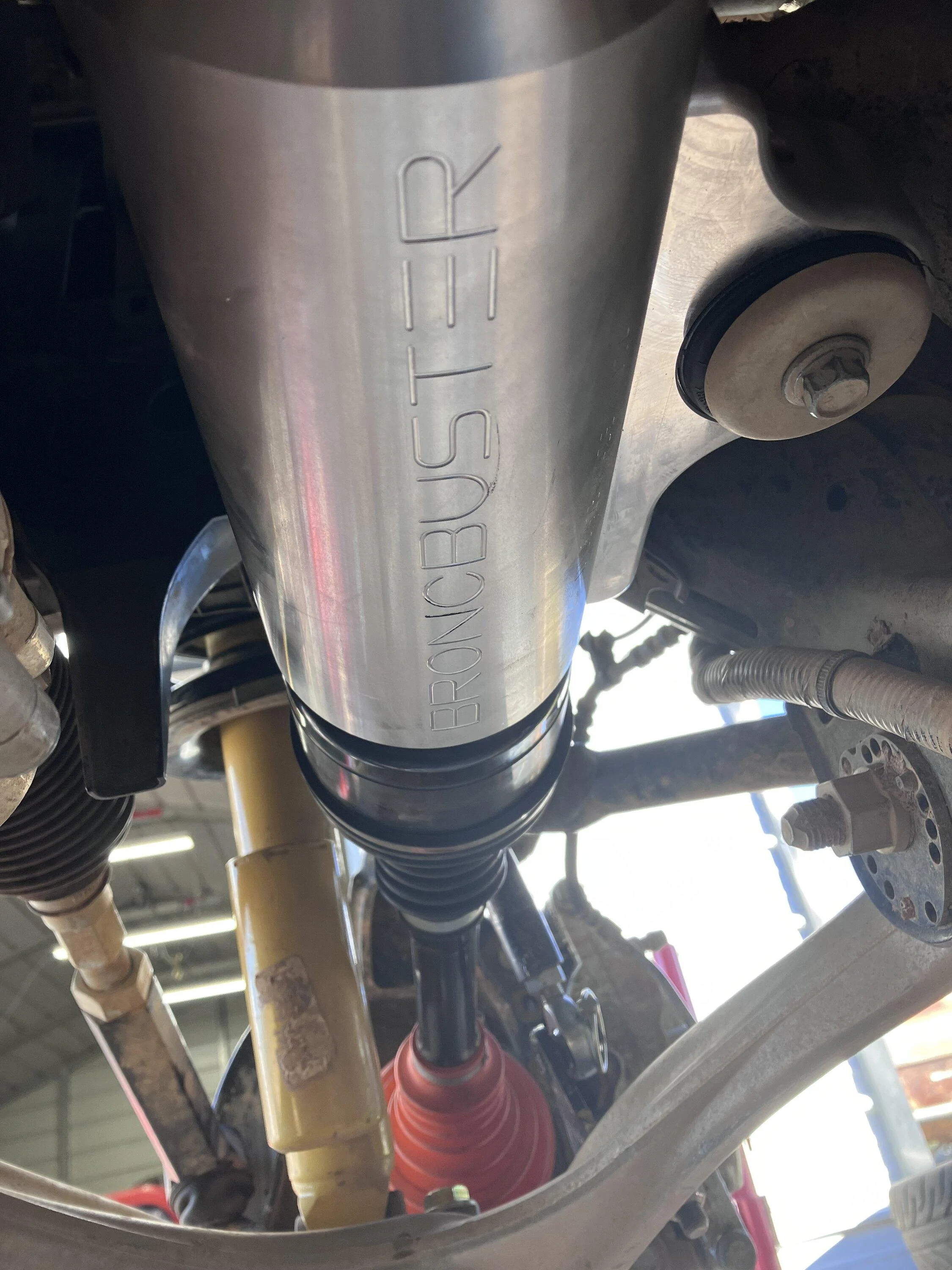

Front end is fortified. Installed the Broncbuster Billet diff tube.
Ford Bronco Wrekt4d Basesquatch build IMG_4814
Ford Bronco Wrekt4d Basesquatch build IMG_4815
Ford Bronco Wrekt4d Basesquatch build IMG_4819

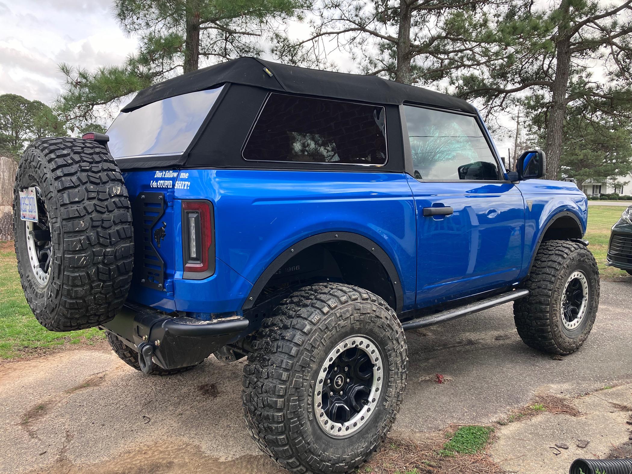

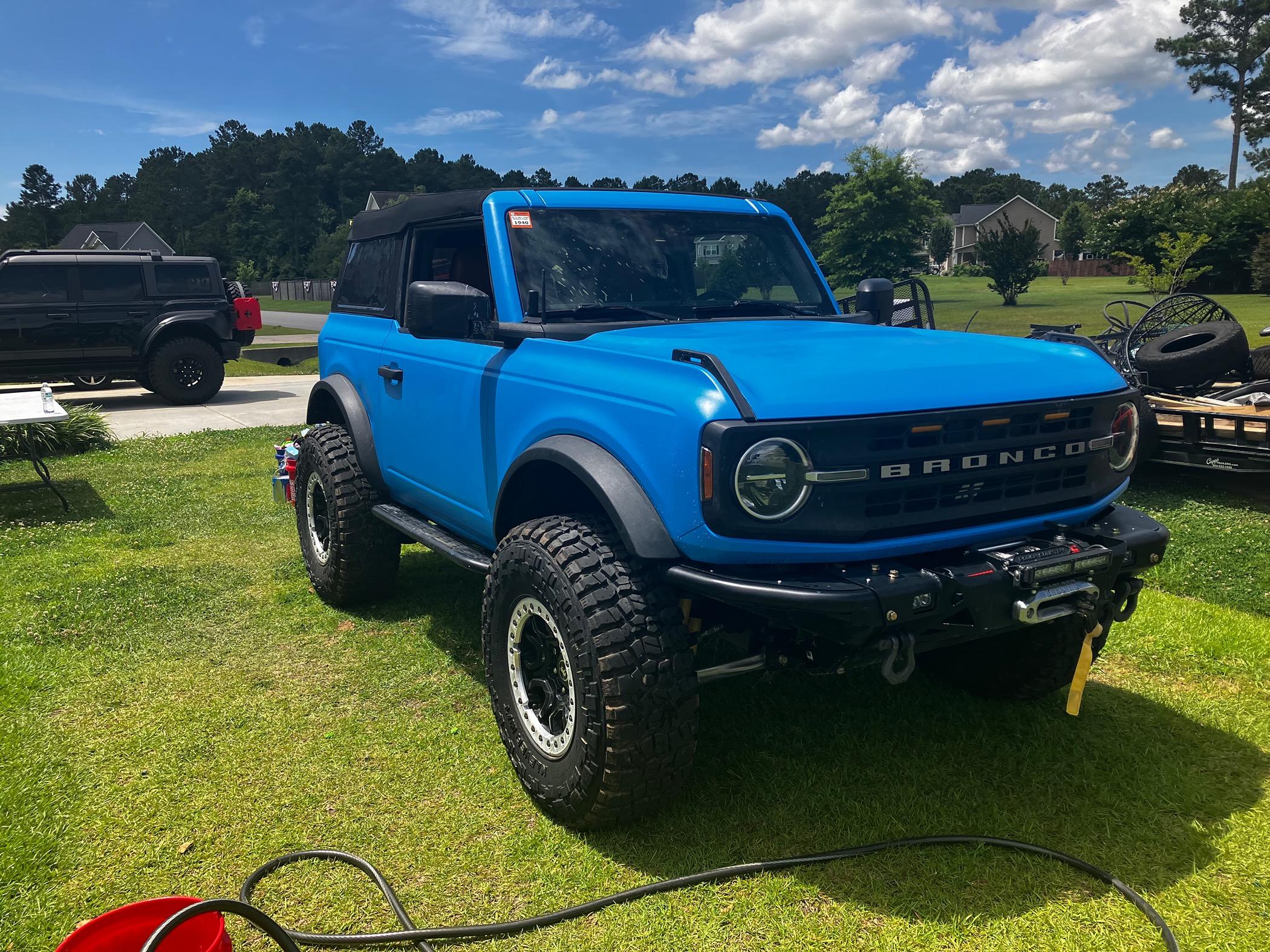

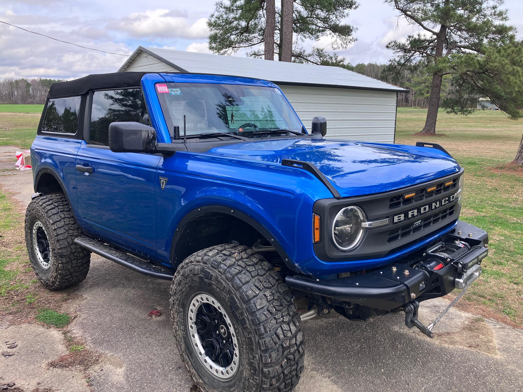

Got around to installing the soft top, test for Spring and Summer.
Ford Bronco Wrekt4d Basesquatch build IMG_5356
Ford Bronco Wrekt4d Basesquatch build IMG_5358
coffeetwitch
Aug 21, 2022
71
46
kansas city
bronco

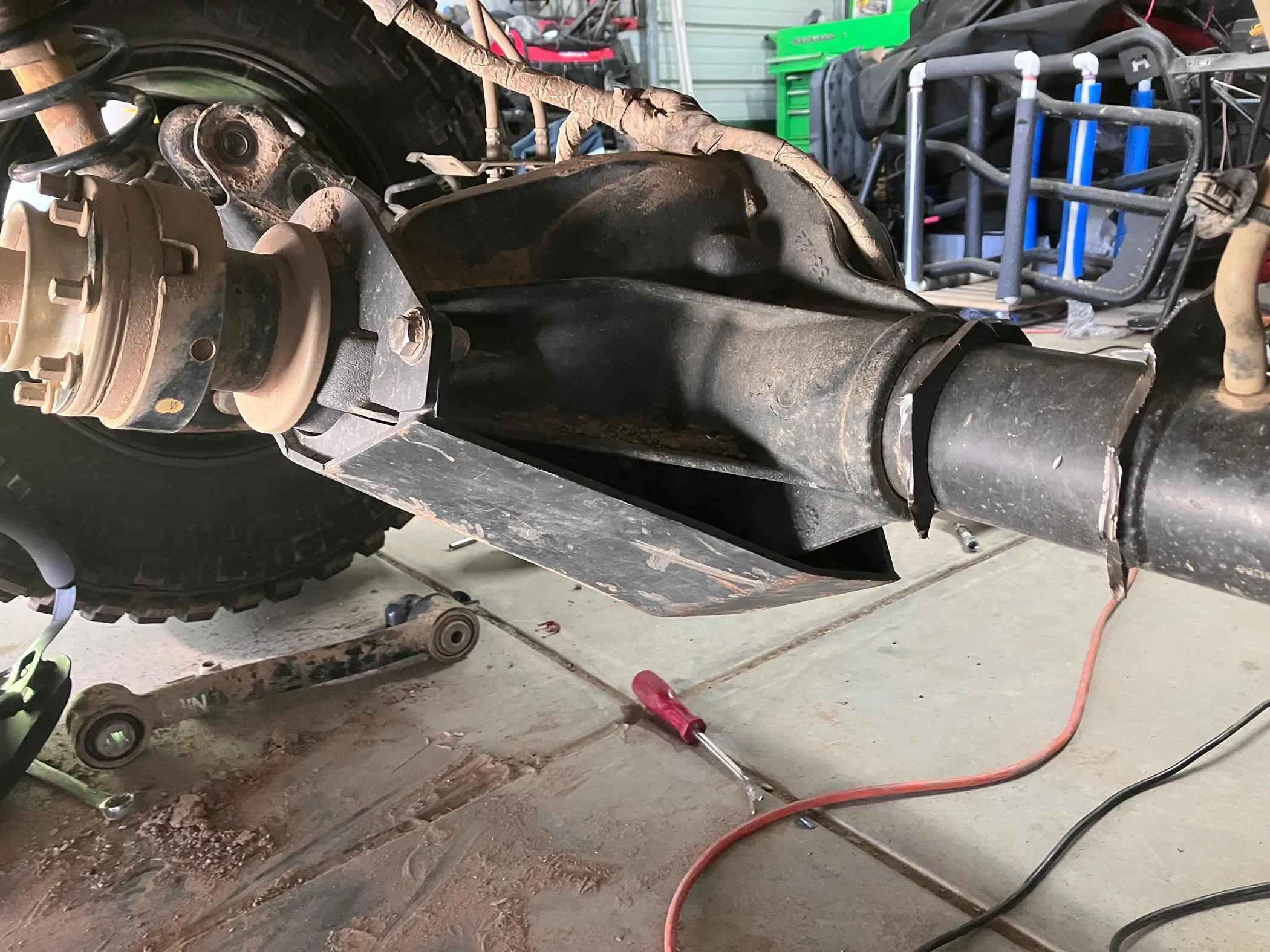

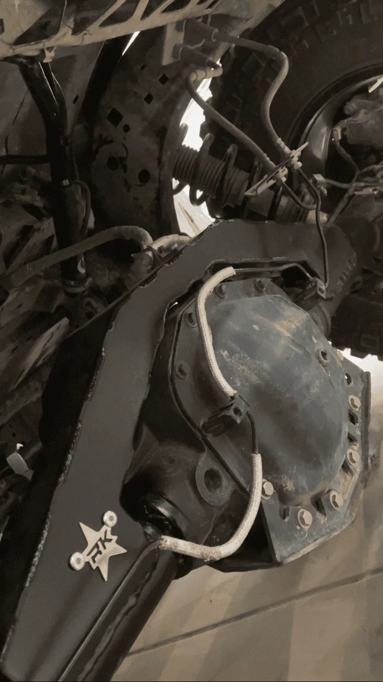

Looks like you also welded your axle tubes to the center section. did you do anything special to make that happen?
mattusmc
mattusmc
Matt
Jul 17, 2020
109
506
2018 Mustang GT PP2
Just prepped the surface and MiG welded just added a few stitch welds, didn’t weld all the way around, the truss should help too

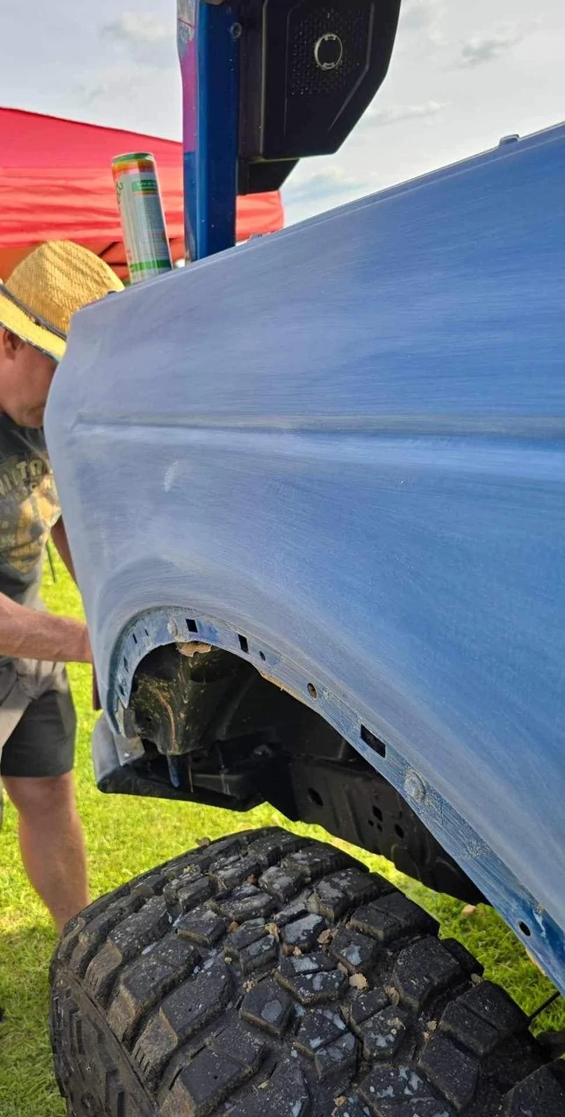

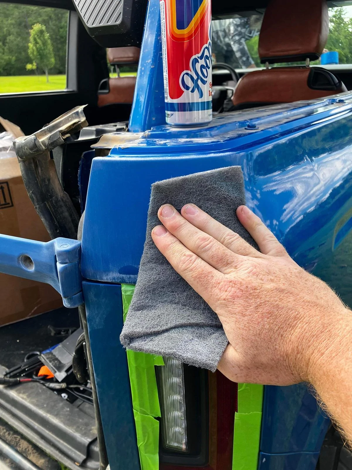

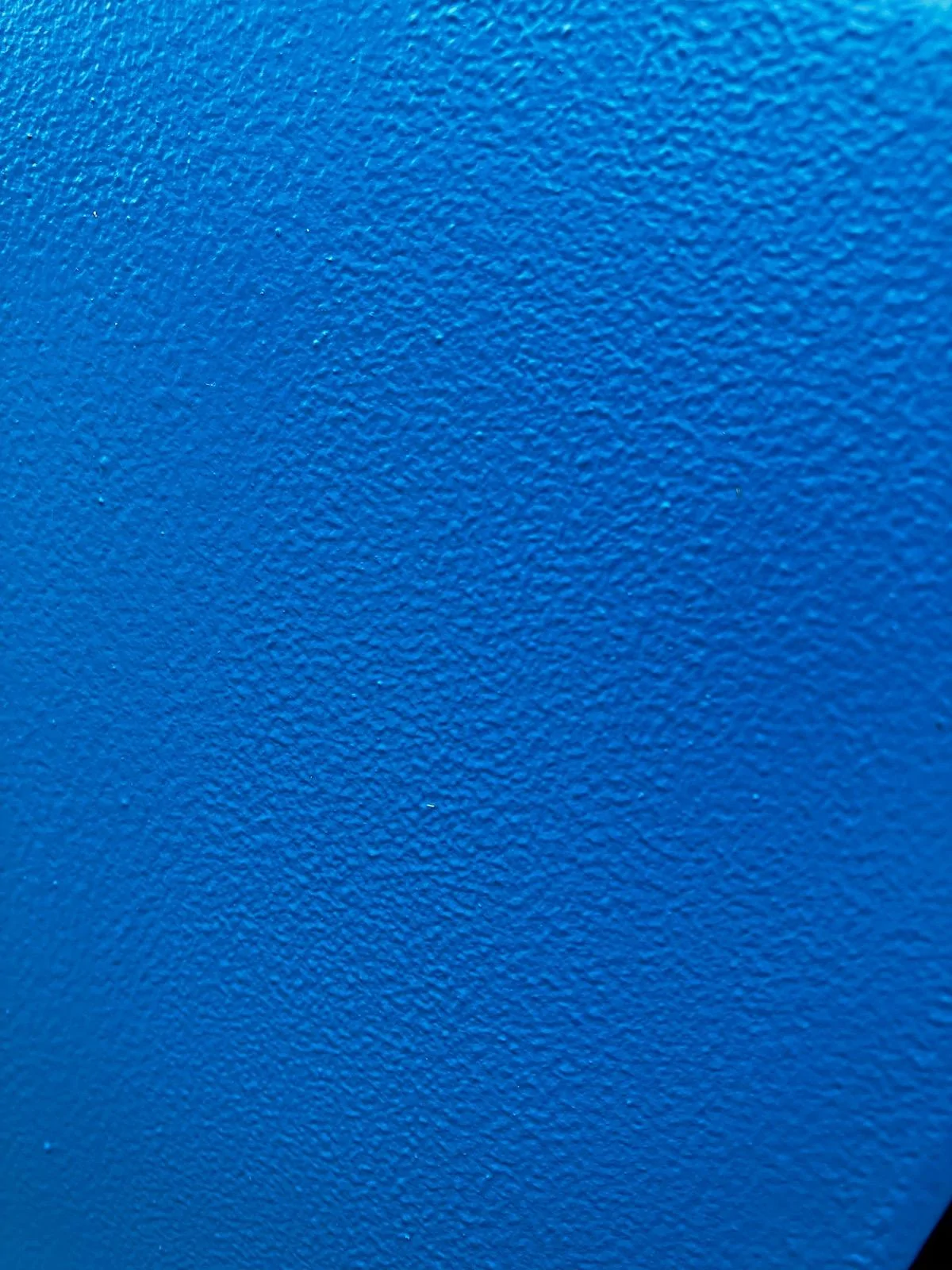

Bedlined the exterior with Monstaliner Grabber blue. It turned out better than I could have hoped for.
Your Bronco is looking awesome! Can't wait to see what else you have in store!
BAUS67
redneck
Jan 3, 2020
5,450
17,301
Central PA
Looks Great!!!!! No need to worry about pinstripes anymore. :wink:

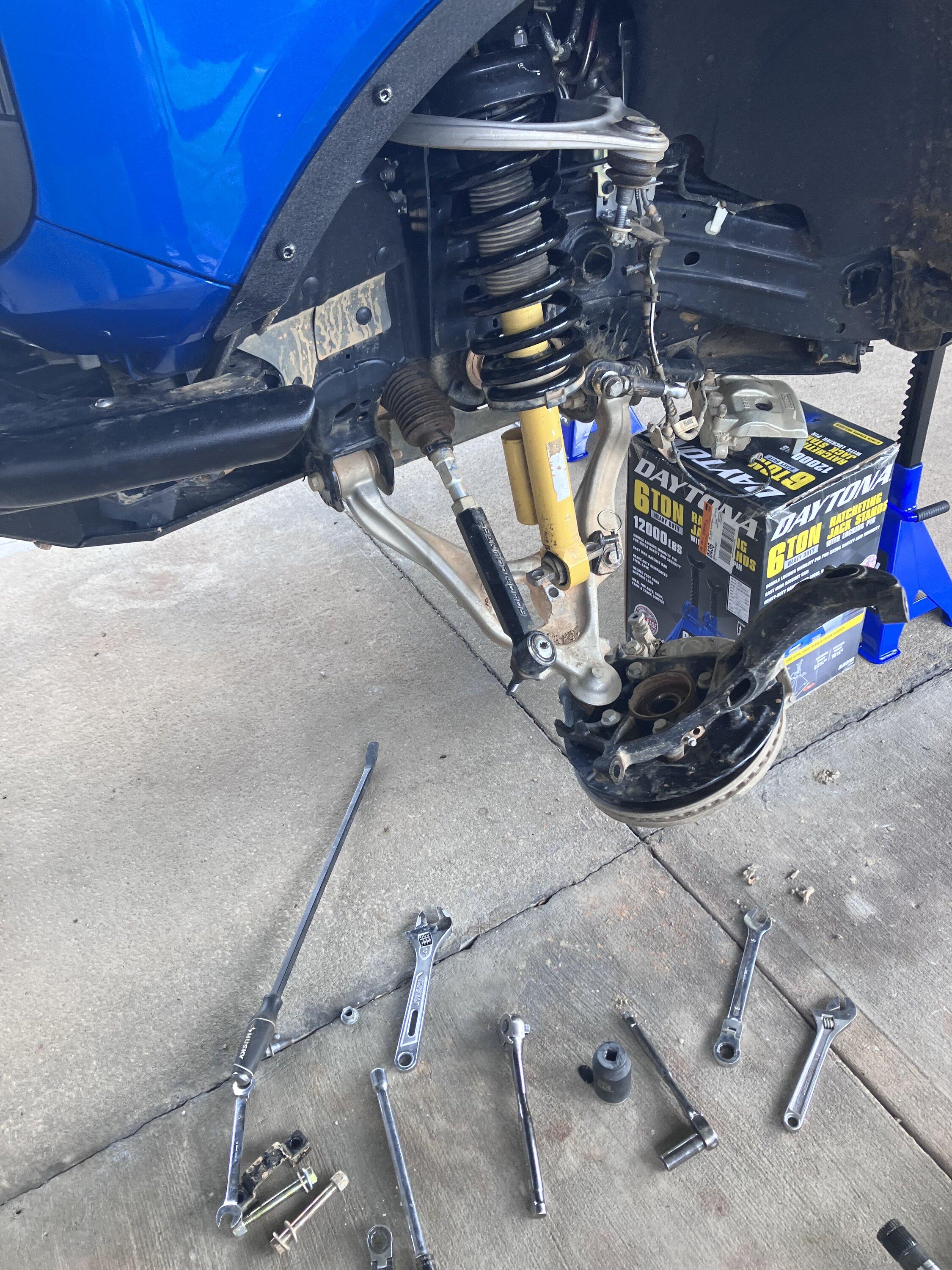

Got the prototype JRIshocks coilovers on today! Initial impressions….I’m in love. 😍 at setting 3 they are perfect for on-road use. I’ll be testing the other settings this weekend at Windrock.

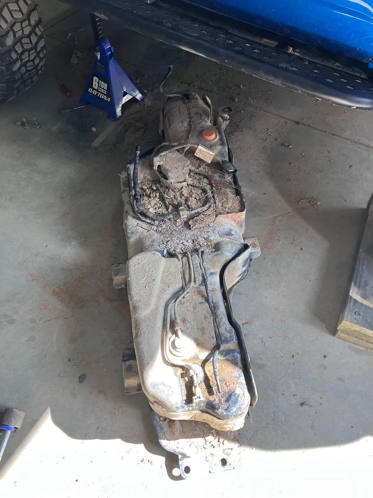

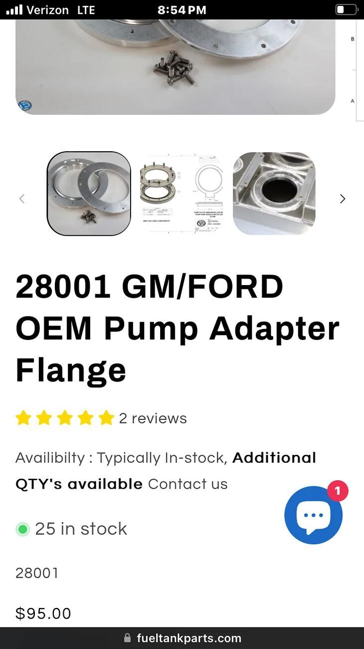

Going to start working on the next big project earlier than I thought. Switching to a fuel cell and relocating to the rear. Found all the pieces needed to relocate it just need to start ordering and get it done. Starting with the pump flange and tank.
Ford Bronco Wrekt4d Basesquatch build IMG_6589

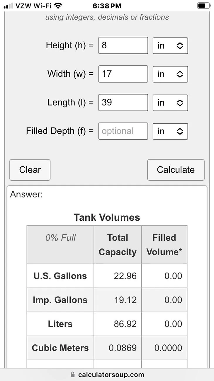

Found an “off the shelf” tank that should fit, same capacity as stock. Still going to make a template to be sure, but I think this is what I’ll be using.
