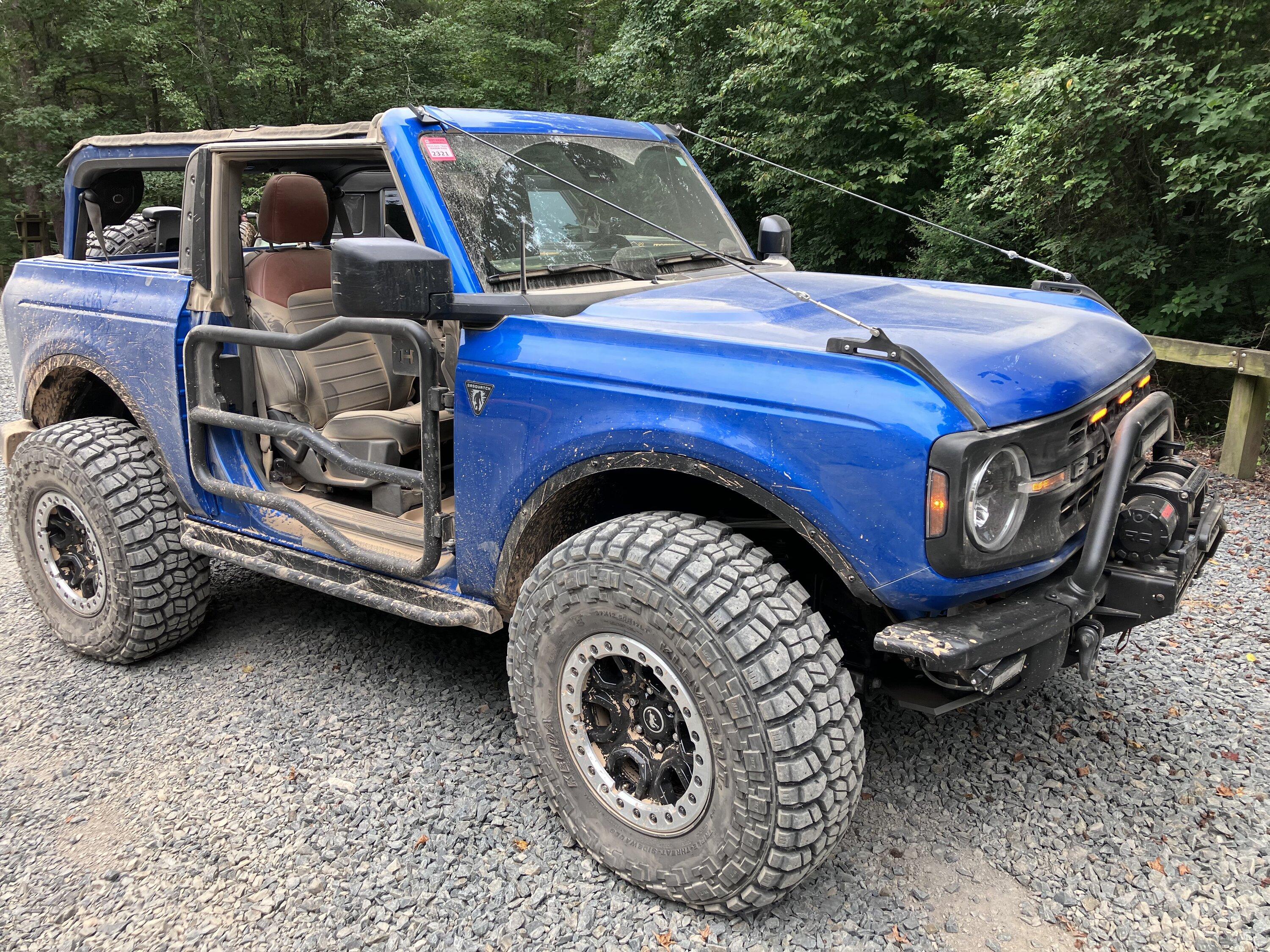

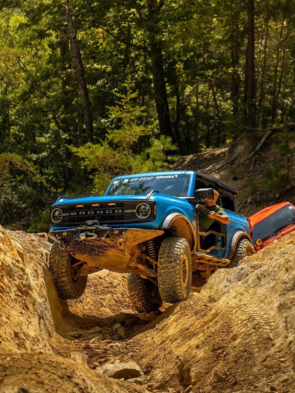

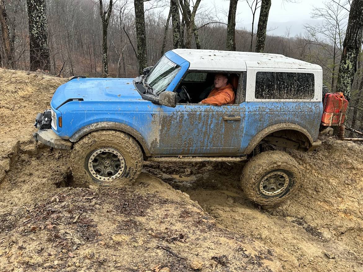

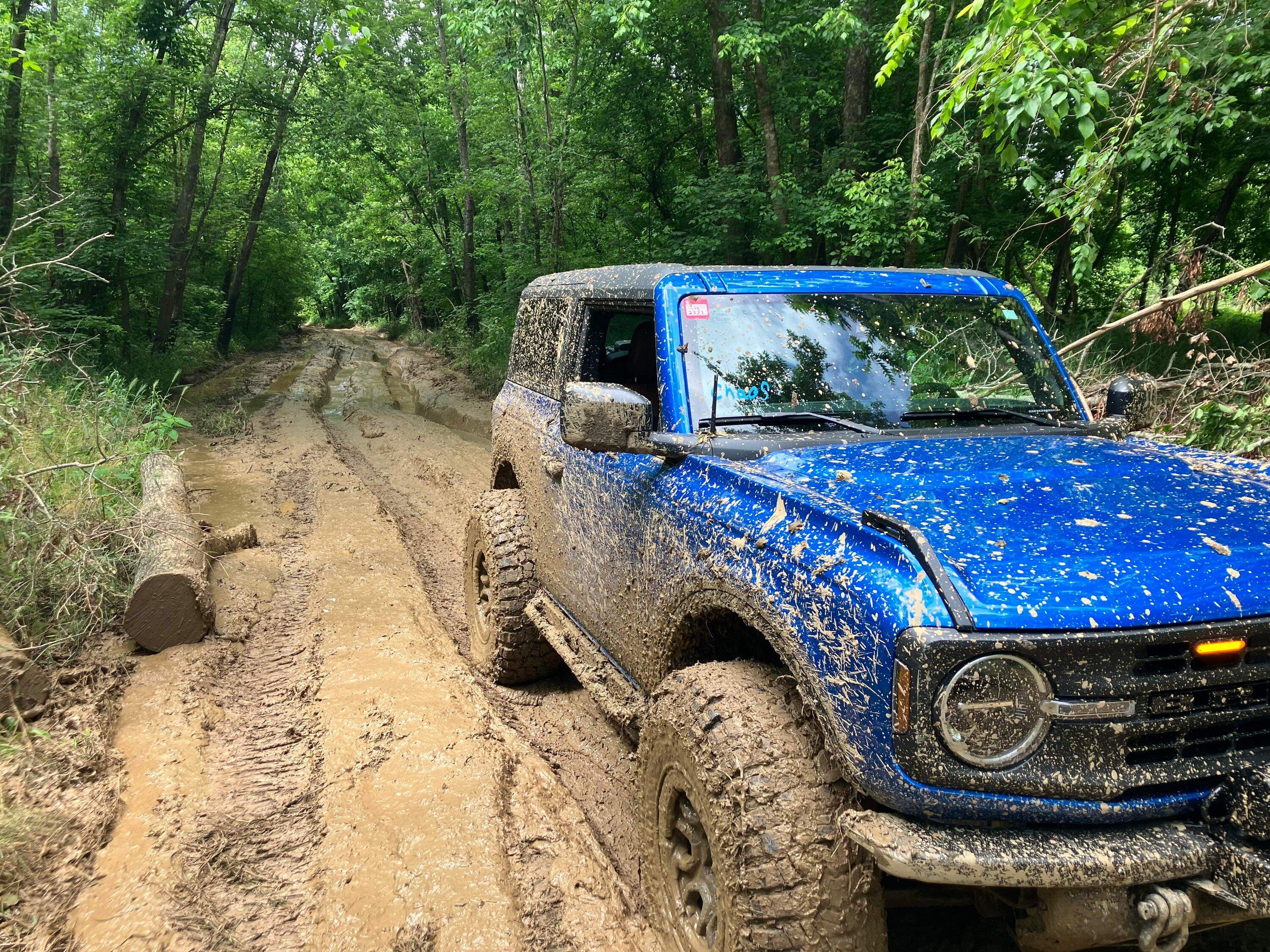

Picked up this beauty back in February. Wasted no time getting it dirty and testing out the capabilities. Decided since day one that it was going to be a “trail truck”. Been busy adding and testing different combos.
Updated***Build list so far:
-ARB diff skid
-LOD Transmission Skid
-LOD transfer case skid
-Metalcloak front bumper
-Metalcloak rear bumper
-JKS shock skids
-Hooke Road diff skid
-Hooke road metal fender liners
-Rough Country 12k lb winch
-Removed the rear seats and Herculined the floor
-M2M molle panel for the GMRS radio
-RC tailgate support
-Oracle flush taillights
-Diode Dynamics stage series light bars
-Diode Dynamics SS2 pods
-Lux magnetic Led rock lights
-AFE Apollo Gt hi tuck exhaust
-K&N drop in filter
-Mishimoto Hi-mount intercooler
-Hooke road fender deletes
-Mabett “raptor” grille lights
-Dobinson HD front springs
-1/2” Mikellis Body lift
-Relocated rear shock mount position
(+2”)
-37 x12.50r17 Kenda Klever MT2
-Ford Performance beadlocks
- Havoc offroad tube doors
- Mabett Seat covers
- Mabett 6.5” rear speaker pods
-Polk audio marine grade 6.5 speakers
-Polk audio marine grade 4” speakers
-6.75” kicker kick panel speakers
-mbquart 8” sub with ford fusion amp
- XOFab DIY rock sliders
-AC Fab sway bar disconnects
-AC Fab trailing arm skids
-Broncbuster Ultimate Hoss 3.0 rack
-RC HD tie rods
-RCV axles
-Broncbuster billet diff tube
-RockKrawler Pro4x truss and 4 link
-Bestop twill trek top
-Grabber Blue Monstaliner
-Revolution Gear 5.38s
-Ford performance diff cover
-Ford performance procal tune
-JRIshocks Stage 2 coilovers
-RockKrawler UCA
-Rigid Chase light/third brake light
Coming soon
-38s or 39s haven’t decided yet

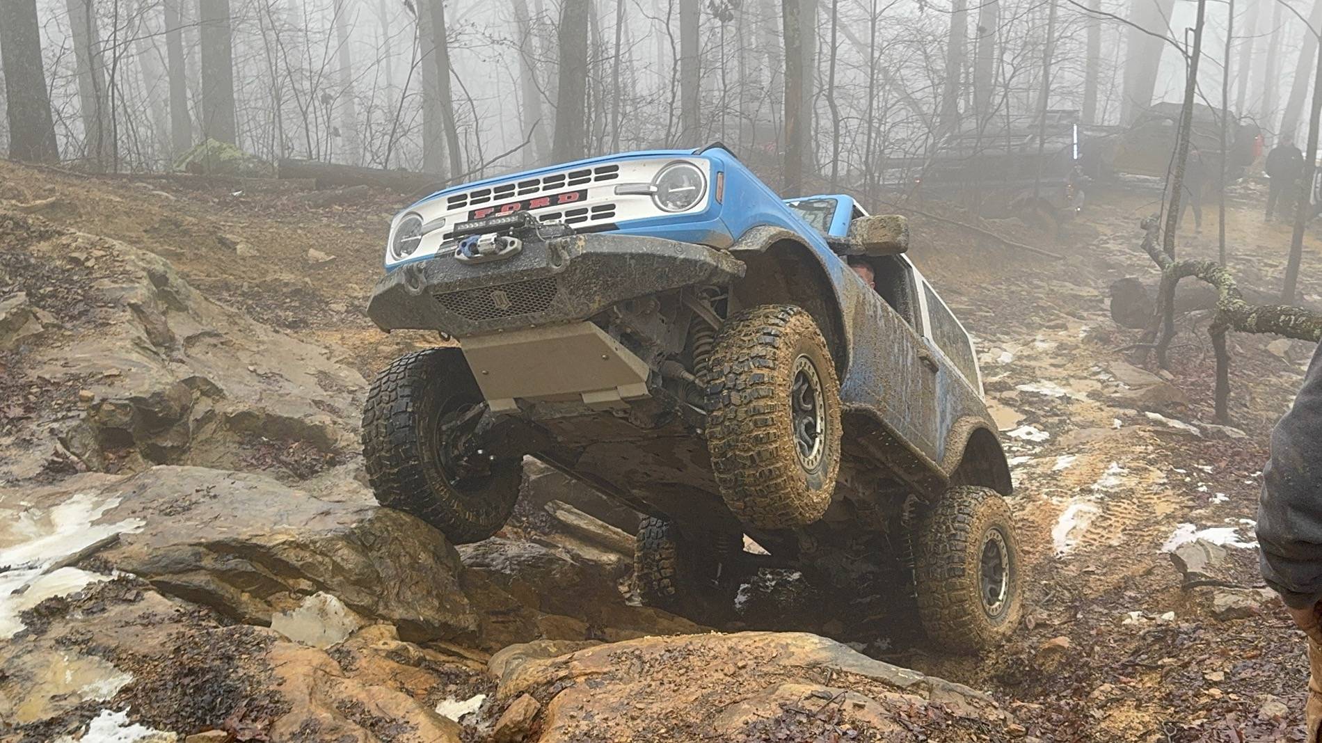

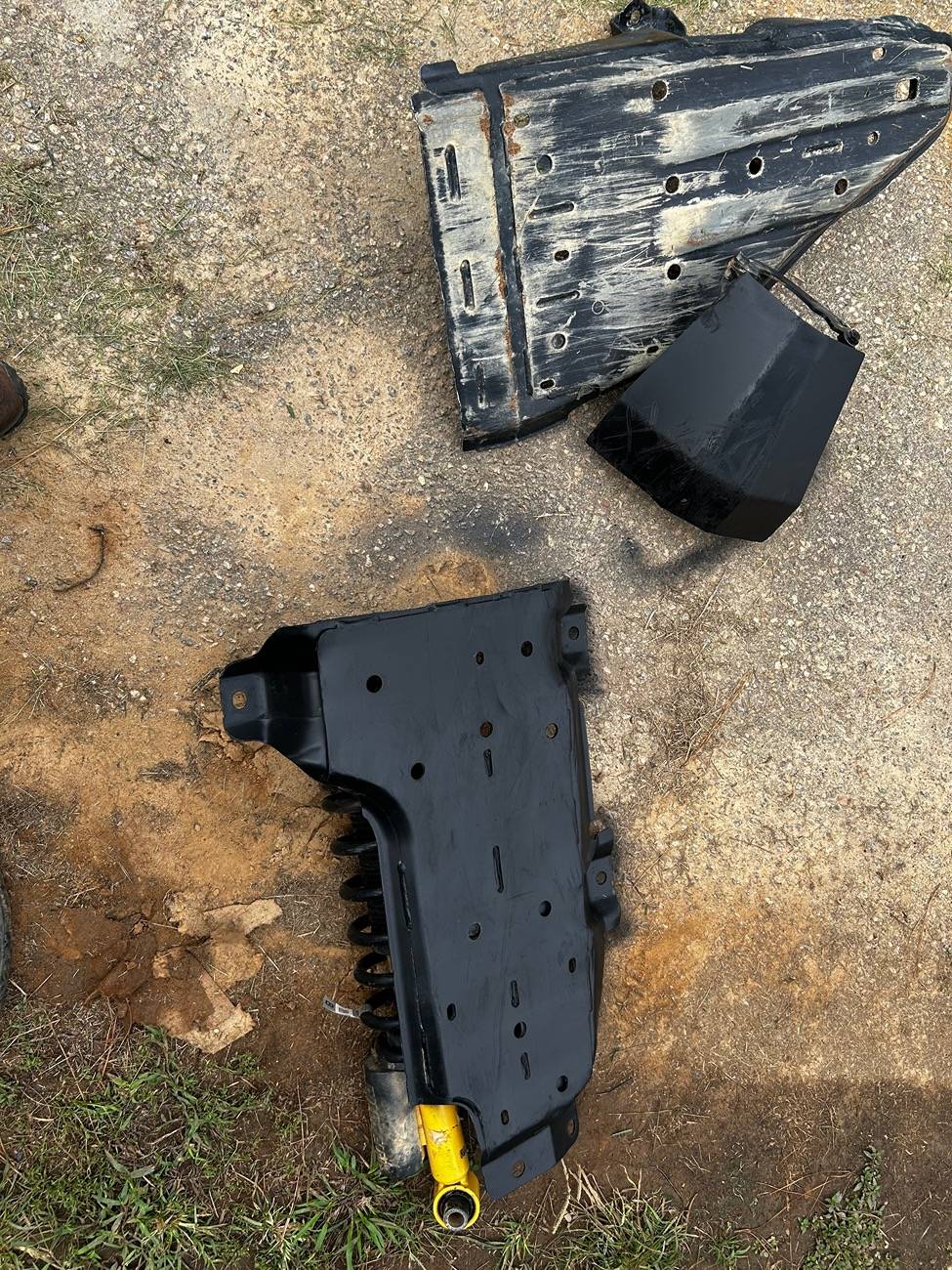

How are the Hooke fender liners holding up? Seems like you may have put them through the ringer a time or two!
mattusmc
mattusmc
Matt
Jul 17, 2020
109
506
2018 Mustang GT PP2
The rears were garbage, folded after sending the tire into the fender well, the tire grabbed the edge and folded it. The front have held up pretty good.

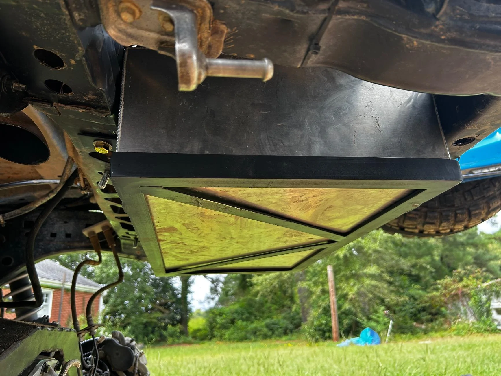

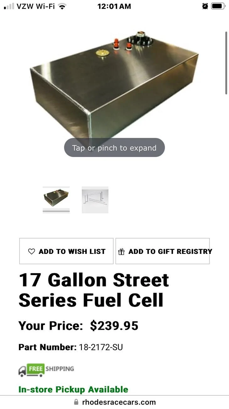

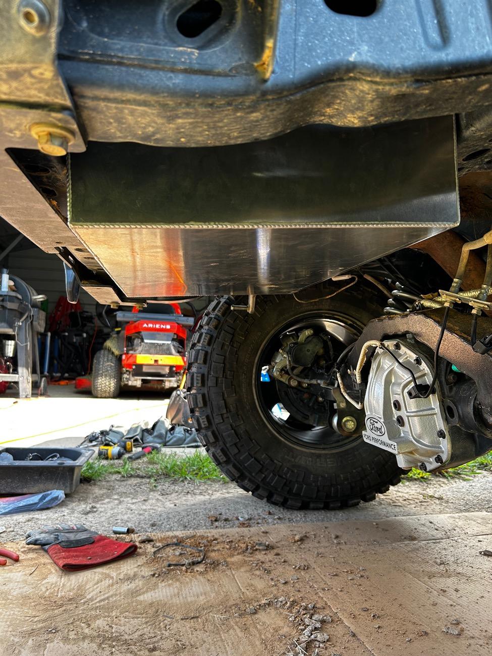

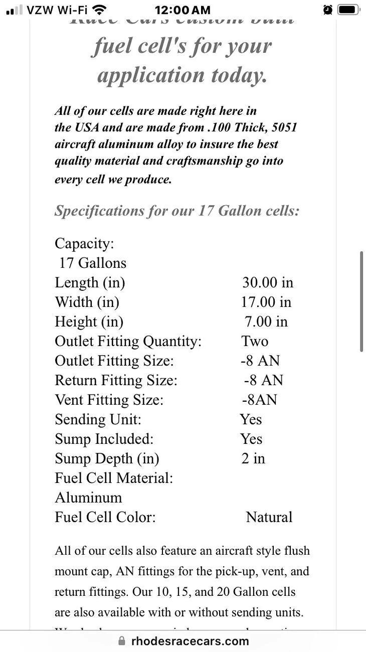

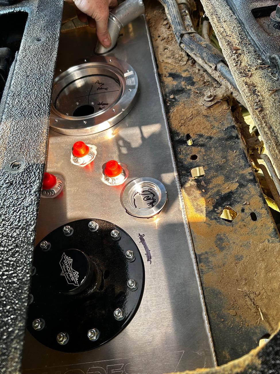

Mocked up the fuel tank… it’s almost too perfect, should be pretty easy to route the lines for the evap system and fill neck.

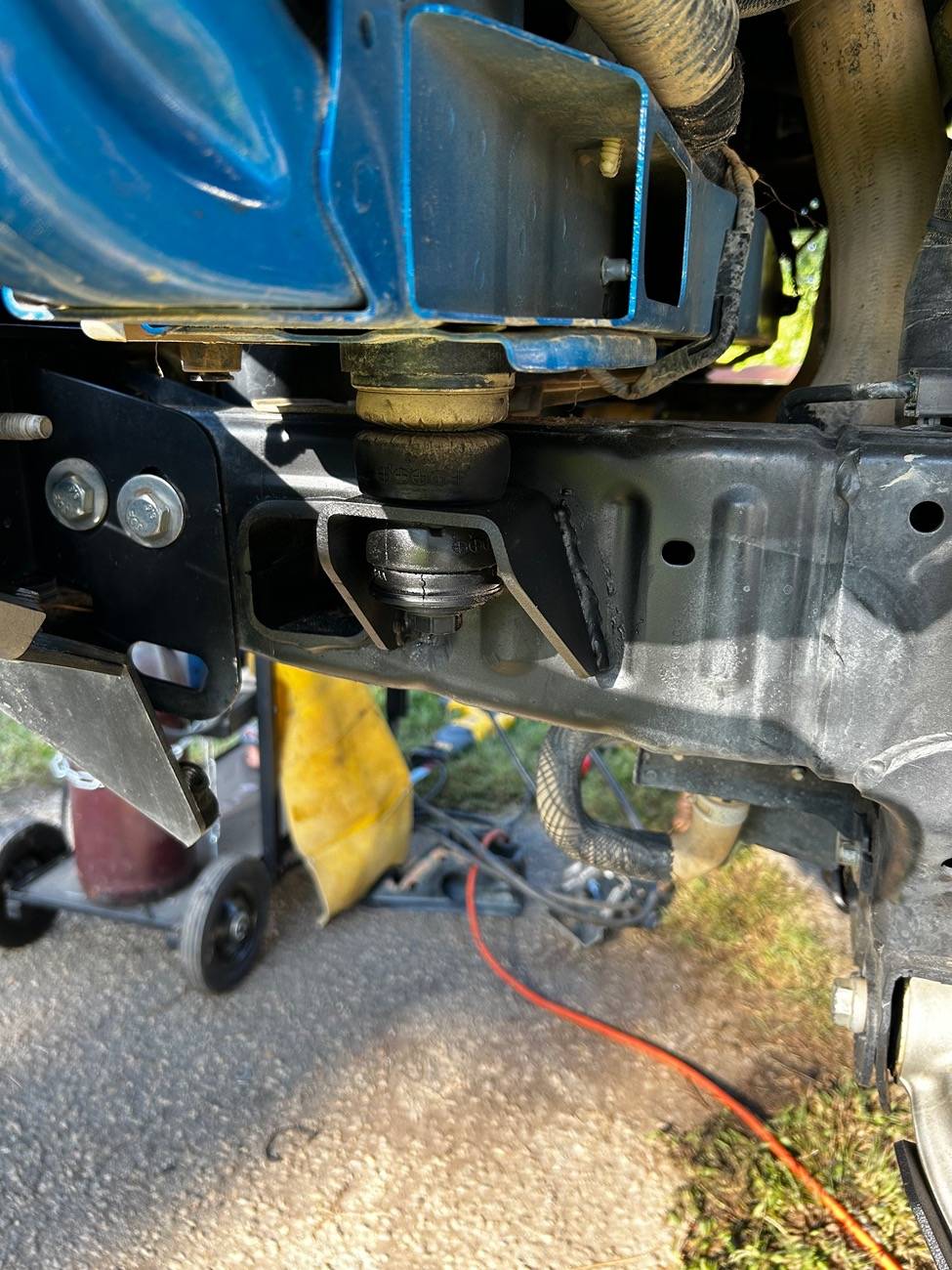

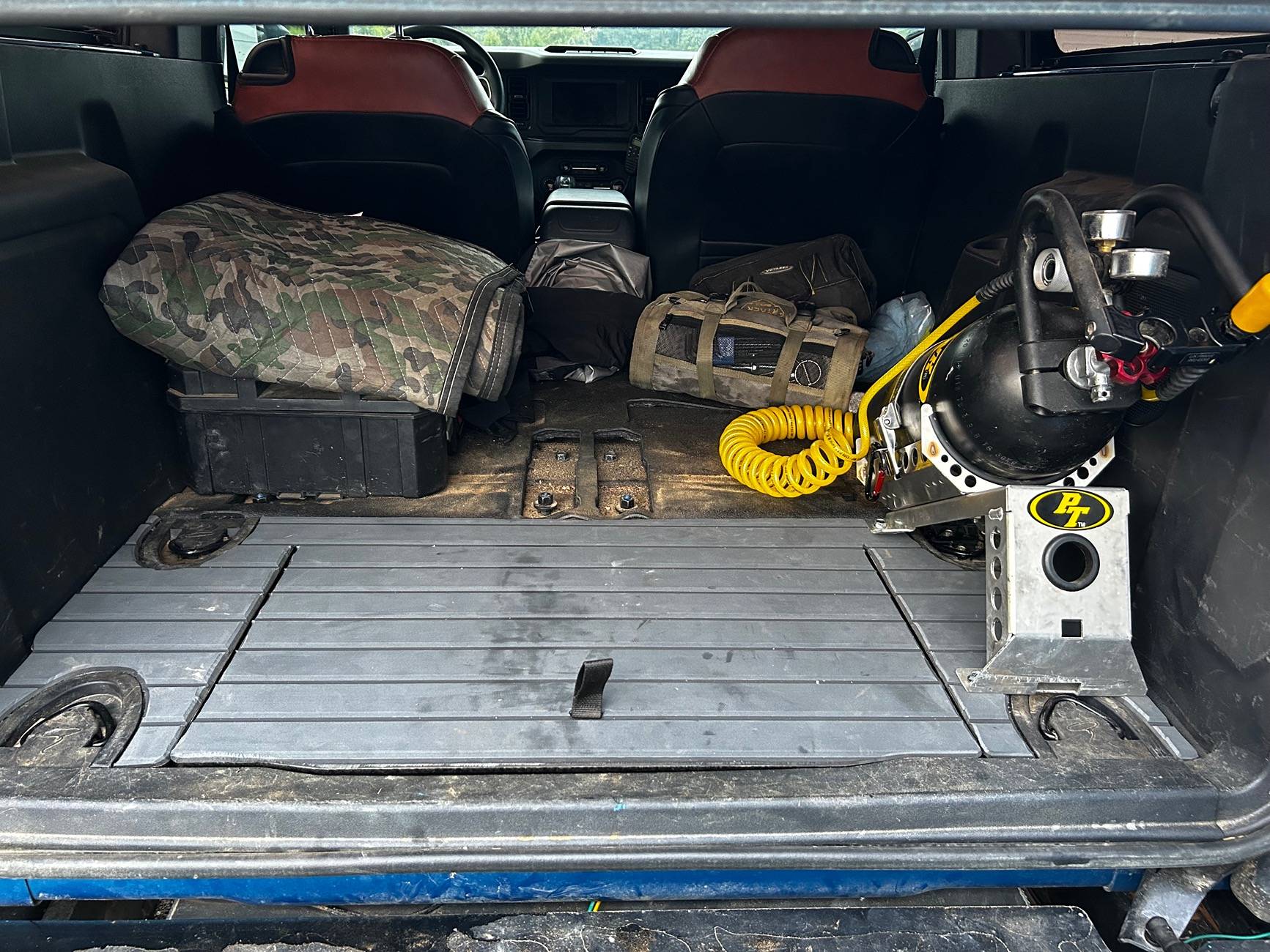

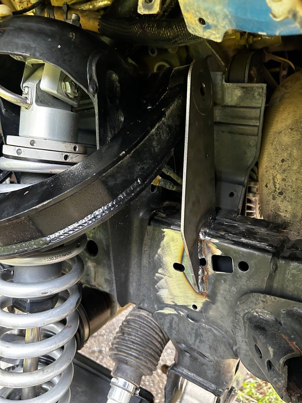

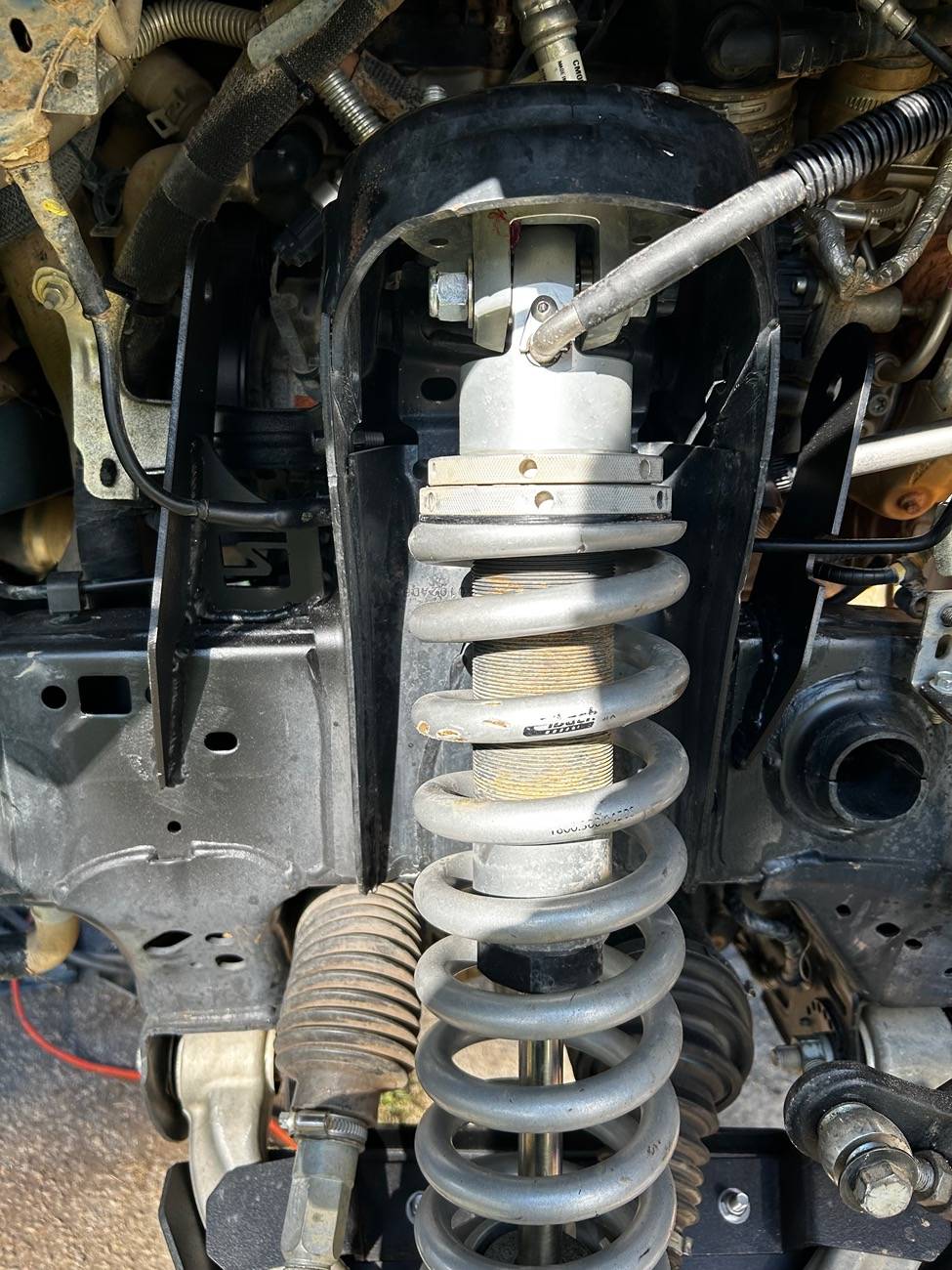

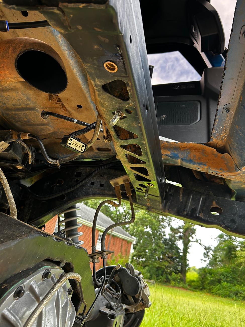

A few updates on the build, finished the solomotorsports UCA double shear mounts, stinkyfab body mounts, fuel system modifications, diff drop, and got rid of the carpeted rear panel. Finished remounting the powertank too.

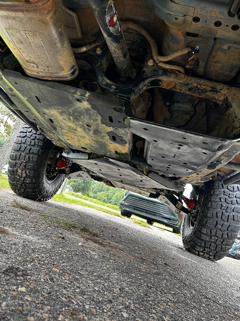

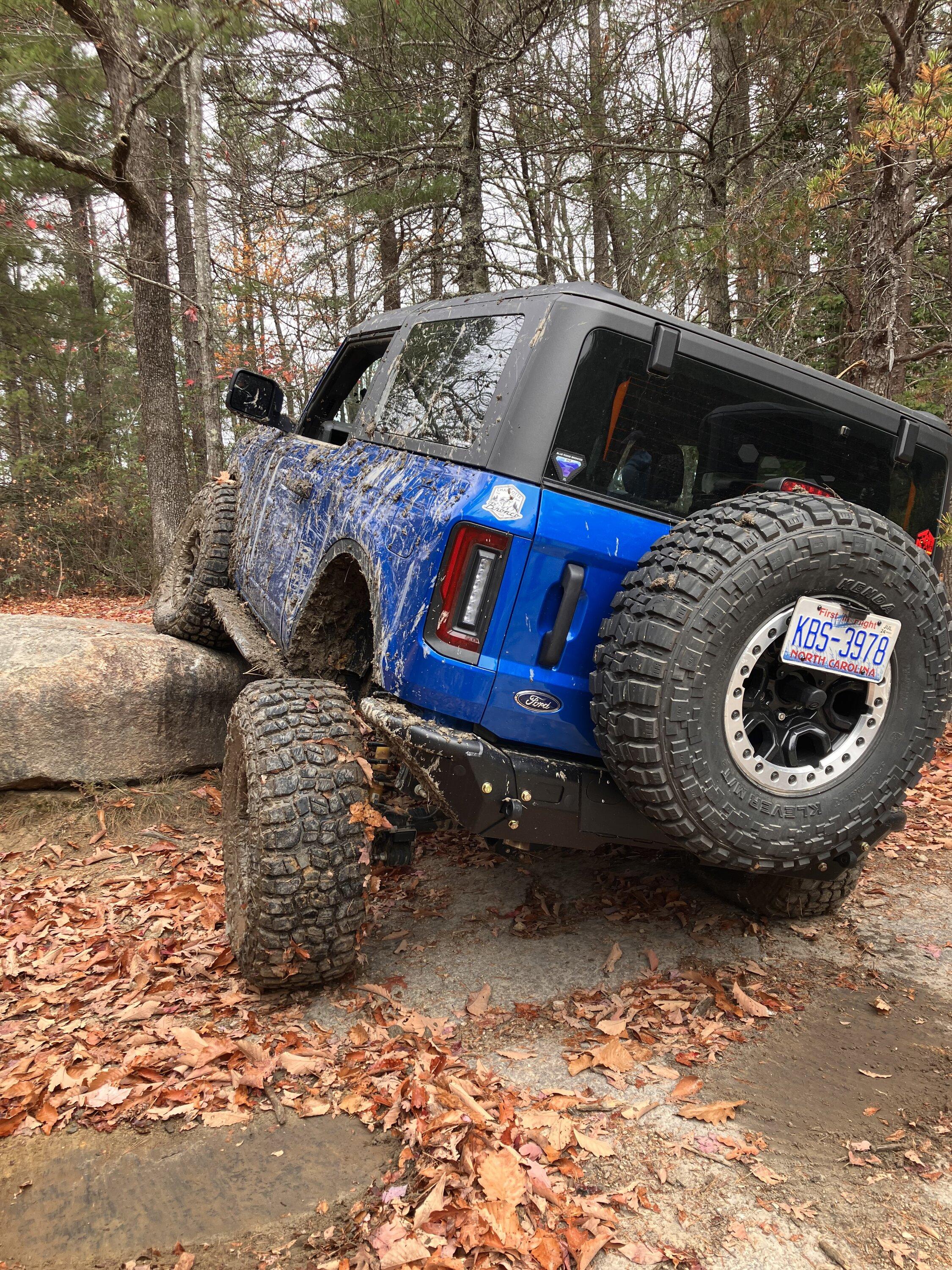

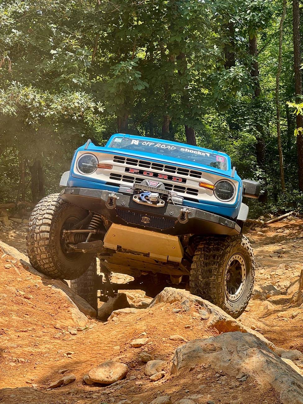

Had a great shake down run at Uwharrie this weekend. Fuel system works flawlessly, no CELs. Suspension feels the best it has ever been. Although now I want more tire and lower CG. Probably going to cut the fenders and see what I come up with for the front setup and mock up a true double triangulated 4 link for the rear or possibly a longer coilover and boxed trailing arm setup

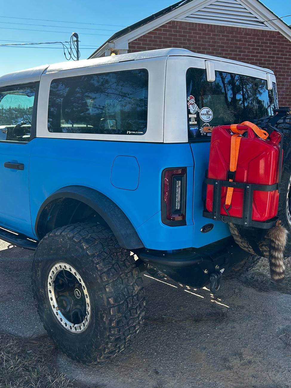

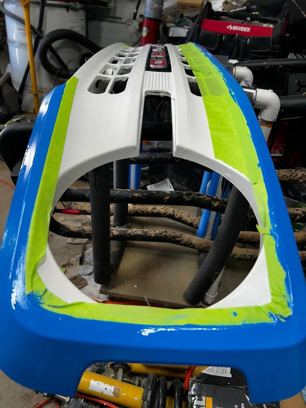

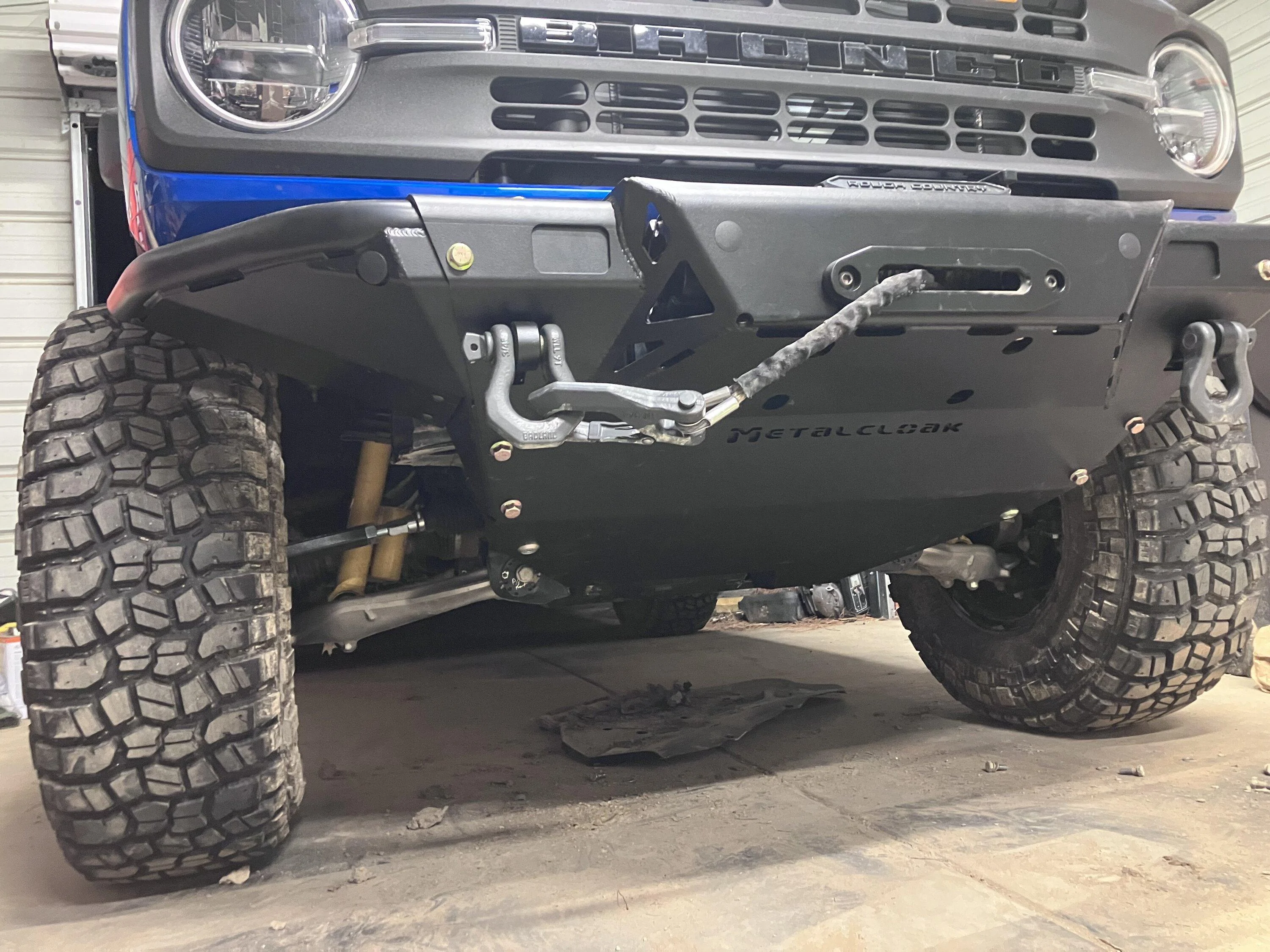

New Year…New Look!!

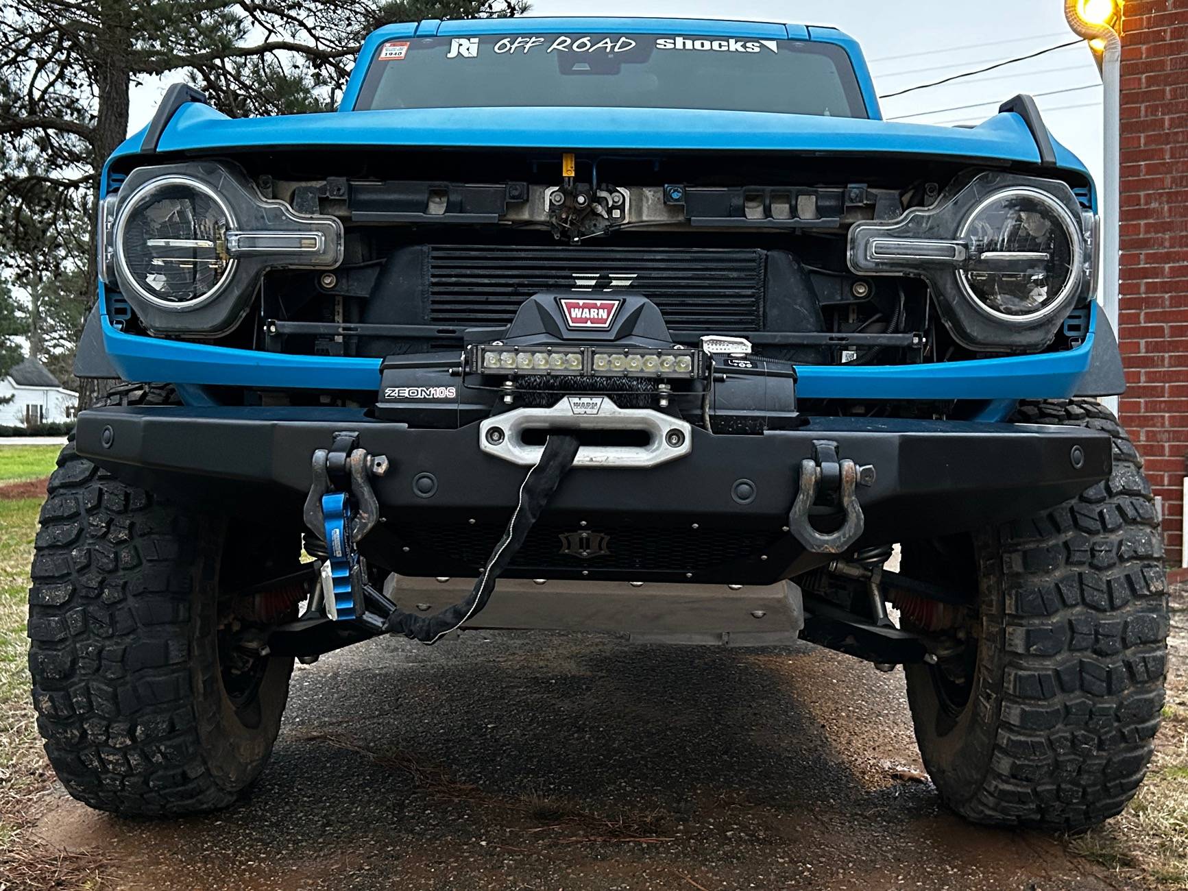

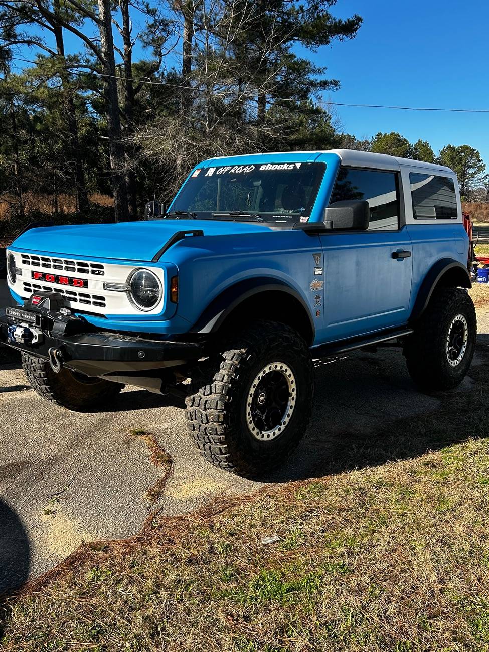

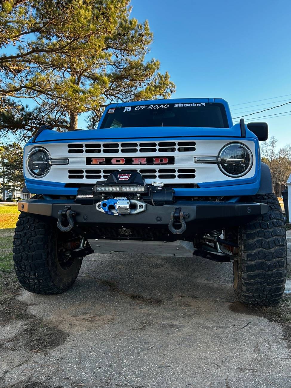

Swapped out the Metalcloak bumper for a new Icon Pro. Finished coating the grille and the hard top with Monstaliner. Just need to work on the fenders then it’ll be ready for bigger tires. Need to start on new 4link too.

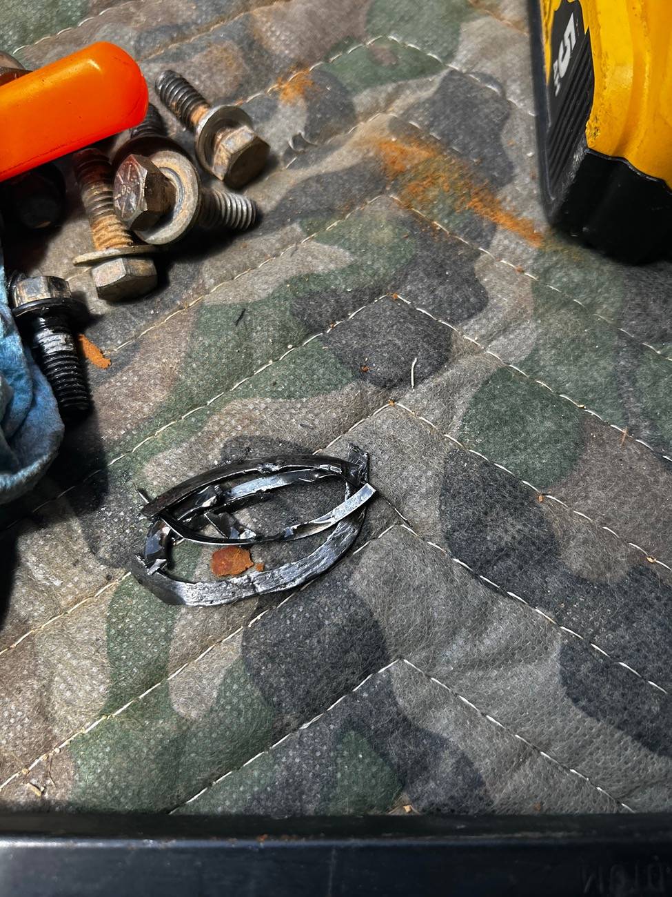

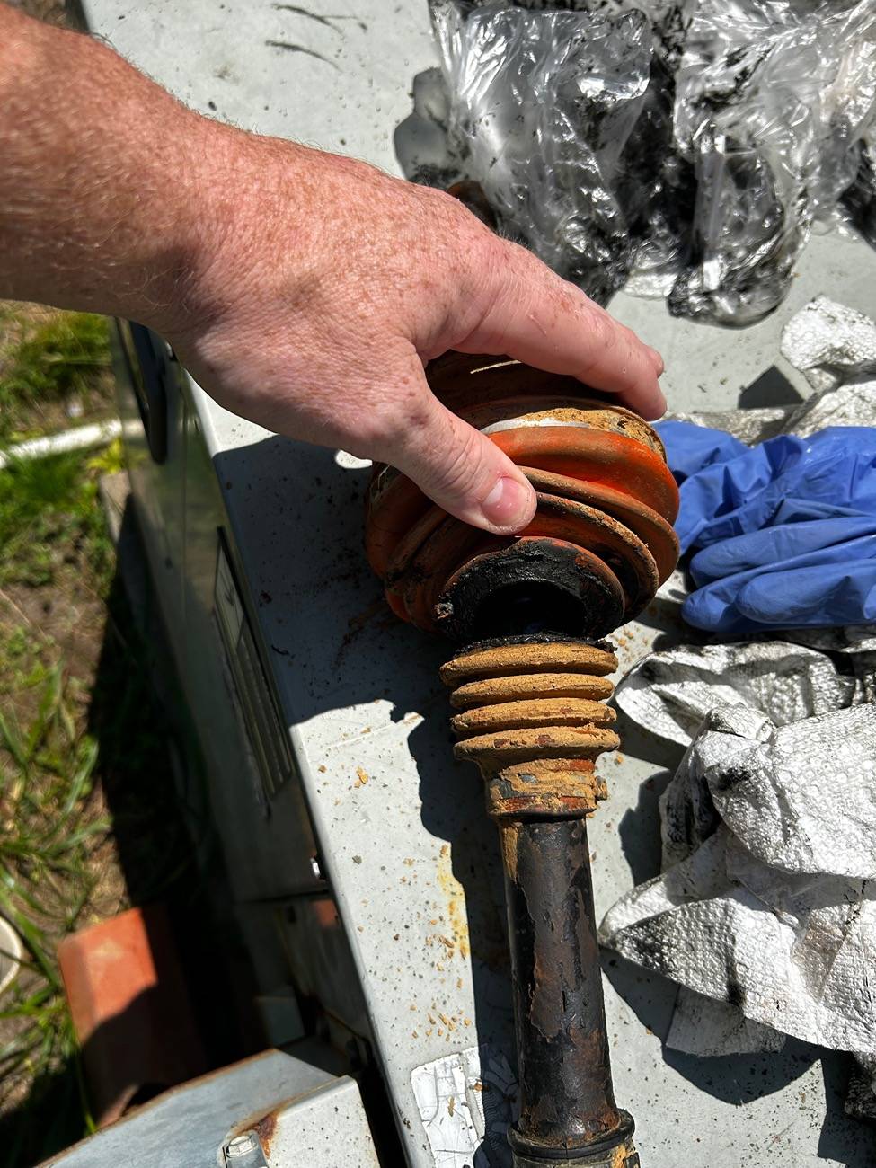

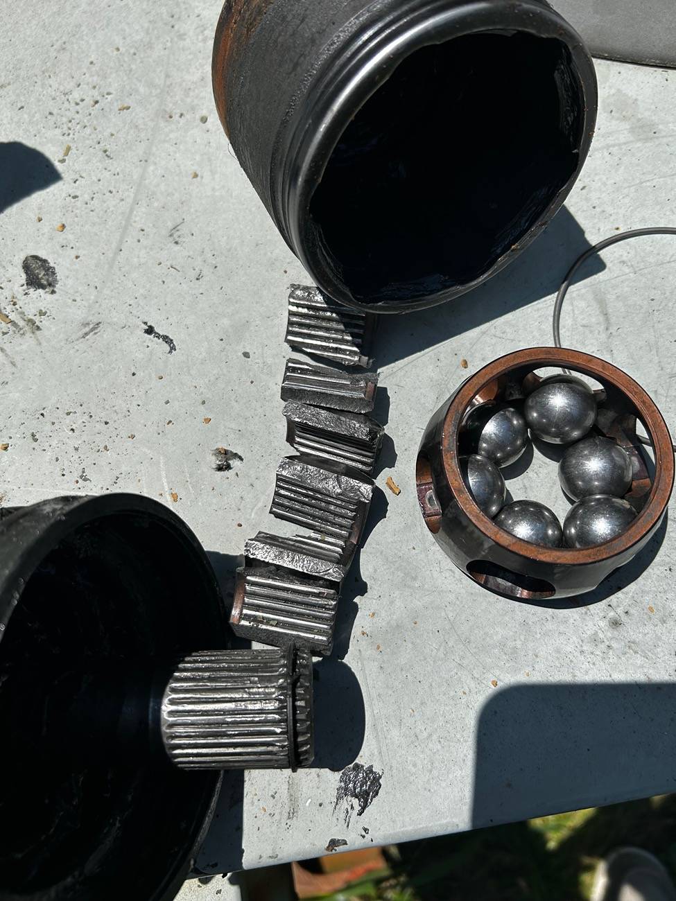

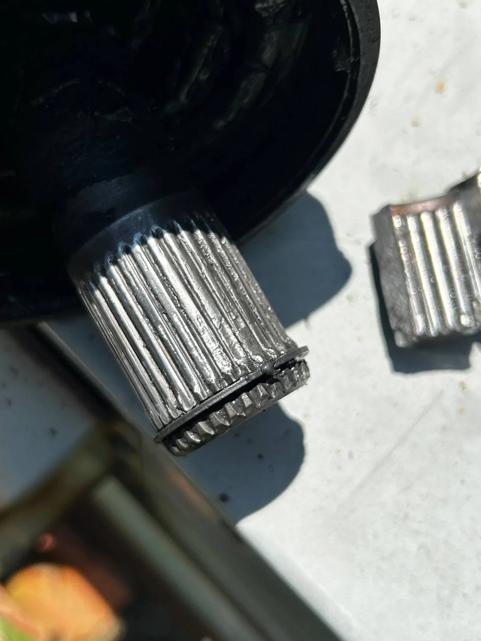

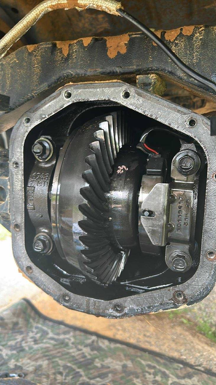

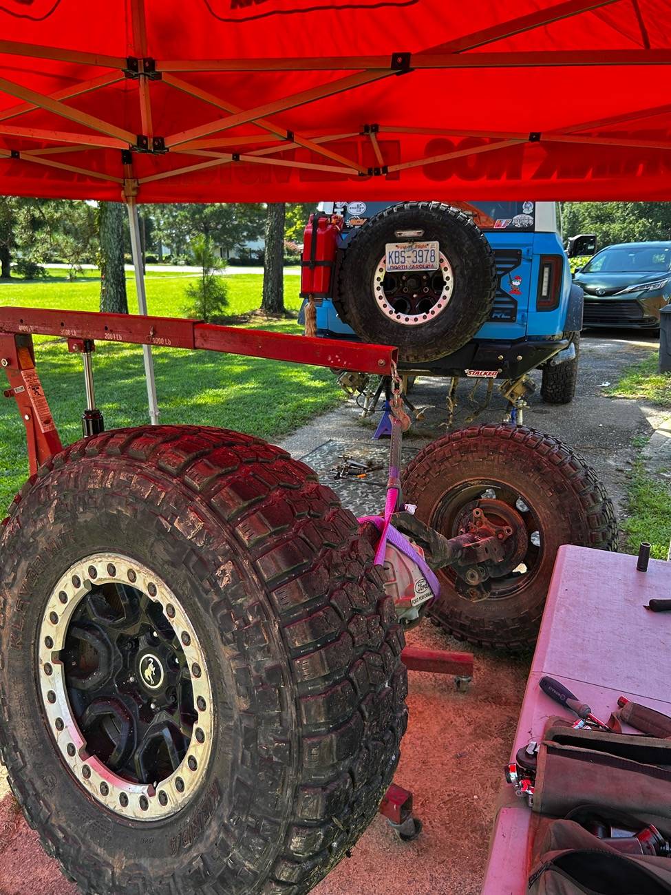

Some updates to the Bronco…
Broke a RCV passenger inner CV and broke the rear locker.
RCV has sent a new center shaft and rebuild kit.
For the rear I was lucky enough to find a new UD60 with an ARB air locker and 5.38 gears for $2500, steal of the year for sure.

I broke my passenger side RCV last year and just got around to have the rebuilt unit swapped back in. Wow, that’s a hell of a deal on the 60 rear!
