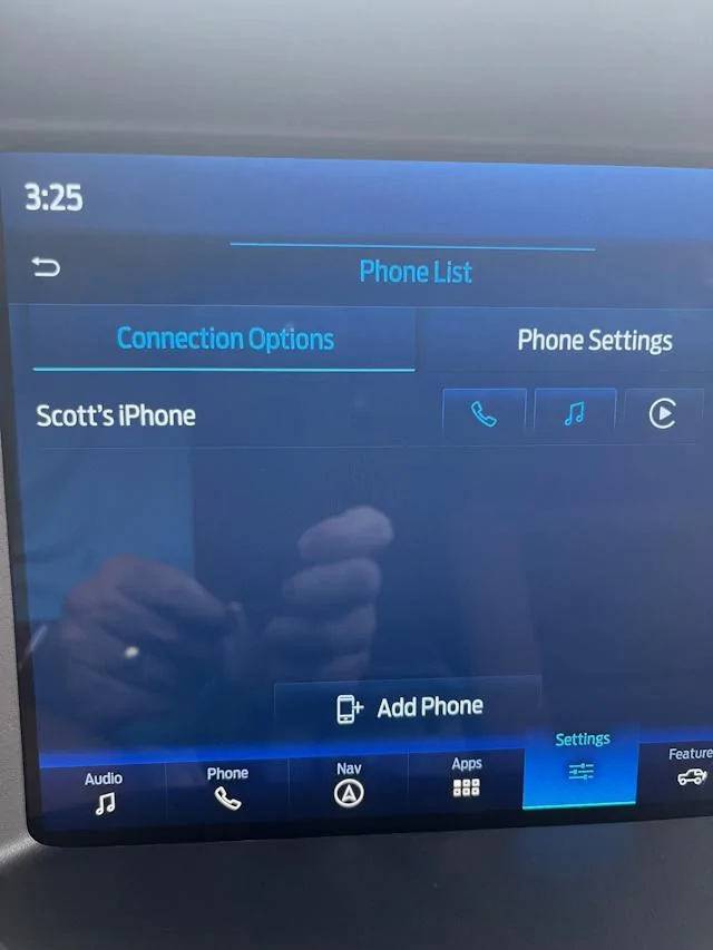

For clarity's sake, when I start Carplay I see this screen.

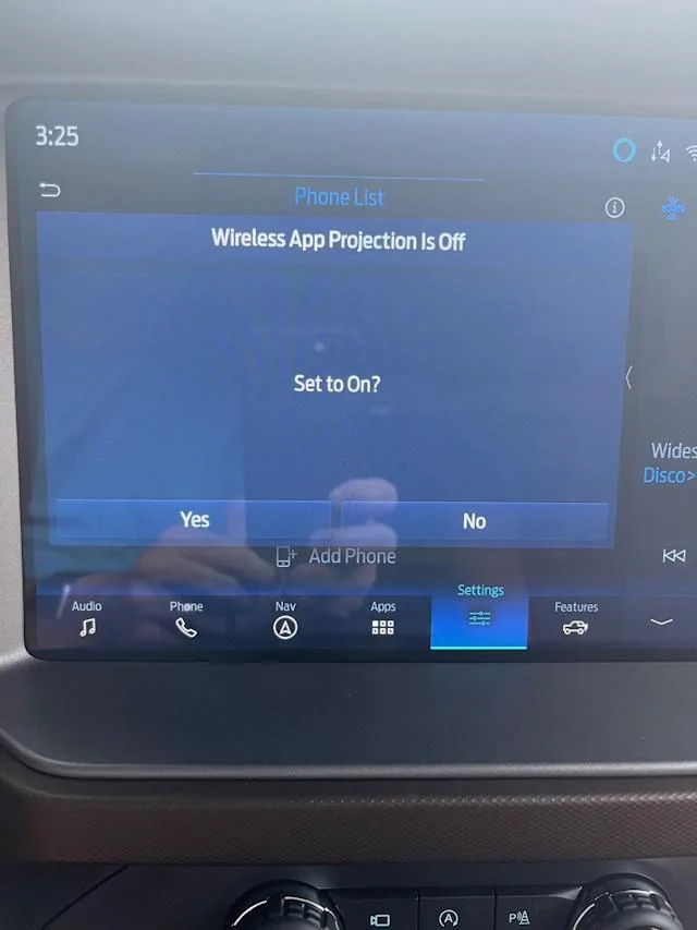

Clicking on the Carplay icon gives me this.
Ford Bronco Wireless app projection thumbnail_IMG_6272
Clicking on Yes, never enables wireless app projection and Carplay never starts.

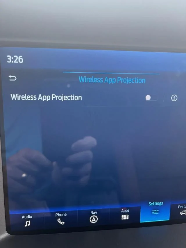

If I go into the Connectivity menu, The slider is greyed out for wireless app projection.
