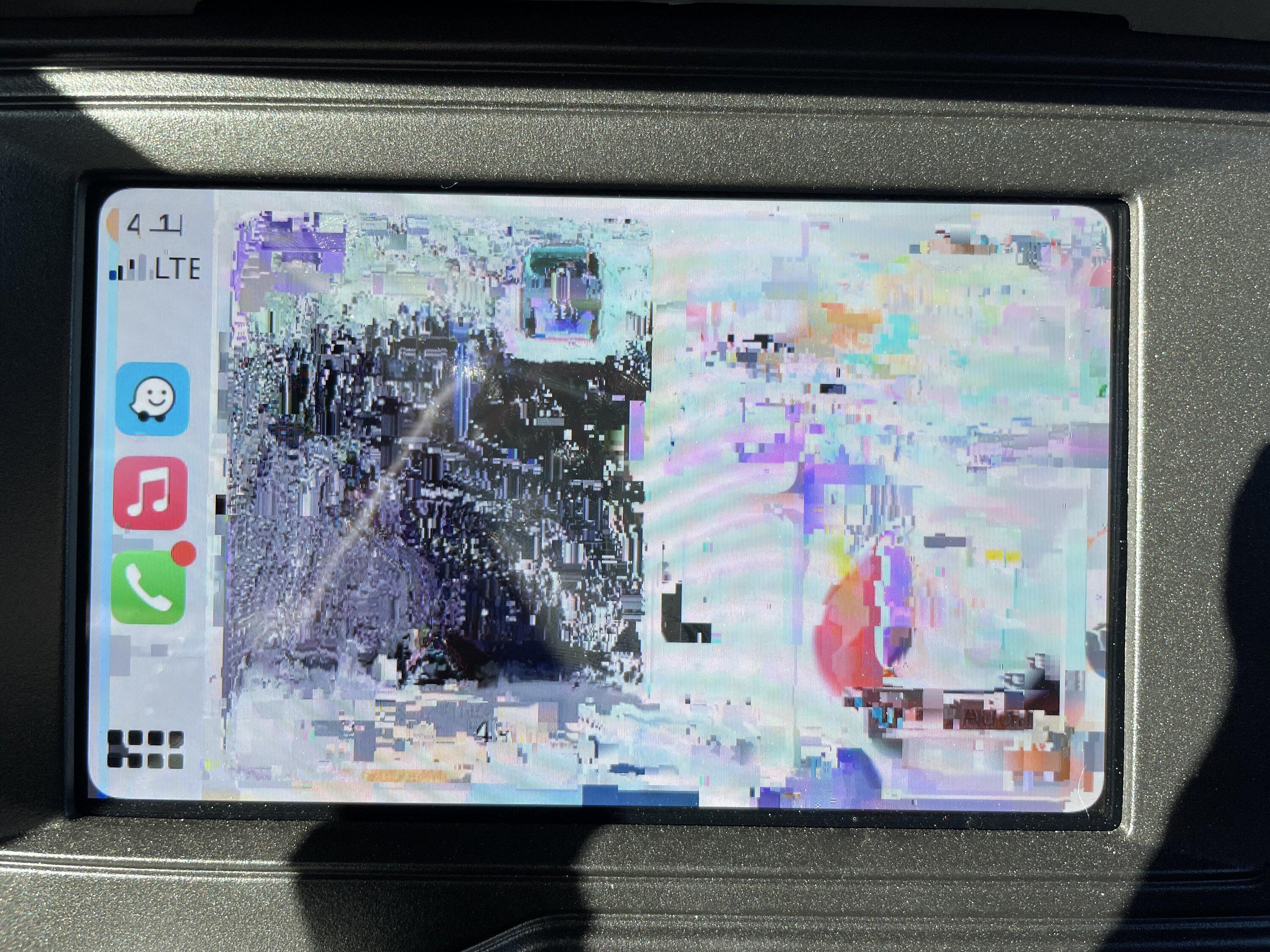

First road trip with the new Bronco. I have had zero problems with Apple Car Play up to now. IPhone 12 plugged in and I use Waze and play Apple Music. After eight hours of driving, my Waze screen suddenly looked like this. Pulled over and turned the Bronco off and then back on and it went away. Anybody else had this issue?
