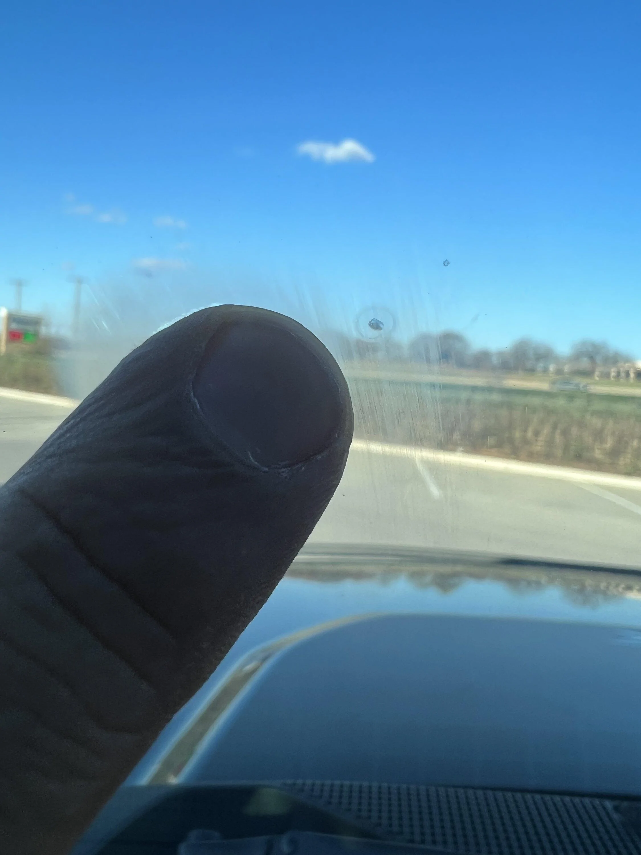

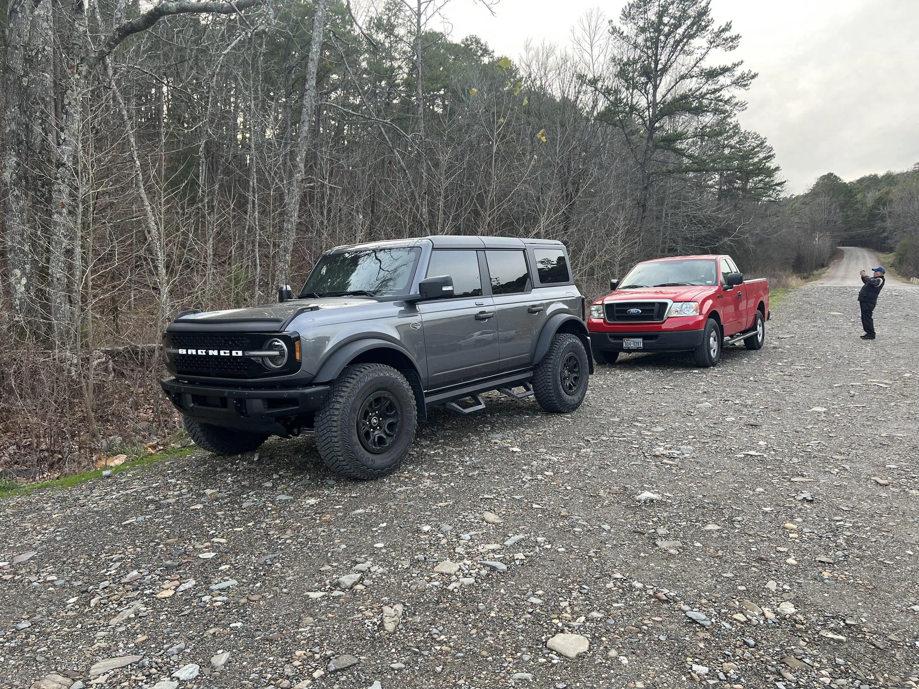

Just came back from Oklahoma, 4 hours on the highway and gravel roads. Got peppered by a few 18-wheelers but the biggest hit I got was from my own tire??? I was turning off a gravel road onto the paved road. Absolutely nobody in front of me…at all. Straightened out on the main road then pow! Rock about the size of a marble hit right at my eye level. I’m thinking when I was turning and the front tire was sticking out it threw a rock up and came down on the windshield. Cant tell if the damage is just to the film or windshield too. It’s supposed to be self healing so we’ll see what happens when it warms up.
Great job, the windshield won't heal when chipped or in this case has a tear. It's also not the same material as PPF like XPEL or SunTek. I have the same as you on my Mach-E, got a similar hit and it saved the windshield but have the same hole like you. My luck is that it's on the passenger side and not driver.
I just got Exoshield done on the bronco for $350, I have similar results as yours for the most part. You did a fine job, the stuff doesn't last forever either so if you get a year or two out of it, you are doing well.
One tip, you can use black thin pin stripe material on the edge to seal the ends. They can lift over time.
Ok cool cause I have one spot that didn’t seal 100% but that’s my fault for peeling it back up. Was wondering what I could use to stick it back down. What kind (brand) did you use?

Just trying to add another layer of protection to my windshield. Yea my insurance covers it... yea nowadays I can probably have the windshield replaced within hours...but I didnt wanna have to deal with all that. Is this snake oil? Maybe, was it my choice to "fall" for it, sho nuf! If spending $200 for the film gives me a warm fuzzy driving on the highway behind trucks and 18-wheelers then to me its worth it. May not be for everyone, may not protect against huge hits but I went into it knowing the pros and cons and decided to do it anyway.
