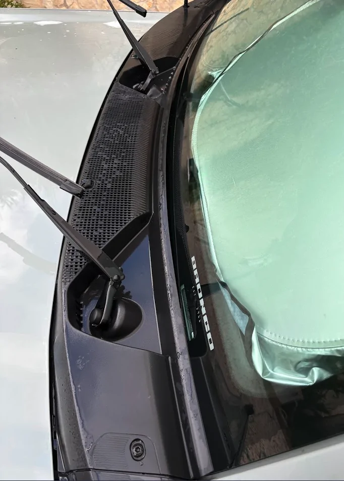

I never noticed this before, but today I was doing a deep clean of the windshield and hood when I noticed it.
I don’t have any other Broncos over here in Portugal to compare it with.
Is this huge gap in the middle normal?
It’s tight on both sides, but there’s maybe a 3/4" gap in the middle.

It's a known issue. Some have had luck getting it replaced under warranty. I was not so lucky with my local dealer. I may eventually try with another dealer, but I haven't yet. There are a few threads about it here.

It's tricky getting the cowl in properly. Do it wrong and you'll have a gap. You need to pop all the tabs where the cowl snaps in behind the firewall. Then you can snap the cowl under the windshield. Then snap the tabs in behind the firewall.

I had the gap as well but my dealer replaced the cowl for me under warranty. No gap appeared since at almost 2 years into ownership.

I would.
The gap will accumulate junk over time, you don't know what problems that willl cause.

Thanks for the replies. Good to know it is not normal.
I've only been to 1 of 2 local dealers here - the only one that would look at the truck. They did the initial service but only fluids and filters not any software or anything. So not sure what their approach to this under warranty might be.
I might wait for a cooler day and try it myself.
Like CalvinT said it will be a collection point for trash and debris over time. So would prefer to get it fixed.

The hinges won't affect it. But if someone has pulled the cowl up, they won't be able to get it back in place unless they follow the right procedure.

It isn't going to harm anything other than the possibility of crap getting down inside there more easily. If you start getting things like leaves, pine needles, road salt, etc down in there it will retain moisture and begin the car cancer where you can't see it.

Yep. Which is why I asked. I know hoods are not water/debris proof but this looked wrong. Would like to keep all the extra stuff out for the reasons you mentioned.
