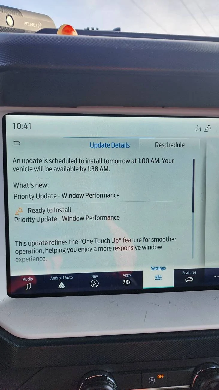

So I pulled my 2024 Heritage out of storage, and got this...
Of course, my '24 already dropped the windows with the keyfob, but this seems like something else.
"One touch up" Refines the feature for smoother operation?
I didn't know there was an issue with this before. Worked perfectly fine! What about 1 touch down? That didn't need any refinement? Lol
Is Ford just trying to keep people at work, or...? 🤷🏻
Is there another thread on this maybe 🤷🏻
