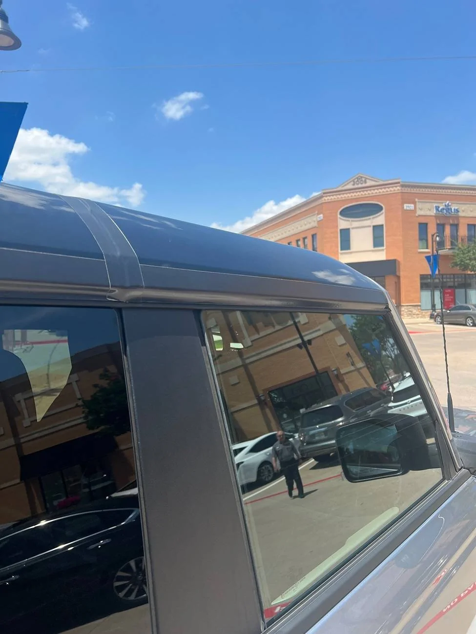

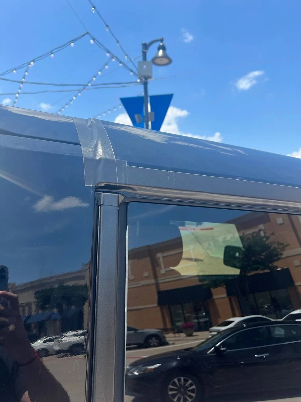

2024 Wild trak with the painted shadow black top. Since purchasing, I’ve been noticing wind noise almost like whooshing coming from the passenger seat area at 40+ mph. Didn’t bother me much when daily driving but this weekend we took it out of town (about 3 hour drive) and the wind noise was a little obnoxious and noticeable especially at high speeds (70 mph+). Tried taking out and adjusting the panels but everything looks pretty normal as far as seals and gaskets. Also got rained on pretty bad few times and so far no leaks so do I just get used to it or is there anything that could be done?

Wanted to post an update/solution on the issue. After some trial and error, I decided to add T-Rex tape along the passenger side top area as well as across part of the weatherstripping that goes around the top and the wind noise is now completely gone! Attached couple of pictures for reference in case anyone is dealing with the same issue. One thing I am not sure about is whether the tape will damage the top long term but I guess we shall wait and see.
Ford Bronco Wind noise from back passenger seat area IMG_6987
Ford Bronco Wind noise from back passenger seat area IMG_6988
