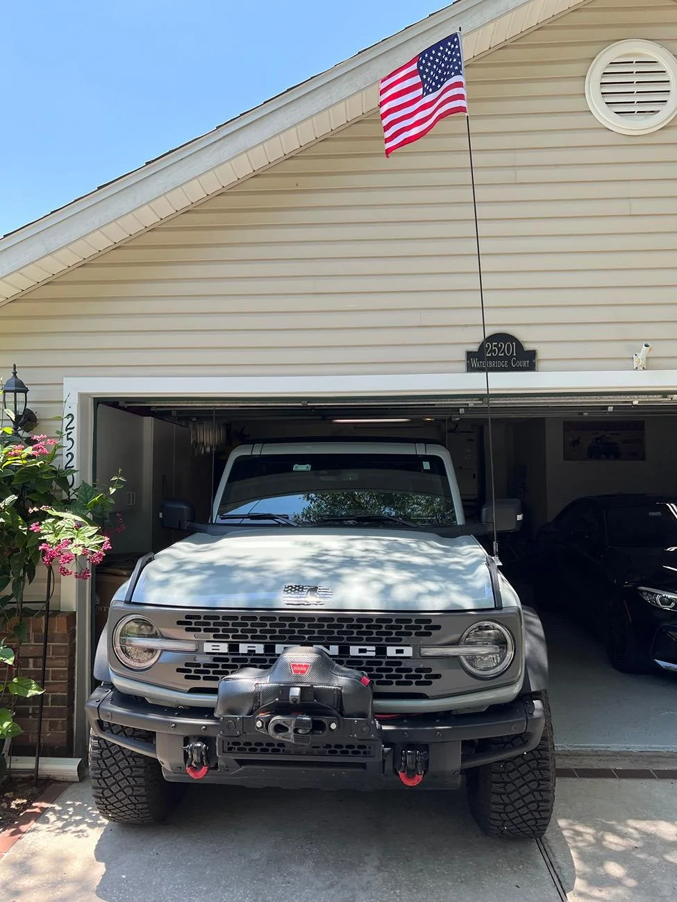

Here’s my setup. Warn VR Evo 12S on RC Mount. Like most others, I carry soft shackles, tree saver, 30’ kinetic rope, 10‘ kinetic rope bridle, hard shackles on all four bumper corners, and 20’ strap.
Ford Bronco Winch accessory question - cover/line shackle? IMG_1729
Nice setup. What winch line shackle did you use?
Chrome_Pony
Chrome
May 20, 2020
1,124
2,272
The Great Land
2023 2.3L Badlands High, 2017 LWN Duramax Z71
That is a Factor 55 Flatlink - E in grey.
I have the same, but the Superwinch 1571 neoprene cover is more my speed. Stretchy and one drawstring instead of about 5, 2 zippers and no stretch on the Warn winch cover.

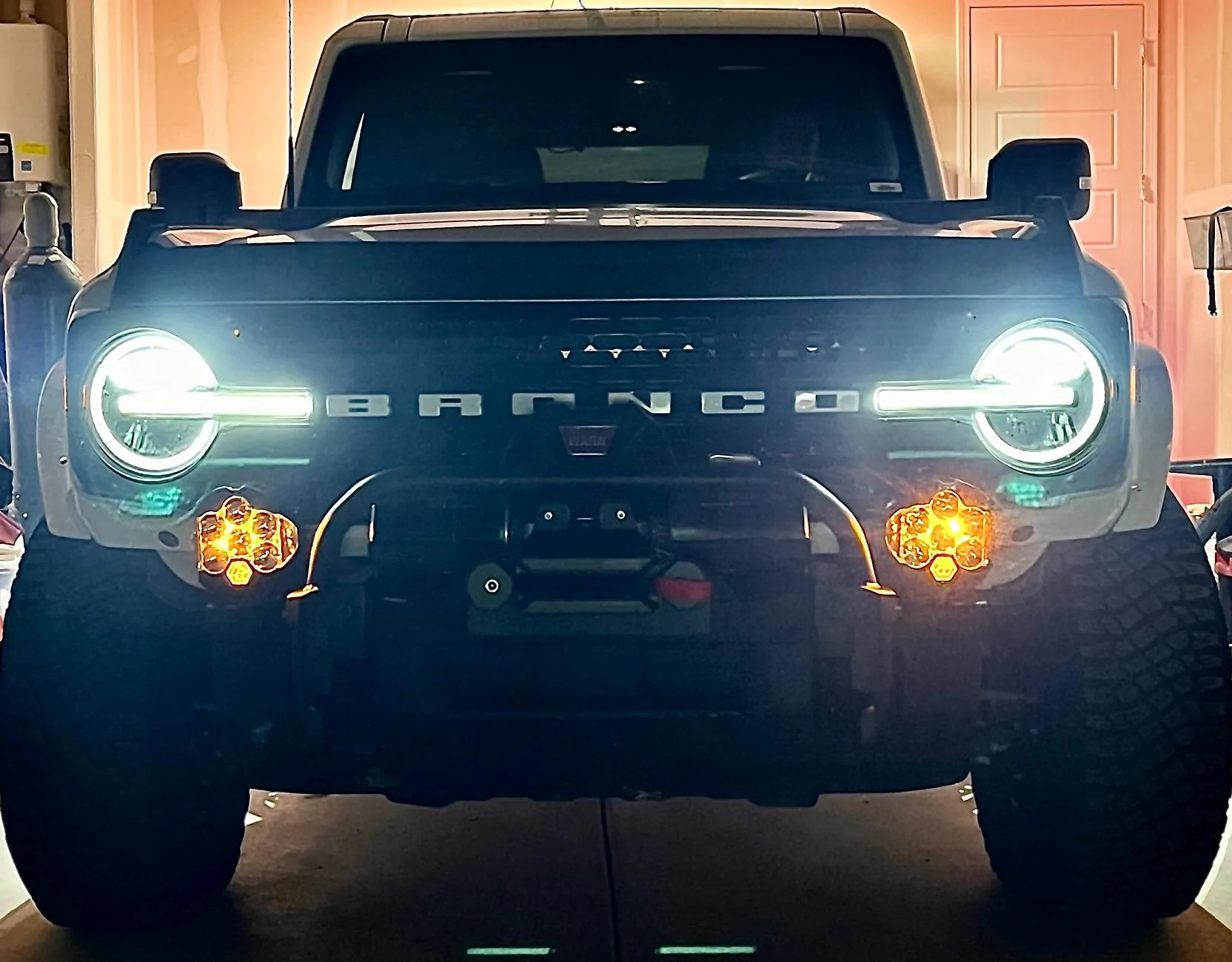

My winch is more recessed than yours and has an Anderson 350A QD, which combine to make it exponentially worse to try to finesse that tightass Warn corset around the winch.
Ford Bronco Winch accessory question - cover/line shackle? 20240119_222526

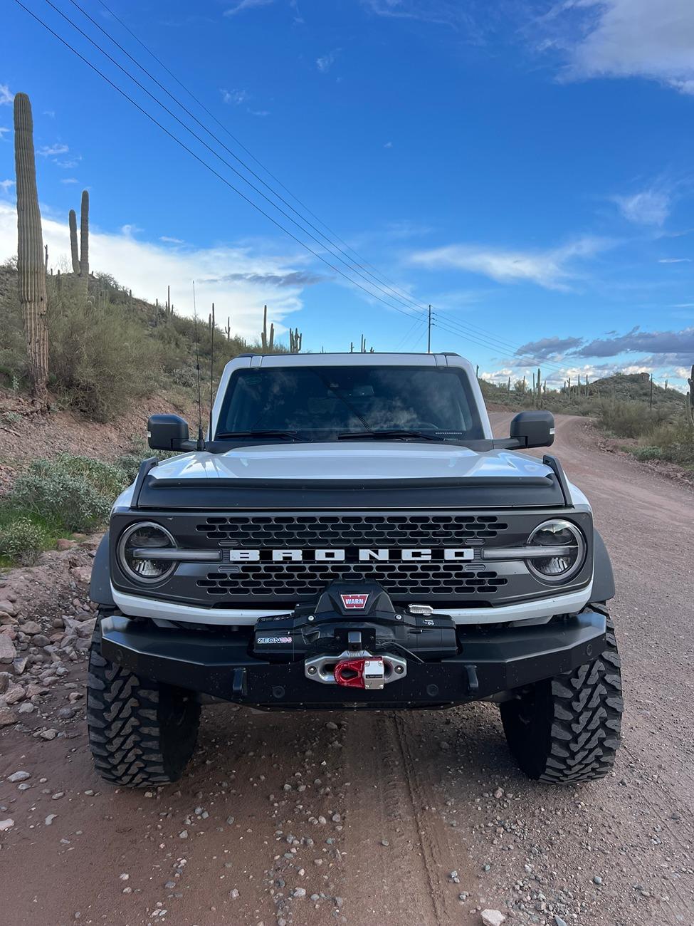

Personally I don't think the Warn 10-S needs a cover as it is a sealed winch. I protect the rope from the sun & junk with some high density foam & a strip of Gorilla Tape. I just remove it whenever I need the winch. Works for me, YMMV 🤠
Ford Bronco Winch accessory question - cover/line shackle? IMG_6939

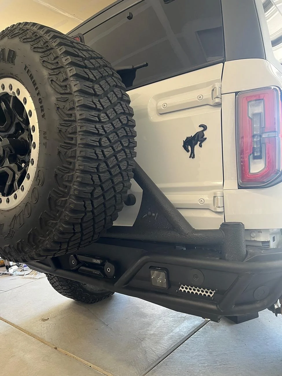

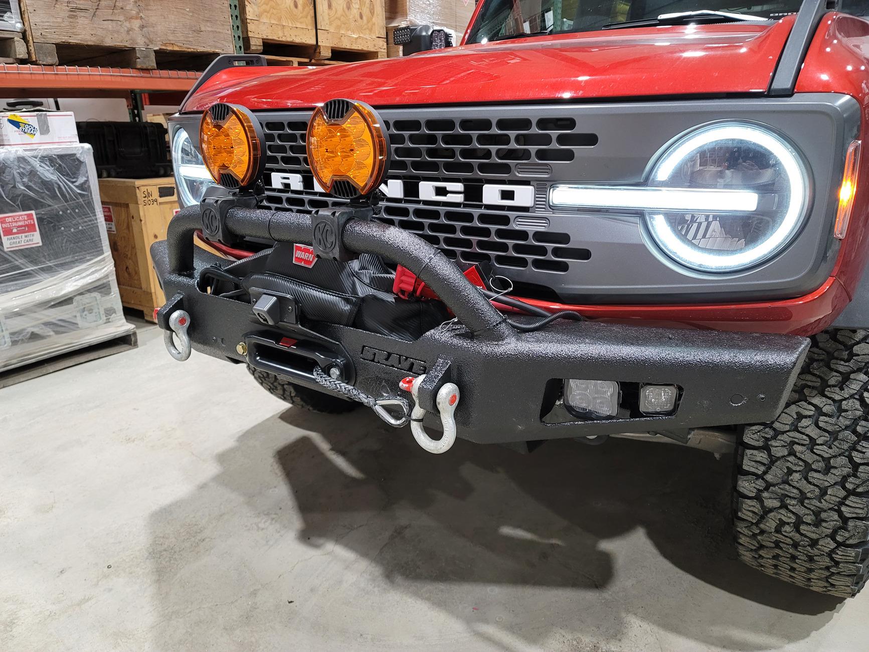

We just did a brummel splice front and rear. Winch line tucks in and is protected from hitting rocks by the fairlead up front
Ford Bronco Winch accessory question - cover/line shackle? IMG_1685
Ford Bronco Winch accessory question - cover/line shackle? IMG_1589
