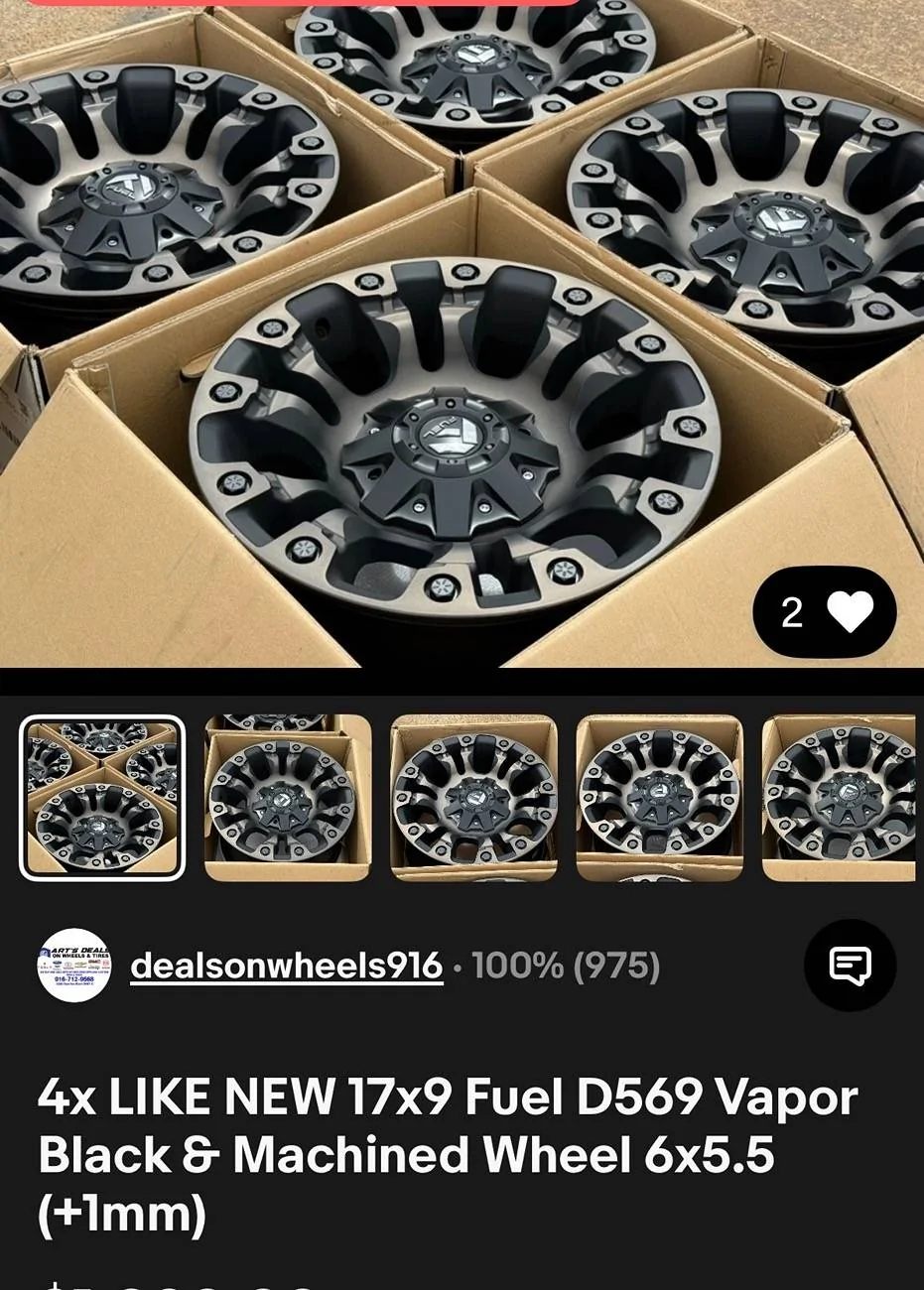

Looking to buy these for my ‘24 Badlands non-sas. They are 17x9, 6x5.5 with +1mm offset. Will they fit without any issues? Will I need to remove the crash bars?
Thank you!

Yes, these should fit but you will be well outside the fender flares if that matters. You're going from a +55mm down to +1mm (first time I've heard of this offset) so you will be moving the wheel out 54mm (a hair over 2").
If you are keeping the non-sqautch 33" tires you won't need to remove the crash bars...if moving up to 35s then yes, crash bars will need to be removed.

Super helpful! Thank you!
