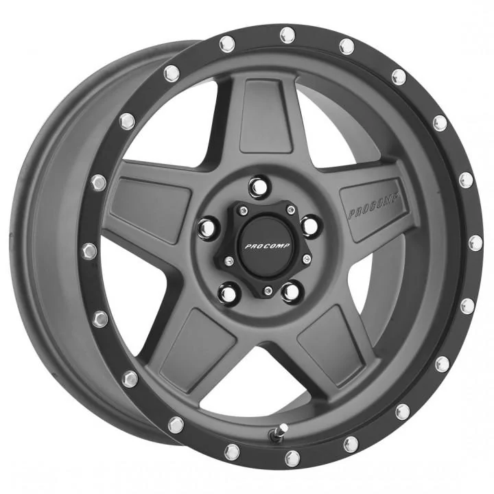

Looking to pick up a set of ProComp wheels. The Series 35 Predator have been what I've wanted for a long time, and I notice they make a 6x5.5 bolt pattern. What I don't know is the offset/backspacing ... is this aggressive, stock or too tight?
  • Wheel Size: 17x8.5
  • Bolt Pattern: 6 on 5.5
  • Offset: 0
  • Backspace: 4.75
Going to have a set of Nokian Outpost 315/70/17 mounted on them. I am also lifted 2" with a ReadyLIFT spacer kit. Just curious how this would look.

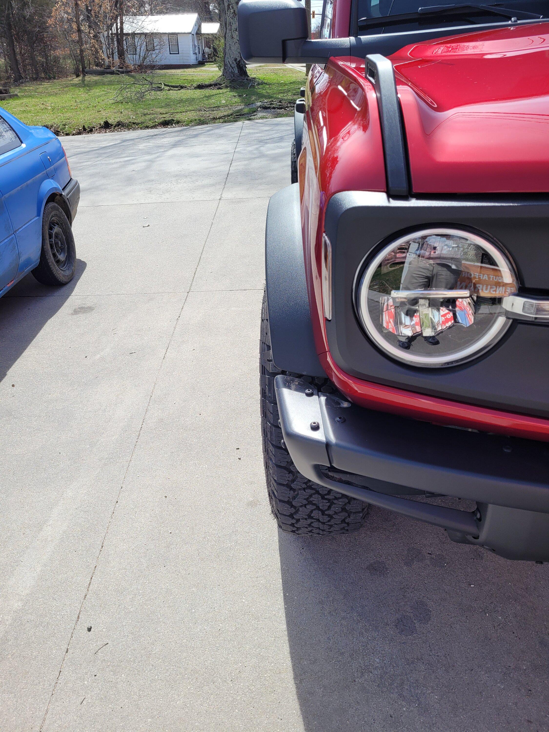

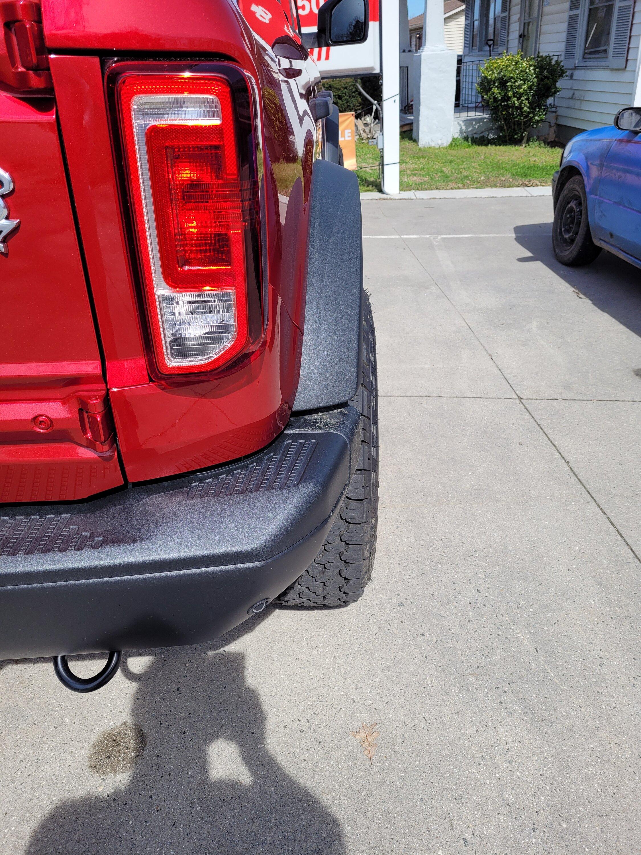

Those wheels will look great. My wheels are +18. I put the grabbers back on there until I can save for lift and tires. Very little poke. Yours will poke more. When I go bigger and wider, I will add the squatch flares.
Not great pics, but here is the poke on mine

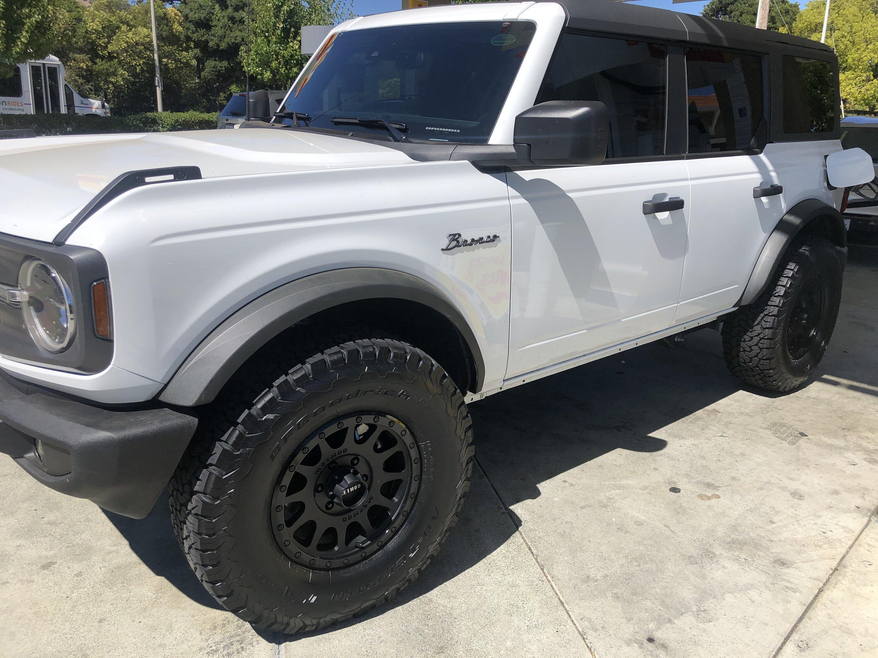

I put on 315/70/17 Method +25 and they work great. Only had to remove crash bars. Big bend.
New to this site so not sure how to post but wanted people to know to go with them.

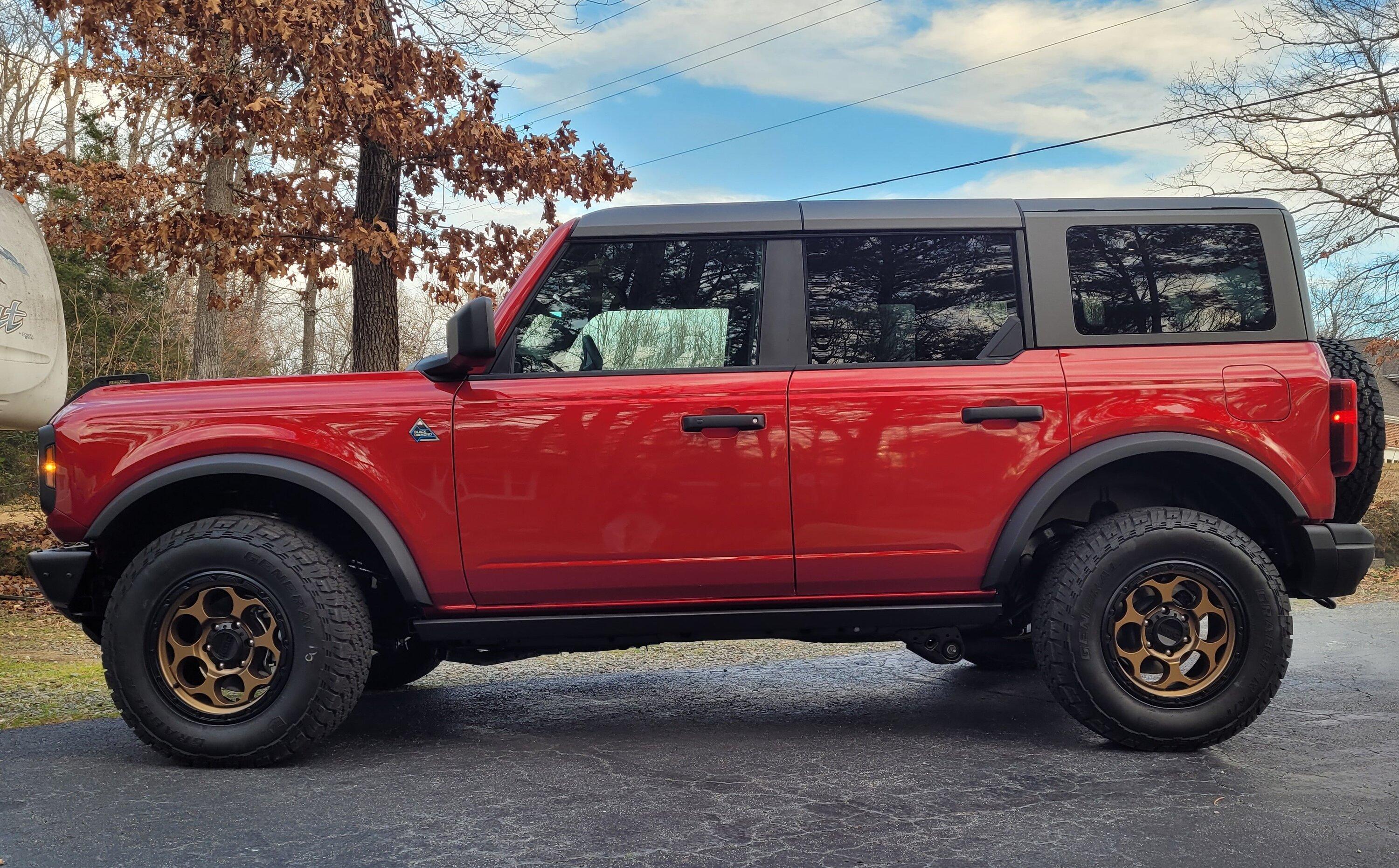

Brodozer made me laugh pretty damn hard. Seeing as how my Big Bend is Cyber Orange, it actually works 🤣. I ended up going with 17x9 0 offset TTX MOABs in the machined black / bronze tinted. I will be opting in for the much wider fenders (non Ford part, they're Raptor-esque) to cover them.
All I have left is running boards and I'm done
