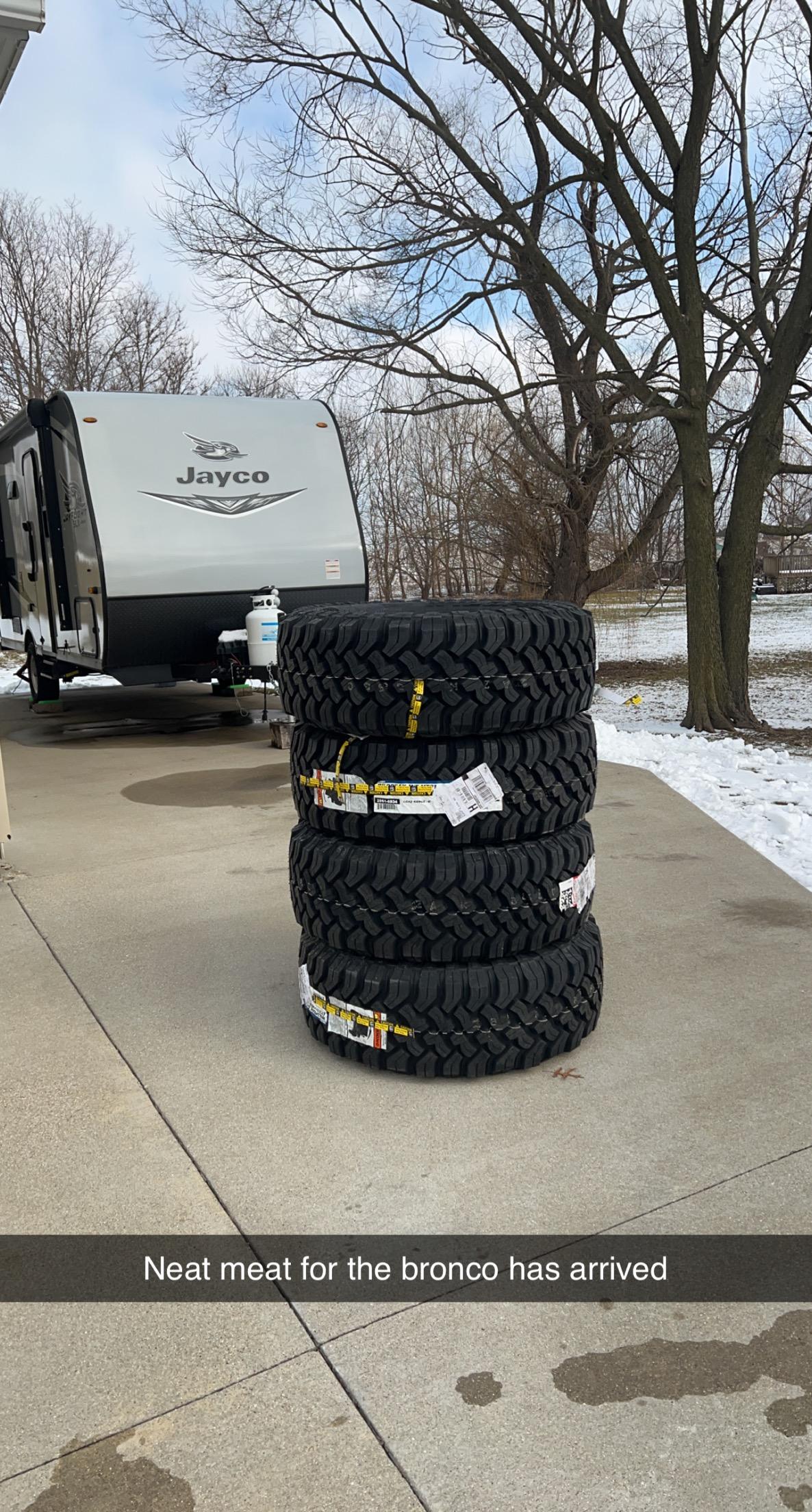

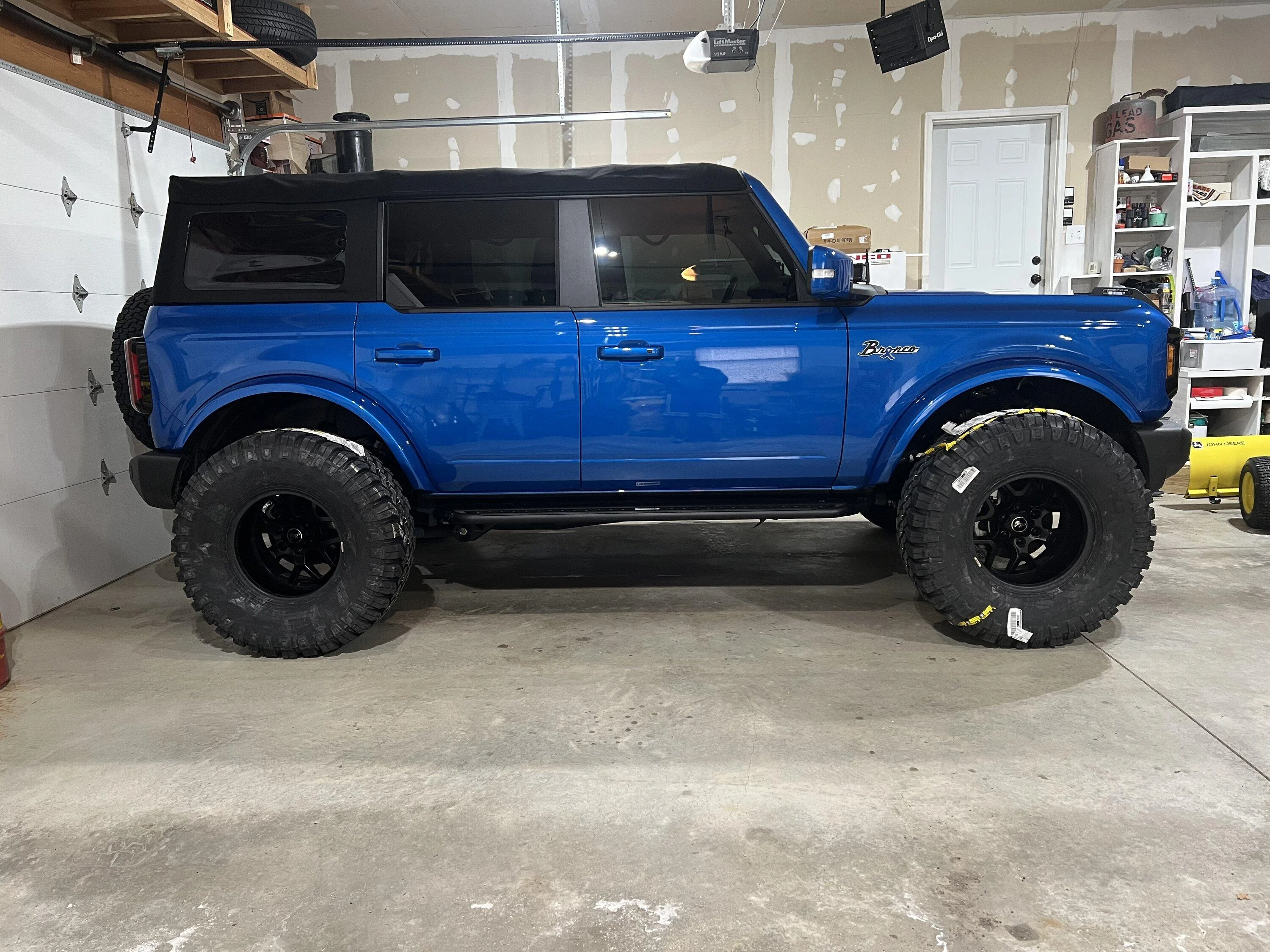

Hey everyone. My brother passed away and I’m building a memorial rig for him. He had these 16in TRD wheels on his Tacoma and I want to put them on my Bronco. I bought a set of 315/75/16 Falken Wildpeak MT’s for the wheels but after getting them I’m feeling like there is no way they’re going to fit on my NON SAS OBX with a 2inch RC spacer lift…. Anyone know if I’ll be good or should I just send the tires back? I wanted to run 35’s and this tire size is my only option with 16’s.

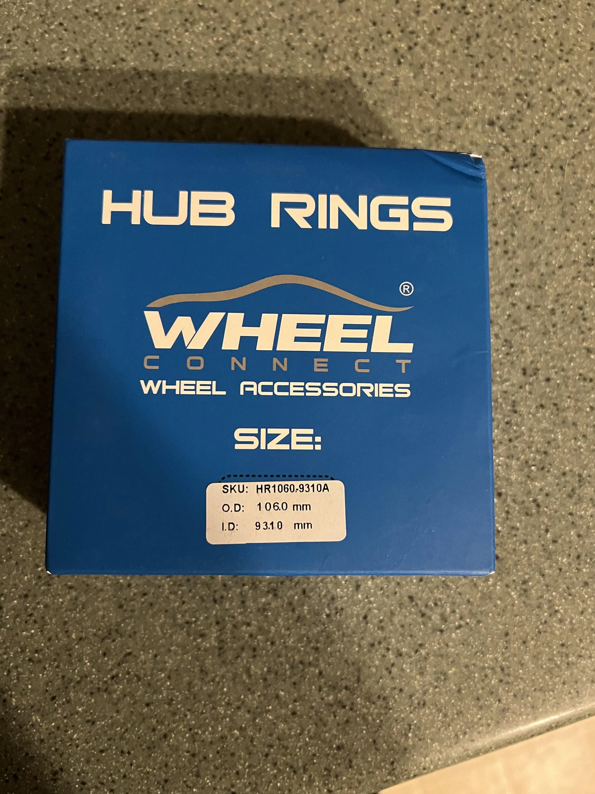

Tacoma has different bore size than Bronco. The wheels will not be hub centric. Have you tried putting them on yet?
I did get these to sort that problem out just worried the 75 is going to be too wide and rub the UCA or something else.

What is the offset on the Taco wheels?
I have 35 x 11.5-17 on my UNLIFTED base suspension Base. They are on a +35 wheel.
In normal driving they do not rub.
If you go full lock and hit some bumps, maybe...
if you full send it over a speed hump, they might rub.
