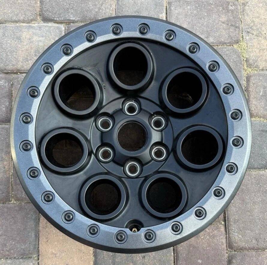

I really love the look of these wheels. I saw them on a Raptor when I was buying my Bronco. I was curious if these would fit a Bronco. I'm just assuming the bolt pattern is the same across Ford trucks/suvs of similar size but I know next to nothing about offset and backspacing or if I'm even using those terms correctly.
Ford Bronco Will Raptor R wheels fit? 1744163080722-vz

Regular Bronco is not the same as Bronco Raptor or F150/Raptor R

Mere mortal Bronco is 6x5.5 lug (or 6x139.7 for metric), Raptors (including Braptor) are 6x135 - -- so no, won't fit without some adapter plate or something.

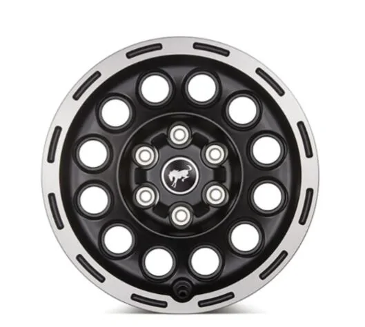

You already got the answer about the differences but you might like these, similar but different and they fit ...
Ford Bronco Will Raptor R wheels fit? Screenshot_20250408-215809
