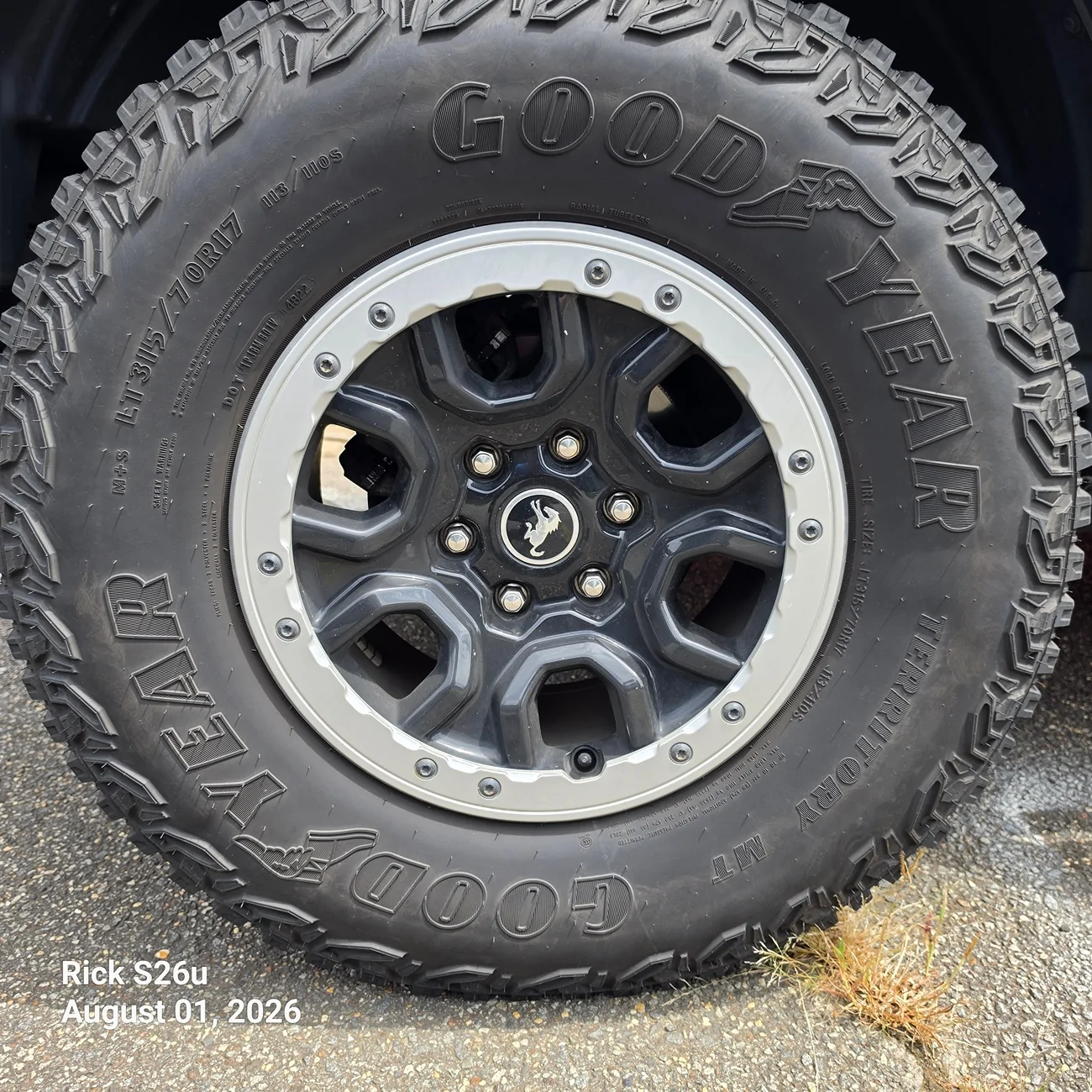

a 25 Big Bend no lift. Will SAS wheel 315/70r17 fit without the truck being lifted (sure ill have to remove crash bars) Also will they mess up speedometer reading? No off-road driving.

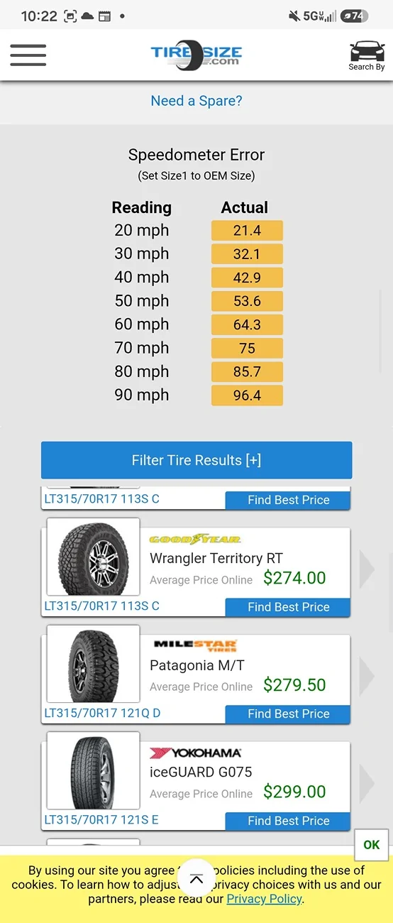

You are going to need to recalibrate the speedo. Like @LI Bronco said remove the crash bars and don’t get crazy in the woods and it won’t rub.

Yes ya can bolt them on and remove the crash bars to avoid them rubbing while turning but the tires will hit the fenders at full compression…I recommend at least a 3/4” body lift…they are also heavier (more unsprung weigh) so they “stress” your stock coilovers more which will adversely effect handling/control…better coilovers are always a good idea…and yes your speedo will be off too….pay to play…party on!
