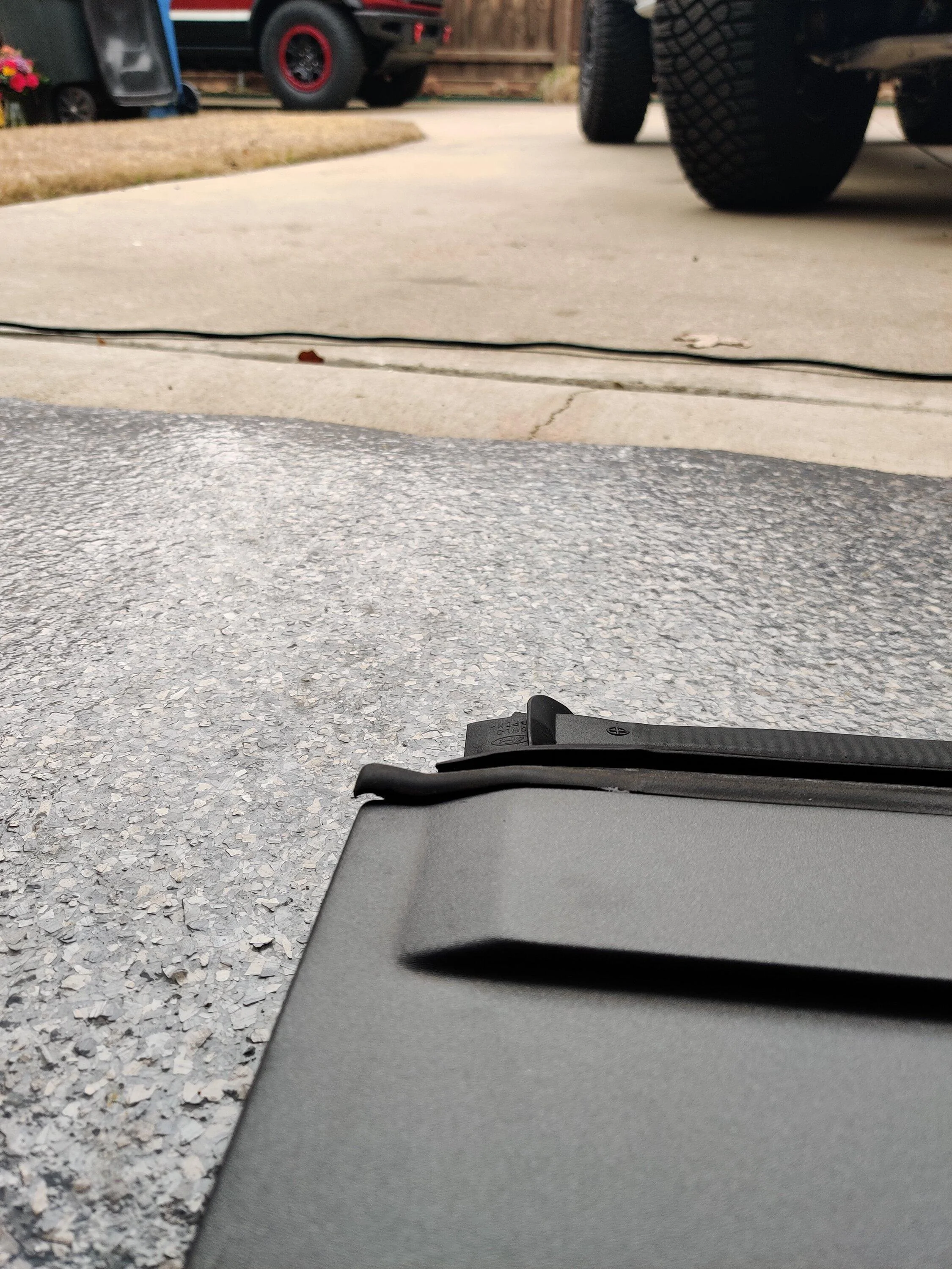

Here is the front passenger weather stripping.
Ford Bronco Wife's '23 WT hardtop doesn't look right IMG_20230225_114842

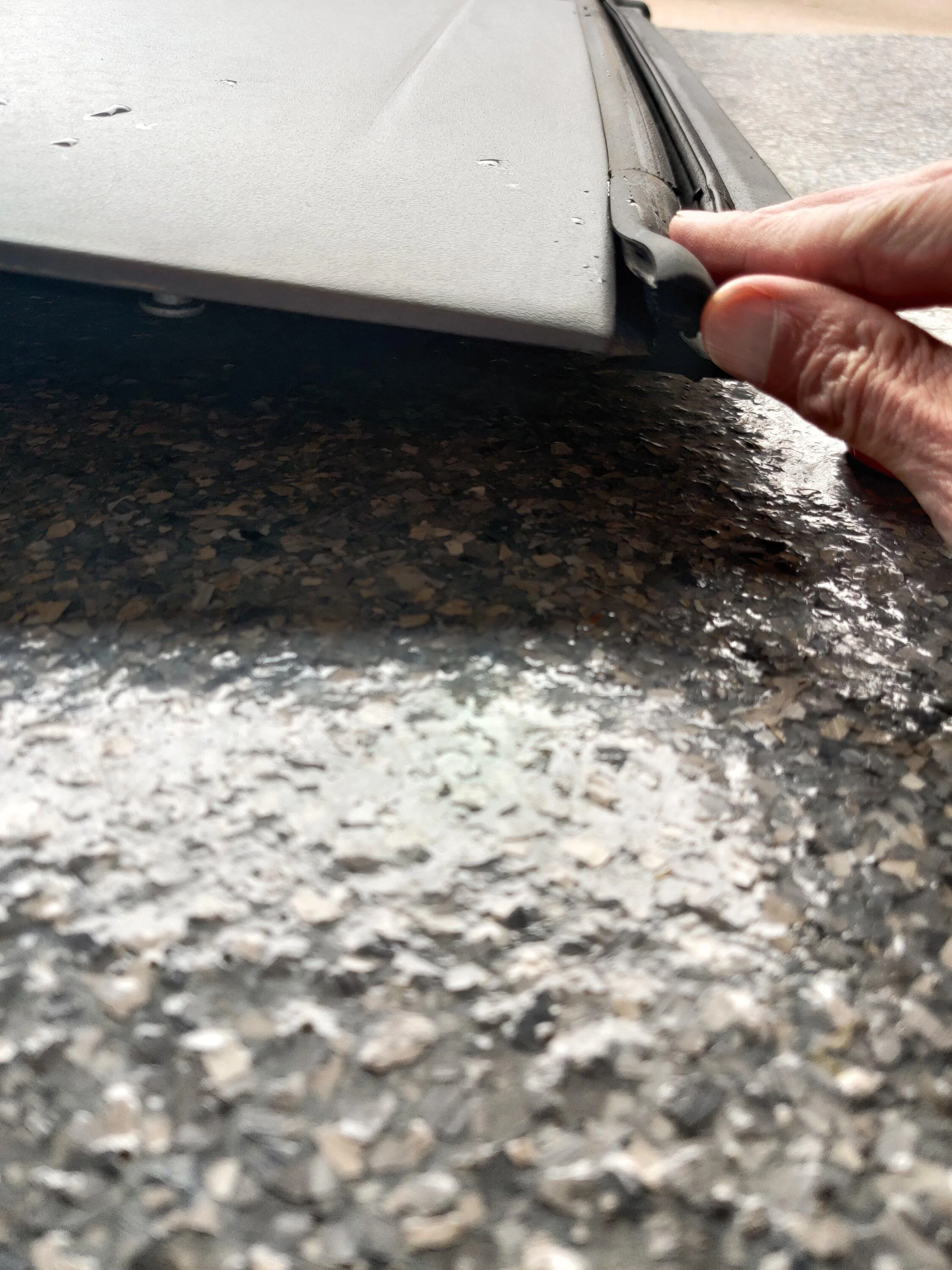

Here is the rear passenger weather stripping
Ford Bronco Wife's '23 WT hardtop doesn't look right IMG_20230225_114533
Both cases seem like they stopped short on the adhesive. Could have the dealership handle it, but afraid they would goop adhesive out the sides, so I might just handle the weather stipping myself and let them handle adjusting the driver side....

That’s how the weather stripping is supposed to be, nothing wrong other than a shitty design lol. Your mid panel will have the same loose edges.

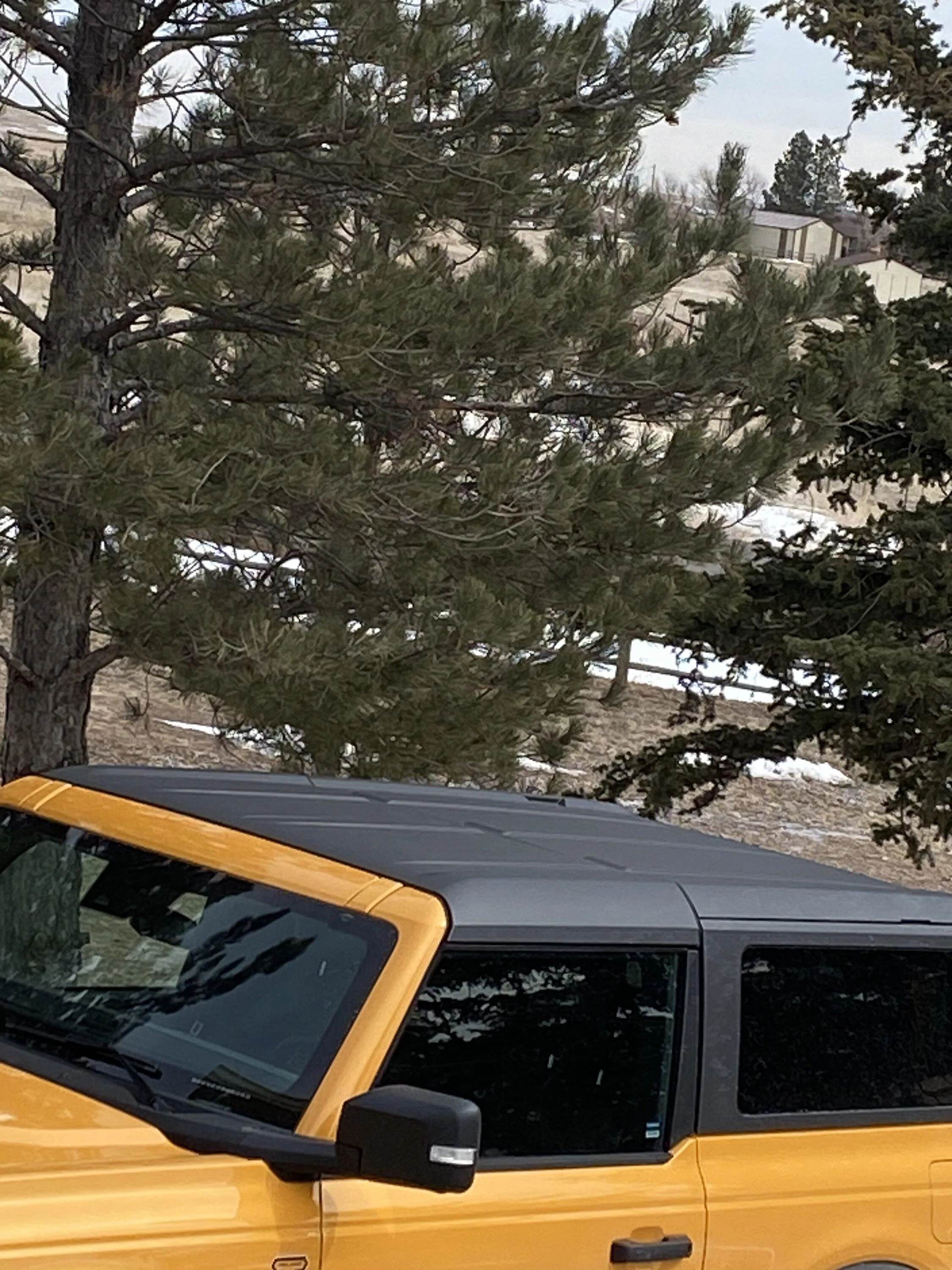

Mine looks even. My guess is your weather stripping isn’t quite even and too much material.

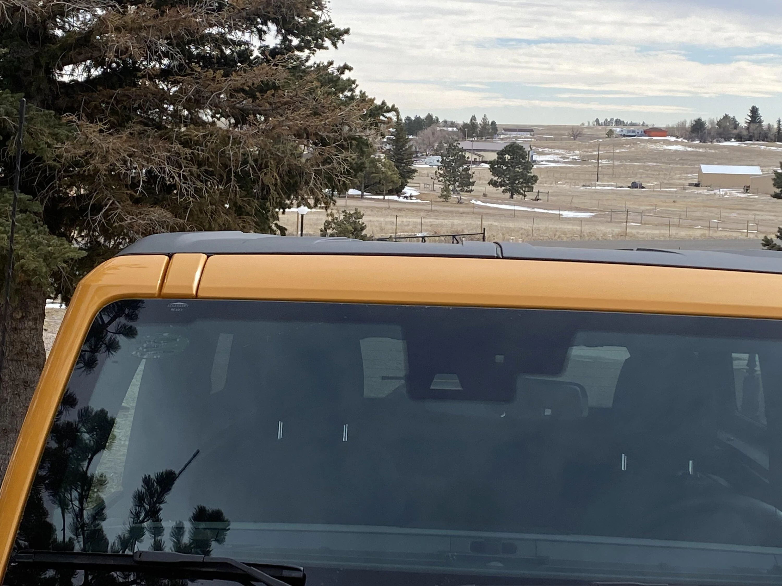

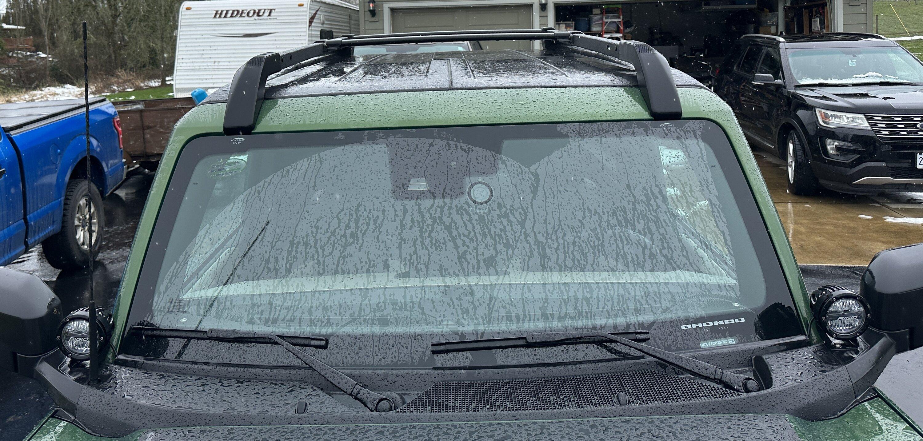

Mine looks good.
Ford Bronco Wife's '23 WT hardtop doesn't look right 8C50AFF8-E5AC-466C-B576-F167AB67ACA8

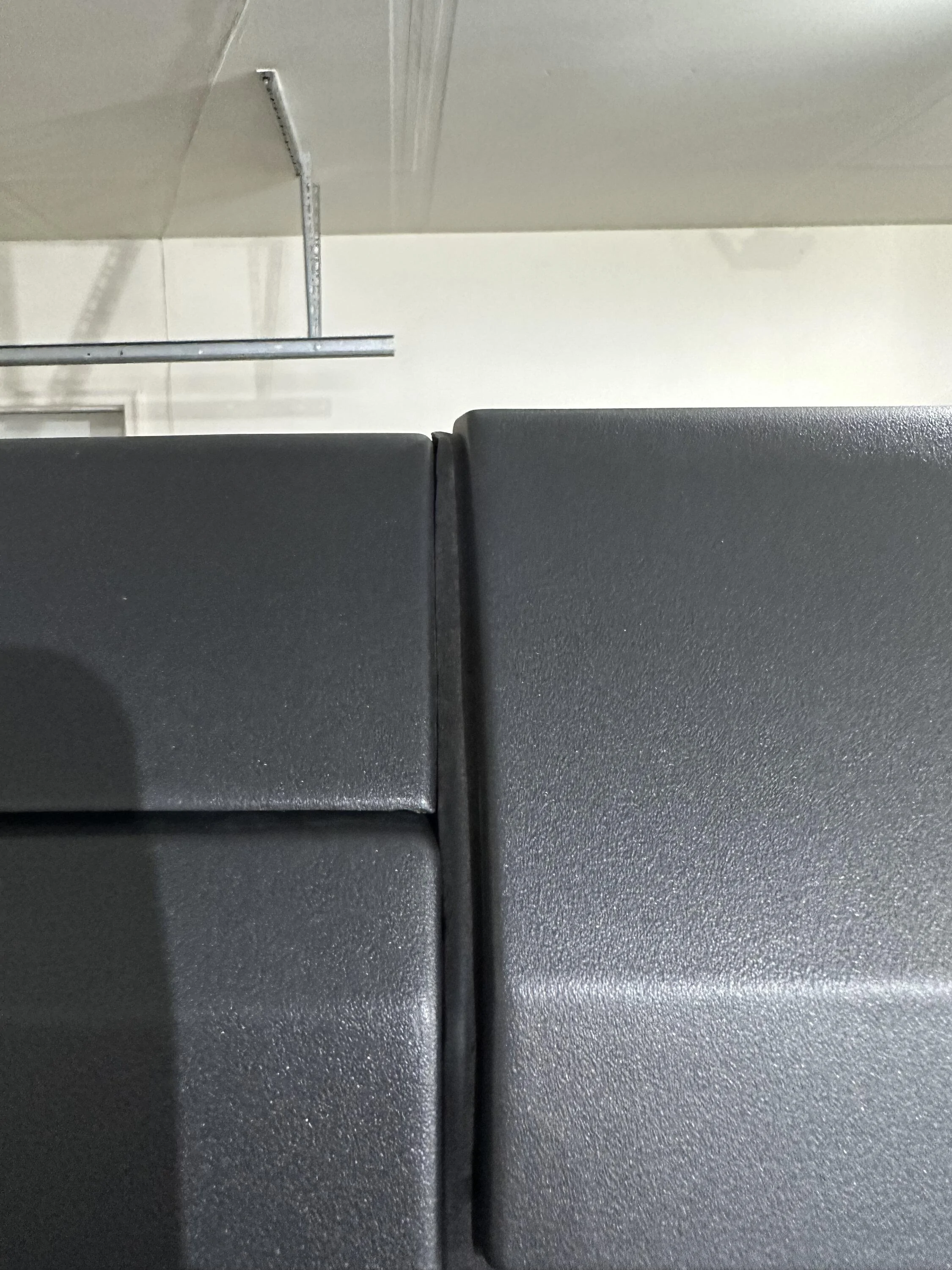

Took mine into the dealership for a few issues, including this.
Before:
Ford Bronco Wife's '23 WT hardtop doesn't look right IMG_20230225_093419755
And after:
Ford Bronco Wife's '23 WT hardtop doesn't look right IMG_20230306_180955906
Ford Bronco Wife's '23 WT hardtop doesn't look right IMG_20230306_180836173
It's hard to tell if it's improved or not. On the short drive home maybe it was a little better. If there's still wind I may try and lower the inner/front driver side one?

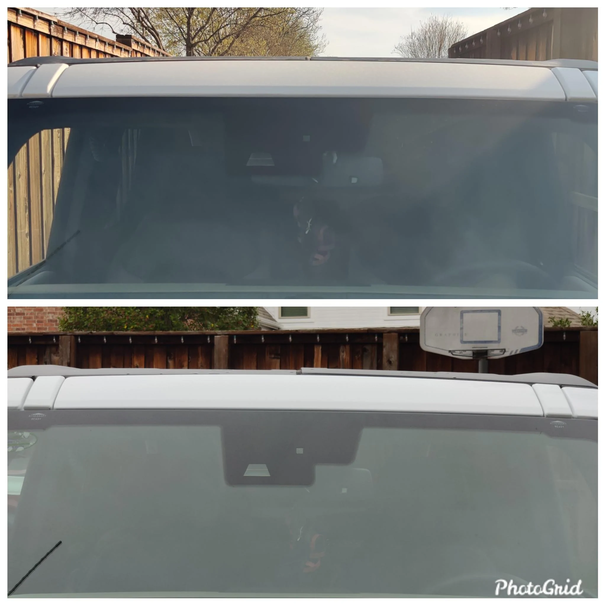

I ended up raising the passenger and lowering the driver to match.
