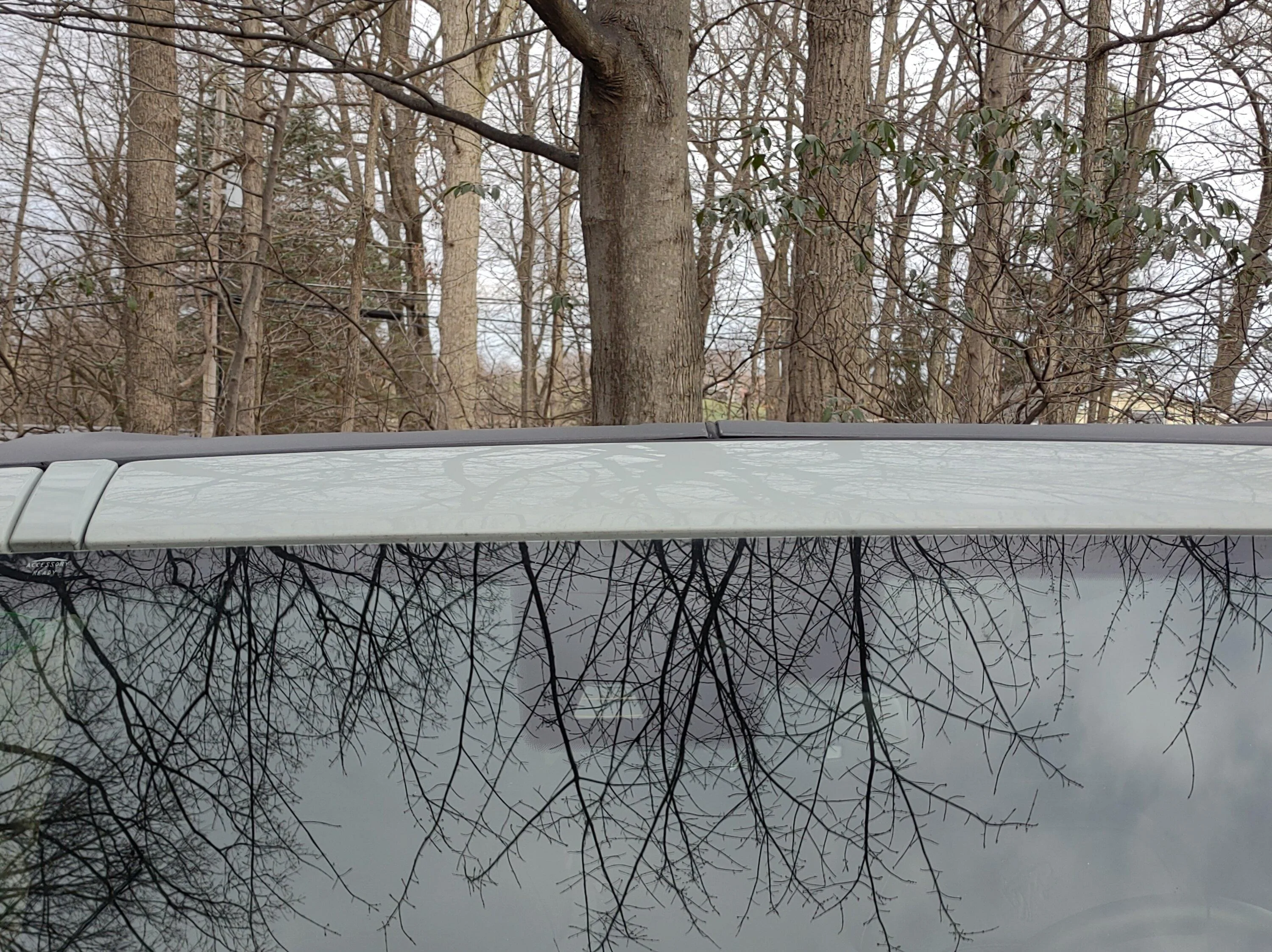

Yeah something definitely is wrong with that D/S panel not sitting right. Looks like the seal is pinched or something. Here is a picture of my panels for reference.

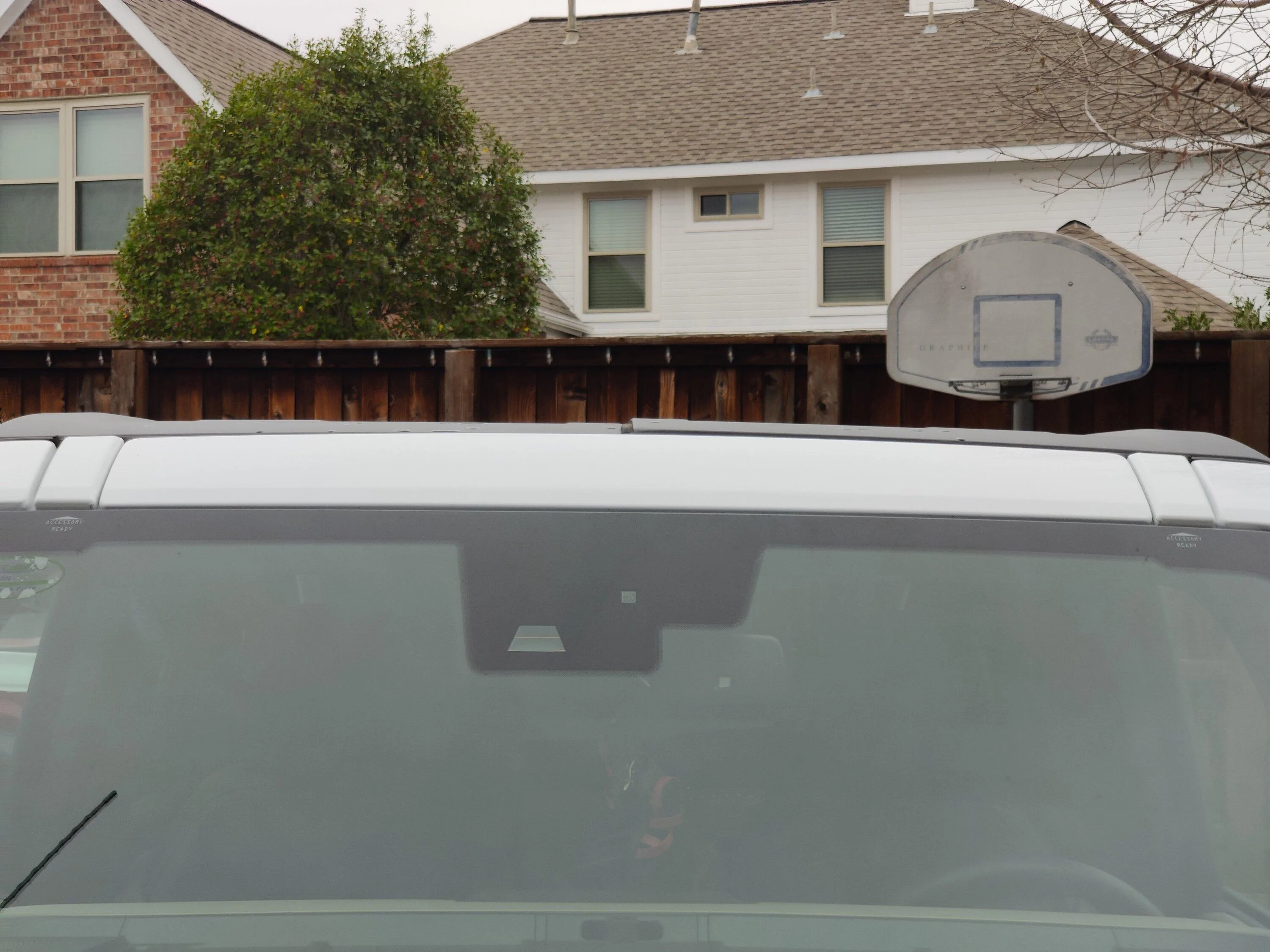

Just took a pick as I see these posts and get anxious.
Bark at Dealer!
Ford Bronco Wife's '23 WT hardtop doesn't look right Bronco-Hardtop-Front

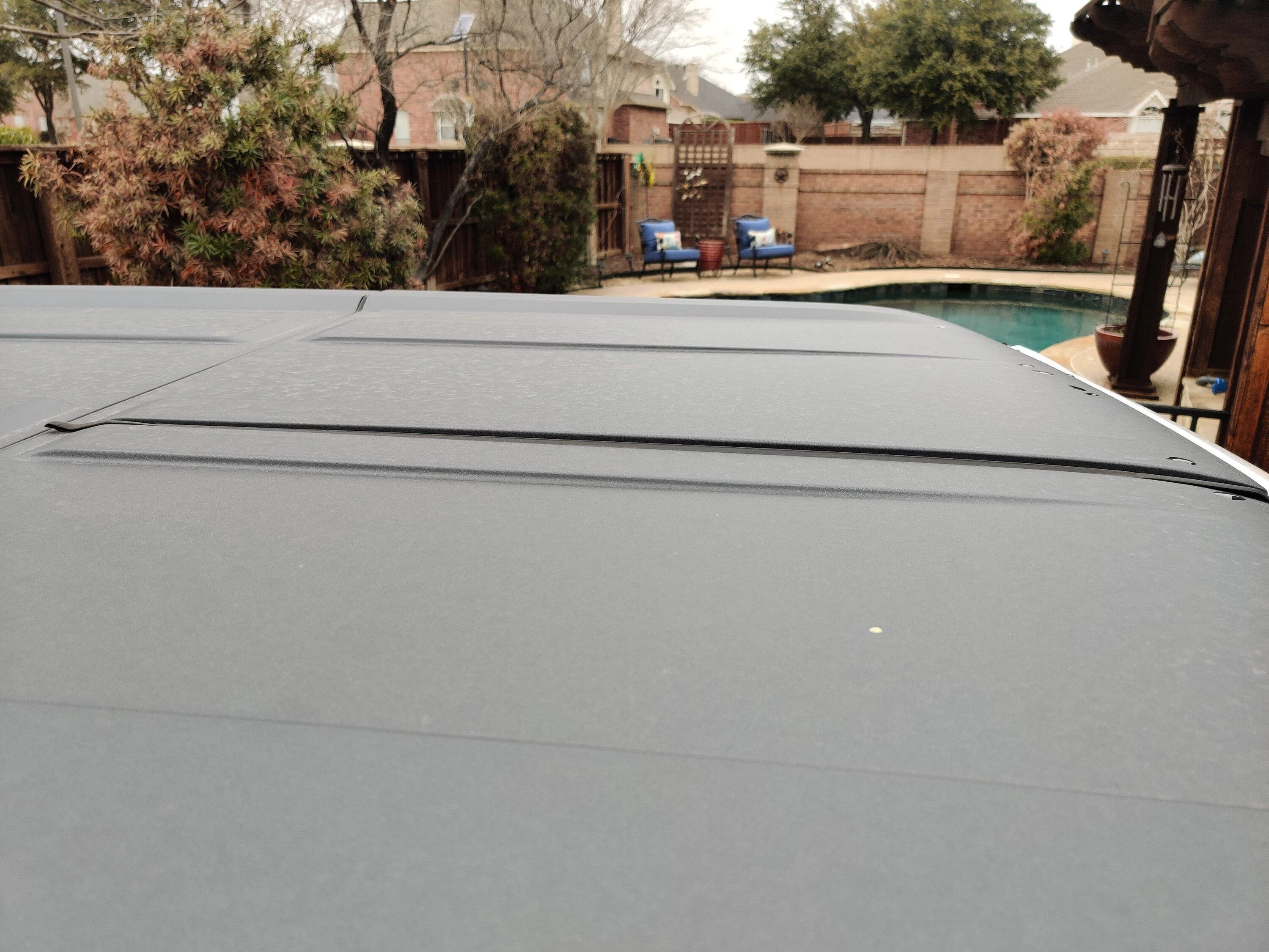

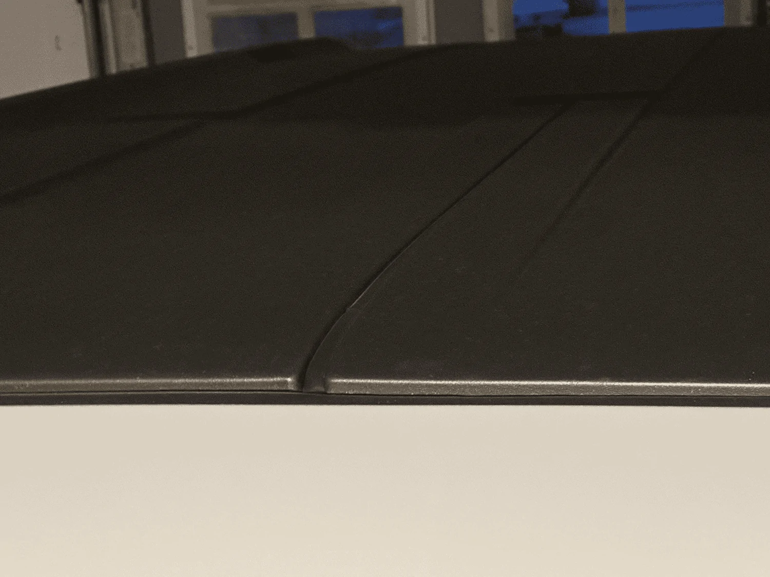

So wife has had her WT for a month now. I cleaned it yesterday after a trip down and back to Houston when I noticed the top didn't look right. Anyone else seen this? As you can see below, the driver portion is higher than the passenger side.
This one is from the passenger side. You can see molding folded towards rear of driver section as well as at the front.
Our other one is a soft top so I'm not familiar with how the hardtop should lay, but pretty sure this isn't correct. I've never taken the top off in the month we've owned it, but wondering if I should check it out or just let the dealership be the first to investigate. Traveling to TN in 3 weeks so hopefully this won't be an issue...

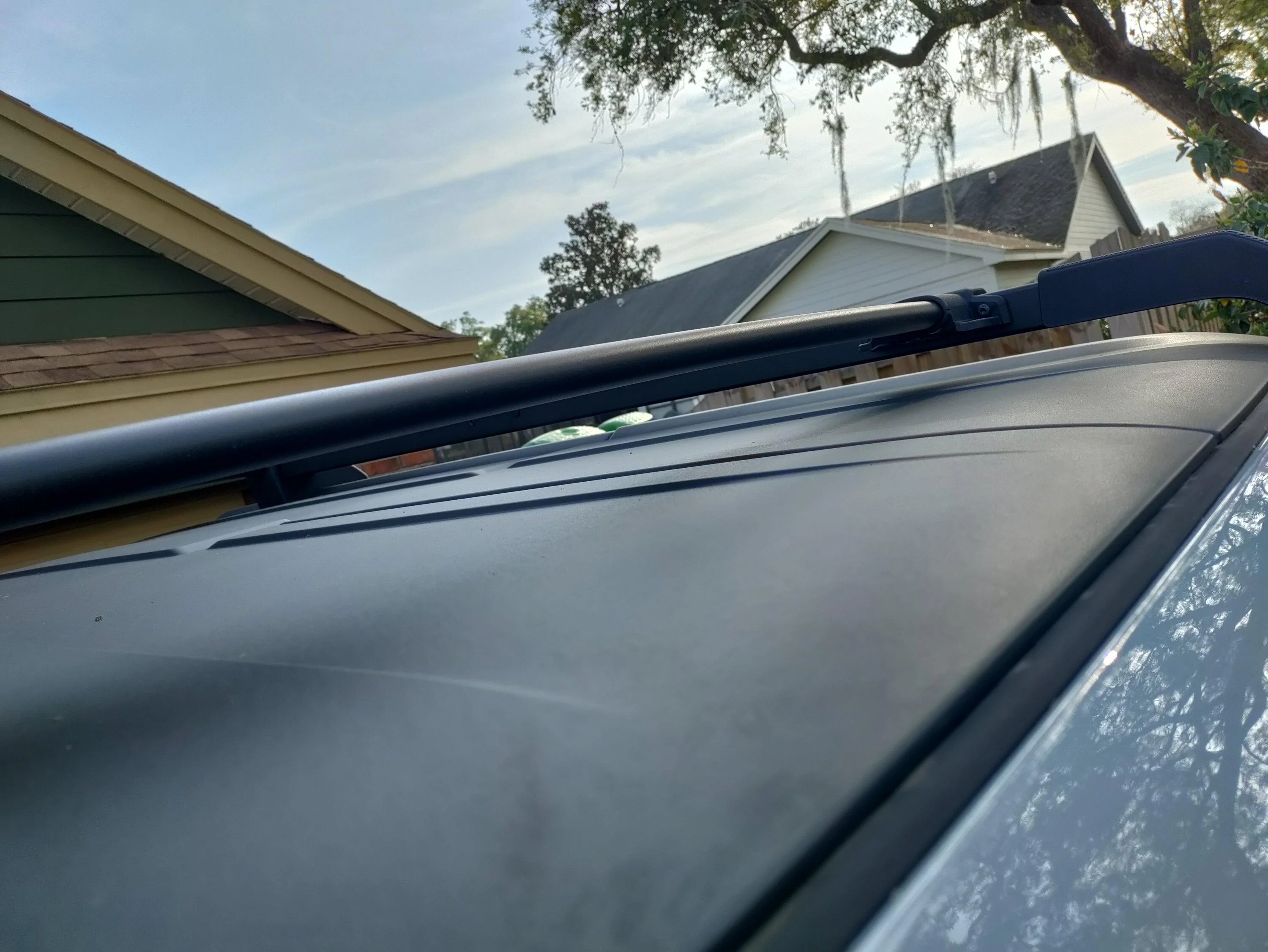

Ford Bronco Wife's '23 WT hardtop doesn't look right IMG_20230225_093419755
Here's my "before".
