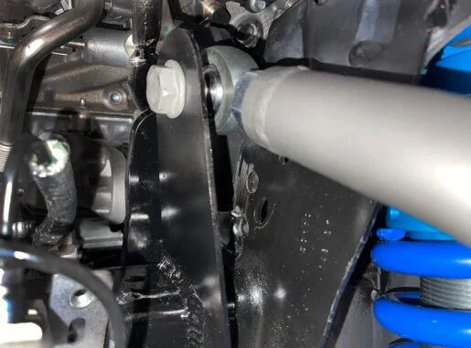

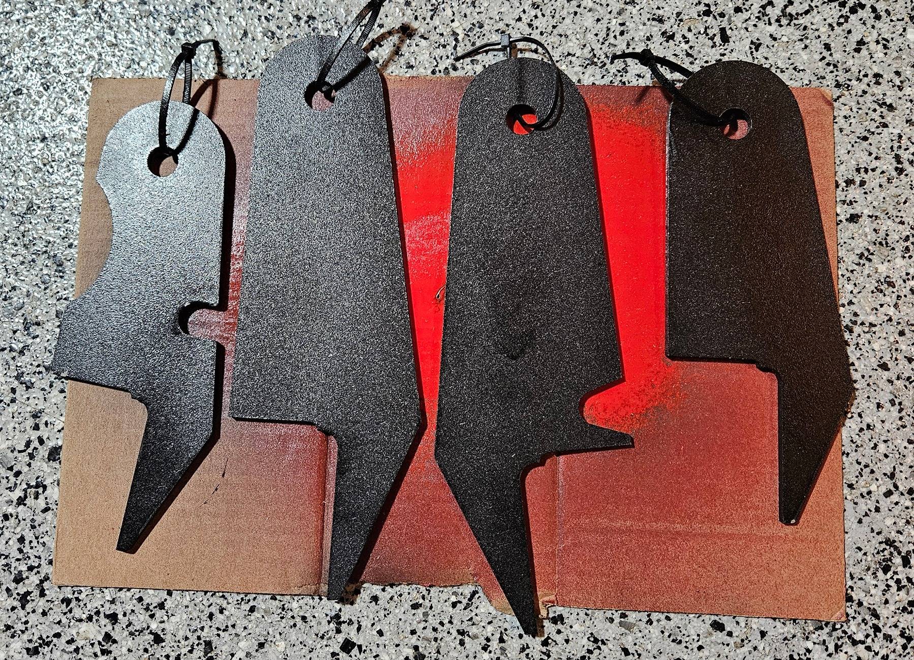

Yeah, I was thinking that as well. Once I get everything installed I'll fit the plates up, can't visualize the placement....
Brackets
Ford Bronco Wicked LT 3.5 Mid Travel Package - Install ? 20241123_210408
Rear - spacers are going on until an axle upgrade.

Definitely UCA double sheer brackets.
