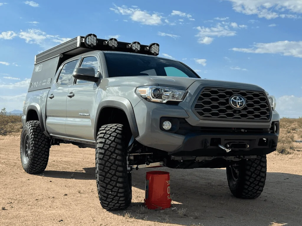

There are these new things (to recreational off roading) that will become more popular once they're more affordable called portals. I call them axle lifts; they use a gear set at each hub to move the axle up and give pure clearance. So you get 3.5-6" (depending on vendor) of actual clearance, which is different from suspension lifting (the body).
They're probably more than you want to pay, and it's early days, but check out this photo. That's an axle lift with probably 15-17" of pure clearance. My BL Sas has around 11". With portals and 38s, I would expect around 16" of clearance. That goes over big ass rocks. That is clearance. And since it lifts the axle, you get pure clearance and matching actual clearance.

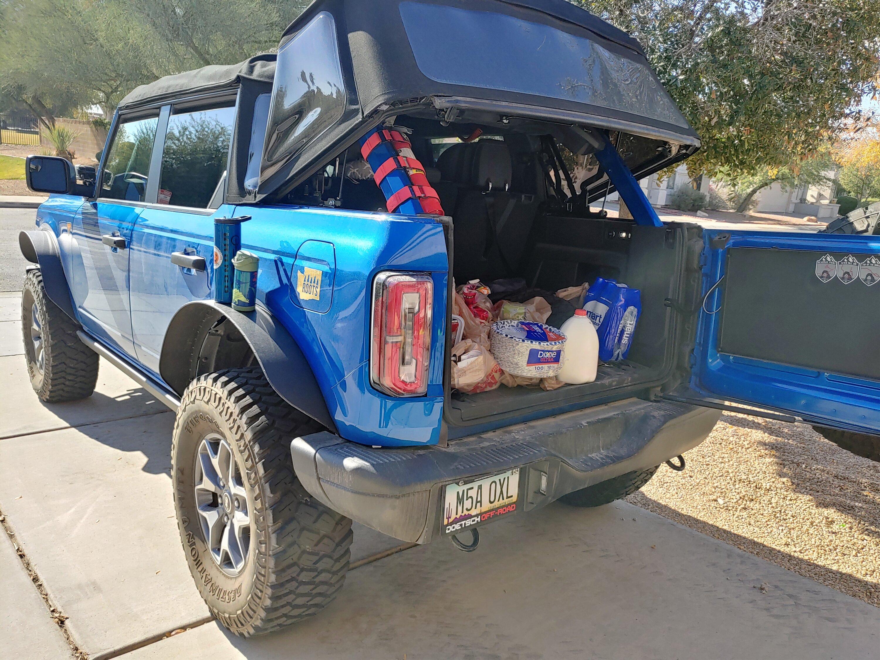

Some of those curbs around grocery stores are a doozy.
I wanted a little more ground clearance, pick that fat belly up a bit. And yeah, it does look cool.
For what it's worth, I didnt break the bank to boost it up. Used a mild spacer lift to achieve roughly the same result.
