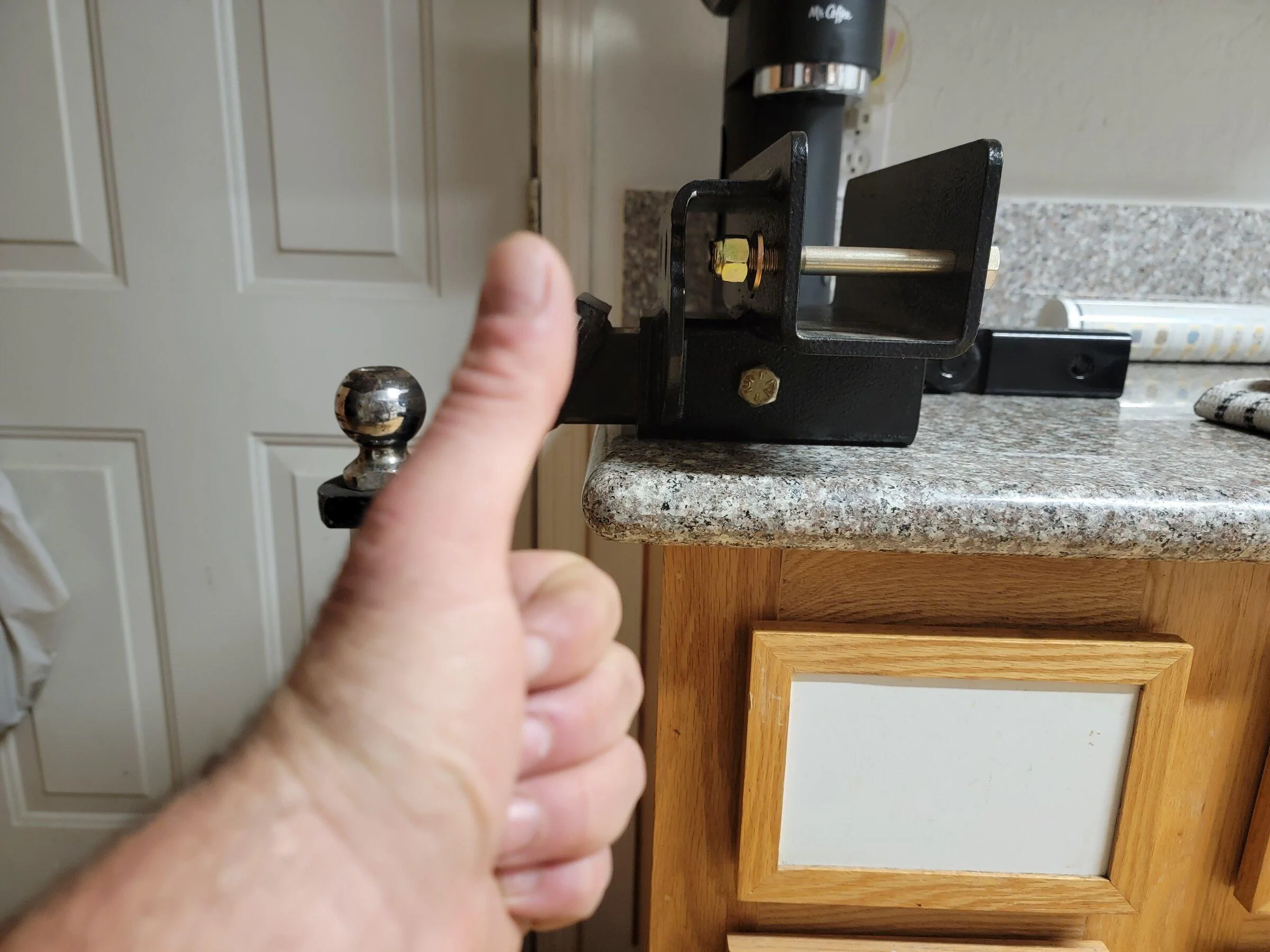

Here's where my hitch hits plastic

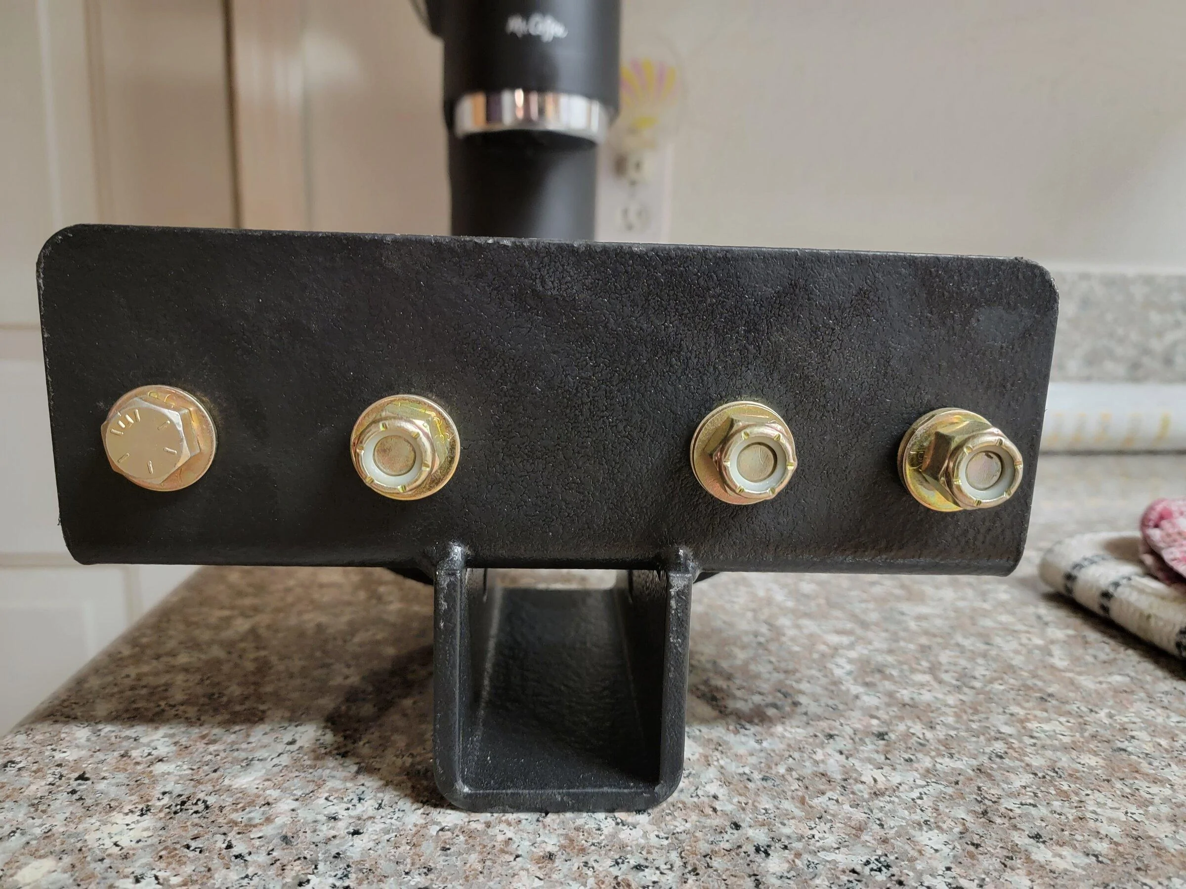

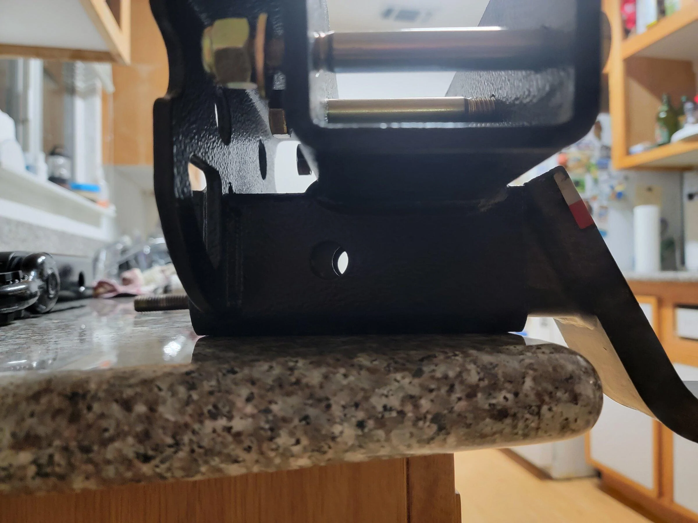

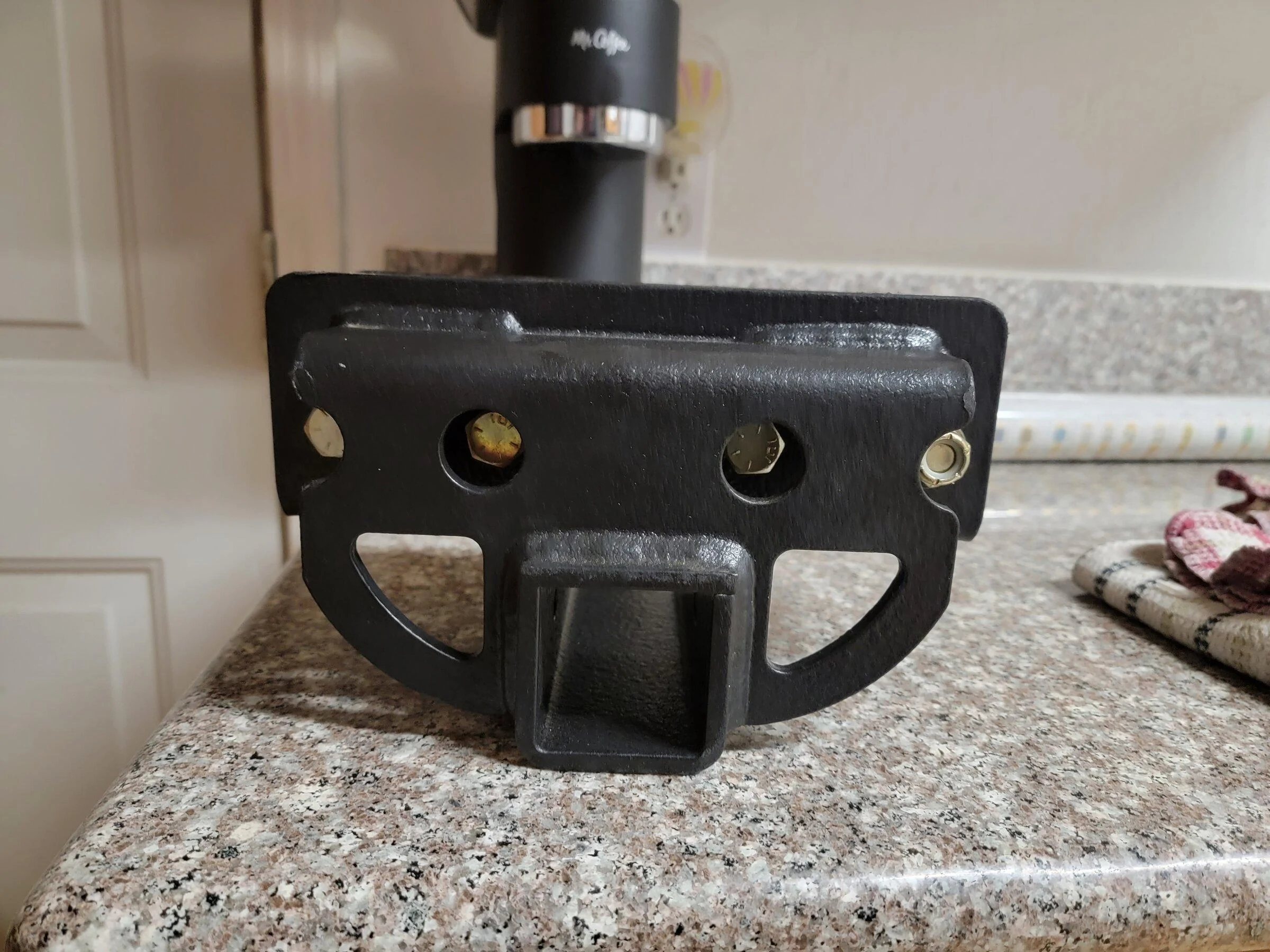

That's not the only problem I encountered though.
With the 2 middle bolts in and not tightened there is no way to get the outers in. Holes are way off.
At least they are equally off 🤷‍♂️😄
That is installed backwards . Turn it around the other way the holes are offset on the frame. They should line right up once turned around to the correct orientation.
Dirtyjed
Sep 30, 2020
224
333
Orangevale
05 Dmax, 86 FunRunnah, Tiyoda truggy, Honda shi
So this is the side thar faces outward?
Ford Bronco Who Is BAMF? 20220122_200046
And this faces towards exhaust?
Ford Bronco Who Is BAMF? 20220122_200103
Edit: If I try to install it the opposite way I did before the holes for actual receiver don't line up with a standard ball hitch.
Ih
Ford Bronco Who Is BAMF? 20220122_202451
How I originally had it on truck works though.
Ford Bronco Who Is BAMF? 20220122_202632
Ih
Now that's not right! The hitch pin holes should be other way. I can see why you would try to install it the other way after installing putting a hitch in the receiver.
We have been using that receiver plate for a few years in our rear bumpers and that is the opposite orientation then our bumpers. Not allowing the pin to reach unless its a 8.5" HD hitch or longer "I just confirmed" on one of our bumpers. That's a design flaw on my end the lower plate should be flipped bringing the hole closer to the back.
We want them to be usable even with the light weight short shank class 2 hitches and bike racks so I'll be replacing all the hitches that were shipped out next week.
Thankfully only a few dozen have been shipped and you are the only person that's actually tried a standard length shank in the receiver so far. We have hundreds ready to assemble so getting replacements out with the pin hole in the correct location next week will be simple.
The hitch you have now will work with extended 8.5" or larger hitches. it's yours to do what you please as you will be receiving a complete replacement.
Find a buddy to sell/give it to that's willing to drill a new hole or buy an extended hitch and they can use it. It's still a perfectly usable hitch they just need a longer shank to reach the pin hole.
