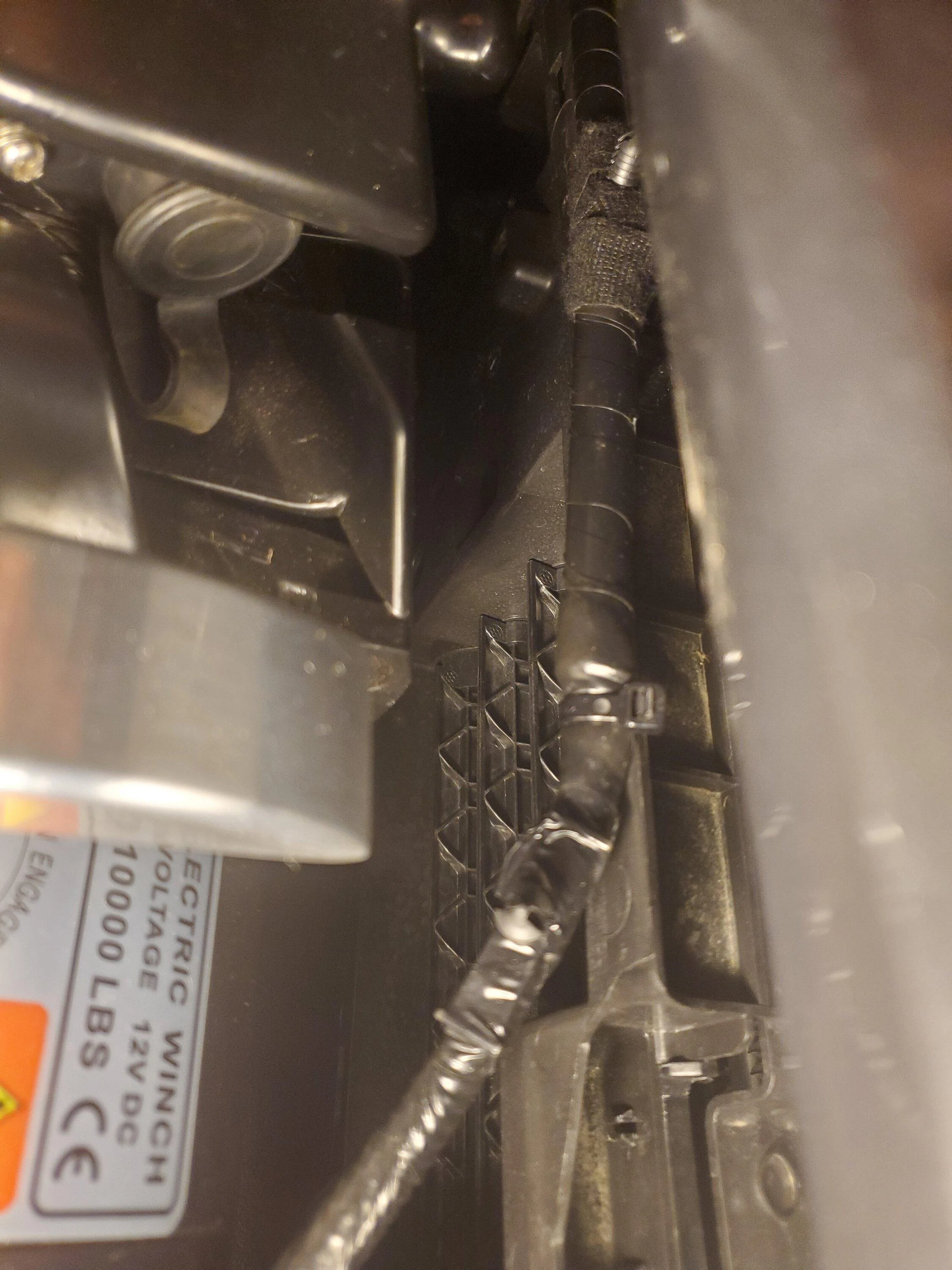

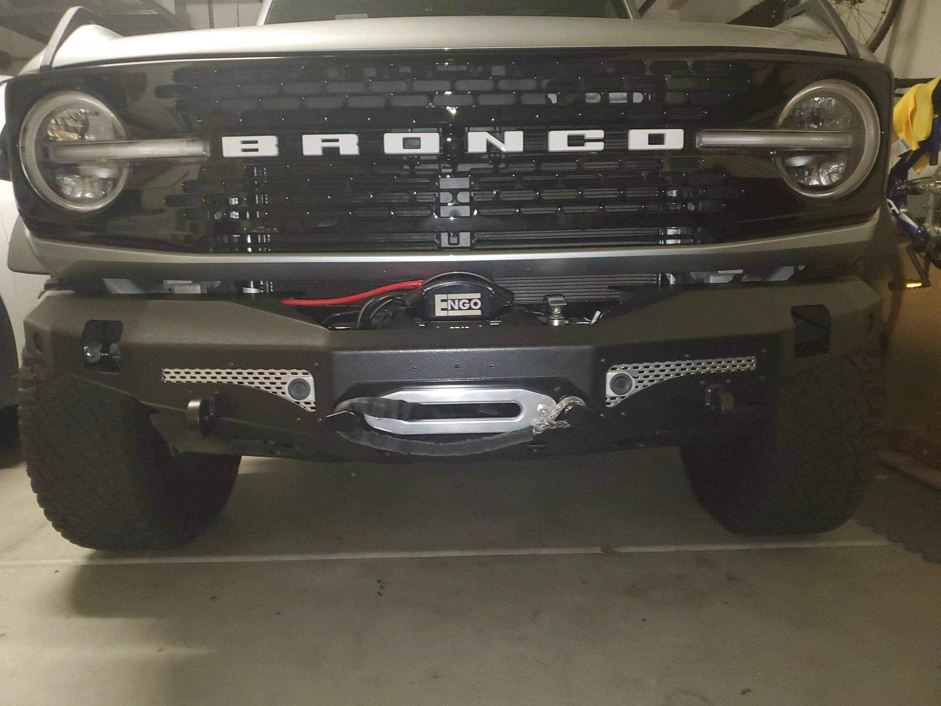

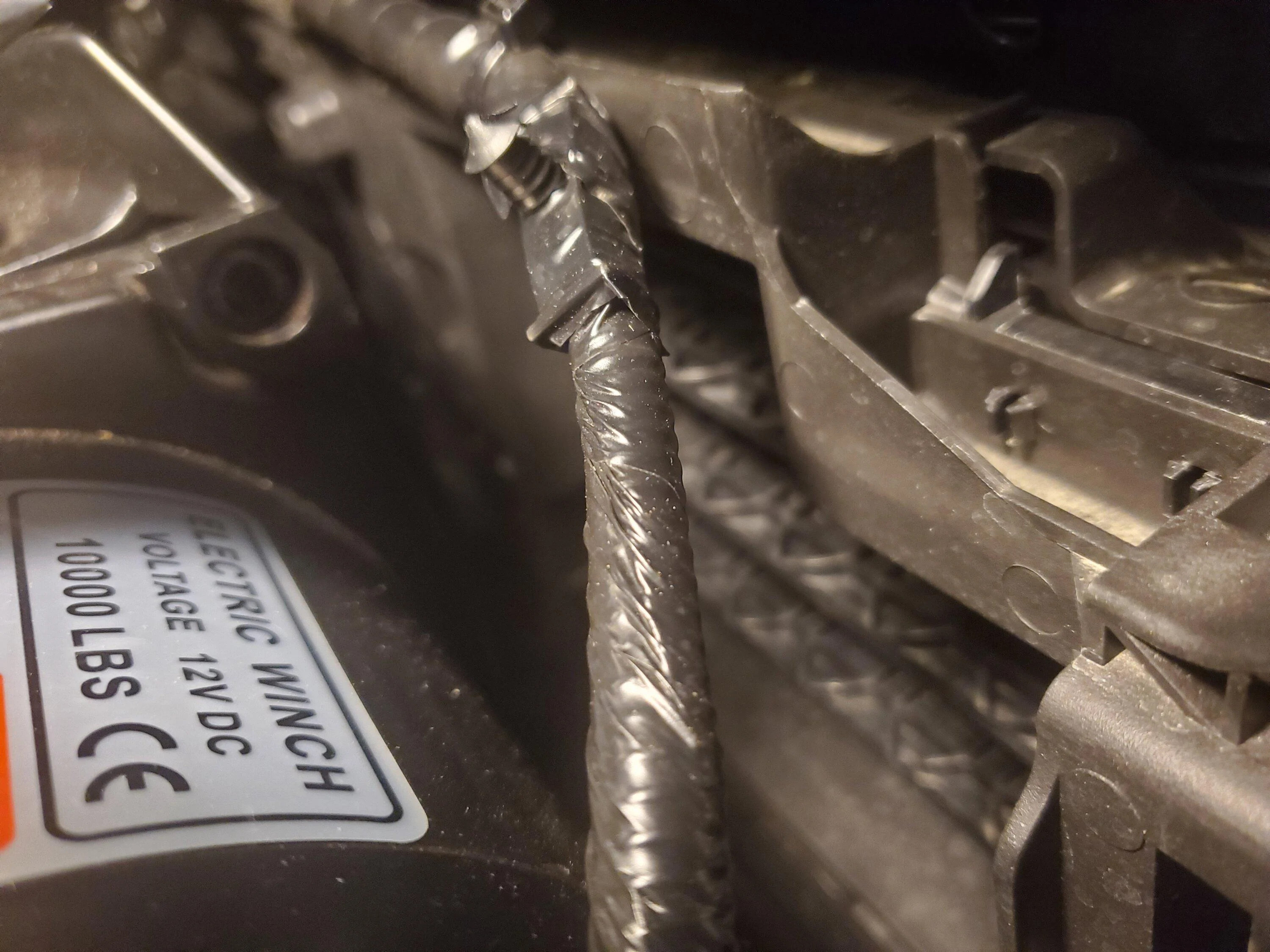

I was able to install my BAMF overland bumper on my 2022 wildtrak (high package).
Installing the actual bumper wasn't to bad. I used ratchet straps to tie it to my floor jack, slowly lifted it to the right height to align the 3 holes and installed the 6 bolts.

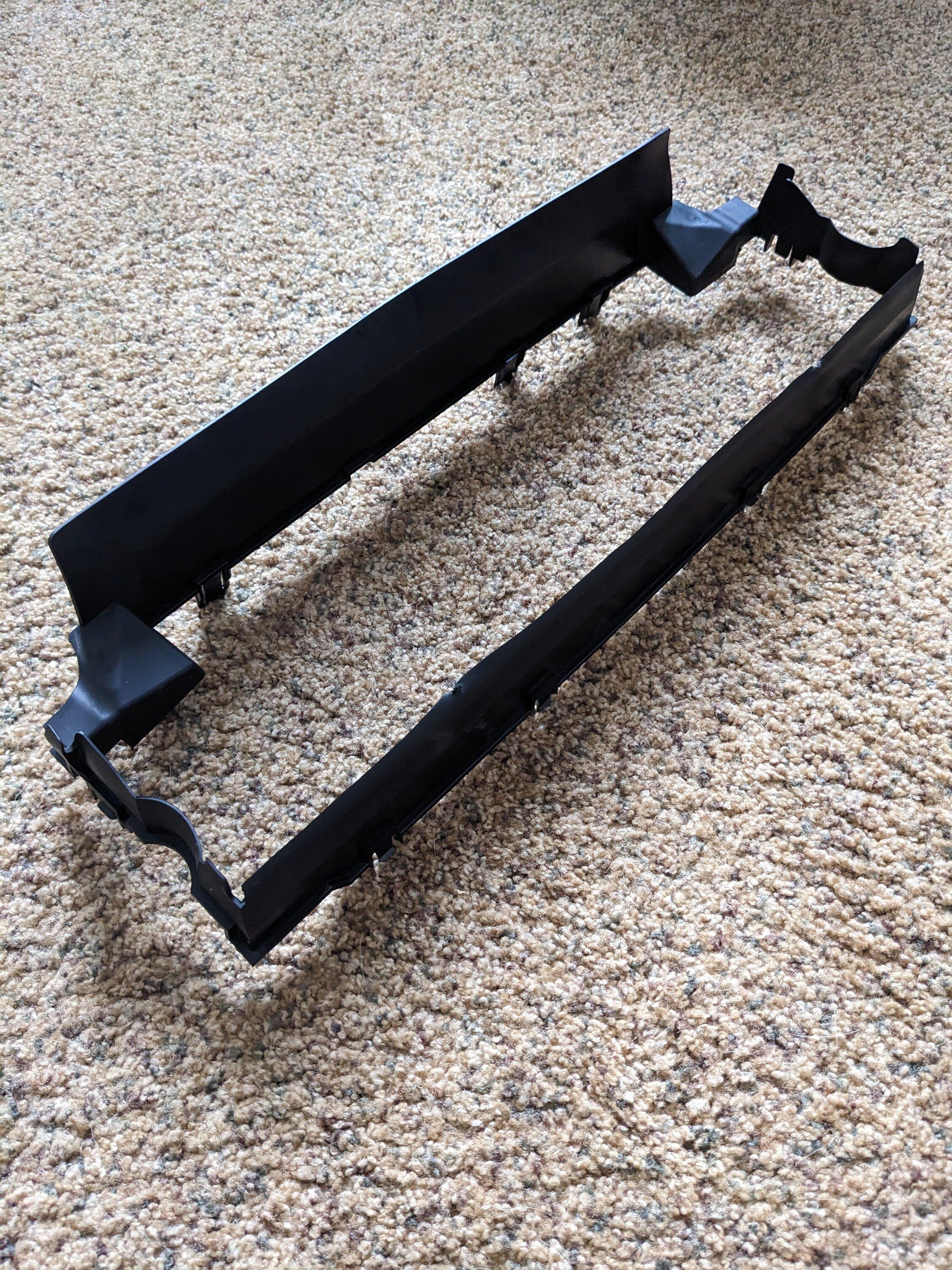

I left my grill shutters (because unplugging them can cause CELs), however I had to remove the cover for the ACC for winch clearance along with the rectangle rubber seal frame. (I don't have ACC so the cover was empty)

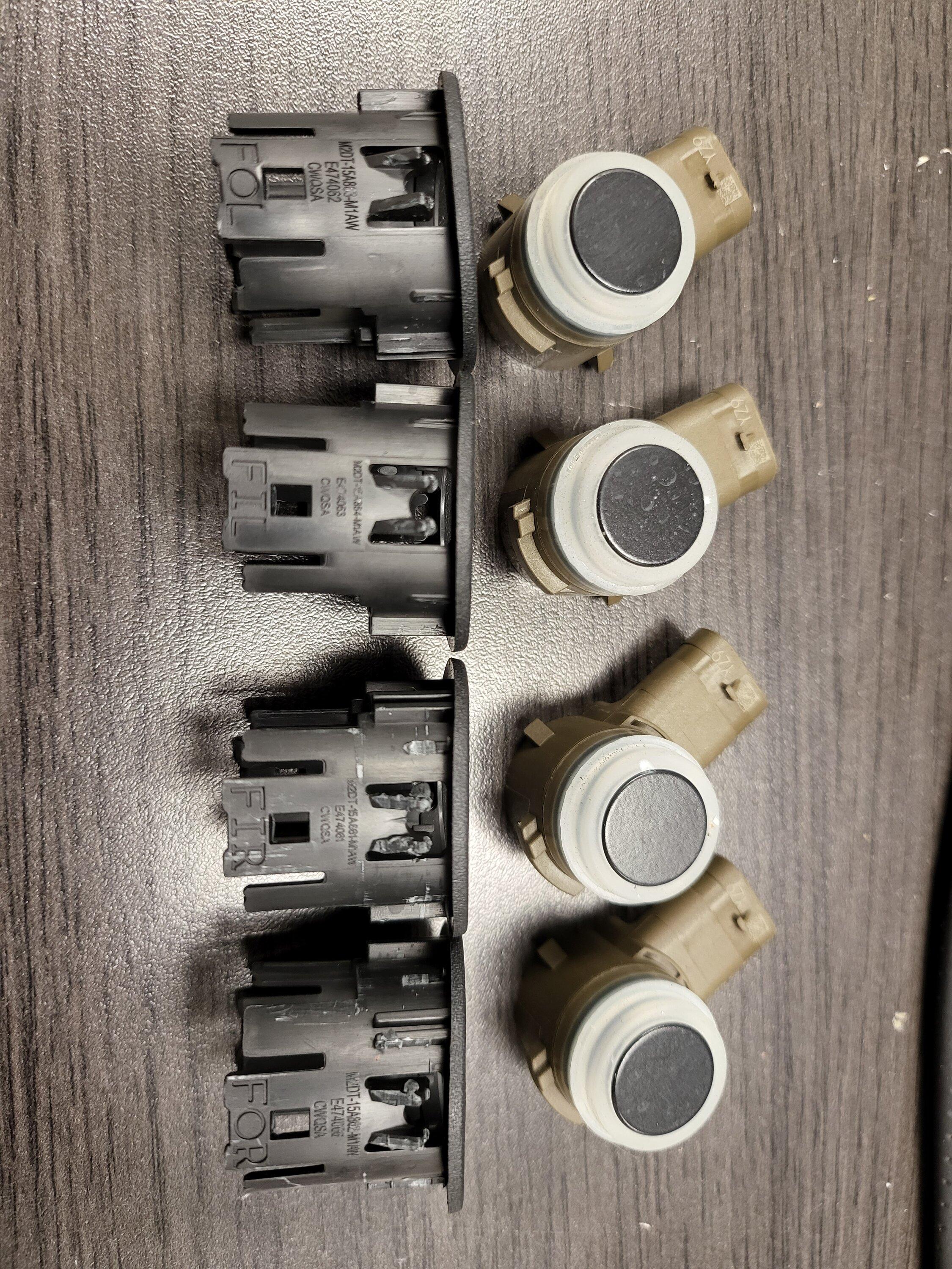

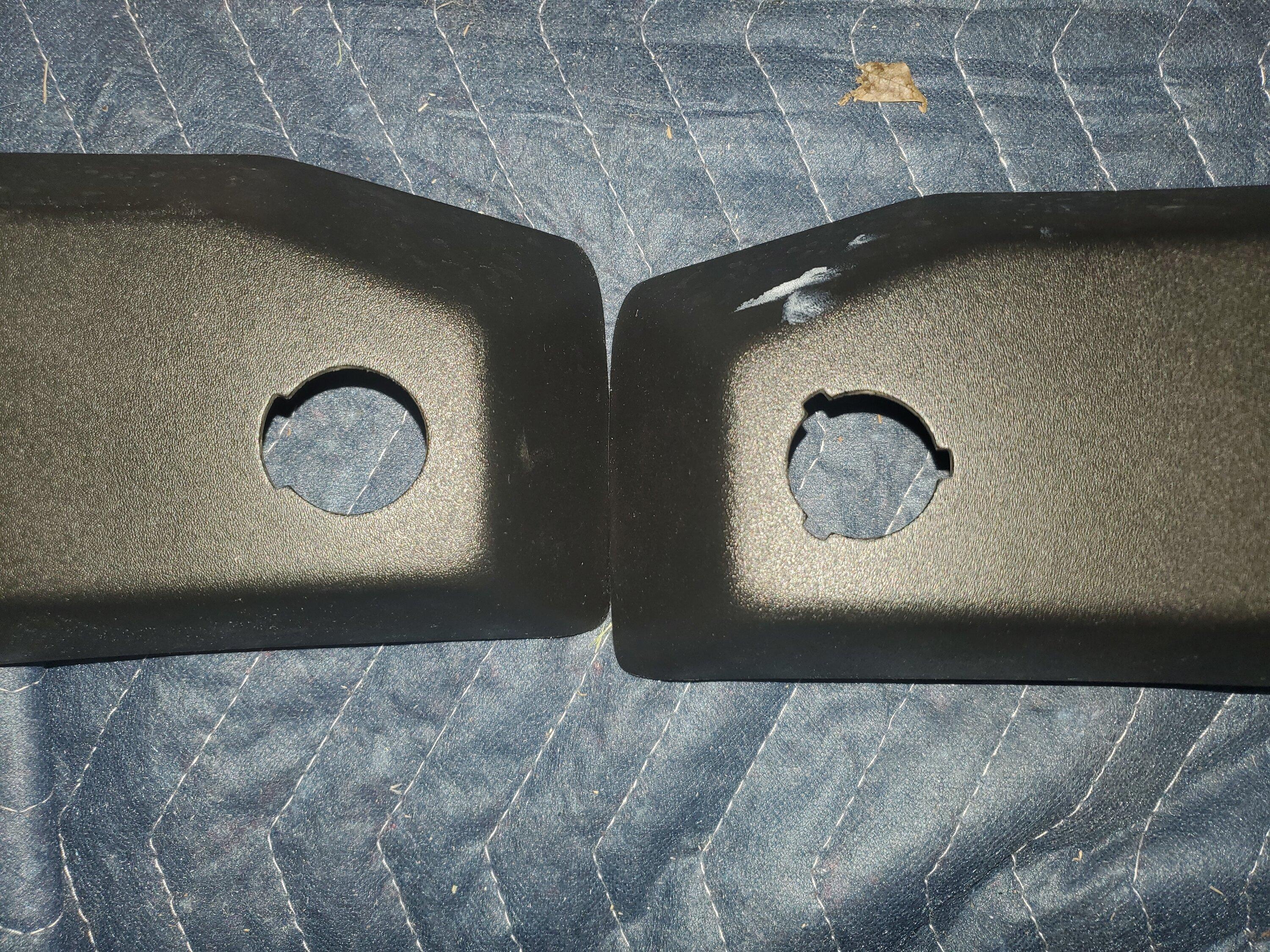

Where the real grief came into play was transferring over the 4 Forward sensors. Something was definitely wrong... Don't know if Ford change the design on BAMF or not but I basically had to sand down most "fins" on each and every sensor grommet for to fit inside the bumper holes. Each hole the bumper has contains three little cutouts that I suspect were supposed to be for alignment. However they did not come even close to what the sensor grommets needed. If you compare the hole patterns in the original bumper (And each one is actually different) to those in the BAMF, not the same.
In addition, I marked every single grommet and sensor at the top before taking it out of my original bumper so I knew The orientation and the order of each. In doing so, the two inner sensors (The ones that go into the grill inserts) had to be reversed. If you install them in the same orientation in the same position as the factory bumper, due to the angle of the grill insert, you would not be able to plug in the electrical connector.
Had it not been on a Sunday, I would have called BAMF (maybe even drove down there) to show them.
Honestly I was a bit pissed, and partially expecting the Bronco to complain the sensors were all out of whack, But I took it for a test drive and they still seem to be working and nothing complained.

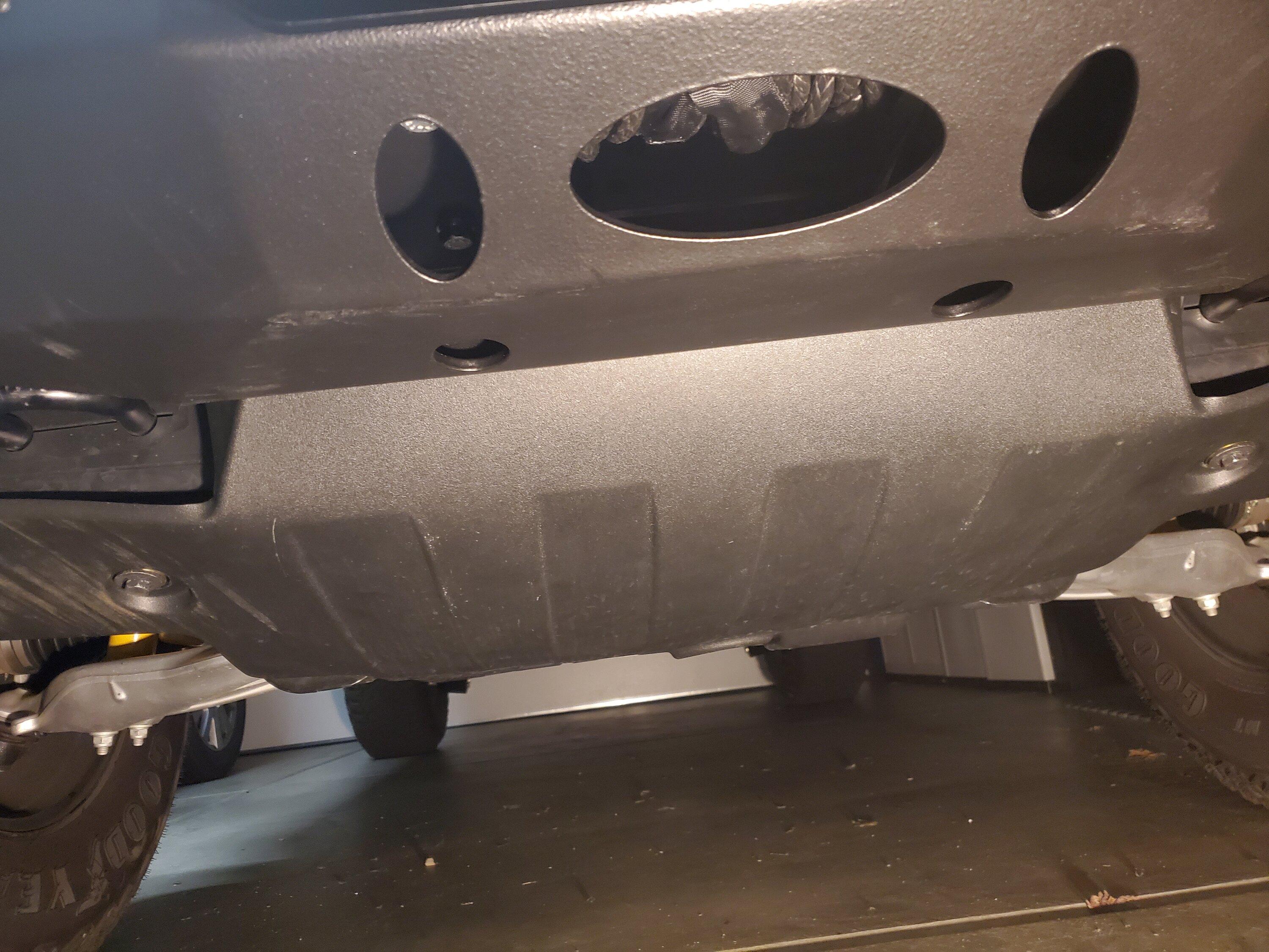

Oh..and I have a new front skid plate to install later, so for the time being I decided just to shove the original plastic one back in place.. and actually fit! The two bolt holes at the bumper will not line up because you can't slide the skid plate fully forward due to it hitting the BAMF bumper, however the two back bolts, and the two middle bolts with a little prying, will align. It's under such pressure that it's not going anywhere missing those two front bolts.

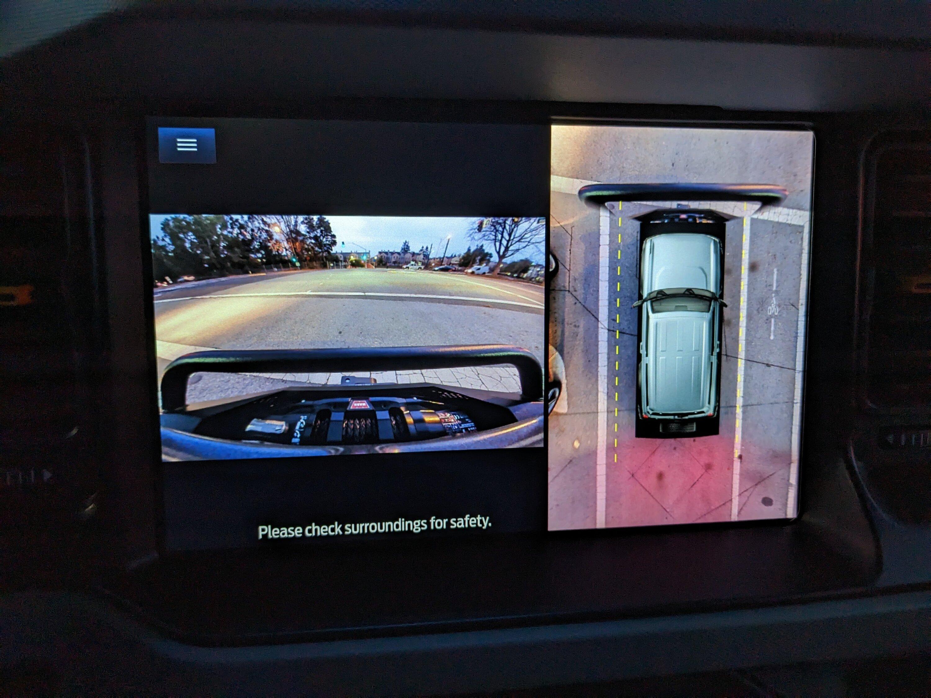

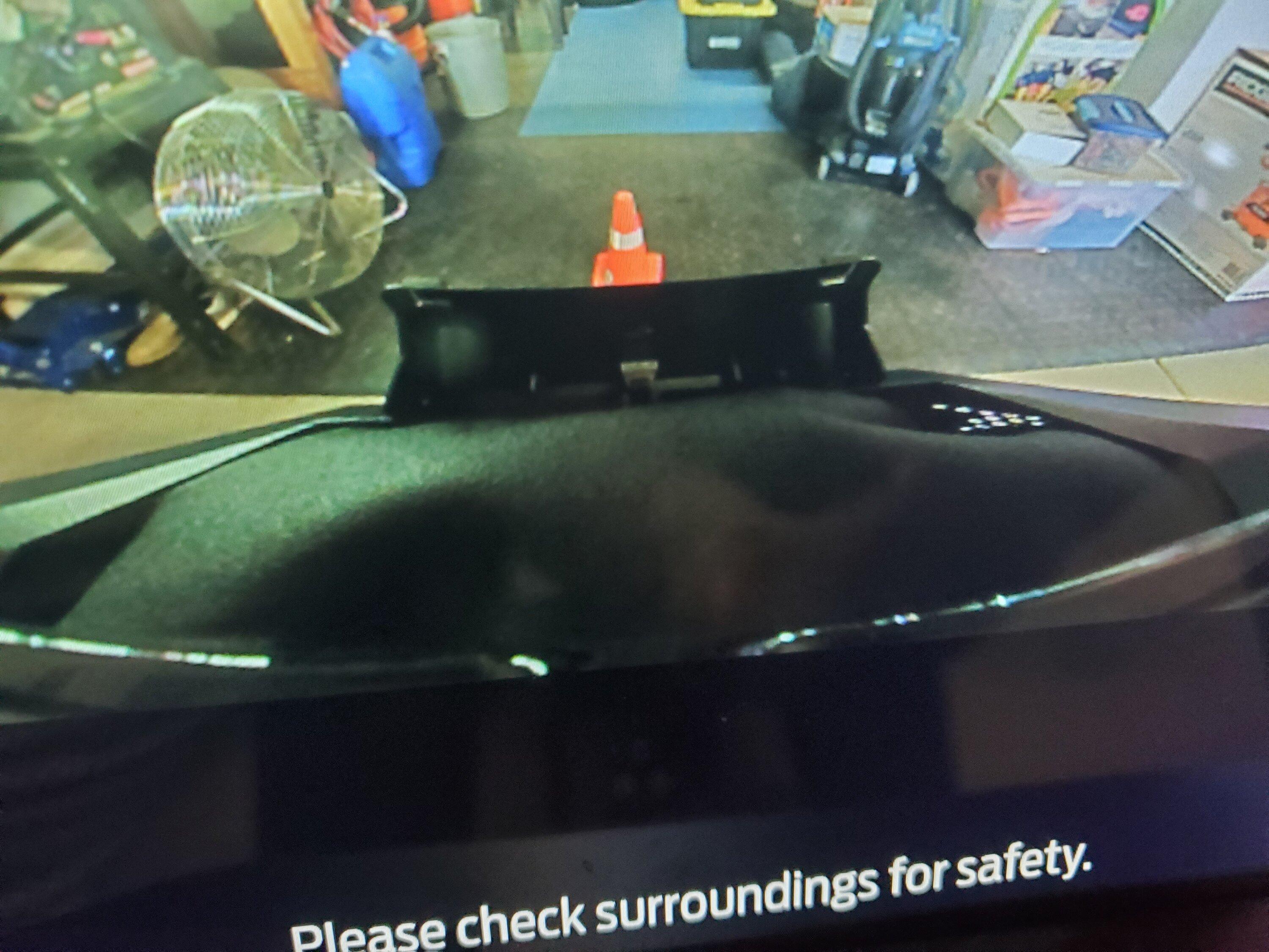

Oh one more thing... The thing that makes this bumper all worth it...it barely affects the front camera. I can barely see the winch, and my 360 view still works almost identically.
The parking sensor holes are cut for these grommets.
the grommets with the large indexing tabs would need to be shaved they still clip in place and hold better than rubber grommets . Or these could be ordered from FORD and the factory grommets can be left in the factory bumper.
Ford Bronco BAMF Overland front winch bumper 20220208_100848
A lot of bumpers on the market just have you use rubber like this that doesn't really hold well
We opted for making the cut outs a prefect fit for the
multi slot grommets found in all but the base bumper. You are the second person that has had these other grommets that we know of.

Don't get me wrong... I love the bumper, extremely happy that it doesn't really mess with the camera.

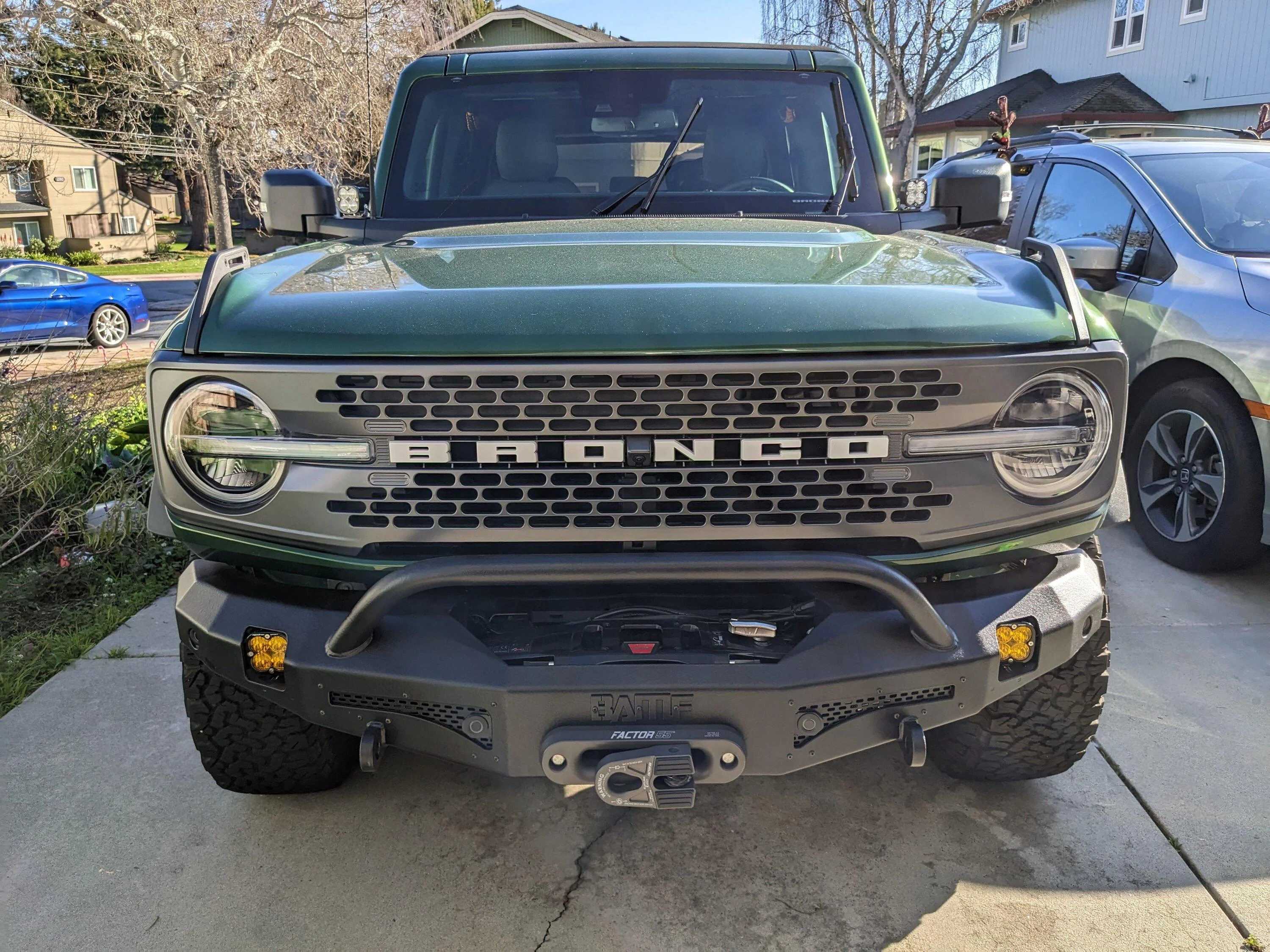

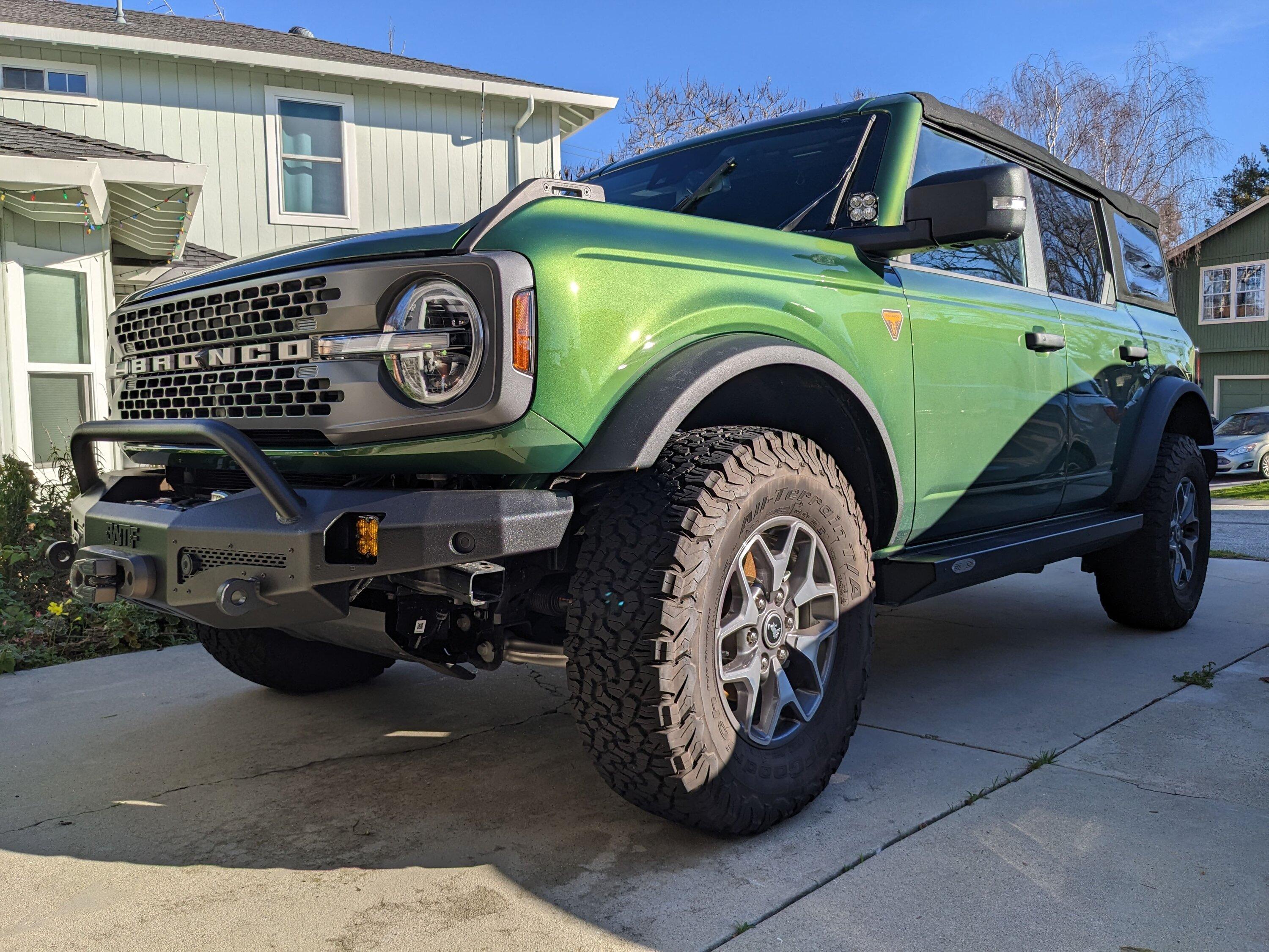

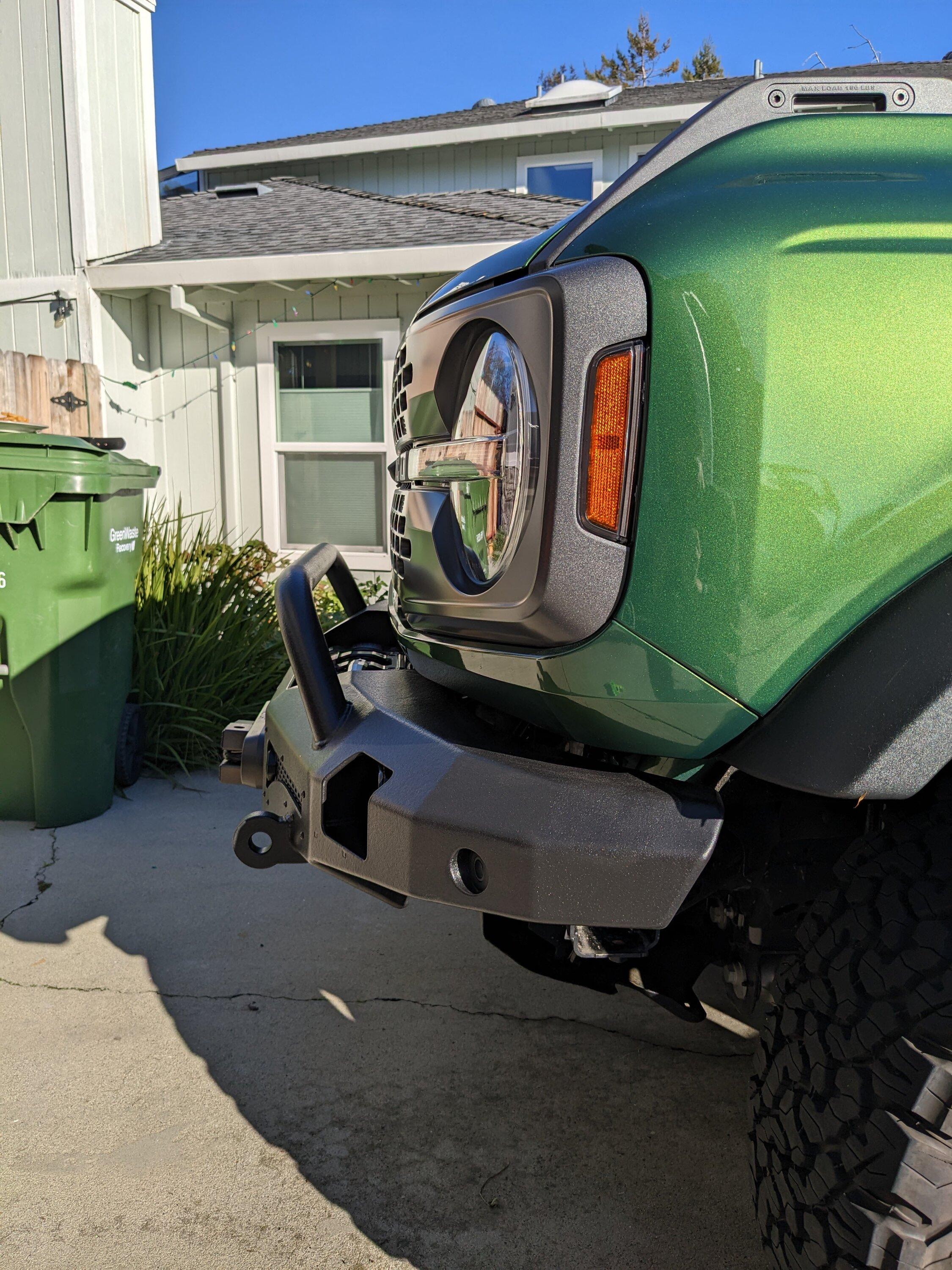

Got the new bumper installed, and I am very happy with the results!
Ford Bronco BAMF Overland front winch bumper PXL_20230101_223135351
Ford Bronco BAMF Overland front winch bumper PXL_20230101_210534282
The only trouble we had was tight spacing with one of the inner parking sensors, which was resolved by removing the rubber air diverter that everyone here says you should do anyway!
Ford Bronco BAMF Overland front winch bumper PXL_20230107_220907648
Thanks, @BAMF for the great support, and looking forward to seeing some rear bumper options in 2023!

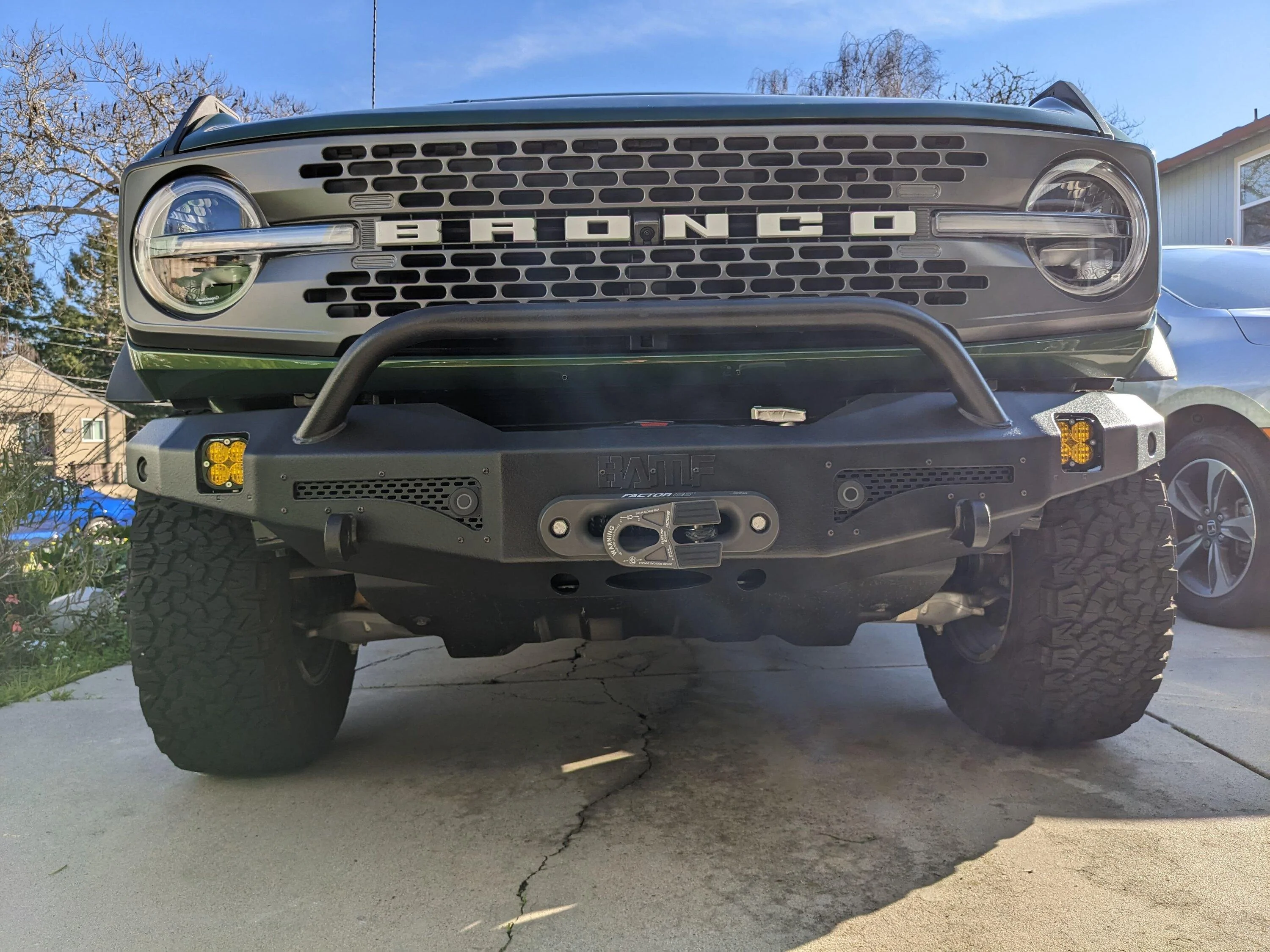

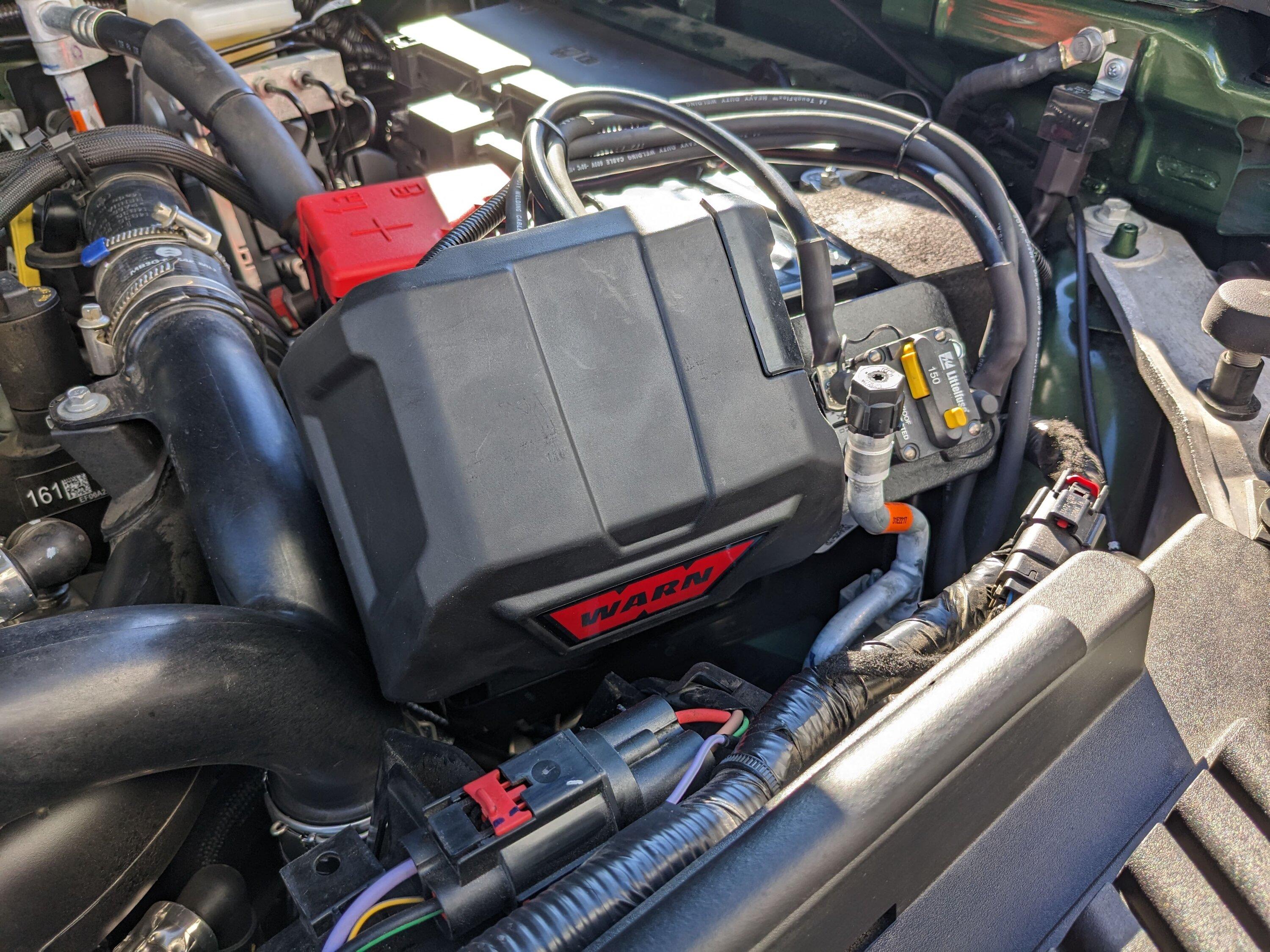

I'm surprised you moved your solenoid. With the bull bar, it seems like that would be in the way that camera and the solenoid would have no effect.
True, but I like the cleaner look without it, there is still a sliver of camera view between the winch and bull bar, and I didn't want to deal with a tight fit for the winch controller wiring between the solenoid and the grill trim piece.

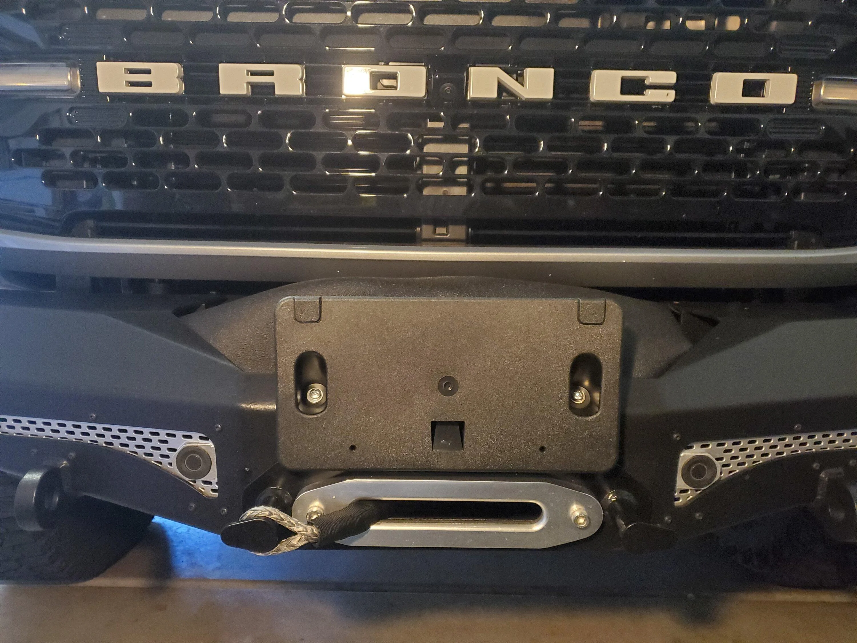

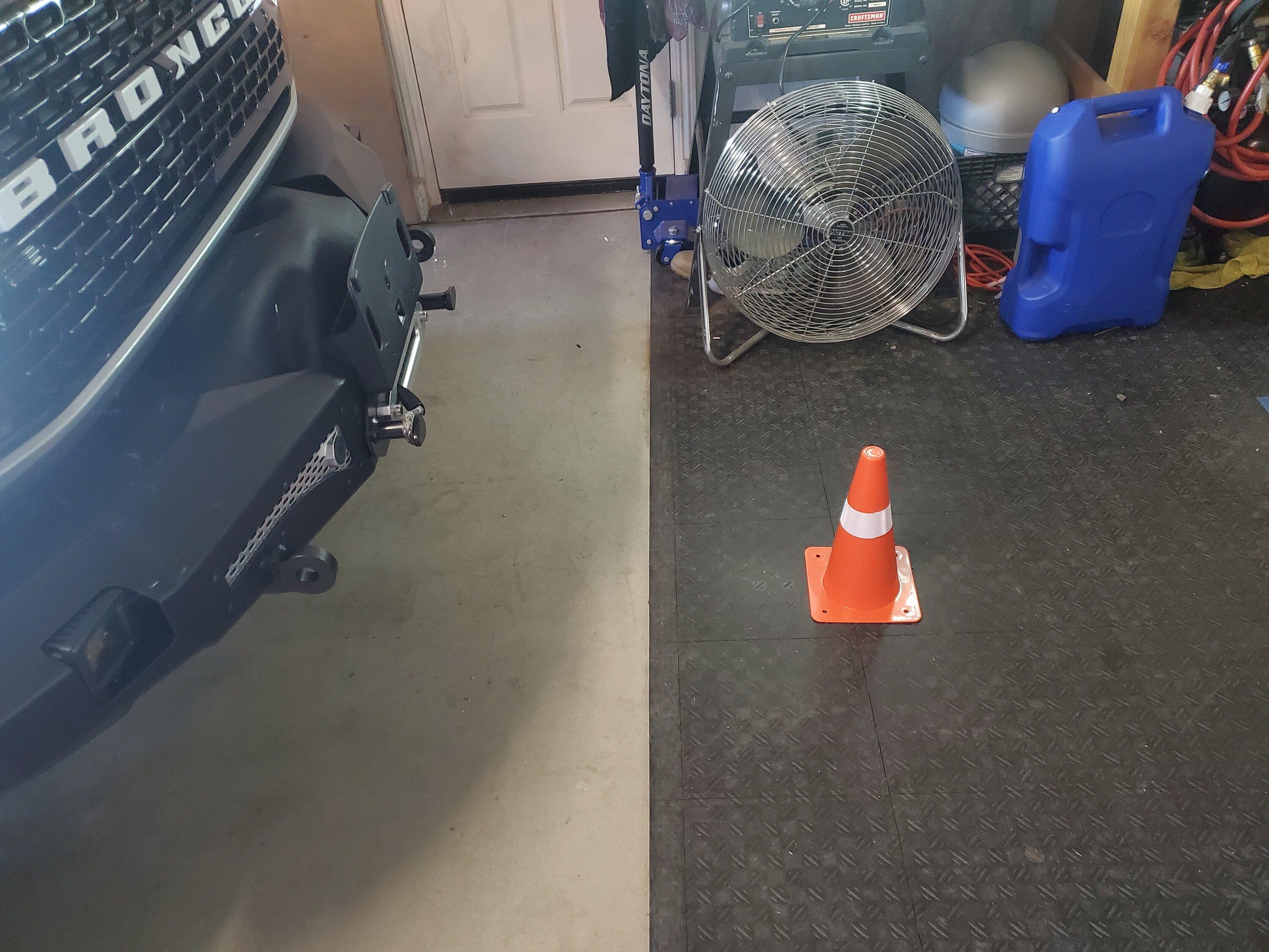

So I was cleaning up some parts in my garage over the weekend, and came across the factory front license plate mount bracket that was included with my Bronco (but not installed).
I noticed that if I flipped it upside down, it practically matches exactly the profile of the overland bumper! Had to drill a couple holes, but it fits great, was free, and although does increase the distance a bit for the front camera clearance, it's not much more... But the biggest benefit (at least for me) was it add some additional protection for the winch.
So some pics....
(Oh, and it will actually fit off to the side and still be above the sensors if you'd rather have your plate add an angle and not in front of the camera)
