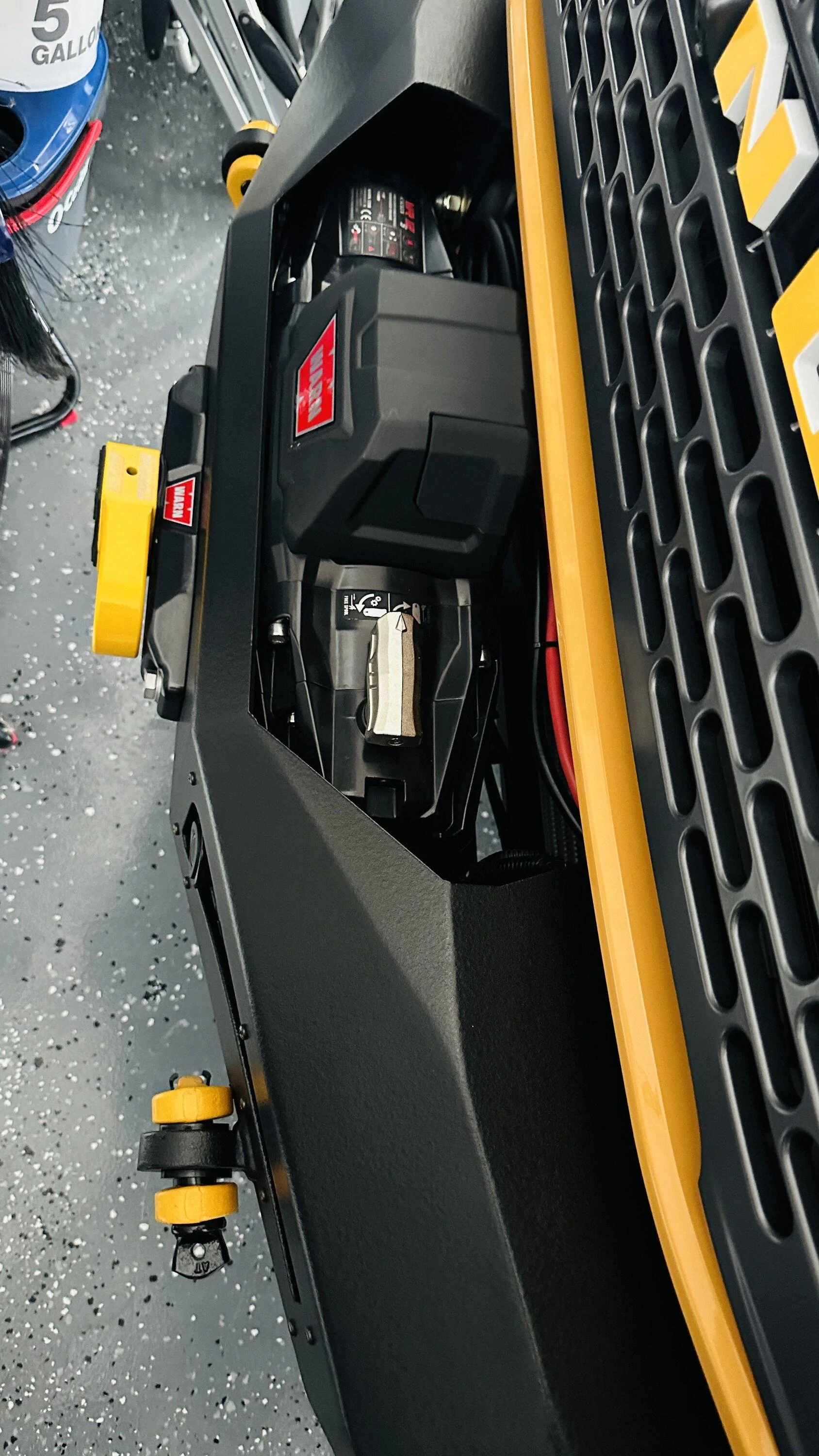

So I was mounting the winch on my bumper while waiting for my Bronco to arrive, and noticed the little "grills" were black coated. But all the pictures I see show them as silverish color... I was actually hoping to have that (since my Bronco is silver)
Was this some option that I missed? At this point I'll probably just going to get some silver can paint but figured I'd ask.

Only the non parking sensor mesh is raw stainless. If you have sensors they are black.

I'll have full installed pics later this week with the parking sensors. two of them are located in the mesh in the center and the outside sensors are just out side of the fog light pocket.
Did you ever complete these instructions? Mostly interested in the routing of the wiring harness and whether we have to cut it and lengthen it to make it work. We don't seem to have enough wire for either outside parking sensor. Seems like the harness just ran along the original bumper in a straight line but with your bumper we have to run back out the back since there is no routing hole from the main part of the bumper to the tube section.

I'm In the long process of updating our instructions in new software.
The parking sensors need to be re-loomed. Take all the tape off the wire loom run your wires around the back of the bumper and re-loom the wires once you have the new routing. There is just enough wire to run out the back of the bumper to the outside sensors.

Agreed. I “Re-loomed” the wite and it stretched perfectly to all four sensors.

Same. We didn't need to rewire or extend any wires.

Got it installed with a Warn Evo12K. We found that it was easier to mount with the winch not bolted down while you secure all the main bolts. You wouldn't be able to get it in after getting the bolts started but you can definitely use the space you get by shifting it around while it's sitting in the bumper.
All the sensors work including the ACC.
My outside parking sensors are mounted on the light rails so closer to center than they should be. I plan to fix this in the future when I have time to remove the harness and deloom it for that extra length you mention is in it. Then I can easily move the outside sensors to their mounting point.

I was able to install my BAMF overland bumper on my 2022 wildtrak (high package).
Installing the actual bumper wasn't to bad. I used ratchet straps to tie it to my floor jack, slowly lifted it to the right height to align the 3 holes and installed the 6 bolts.
I left my grill shutters (because unplugging them can cause CELs), however I had to remove the cover for the ACC for winch clearance along with the rectangle rubber seal frame. (I don't have ACC so the cover was empty)
Where the real grief came into play was transferring over the 4 Forward sensors. Something was definitely wrong... Don't know if Ford change the design on BAMF or not but I basically had to sand down most "fins" on each and every sensor grommet for to fit inside the bumper holes. Each hole the bumper has contains three little cutouts that I suspect were supposed to be for alignment. However they did not come even close to what the sensor grommets needed. If you compare the hole patterns in the original bumper (And each one is actually different) to those in the BAMF, not the same.
In addition, I marked every single grommet and sensor at the top before taking it out of my original bumper so I knew The orientation and the order of each. In doing so, the two inner sensors (The ones that go into the grill inserts) had to be reversed. If you install them in the same orientation in the same position as the factory bumper, due to the angle of the grill insert, you would not be able to plug in the electrical connector.
Had it not been on a Sunday, I would have called BAMF (maybe even drove down there) to show them.
Honestly I was a bit pissed, and partially expecting the Bronco to complain the sensors were all out of whack, But I took it for a test drive and they still seem to be working and nothing complained.
Oh..and I have a new front skid plate to install later, so for the time being I decided just to shove the original plastic one back in place.. and actually fit! The two bolt holes at the bumper will not line up because you can't slide the skid plate fully forward due to it hitting the BAMF bumper, however the two back bolts, and the two middle bolts with a little prying, will align. It's under such pressure that it's not going anywhere missing those two front bolts.
Oh one more thing... The thing that makes this bumper all worth it...it barely affects the front camera. I can barely see the winch, and my 360 view still works almost identically.
