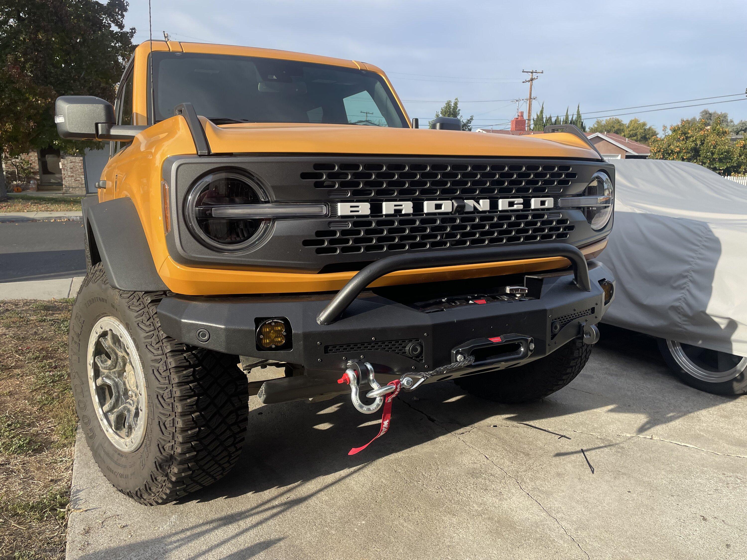

Hi Guys, I did mine a while ago with a 12K warn winch. but have been out of country working. Here is the front of my Cyber Orange Badlands SAS with the BAMF bumper. Jerry I would really like to know how you installed the lights by the winch and I really wish I would have gotten the bull bar.
Looks fantastic! So, you were able to get this to fit without the solenoid relocation? Do you have ACC? Did you relocate that?
I did get the solenoid relocate adapter but didn’t need it. As far as the ACC I moved it with his kit and it works great. The only thing I’ve noticed is my right parking sensor goes off while I’m driving and I think I must of not put it in correctly. Very happy with the bumper waiting for a rear bumper that holds the spare tire hint hint
