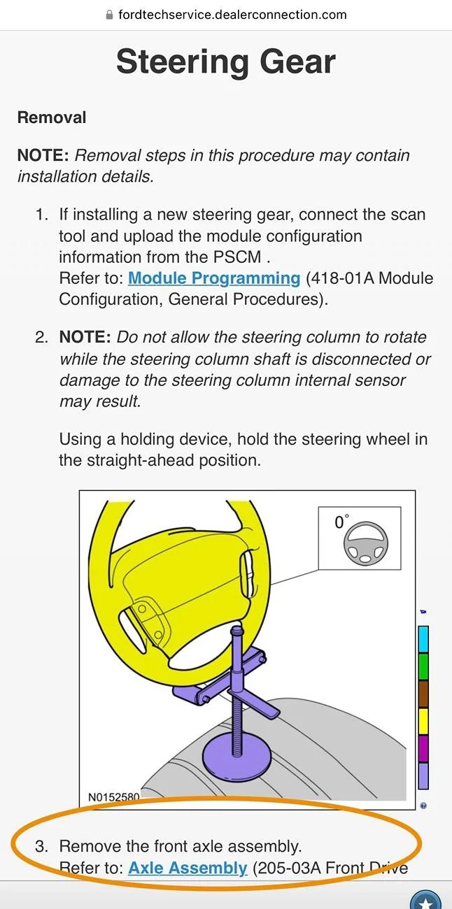

Got the Bronco back today. Noise is gone. Covered under warranty as quoted. They also did an alignment, which makes sense. A few comments though. The good: invoice shows many new nuts, bolts, clips, and plugs were used. I was glad to see this and confirmed it by looking under the vehicle. The heads up: invoice states that the front differential was removed in order to access the steering rack. I didn’t expect this. Videos online indicate this is not necessary. I’ll be engaging the four wheel drive this weekend for sure. As noted by other members: they didn’t reinstall the skid plate correctly. I have an RCI engine and transmission skid. They’re tight but they did not replace the washers correctly so the continuity of the protection “pan” on the transition from engine to transmission skid is uneven. Basically, a lip to catch things on that shouldn’t be there. At least they didn’t charge me to remove/replace them. I’ll be correcting this issue myself.
Whether it’s necessary or not, Ford’s instructions say to remove it. So I’m sure the warranty story was written up per Fords instructions even if it wasn’t removed.

It's definitely got to be easier than smashing your hand trying to twist it out of there... :censored: :whistle:
