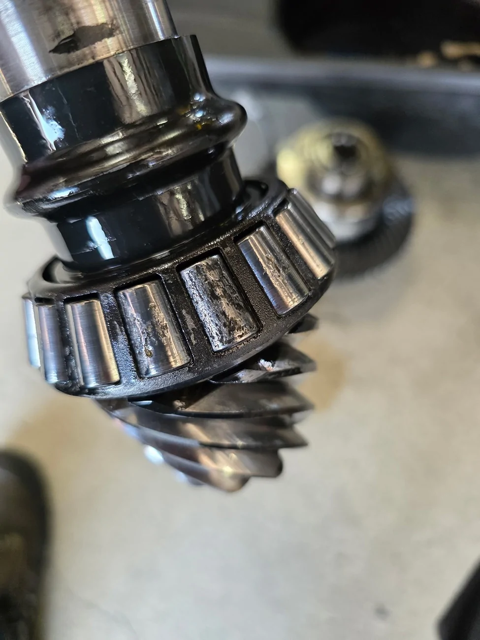

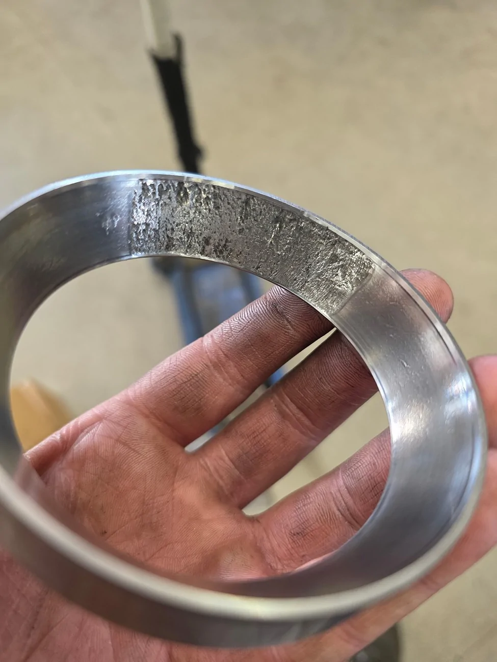

Just wanted to update for all.
Noise was fried rear differential. No mods or off-roading. 50k miles. Covered and approved under power train warranty.

Here ya go!
Ford Bronco Whirring, Drive Train Noise 3069298213254631274
Ford Bronco Whirring, Drive Train Noise 5320735553253634038

With extended warranty I think it should be covered. It's common failure. I was talking to my parts guy at dealer yesterday in small town TX and he says he sees these Dana's throw pinion bearings all the time. I have heard change diff fluid at 500-1000 miles after break in of the bearings and it almost always keeps this from happening again. Good luck 👍🏼
