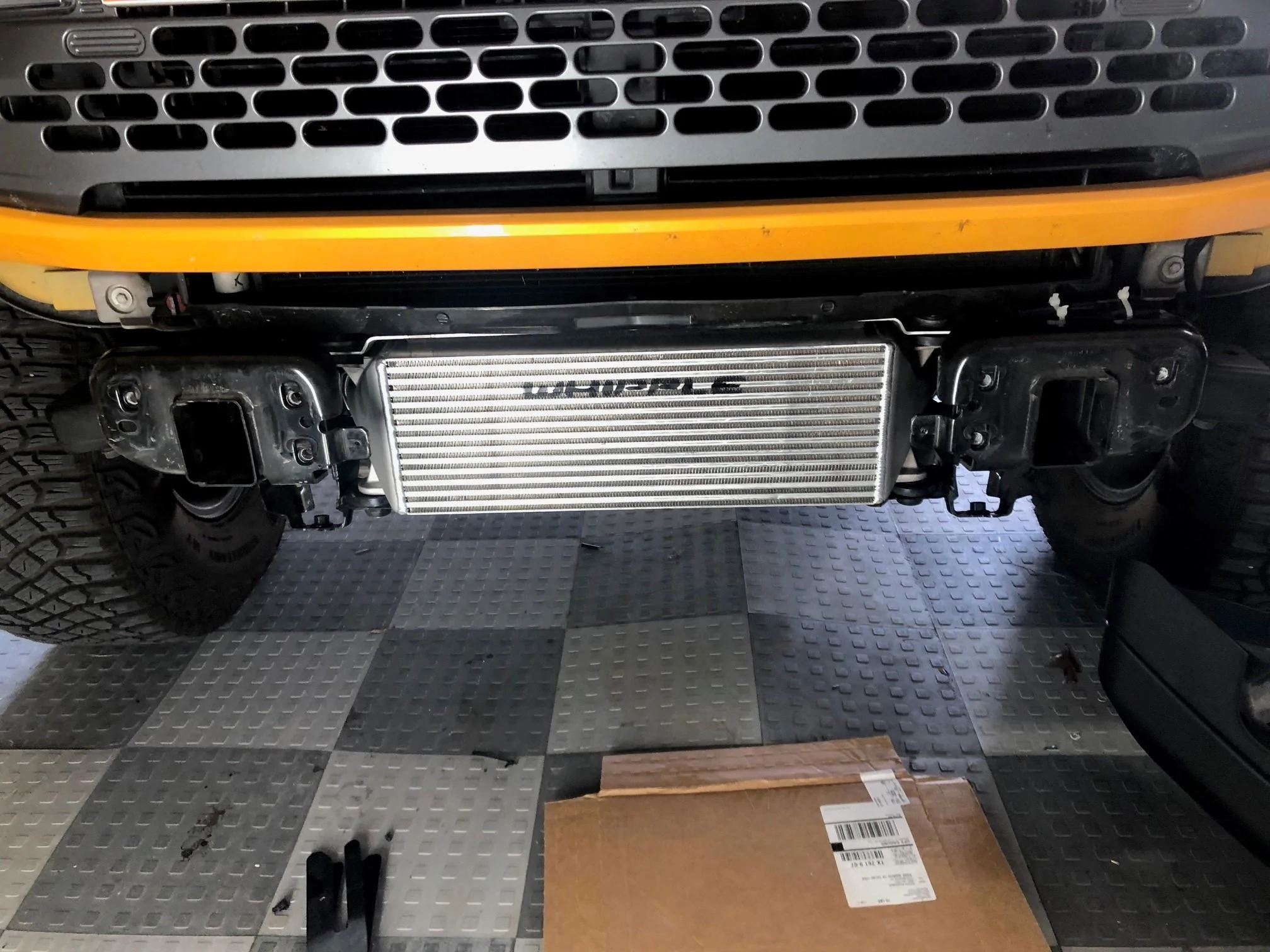

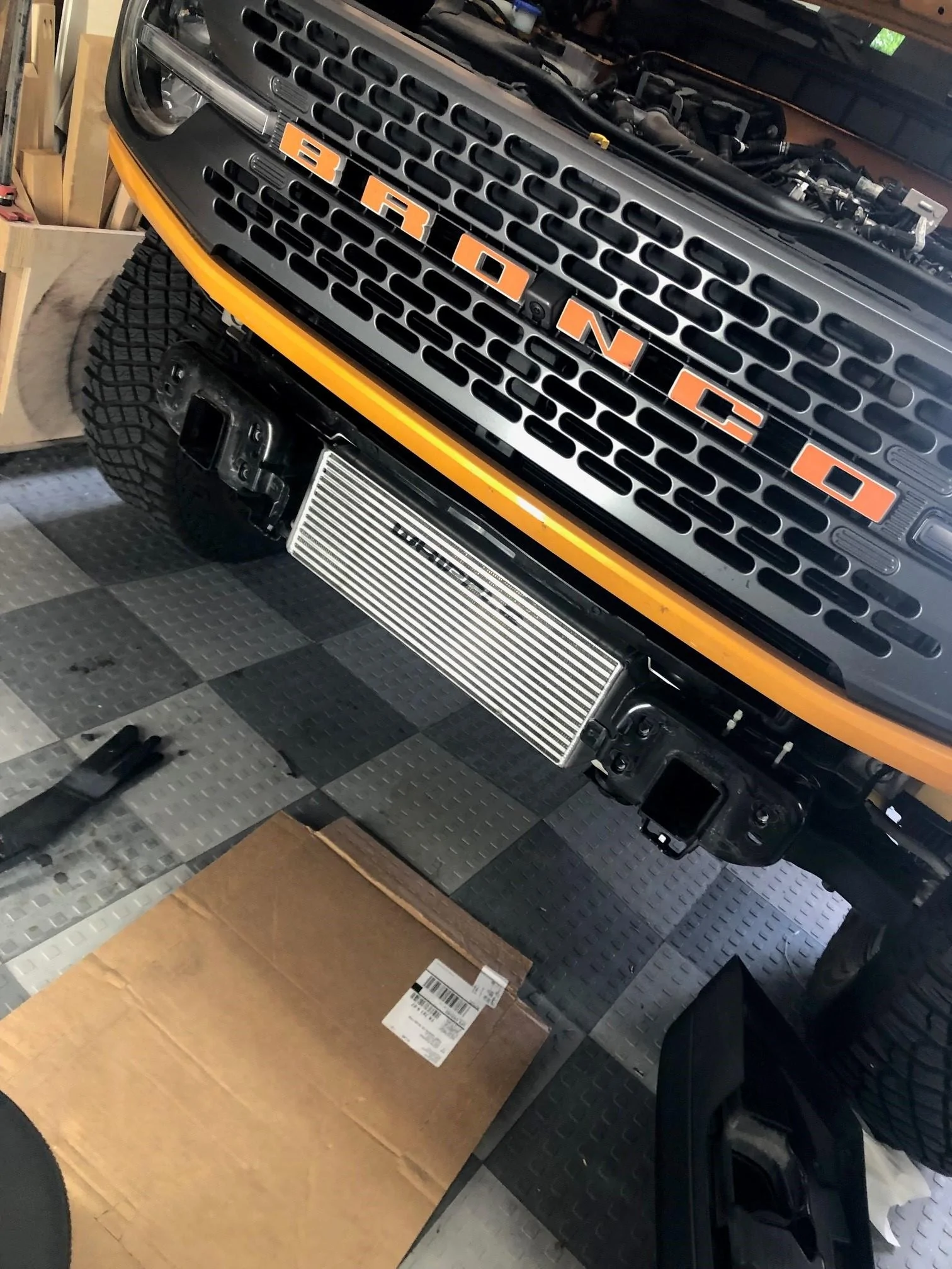

I installed the Whipple Stage 1 tune and air filter last week and man what a difference it made. I just installed the intercooler this morning. Can't wait to see if it makes any difference. It's really hot down here in Texas right now, 105 yesterday, so power gains probably won't be as dramatic as if it was in the 80's. This install was quick and easy. Less than 2-hours. FYI i have the capable bumper and no CCA so not as many bolts and brackets to mess with.
You’re talking about it taking 2 hrs for the intake and such right? You have to remove the front bumper to install the whipple intercooler? I have the mishimoto and it’s a 5 min install from start to finish with removing the skid plate

The Whipple is much thicker than the factory unit. That how it gains its efficiency. But it doesn't hang down any lower. You have to discard the factory shutter damper in order to use it, hence the bumper must come off. It's no big deal. I have never gauged the benefit of a performance product by how easy it was to install.
