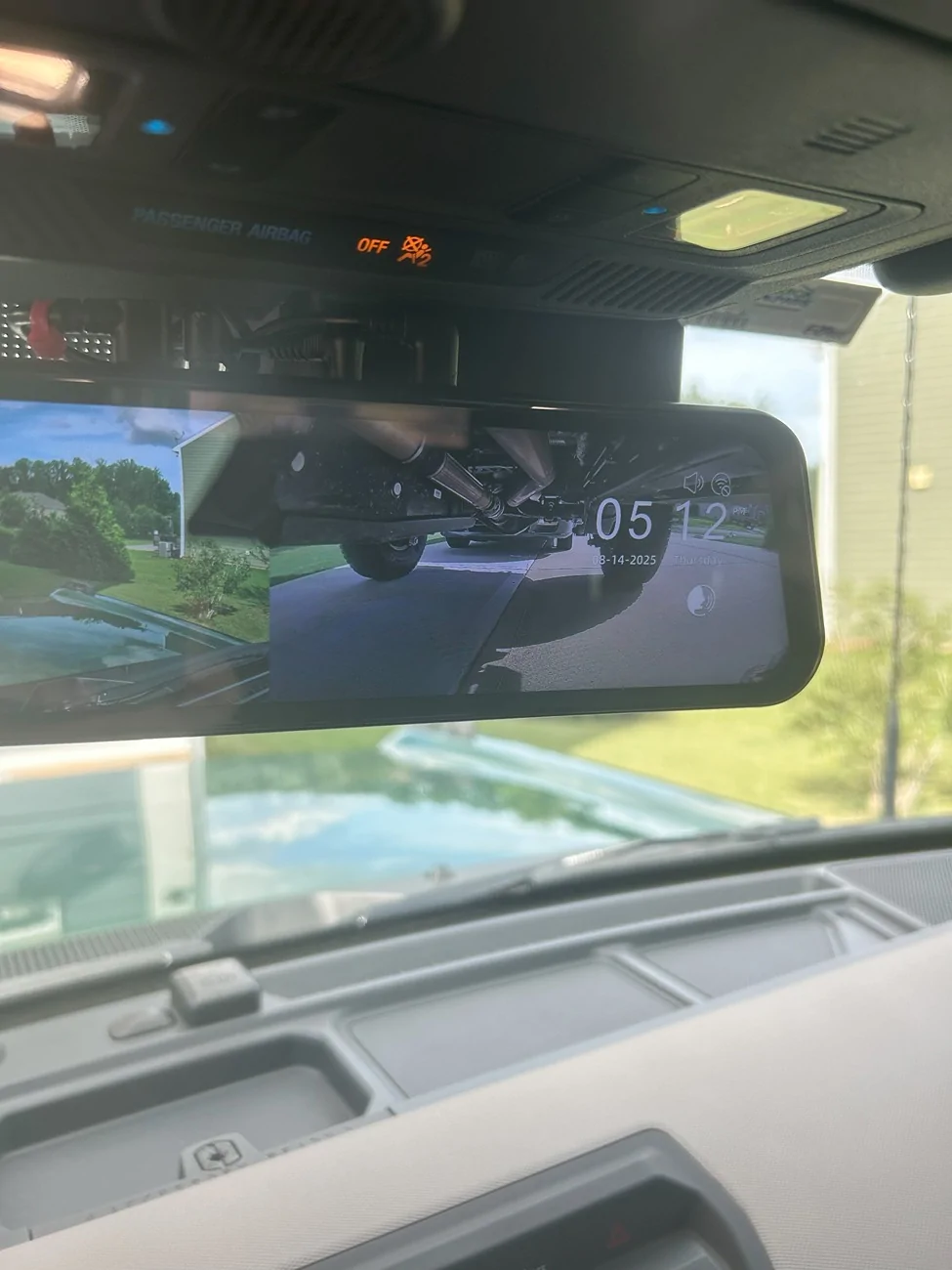

Roll bar or spare tire.

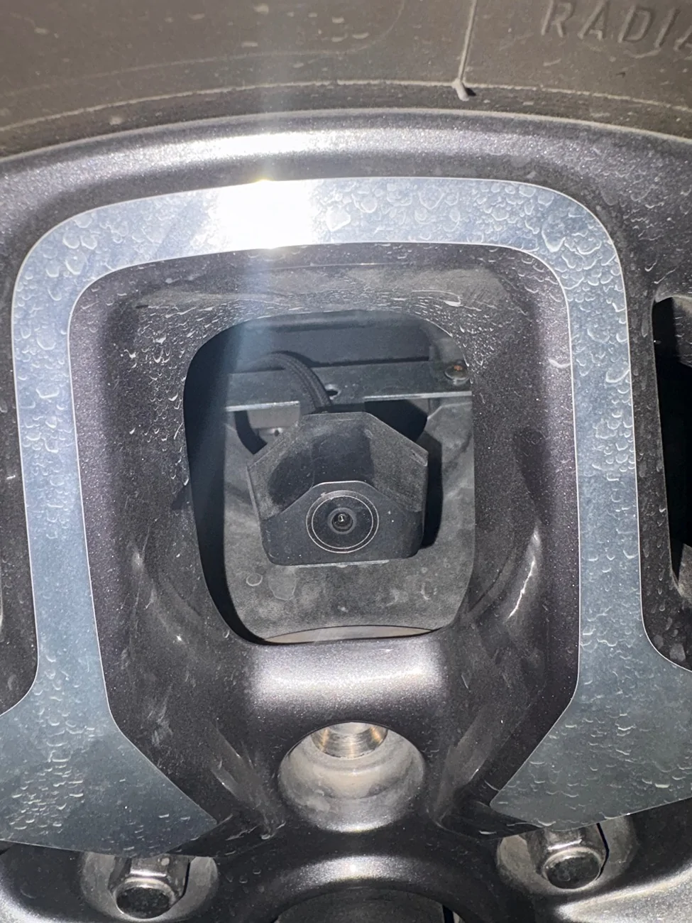

Inside the spare tire wheel using a modded t brace from home depot.

That looks like a clean install. The camera view look alright through the window? I feel like the wheel tire mount may be better in terms of view. But idk

I ran the wire thru the vents on the tailgate. It was long enough to reach all the way. See the attached picture for an idea. Depending on your wheels you can center it or modified to fit thru the wheel openings. You can also use aluminium to fabricate tour own.

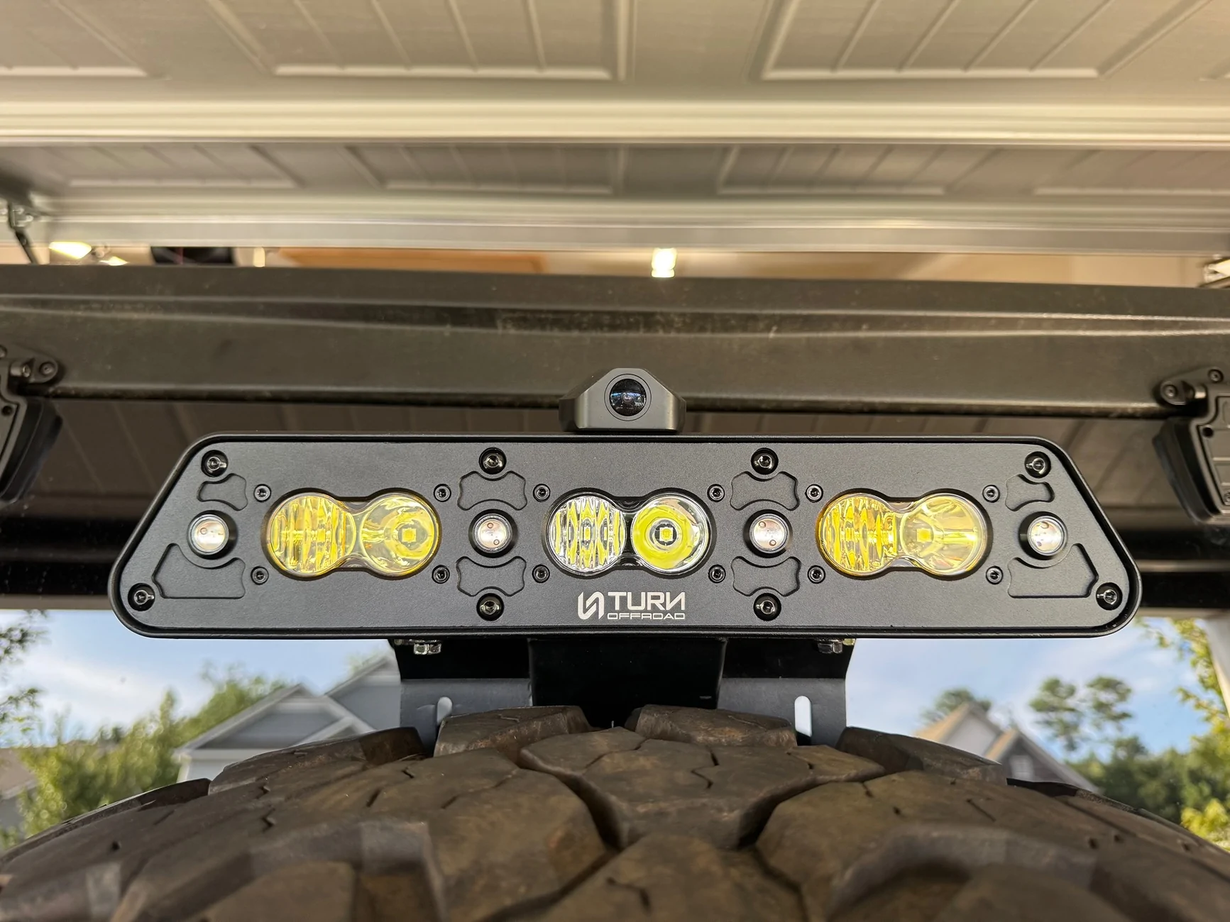

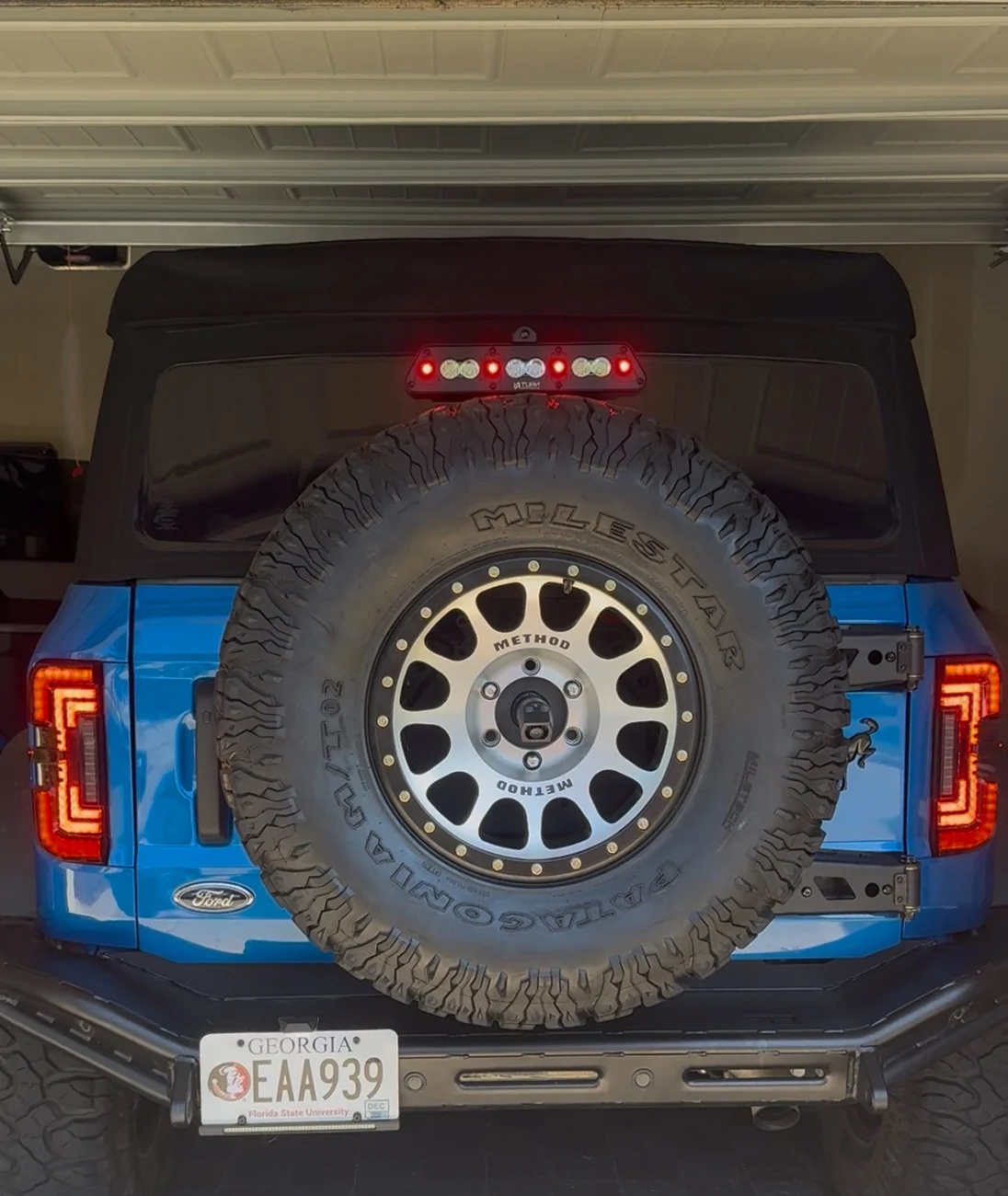

I mounted onto top of the third brake light. Ran the wire down through the vents, along the harness into the cabin and down the passenger side

does the camera bounce at all being on that?

Thanks! I think I’m going to give this a try

Occasionally I get some shake at highway speeds but it’s short lived when it occurs. It is really helpful to avoid blind spots being up so high with the wider angle visibility compared to the normal mirror.
