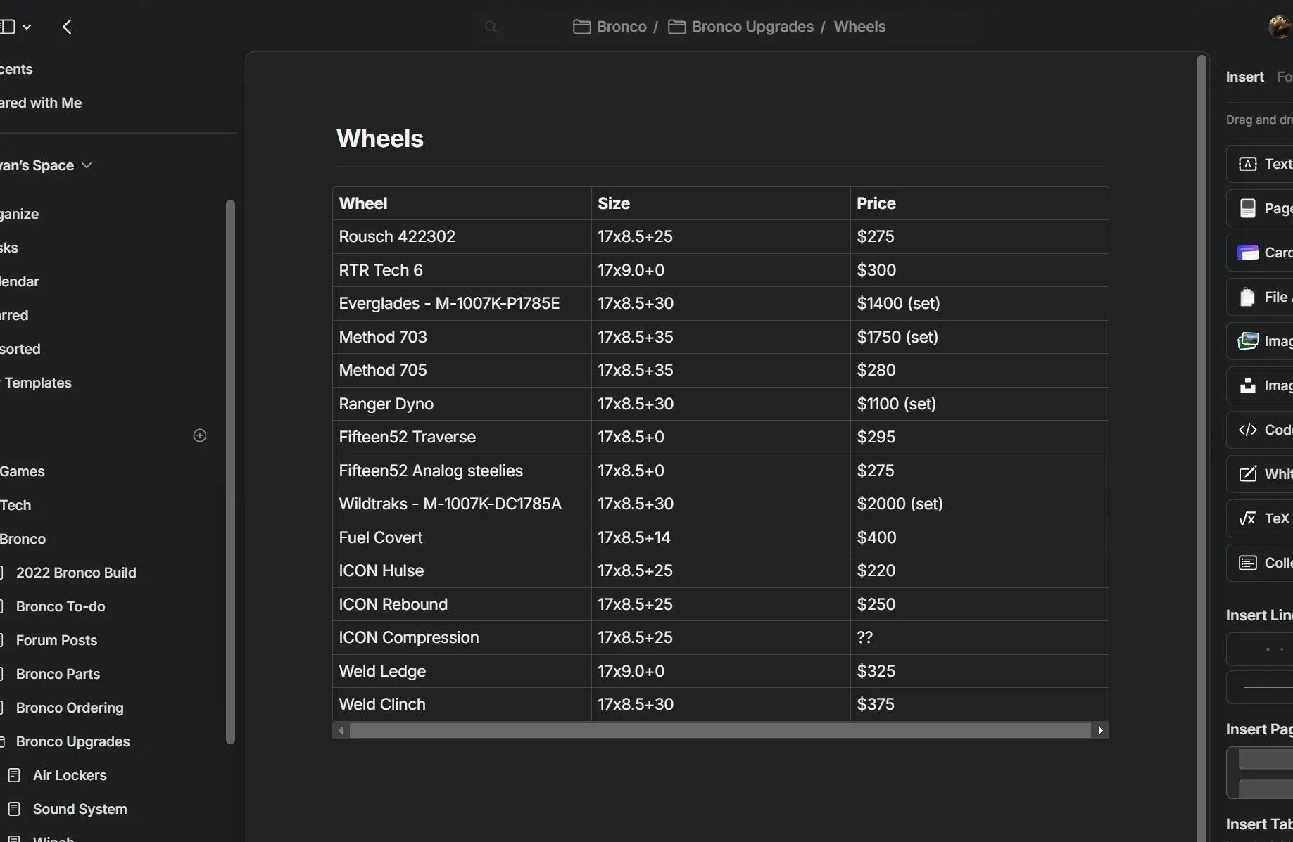

My list for @userdude now that I'm home. I apparently didn't write down the hub bore—unhelpful. There were others I had in the original spreadsheet, these were just the wheels I was considering buying. (You can all judge my taste in wheels now.)
I did quickly spot check a few on this list. Most are indeed 93.1mm or close to it. Some of them don't even list the hub bore. Some of them are definitely not 93.1mm (like the Fifteen52 wheels). And some of them I have no idea because they don't come up, guessing they're discontinued.
All in all... super unhelpful for @WR1 because most of them are not 0 offset, which he'll probably want if he is going 37s. I personally was going for 35s while I was shopping, but I'll admit memory of this list had far more 0 offset wheels than what there actually is. So... ya' know.... got a little egg on my face for that one, I see the problem now.
Also noticed quite a few price increases while I was spot checking. :(
