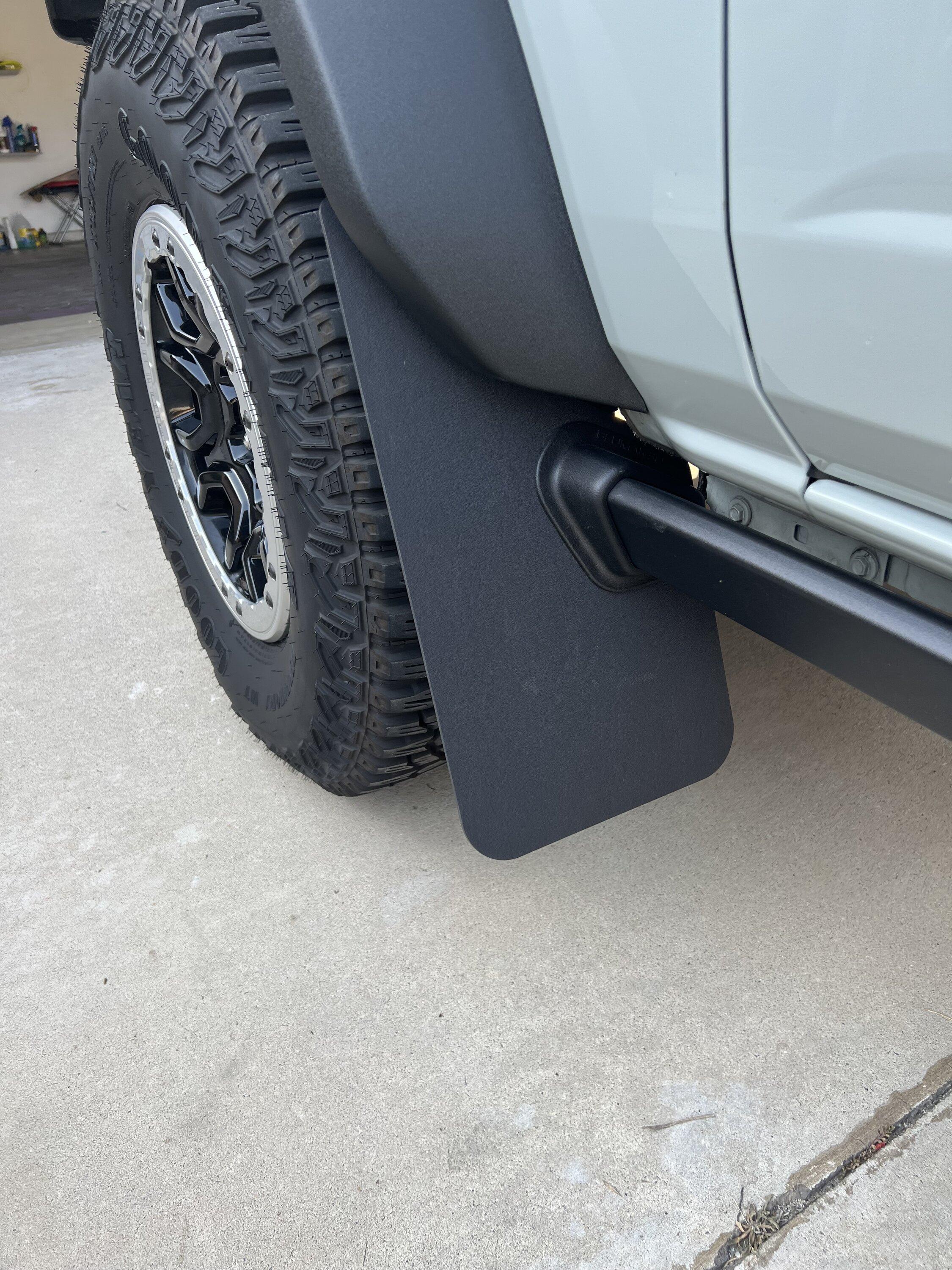

Did the Mabett ones here too. They were one of the first that had a decent fit to the Bronco and easy to install.

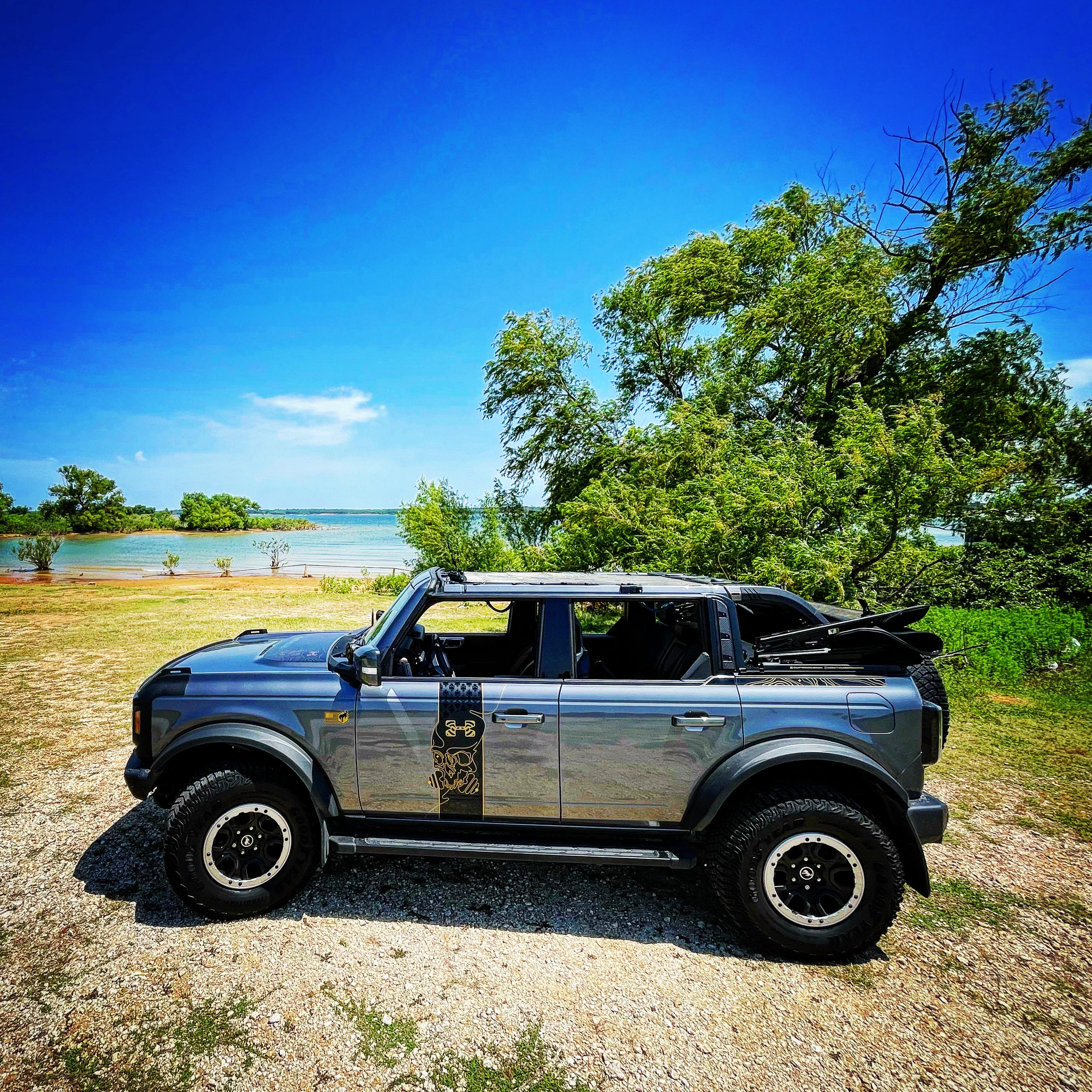

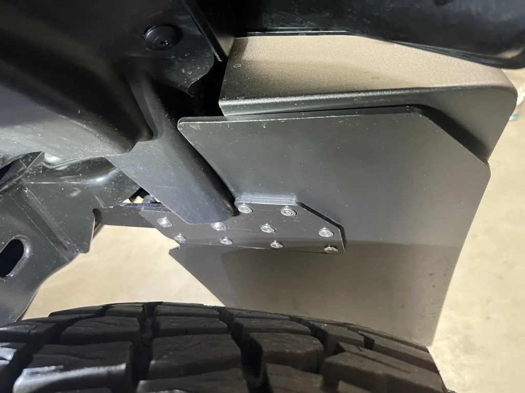

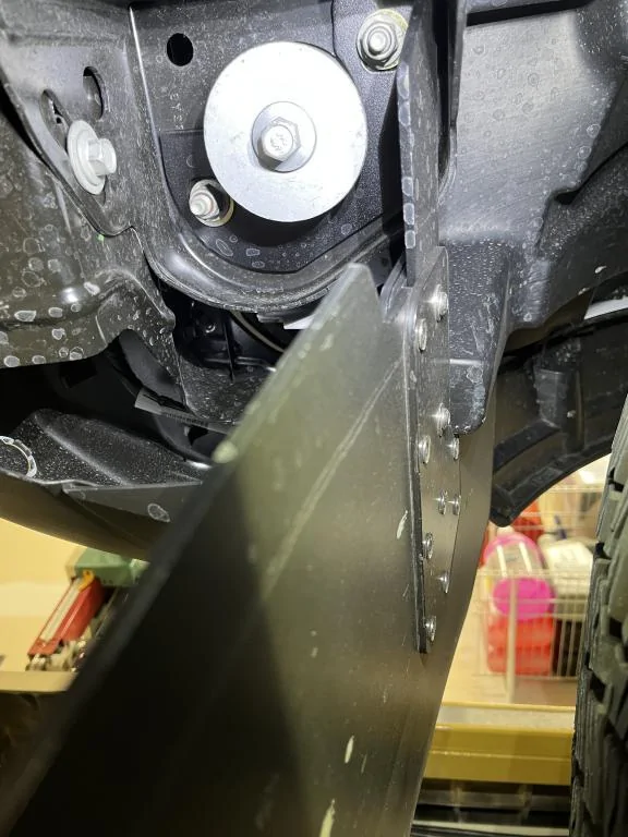

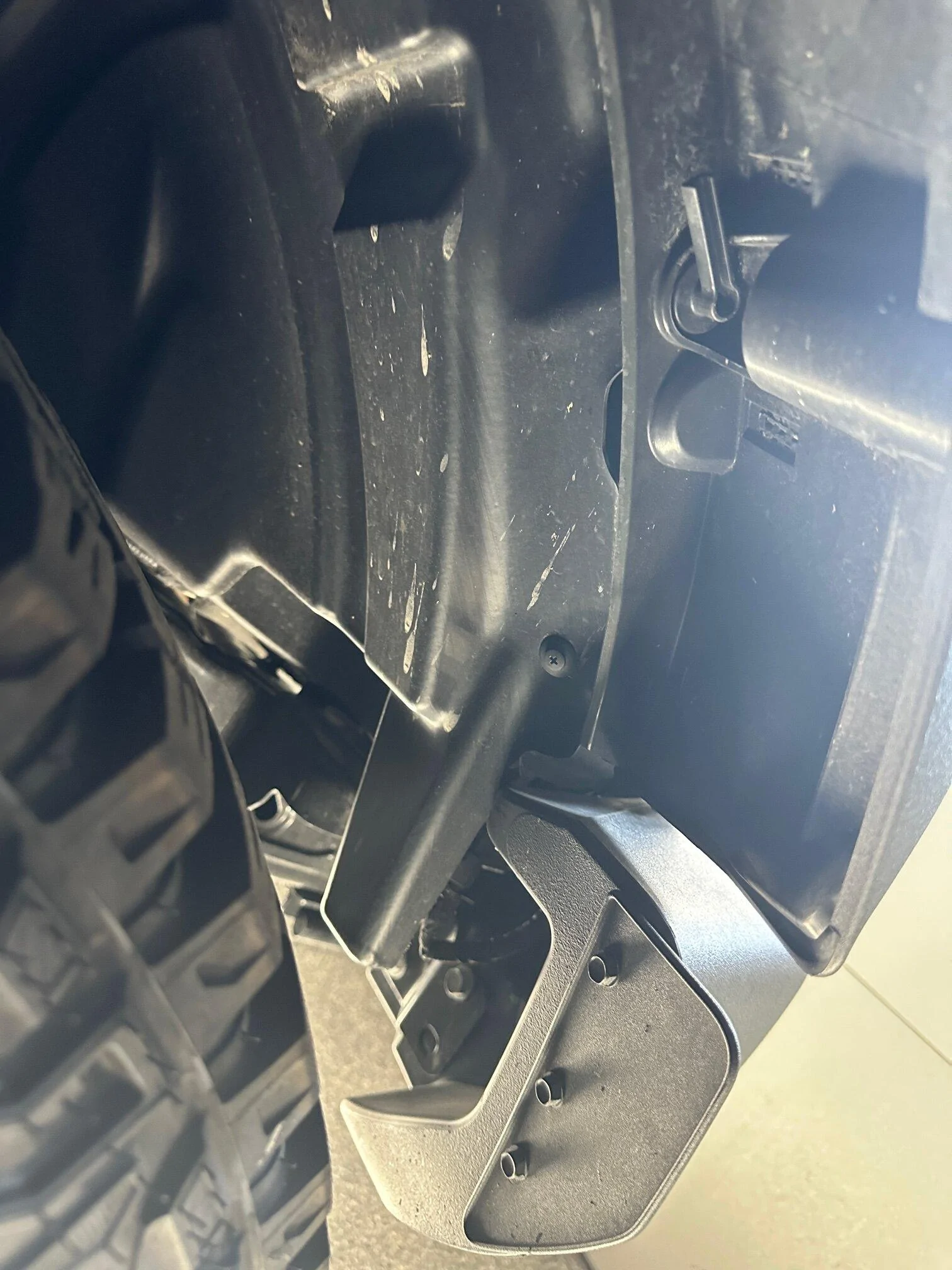

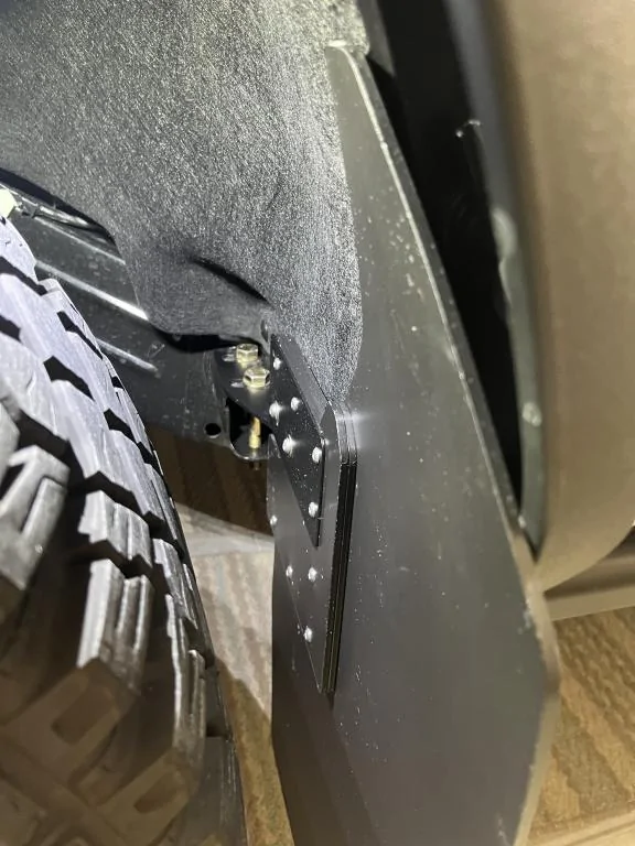

We had the IAG/Mabett type mud flaps installed for about a week. Very nice OEM look, but not fond of how the metal support brackets, on both the front and rear mud-flaps, extend into the wheel well area. Since they both bolt directly to the edge of the fenders, an impact to the bracket or mud flap could potentially damage the fender and/or surrounding trim pieces.
Began looking for mud-flaps that do not attach to the fender or surrounding trim pieces. One of the few (only??) combo (front/rear) sets of Bronco mud-flaps that don’t are the Rokblokz. They're 100% supported by a heavy metal bracket that mounts to the front crash bar (on the front) and a body/frame attachment point (on the rear).
The pics show a front/rear set of Rokblokz XL Longs on our 2d Sas with OEM 315's.

Our Badlands (2dr SAS), which I believe has a different OEM rear bumper than the Wildtrak, doesn't have these 3 bolts.
In any event, whether the bumper (or end-cap) has the 3 bolts or not should be a moot point. The Bronco Rokblokz mud-flaps (both front and rear) do *not* mount or attach to the fender, bumper, bumper end-cap or any nearby trim piece. The mud-flaps are 100% supported by a heavy metal bracket that bolts to the crash bar (front) and frame/body mount (rears). The frame/body mount is the large, silver colored, disc-shaped item (with two nuts/bolts) shown in one of my pics.
Since the Rokblokz mud-flaps do not attach to the bumper in any way, they should work fine with any rear aftermarket bumper---as long as the ends of the aftermarket bumper don't protrude into the wheel well area where the mud-flaps are located.
