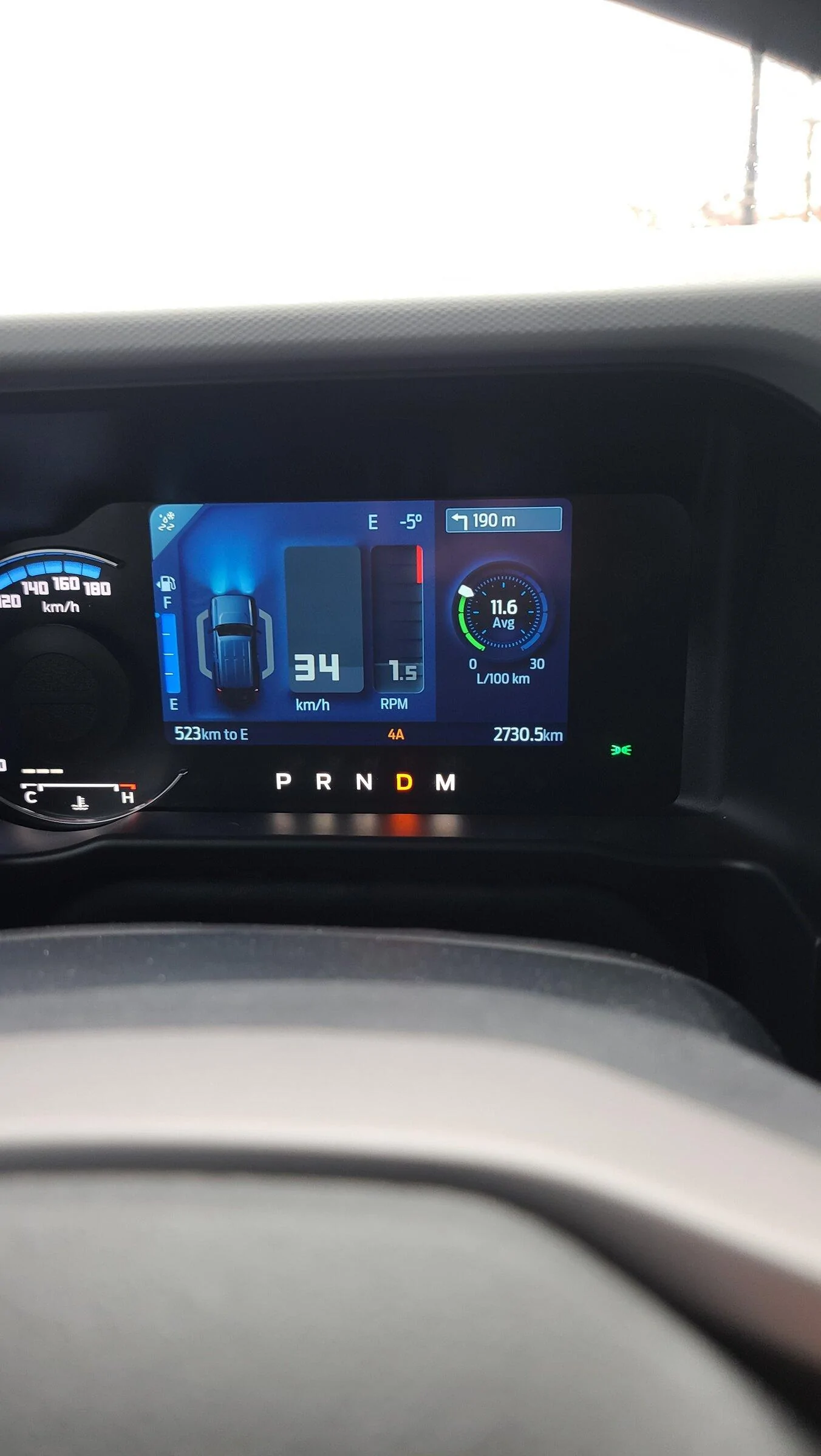

Why such shitty mileage? I have a 2.3L Sasquatch and I'm 11.6L/100
Sounds like you're doing straight off road crawling? Lol
Let it use boost...as rpm's go up, so does internal friction. 2X the rpm, 4X the amount of friction.
At some rpm point, it'll be the most efficient with regards to BMEP, but that's more to do with unboosted motors than boosted, cam timing, exhaust and intake tuning, etc.
The best way to improve mileage is with adjusting the nut between the steering wheel and drivers seat.
