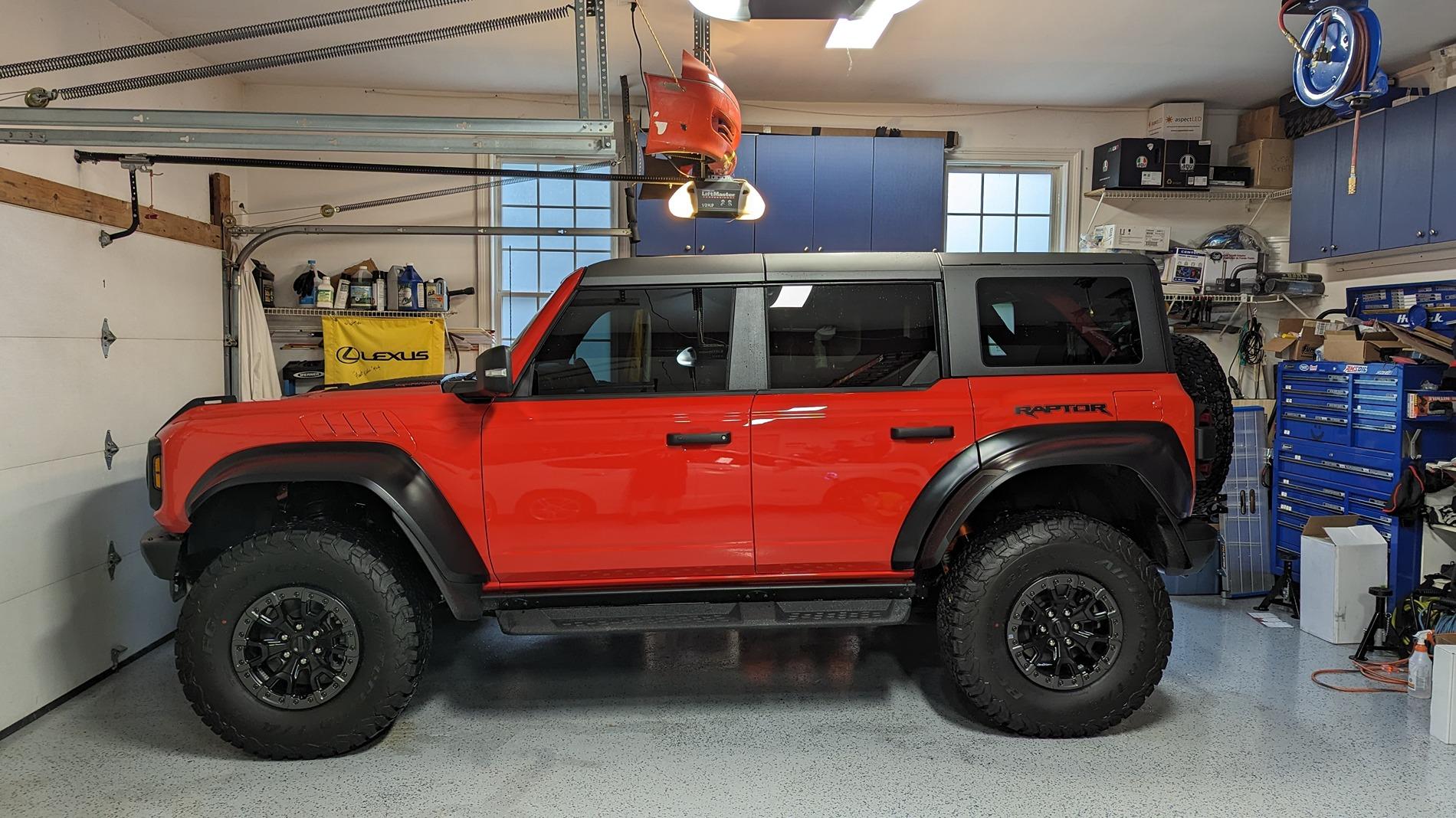

I Paid $2k to have my Braptor (brand new at the time) and my wife's Black Denali with 50k miles. Both had full clay bar, paint correction, 'graphene' ceramic, climate controlled 24 hour cure and 10 year warranty. At this price they also tinted the front windows on both cars, so maybe $900 each?
I was skeptical at first. The wife is a drive thru car wash queen- the car was swirled front to back and this completely cleared up the black paint. She has steadily hit the car washes over the 6 months since coated and there is literally zero defects- who knows how long that will last.
As for the Raptor, it deepened the color of the Hot Pepper Red and made the paint like glass to the touch. Easy to clean too.
I didn't have the time to do this myself, but will now have it done on every new car I buy.
