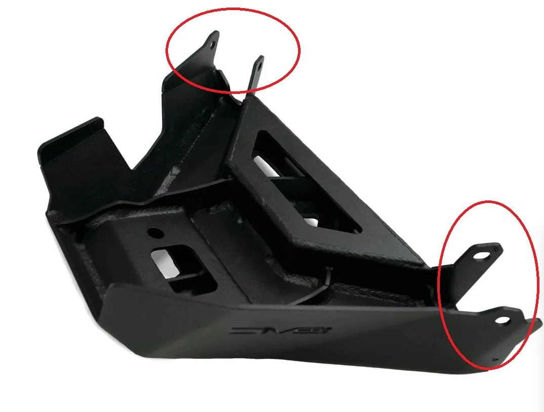

UPDATE: Turns out the clicking sound was the skid plate. Once on the lift, we pushed up on the skid plate and the sound stopped. Keep in mind, the skid plates were not loose at all. It took two of us to push up on the skid plate to eliminate the clicking.
The main shock bolts were fine and tightened to spec so we starting tightening the two bolts (where the red circles are below) and eventually the clicking stopped.
