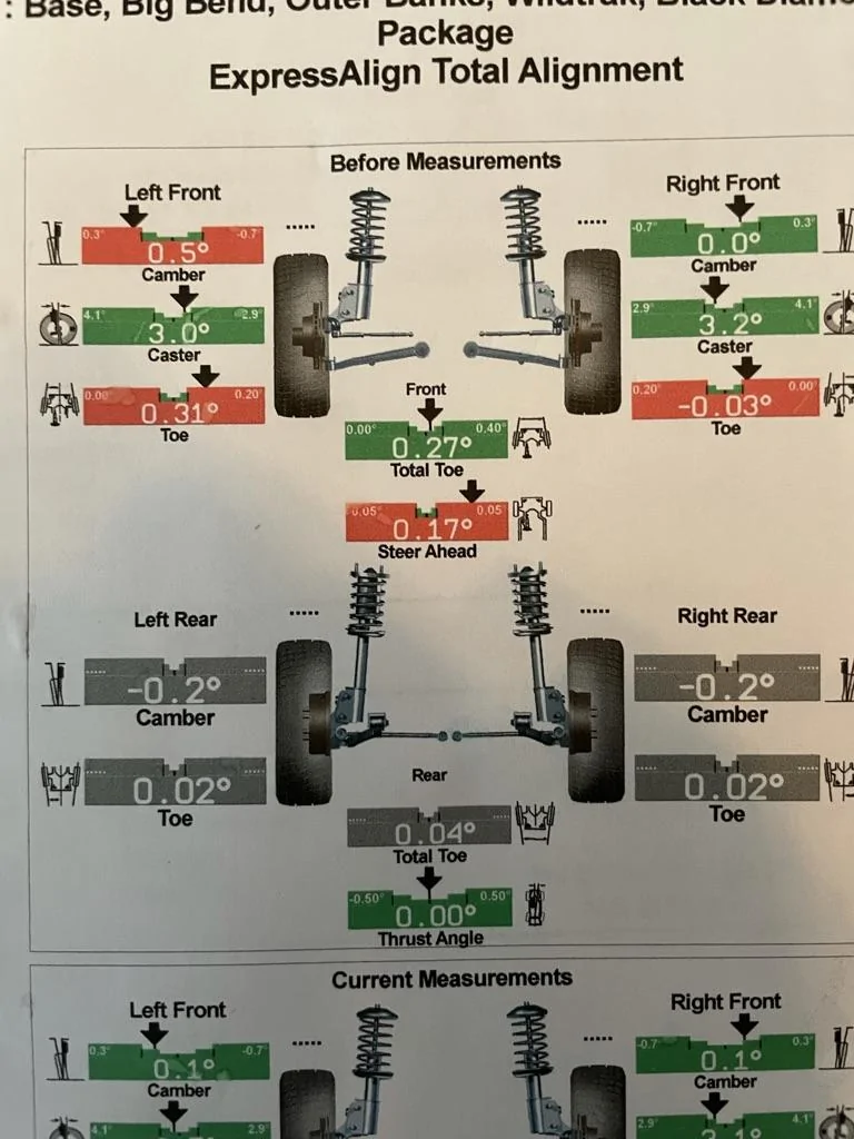

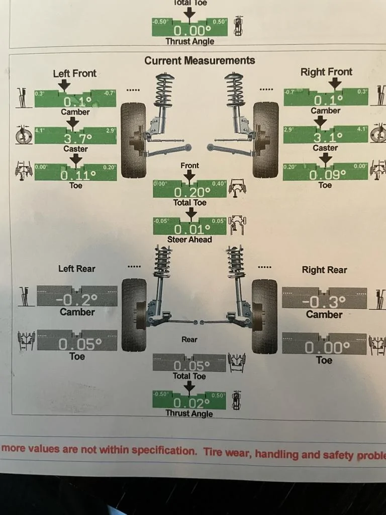

Update: Took it this morning to a shop nearby that specializes in Rough Country lifts. Asked them to comb over the dealer's install and re-align. They also did before an after test drives. The tech said he didn't really notice what I was talking about but also didn't take it through any real curvy areas. He said the install looked good from what he could tell, nothing looked out of order. He also said the before alignment wasn't bad, but tuned it in for me anyway. I posted some pictures of the before and after alignment and the RC specs below. Seems like left front camber was right at the limit, and left front toe was out at the high end and right front almost out at the low end (but total was good). He has everything pretty well dialed in now. Since the tire shop was right next to where I was I went ahead and made an appoint to get new all terrains put on tomorrow morning.Couldn't really tell how much it helped as I got stuck behind an old timer doing 25 mph the whole way back.

your alignment wasn’t great before, but it wasn’t bad either. Not sure if it’s normal with other cars, and I only noticed this since I took mine to 3 different alignment shops in the span of a week, but each time the toe was pretty out of spec like yours and they put it back so it’s possible the dealership gave you a better alignment to begin with.
a little interesting the shop inverted your caster split, believe most normally want more caster on the right.
the handling you’re describing is definitely strange, especially since you have a sway bar. Even without, those stock hitcahi shocks are pretty stiff!
