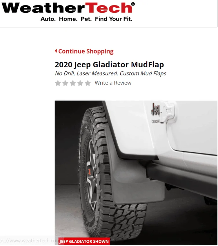

When I had my 2020 Jeep Gladiator Rubicon trim, with rock rails, WeatherTech made me very happy with these. I was sure they'd follow the same design approach and mold in an indention for the rock rail. Clearly the same engineer was not assigned to Bronco.

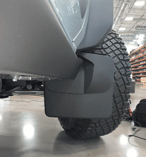

It sure looks like they are on wrong. The top in the picture looks like it belongs on the right side. looks like it's molded for the fender flare there. Looks like there are on sideways.
I thought so too, but look at the mount point. It would only go on one way

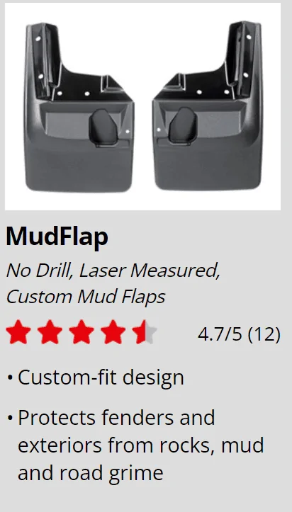

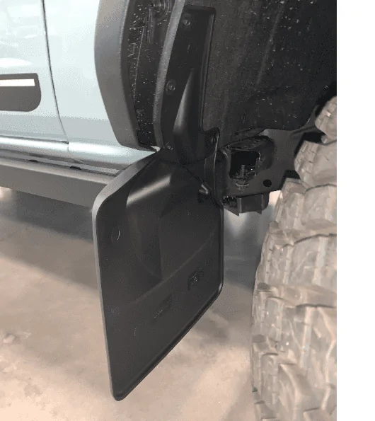

From Weathertechtoday (2/18):
"Good morning, Cat-
Thank you for your patience!
I contacted our Engineering department to provide you with some additional information.
Each WeatherTech MudFlap is individually designed to create the best MudFlap available.
Ease of installation, vehicle protection, and aesthetics are constant influences in this. Usually pushing back at each other.
Part 110140, the Ford Bronco front Mudflaps, were challenging and required special considerations.
- Ease of installation and removal if desired - The traditional J-shaped design was deviated from the basis that a drilled upper connection point would be required.
-Quick release fenders would also need MudFlap separation if desired. The On/off removability would be more difficult and leave a permanent attachment hole.
- Without a secure attachment, the molded plastic coming up following the lines of the fender would create a vibration point. The material would eventually be rubbed away.
-The traditional J-shaped design would also create a pocket for rocks and debris to accumulate inside the fender.
[First 3 pics, below]
Vehicle protection was considered with the gap created. The centerline of the tire in relation to the gap would be below. Debris would be unlikely to travel through the trajectory and reach the door panels. Nylon u-clips versus steel u-clips were also supplied to avoid galvanic corrosion.
[Second set of 3 pics]
Aesthetics were considered with our traditional bulbous MudFlap design. However, with requirements to avoid the rock rails, tube step, and large 35” wheels, design
modifications to the traditional MudFlap needed to be implemented. The bulbous design on the outer half was left, to create strength on the extension outer part.
[Last 3 pics]
I hope this helps!
Please let me know if you have any other questions or concerns. We’re happy to help.
Best Regards,"
