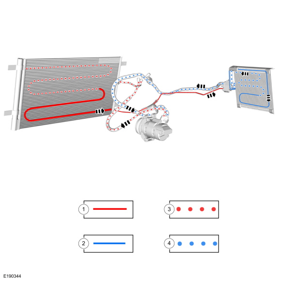

The Refrigerant Cycle
For information regarding basic HVAC (heating, ventilation and air conditioning) system refrigerant operation, refer to the current Ford Web Based Technical Training courses. The following diagram shows the refrigerant system state in each component.
The following are characteristics of the DATC system:
  • The PCM controls the A/C clutch relay.
  • The evaporator temperature sensor monitors the temperature of the air that has passed through the evaporator core and sends a signal to the PCM . If the temperature of the evaporator core discharge air is low enough to cause the condensed water vapor to freeze, the A/C clutch is disengaged by the PCM .
  • The line pressure is monitored so that A/C compressor operation is interrupted if the system pressure becomes too high or too low.
  • The A/C compressor relief valve opens and vents refrigerant to relieve unusually high system pressure.
NOTE: Typical A/C flow and state shown in graphic others similar.
A/C Flow and State
Ford Bronco {thread} {filename}
ItemDescription
1High pressure liquid
2Low pressure liquid
3High pressure vapor
4Low pressure vapor

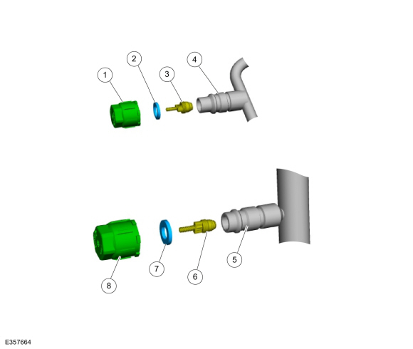

Service Gauge Port Valves
The service gauge port fitting is an integral part of the refrigerant line or component.
  • Prior to leak testing, blow air over service gauge port valves to insure an accurate test.
  • Special couplings are required for both the high-side and low-side service gauge ports.
  • A very small amount of leakage around the Schrader-type valve with the service gauge port valve cap removed is considered normal. Install a new Schrader-type valve core if the seal leaks excessively.
  • The A/C service gauge port valve caps are used as primary seals in the refrigerant system to prevent leakage through the Schrader-type valves from reaching the atmosphere. Always install and tighten the A/C service gauge port valve caps to the correct torque after they are removed.
  • Follow the procedure and the notes for electronic leak testing. REFER to the appropriate procedure in General Procedures.
ItemDescriptionTorque
1Low-pressure service gauge port valve cap 7 lb.in (.8 Nm)
2Low-pressure service gauge port valve O ring—
3Low-pressure Schrader-type valve 16 lb.in (1.8 Nm)
4Low-pressure service gauge port valve—
5High-pressure service gauge port valve—
6High-pressure Schrader-type valve 22 lb.in (2.5 Nm)
7High-pressure service gauge port valve O ring—
8High-pressure service gauge port valve cap 7 lb.in (.8 Nm)
