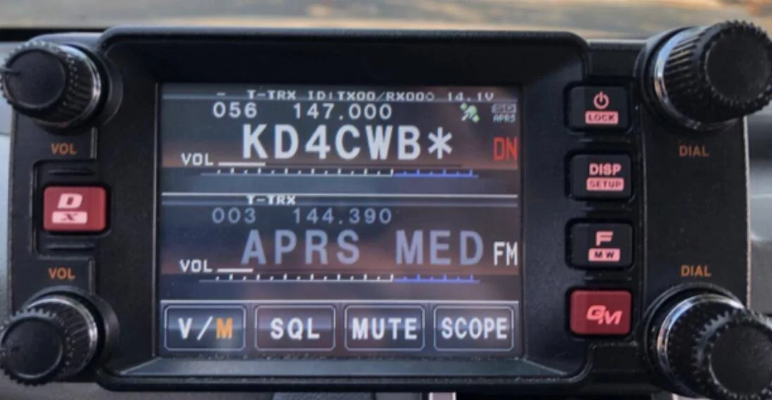

I haven't found it to be too bad, but it's a possibility. On my Yaesu, the active transmit band is slightly brighter and has white characters on the display, while the characters on the other band are gray. You can tell from a quick glance which one is currently active. To switch bands, just tap the band on the touchscreen to make it the active one.
Here's a pic I got from Google that shows the difference:

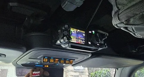

My MARS-modded Yaesu FTM-500 head unit mounted on a Mountains2Metal Over Head Squatch Basket with the basket part cut off so I could mount the unit on it. I used a 20' cat-5 (cat-6? Don't remember, it doesn't matter) network patch cable to connect to the body of the radio.

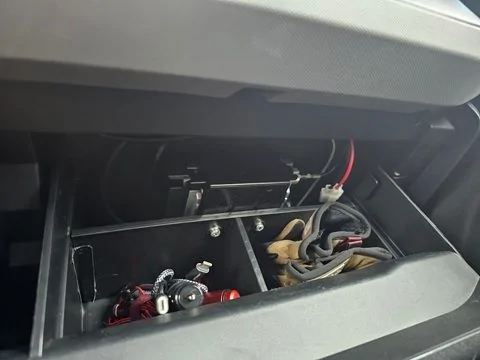

The radio body is on a Mabett glove box organizer and lives in there.

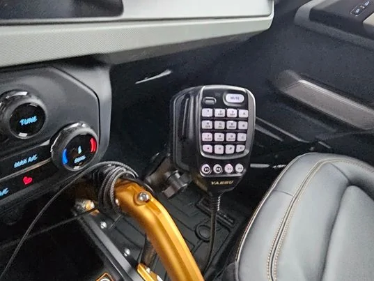

Mic is mounted to an Archetype Racing (RIP) D handle with a 67 Designs arm and mag mount. A mic cable extension was needed in my case.
