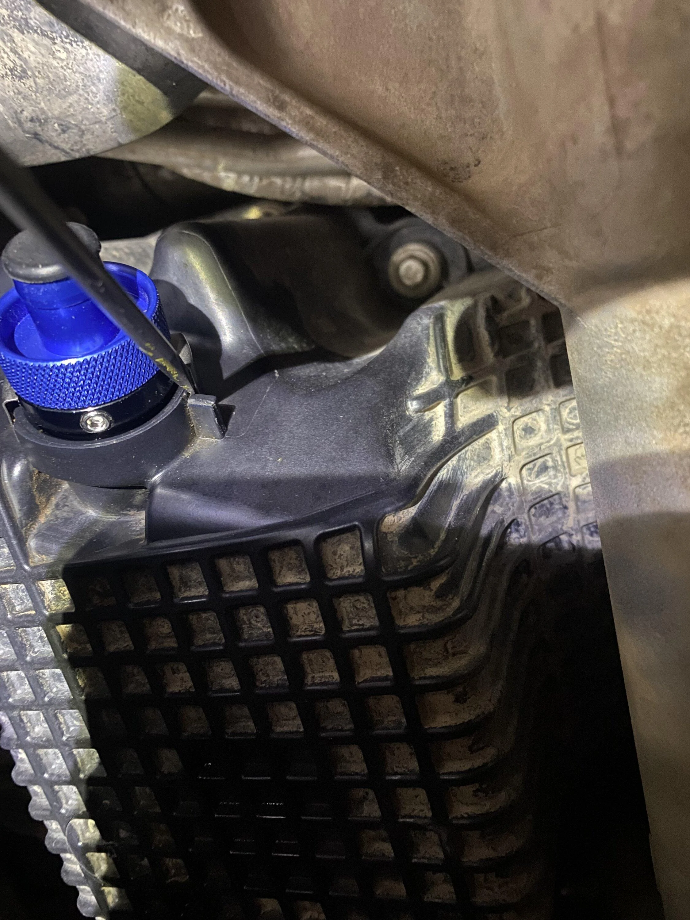

So I had more time to see how the UPR plug comes out. You have to use a very small/long flat blade screw driver to pry the tab closet to the bumper out then slowly turn the plug counter clockwise. This will force the tabs over the plastic hump. I suppose the UPR tabs were slightly bent inward which caused the issues with me trying to remove it. Such a pain. But glad it’s resolved. I guess if that’s all it’s not as bad as I thought. The real test will see how the o rings hold up over time and how easy it is to drain.

Any feedback on the performance of the UPR?
Was curious to see if there is any weeping around where it connects to the oil pan.
@CarbonSteel and I have been discussing whether or not the UPR maybe superior to the Ronin... Any feedback you can provide would be appreciated!

Haven’t noticed any oil leaking. Waiting on first oil change to give full review.

How secure is the screw-in drain part? Is it only held by the friction of tightening or something else? My concern is that it could loosen from vibration and empty the oil.

Very secure. Its not going anywhere. Screw valve, does not loosen and its held in place by just friction and 2 o-rings. You simply tighten the valve and it locks in place. I hear it click when it locks in when screwing. So must be something in there that locks? No idea.

For clarity, it is the blue part that clicks when screwed in? The black part has locking tabs that also click.
Just want to be sure I understand.

The blue plug is what clicks when you screw it in.
