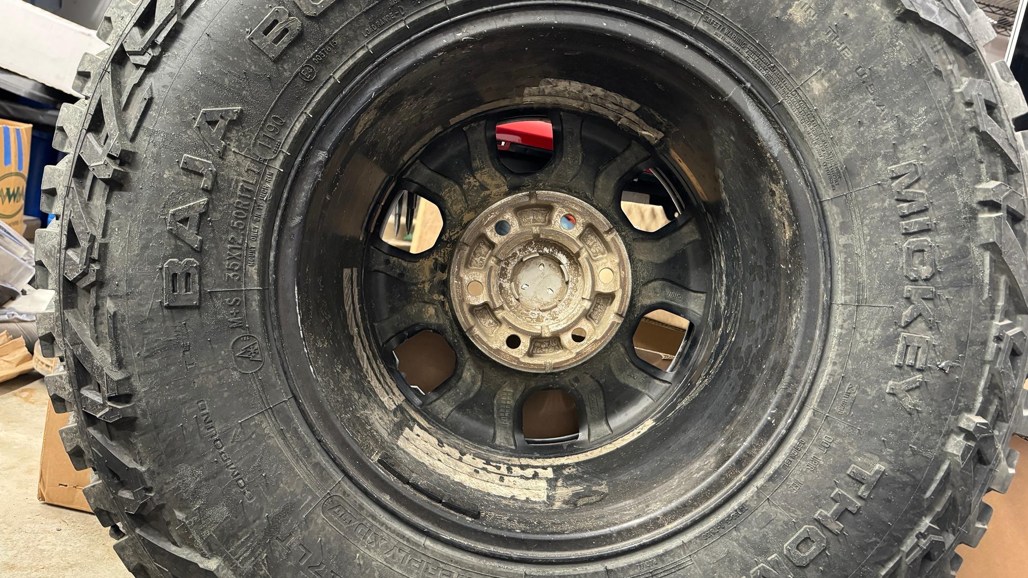

I'd take it to another shop to balance, I fought balance on my Mickey's, 6+ balances, 2 warranty tires, still persisted. Took to another shop, they found 26oz of weights on one wheel, others were almost as bad. The 26oz tire only took 3 oz to balance. Both shops have the roadforce balancer (or whatever its called). Take a look and see if there are weights on both sides of the wheel, they might just keep adding weight to counter balance instead of starting over.
Edit: yeah, check out that play issue but worth checking the weights. The rotor is held in by the wheel, so they flop around until the wheel is installed.
