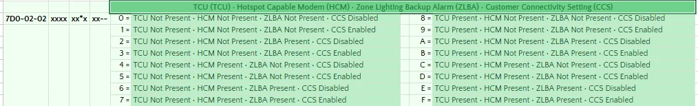

If the option for wifi does not appear, you may need to change the config in the APIM. It will not solve your OTA issues, but you should have the option to connect to wifi in your touchscreen. Check what you show here in the APIM with FORScan. If CCS is disabled, you will not have the option to connect to WiFI:
Ford Bronco Update outside US 1766430406872-ez
Or message me the VIN and I can check.
