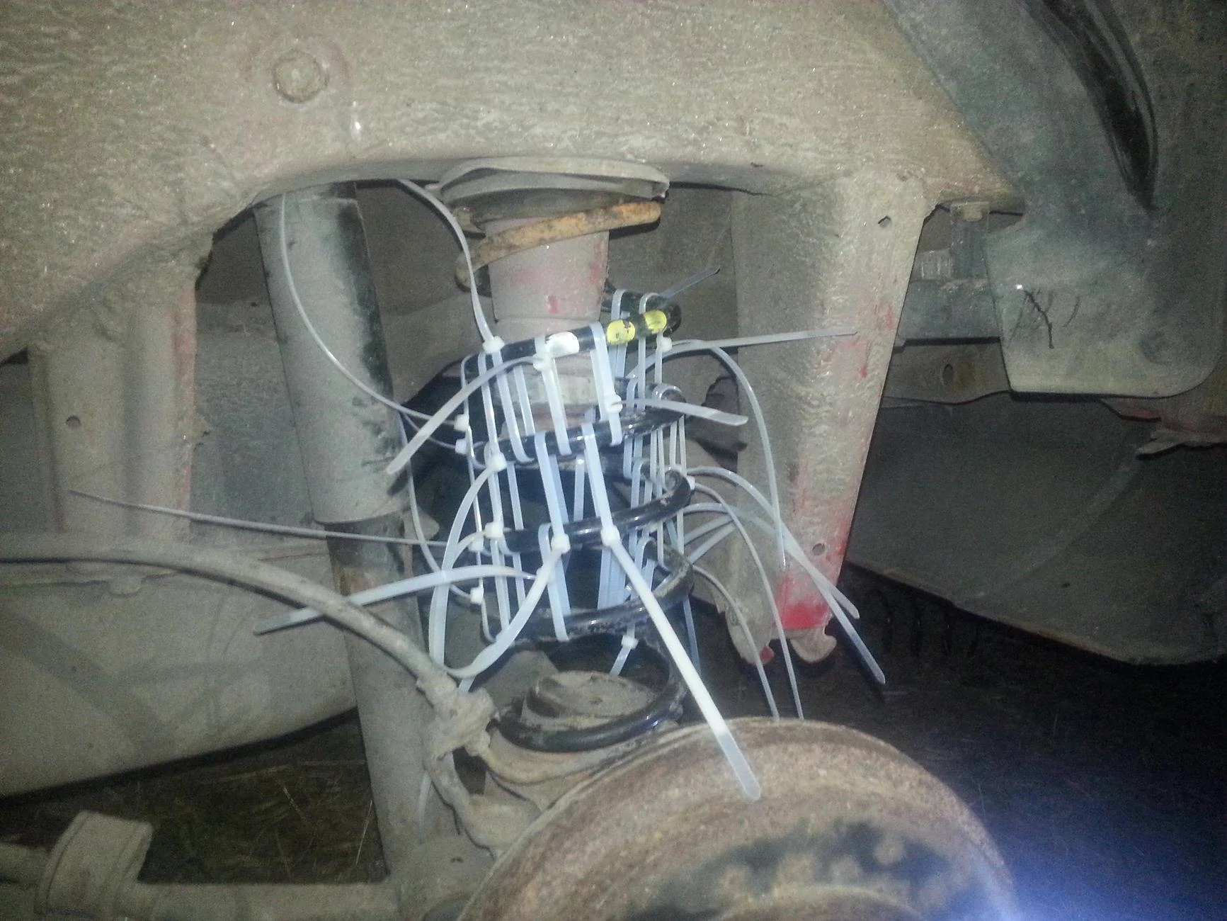

Why do things the expensive way when theres zip ties?
Ford Bronco Update - Harbor Freight spring compressor 8k42pxquy5x11-1732866954
Dont compress it with zip ties. That said I usually put a bunch on as extra insurance. I don't trust the to hold the full force but if the tool starts to give a little they'll help make sure it doesn't give a lot.
Pic isn't mine. Its there for for the joke.
