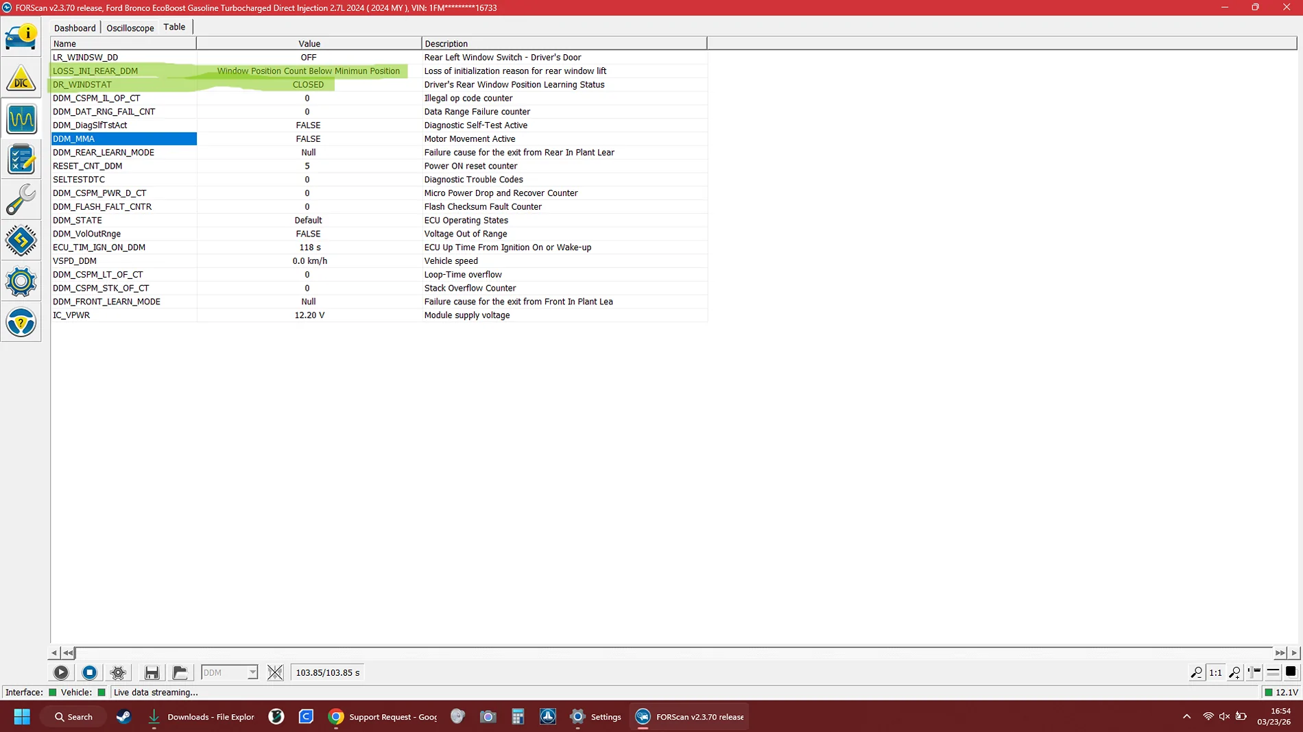

Over the weekend I did take about 15 straight mins to just continuously do the relearn and no luck and no behavior change in the window movement. I did try door open and door closed again and truck running and off.

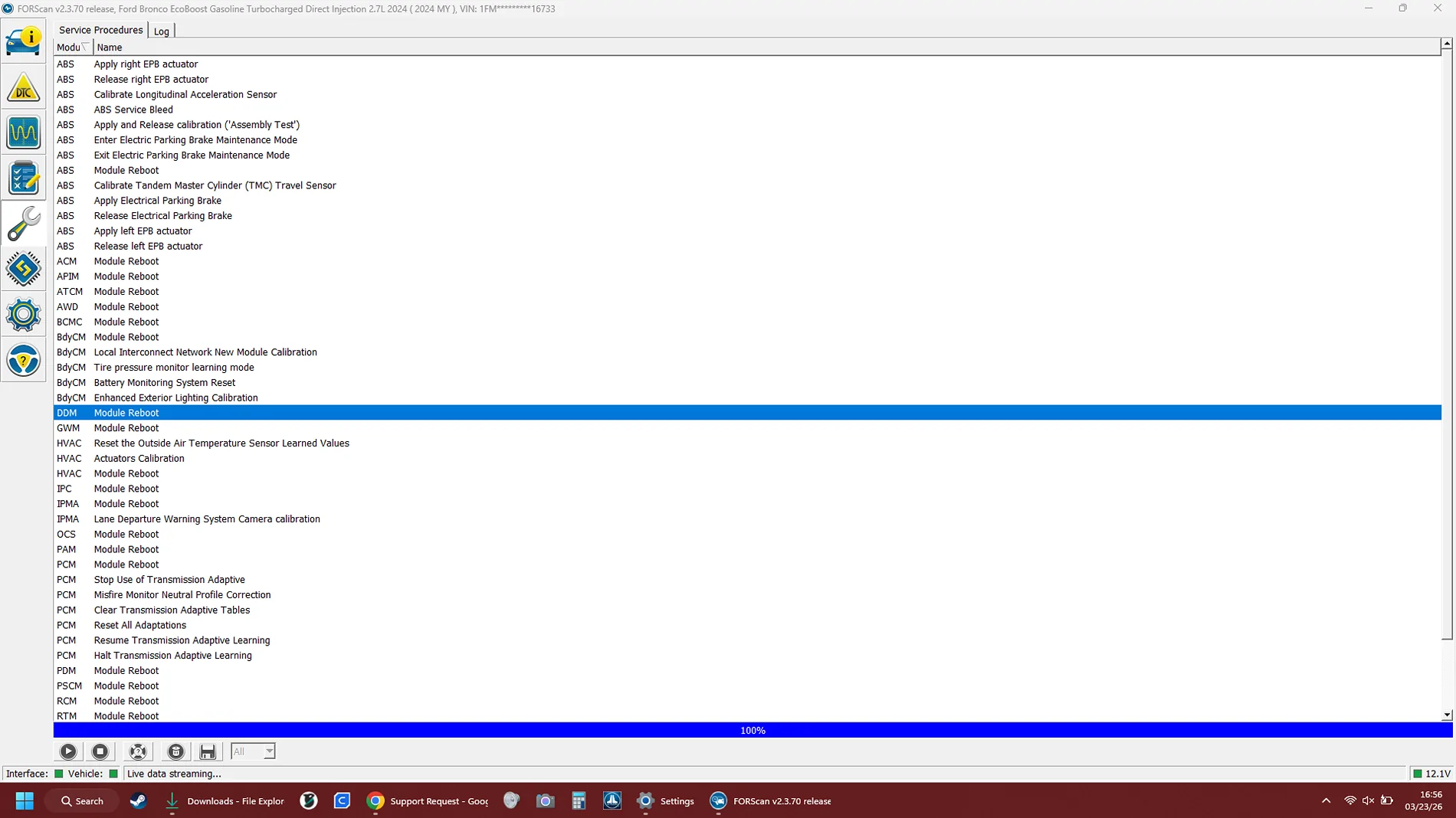

Since there was little I could do, I keep going back to ForScan since I can see the module state. I pulled some PIDs for the DDM and could see that the LOSS_INI_REAR_DDM pid was showing: Windows Position Counts Above Maximum Position and DR_WINDSTAT was Not Learned. I could not get this to change no matter the procedure. However since there were no DTCs, I knew the module was fine, just stuck in a safety loop. Search didnt bring much more than I had before, but I happened to ask the right question to Copilot and ended up figuring out a fix.
In ForScan I pulled up the DDM in the Wrench Menu and the only option is for me to "Reboot Module." I selected this and the warning popped up and I left the warning on the screen.
To get the DDM to wake up and look for the learn signal, I manually bumped the window up to the top, then pressed down to the first detent and held it there. As the window was moving down and, I clicked OK on that safety popup and it reset WHILE I was holding the button. the logic was that the current spike at the bottom of travel would be pulling about the same time the module was reset and that *SHOULD* corrupt the modules memory and make it look for the Learn.
This changed the State of LOSS_INI_REAR_DDM to Moving Reset. DR_WINDSTAT remained unchanged at Not Learned. This is the key to get the module to learn anything.
At this point, the safety that was causing my windows to instantly drop (and preventing the learn procedure) was inactive and I could perform the Relearn. I saw no changes when I did the relearn and this is where Copilot made me nervous, but I FAFO'ed.

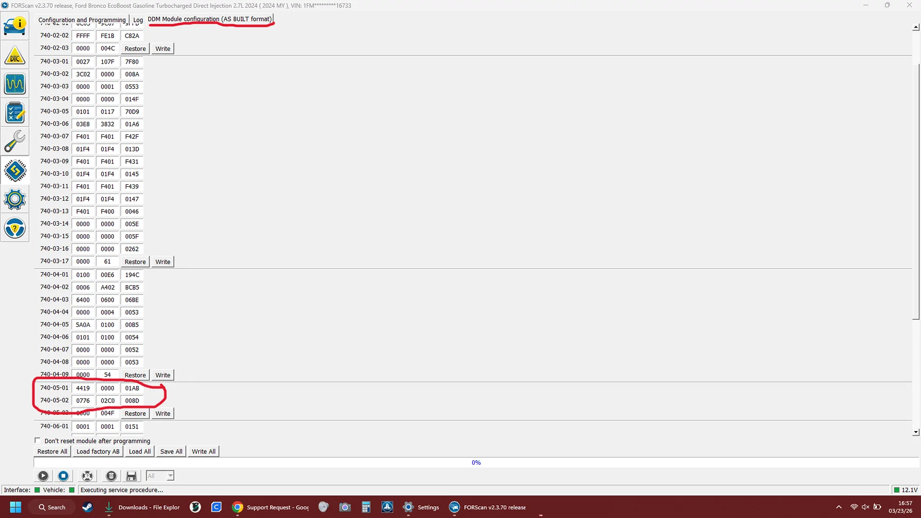

Next step ended up being to go to the DDM (as built) and changing 3 blocks
740-05-01 was 4419 | 002B | 01D6 to 4419 | 0000 | 01AB
The rationale for this is that the 2nd block in the address is a status code. Setting it to 0000 lets the module recover from the safety/fault loop. Block 3 is a matching checksum
740-05-02 was 0776 | 02BC | 0089 to 0776 | 02C0 | 008D
Changing the 3rd and 4th characters in the 2nd block to 02 seems to be a standard Ford value that sets the rear window to Init Pending. Block 3 is a matching checksum.
Write All to set the new values
Now I was able to perform the relearn!!!!!!!!!!!!!!!!!!!!!!!!!!!!!!!!!!!!!!!!!!!!!!!!!!!!!!!!!!!!!!!!!!!!!!!!!!!!!!!!!!!!!!!!!!!!!!!!!!
and it worked first try.
Idk if anyone else will find this useful, but this one was a beast for me and now I get to cancel my service appointment!!
Unfortunately, I did not take screenshots as I went, but here is where I made changes and which PID I was using. You can see a lot more PIDs, but I highlighted the two that were important
