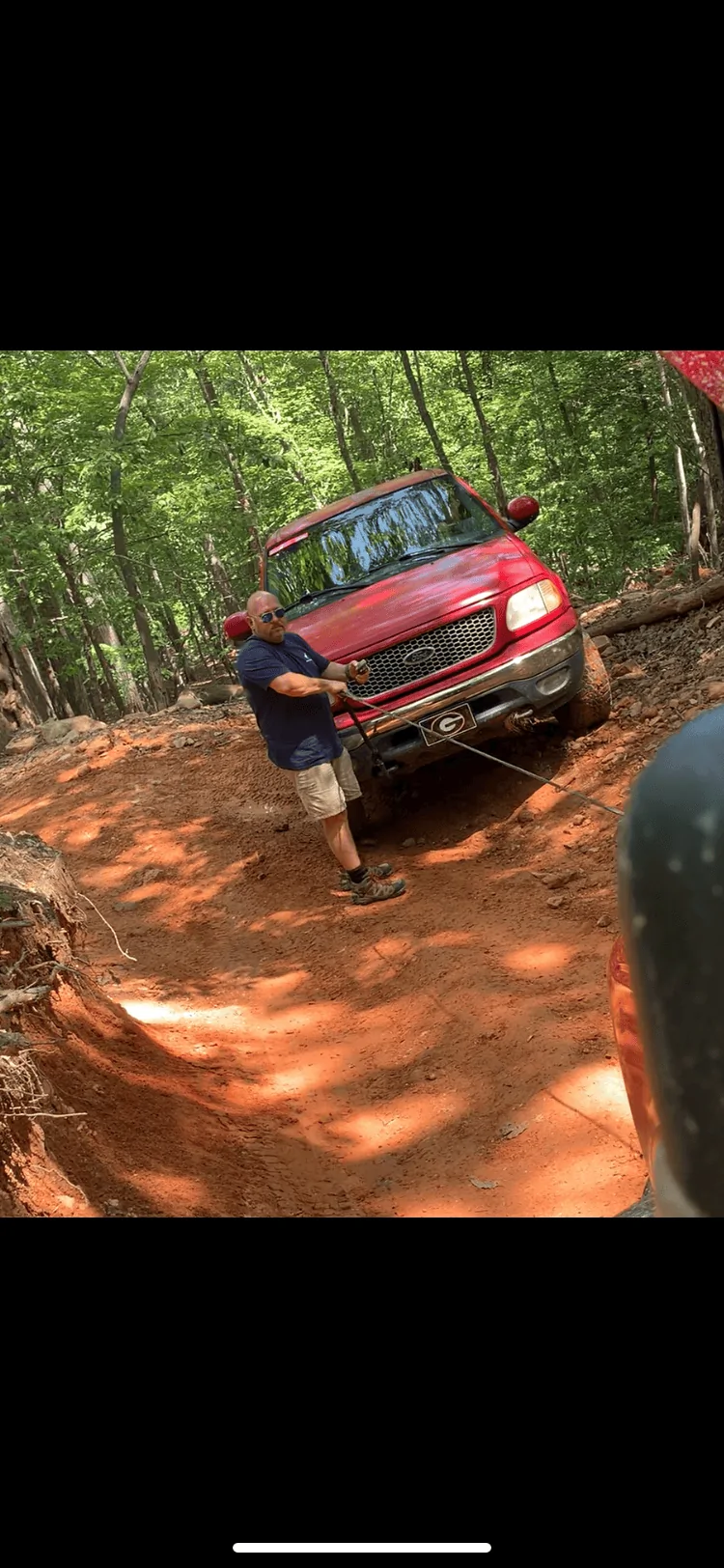

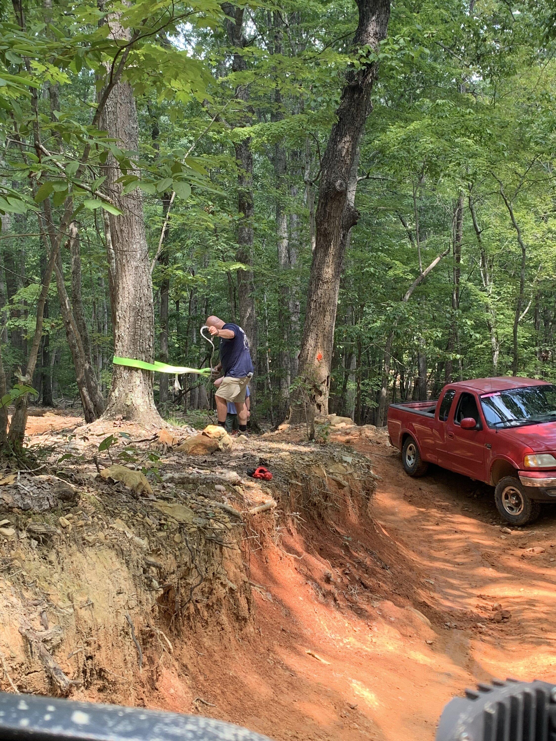

FWIW I used virtually ALL of my recovery gear for the first time weekend before last since running trails in the Bronco (almost 2 years now already and 39K miles).
Just a weird situation, unexpected (aren't they all!?), and neither I nor anyone in the group I was leading were the victim.
We were doing an intermediate trail nearby called Dutch John, things were going very smoothly for mostly a "new group of offroaders" I had with me.
We topped a hill and began into the next curve and I saw an F150 off the side of the trail, at an awkward angle.
Stopped and asked the obligatory "Are ya'll good?". Obviously they weren't but surprisingly not everyone wants help even if they need it.
Long story short, the F150 had non-functioning 4WD and not even AT tires. There was no way he was going the way we had come, as it was far more challenging than what he had made it through to that point.
I initially pulled him up out of the hole and onto the trail facing us twice. Hoping he would be able to back up into a wider spot up the trail and get turned around.
But the clay was so slick any attempt to turn the wheels just caused them to slide back down the ruts and right back off of the trail.
So plan B became apparent.
I used my tree saver strap, recovery strap (NOT a standard towing strap), two soft shackles, two hard shackles, snatch block, and extra 100' of synthetic winch line to angle off of a larger tree and pull him up onto the trail from the rear vs. the front.
After that, picking different trees and angles allowed me to turn him completely around and facing along with us, eventually down past the ruts. At one point I was having to pull him sideways against the mud with my wife in the Bronco, in 4L, in reverse to keep from being pulled down. Got kinda sketchy but never out of control.
About an hour spent in 98 degree humidity.
But in the end some good karma and an excellent lesson for the group in how, what, and what gear made it a successful recovery.
I bought it all piece by piece thinking I'd use it one day, but saying to myself "You probably will NEVER use any of this, ya know?".
Turns out I did.
Be prepared for the unexpected.
You can never plan for every instance that could happen, but some basic stuff can go a long way to driving home or not.

After getting him out of the rut. And yeah, no gloves. One of the “bad habit” things I didn’t want the group to learn:
