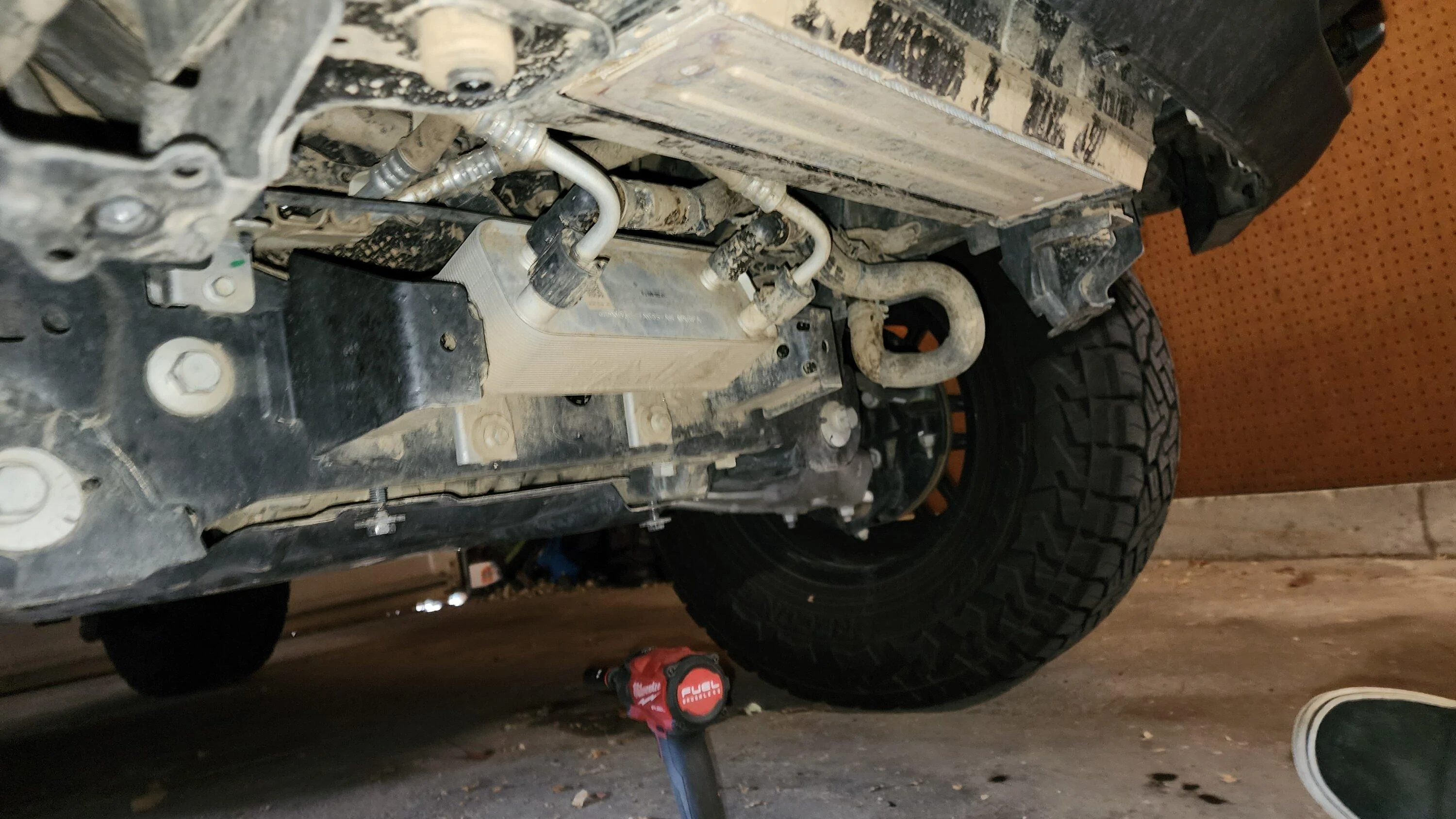

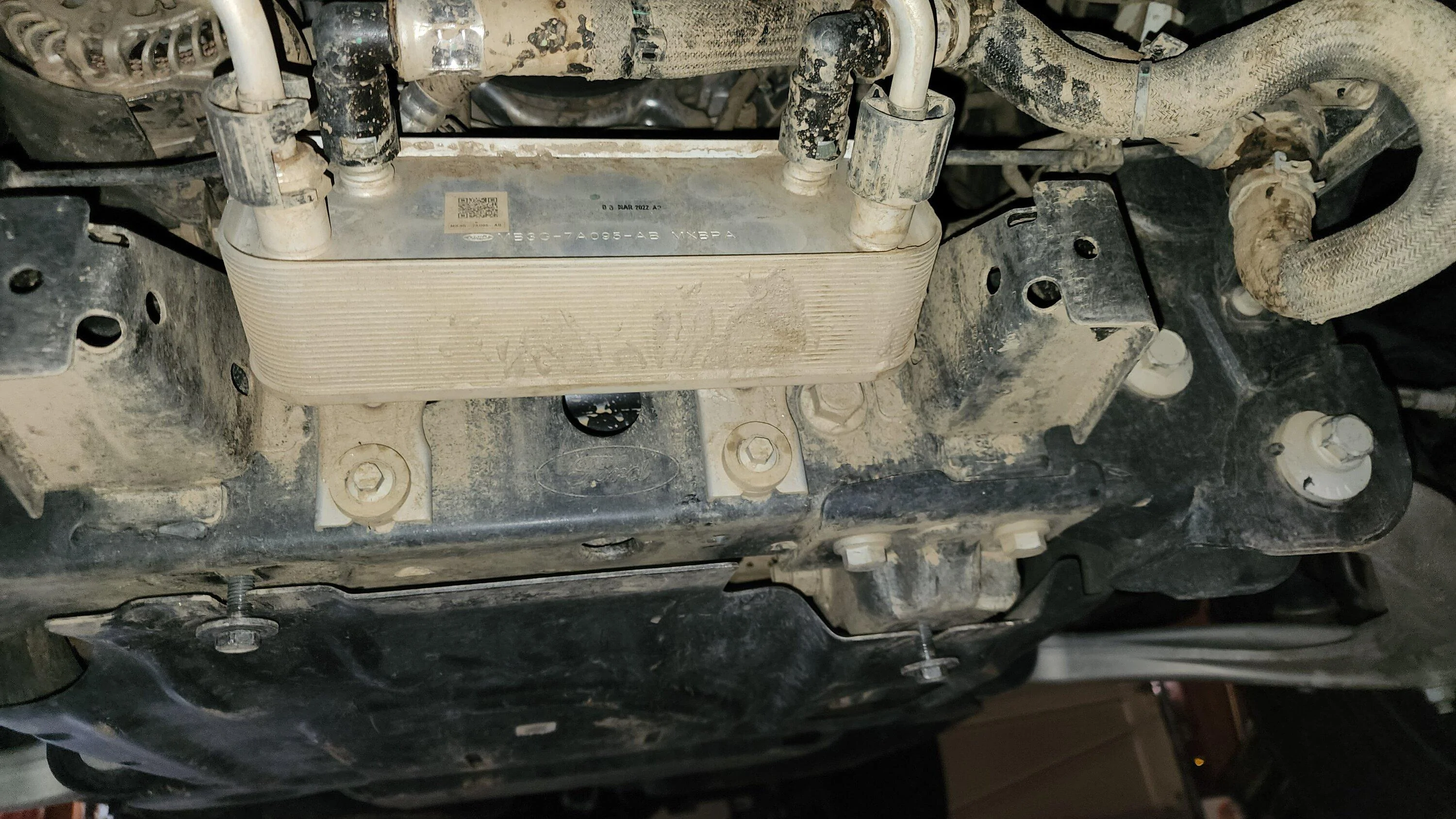

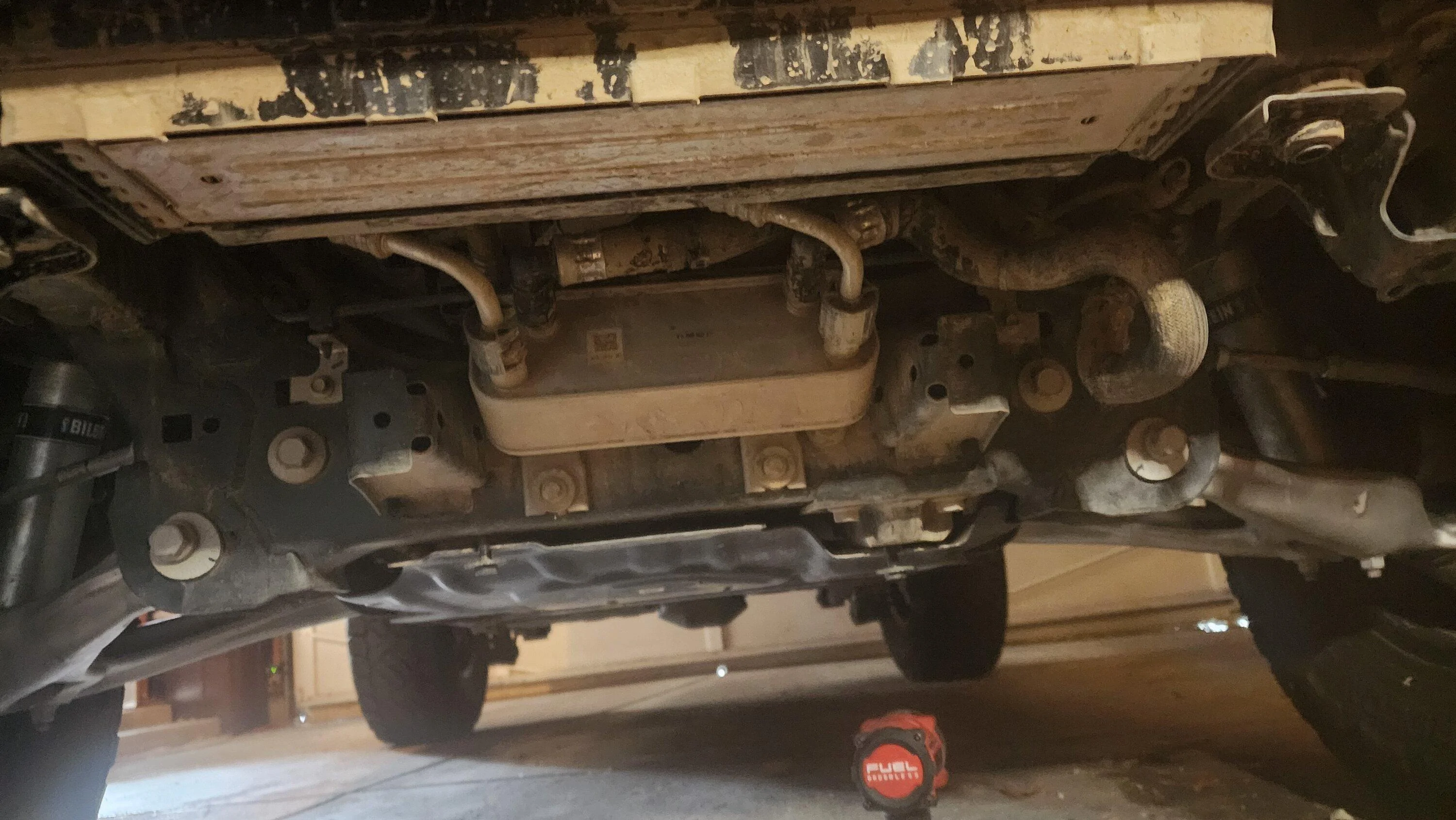

Does anyone know what this is underneath the front skid on my 2023 2.7L badlands ? I was hoping to put one of the rough country hidden winches down there but this is literally right in the place that would go. I haven't seen it on any of the videos I've seen when people remove their Skids. Is this something new for 23'? Any help would be appreciated.

There are a few mentions of it on here.
Quite involved to fit the RC hidden setup on a 2.7.
Not impossible, but not exactly a "I have a free afternoon so let's do this" kind of job either.
Best of my recollection you have to relocate the intercooler mounts, move the pipes, etc.
But I'm not 100% so not going to misquote.
Someone will chime in soon with good details.
Bottom line is what you have is normal for the 2.7, and to go that route is not necessarily going to be neat and easy.

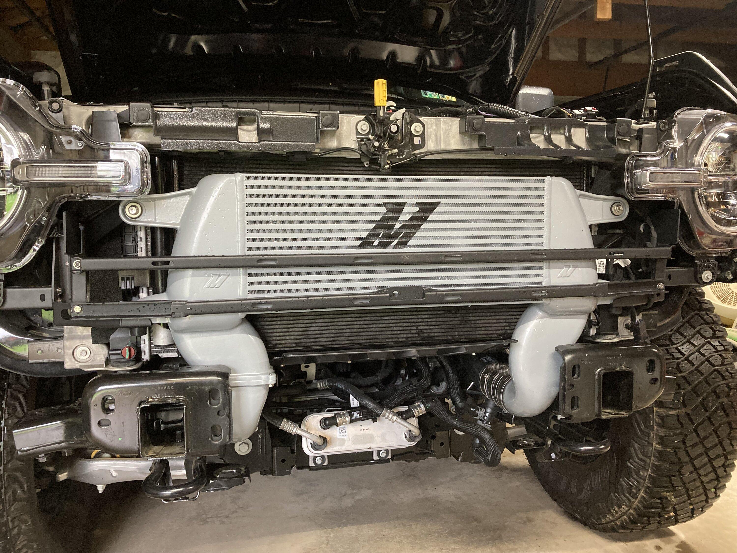

@BAUS67 Didn't you change out your intercooler for the Mishimoto to fit a winch?

Yes, I did. The part the OP is asking about is the trans cooler. It stays were it is. As others have said it is fluid to fluid exchange of heat. You can move it but don't kink the hoses, it won't cool anymore, or burn the trans up. Just uses the air around it dissipate the heat from it. In other words, it does not need to be in the air stream to cool.
Mishimoto was asked about making a relocation kit for the trans cooler but it is not in the works anytime soon. A fluid to fluid cooler is a bit different animal than an air to air cooler.

RC provides a bracket and instructions to relocate the cooler there. It's a tight fit. I ended up doing it a bit different, but got it in there.
fourdayoff
Apr 28, 2023
138
145
Boulder City Nv
2022 Bronco Badlands/sasquatch 2.7
The RC hidden winch mount works with the 2.7. It's a tight fit but all instructions are there. Plan on taking some extra time. I went with the 12000 Lb. I also got with my neighbor and fabricated a gear and rack with a PTO cable for the engage lever and used a wireless controller. I posted on here but can't find it now. Jim.

Hey @Big Bad Green Machine - like others have mentioned, that is the 2.7L transmission cooler. It us a liquid-to-liquid design and uses coolant to maintain optimum transmission fluid temperatures. It helps to quickly bring transmission fluid up to temp during cold-weather temperatures, while also using coolant to maintain reasonable temperatures in hot-weather climates.
There are companies utilizing our Mishimoto High-Mount Intercooler to help create extra clearance for low mounted winches. Do some searching on the forums and you'll find good options!
