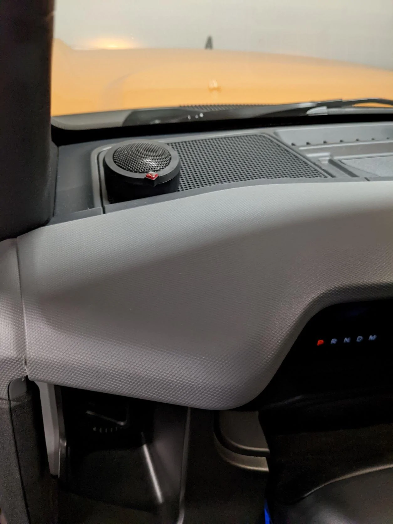

How does it sounds with only tweeters in the dash? I'm considering this option as well but was wondering if it would be too bright. I'm just concerned the full range from the 6.5s in the kick panel won't make it up to your ears as they are firing into your shins, if that makes any sense.
It sounds great with just the tweeters! The owner really emphasized getting the sound stage right and they knocked it out of the park. The EQ is set with the treble pulled down a bit and I haven't noticed much brightness even blasting 00s pop punk with the top down. The low end from the kickers comes thru great too and it's all quite balanced
Awesome! Well that is the route I will go as well. Thanks for the feedback.

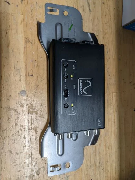

Wave Tech link 4 line out converter

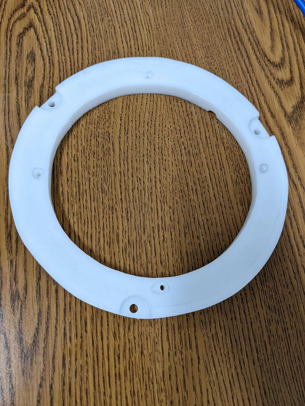

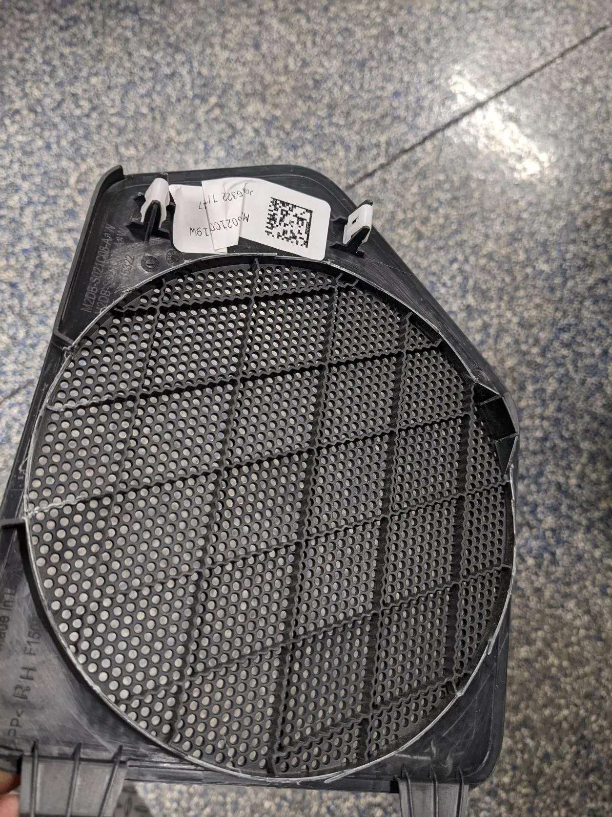

Rather than purchase adapters for the 6.75 I made my own from 1/2 thick plastic. The stock kick panel speaker is a 6.5", but there is plenty of depth and space for the 6.75 to fit. As these were the only ones my local shop had in stock, I went with them. I did trim the back of the kick panel trim grill area (see photo) to ensure that the speaker would not touch as it travels. I mounted the tweeters to the dash top grills.

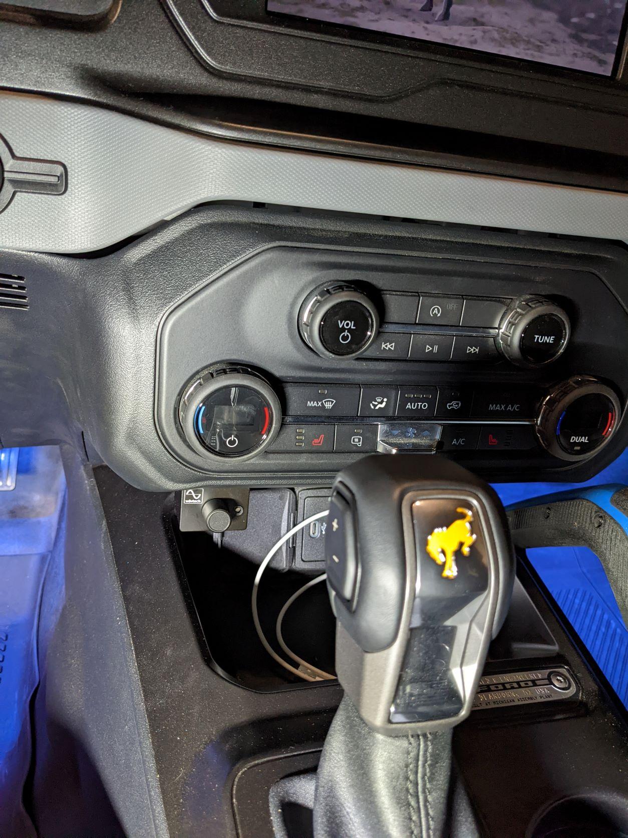

The link 4 has a remote level knob that controls the sub volume and it is mounted under the dash (see photo).

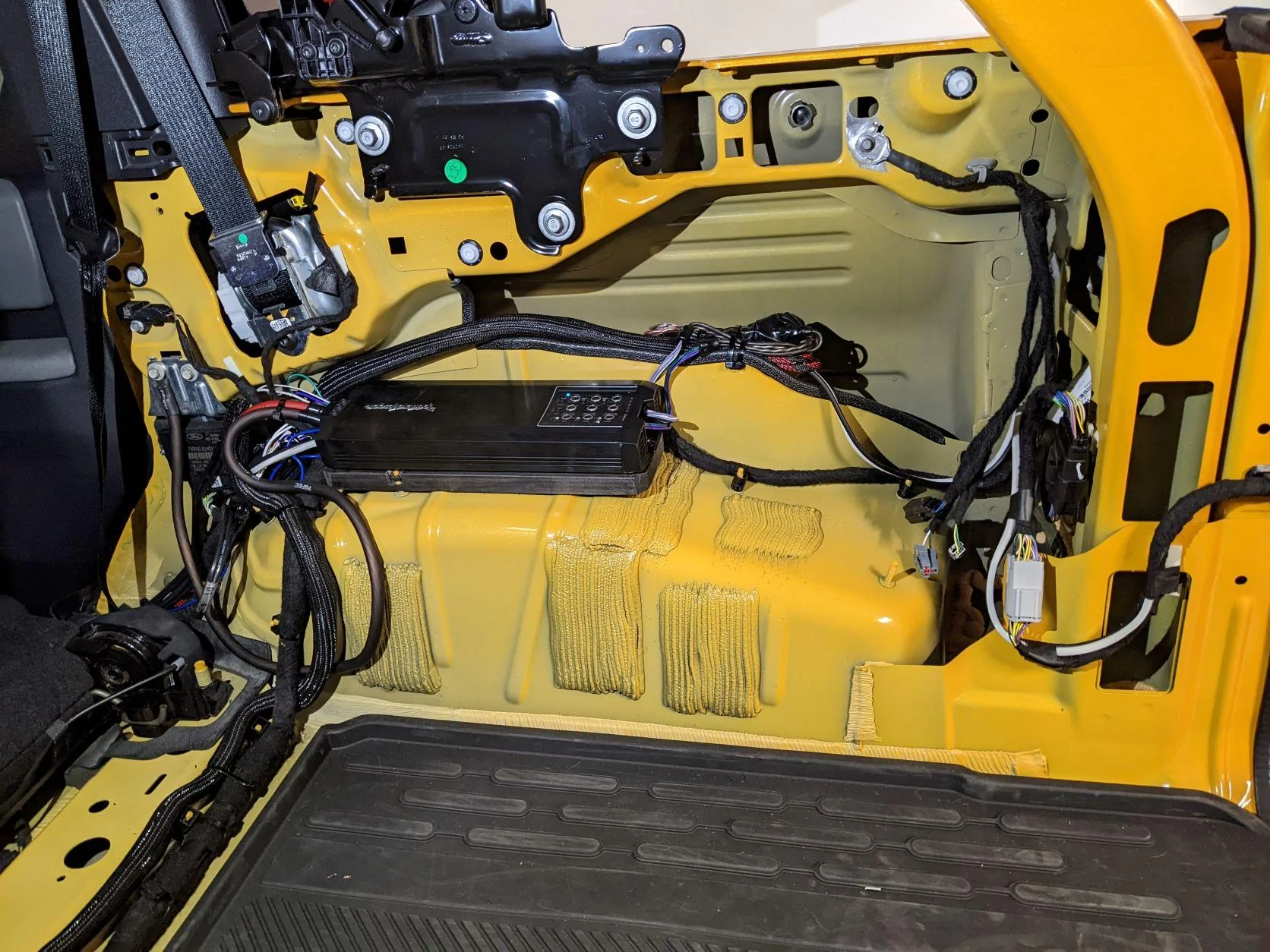

I mounted the fuse to the lid of the fuse box under the hood and ran the 4 ga. wire down the drivers side and then across the back behind the seat, following the factory wiring harness. The RCAs, speaker, and remote wires are routed down the passenger side.
Originally I tired using the factory ground location towards the top rear of the fender area. This provided a lot of ground loop feedback so I ended up moving it to the location shown in the photo closer to the seat belt.

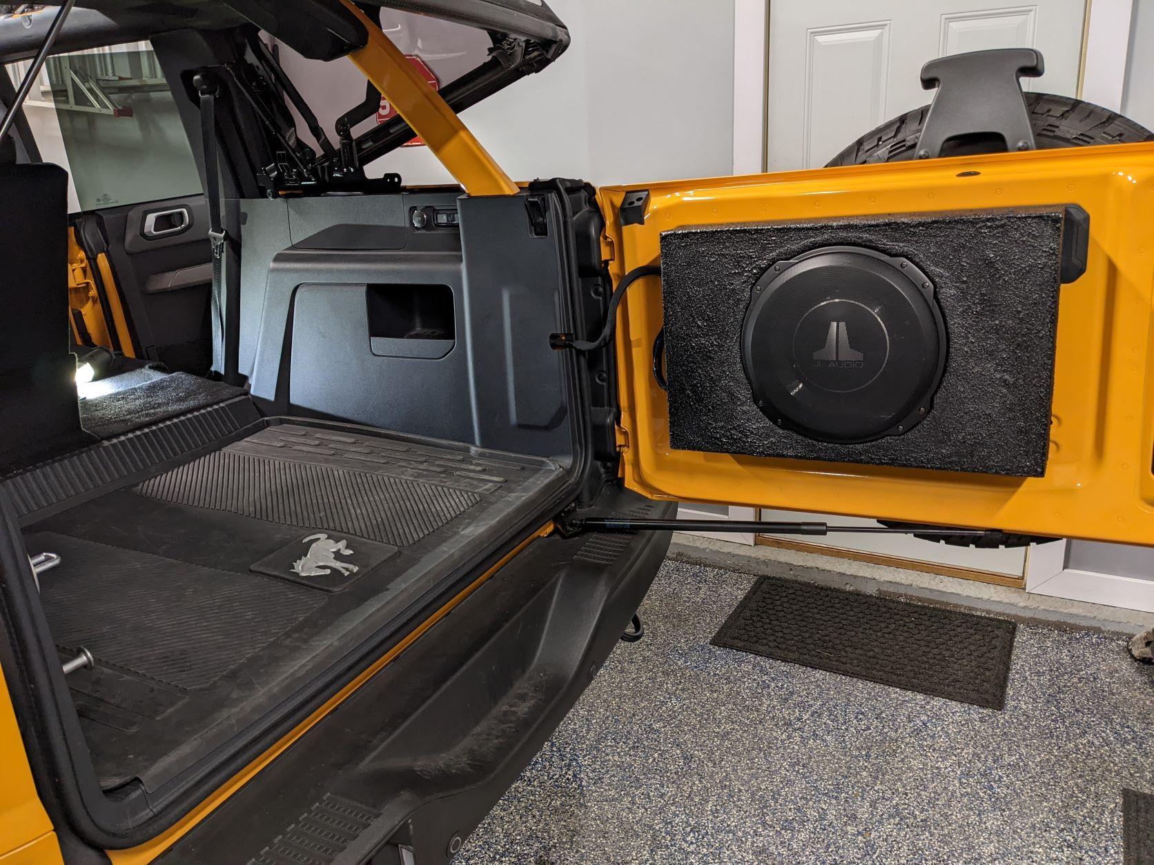

I cut the carpet off the sub box and coated it with two coats of Herculiner truck bed coating. I machined two custom t-slot nuts that fit into the oval cut outs in the tailgate. I used these two t-slot nuts and three rivet nuts across the top in existing factory holes to attach the box to the tailgate using five 1/4-20 bolts. Since the tailgate is not flat I placed some 3/16 thick rubber between the box and tailgate. I ran the wires to the sub inside of the factory wire loom and then close to the box brought them out into their own loom for a factory look.
The amp is mounted to a board attached to the fender using three existing studs in the fender. Everything is in loom or protective sleeve where it could be exposed to movement or wear. I removed practically every interior panel to complete this job and only managed to break one clip, and that was on the dash speaker grill after the third time taking it out.

Check out MTI Acoustics out of Texas - they have made tons of custom under seat boxes for trucks and now have a few things out for Bronco -
-----Our HDPE amp rack bolts in to three OEM spots, with our included aluminum hardware for the lower points.
With spacing on the front and back, enjoy a handy spot for your amp(s) and integration pieces or distribution blocks.
I was thinking of making a plate like this to mount a shallow powered sub . Remove the cubby and attach a speaker grille in its place. Really just waiting a bit to see what the aftermarket can come up with. I'd like to see a powered sub in the shape of the factory sub to bolt into the factory spot. or do similar to what @cmcbronco did
