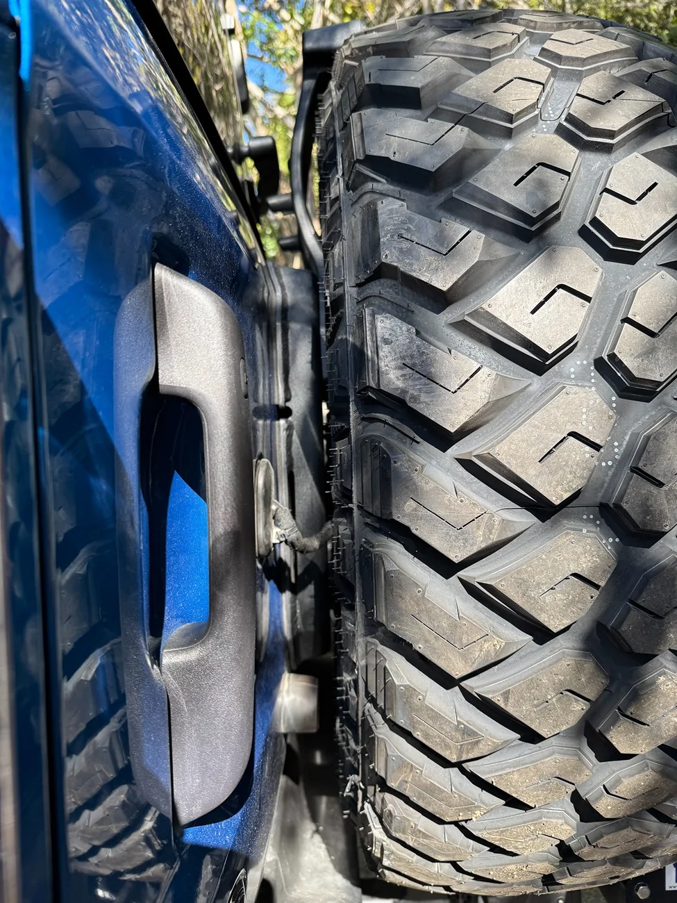

I now have both the TOR tailgate reinforcement and adjustable tire carrier installed along with 37's that are mounted on 17 inch Method 305's with 0 offset. I have the adjustable part of the tire carrier pushed in all the way and when the spare is mounted the tire does not make contact with the tailgate reinforcement or either of the two rubber things that stick out at the bottom of the door. It comes very close to the reinforcement arm but no contact. For those that have this setup, am I OK leaving as is or should I get tennis balls or some other rubber type extension to put between the rubber thing on the door and the tire? The whole setup is very solid and I have done a day of wheeling with it like this and it does not make any sound or vibrations or anything. When I grab the tire from the rear I cannot shake it. It does move at all like the OEM set up did.
I ran like you did for about a year. Eventually I threw some Barnes tire bumpers in there - the spare tire did start to twist/sway side to side - I don't think it would hurt that carrier, but for $20 it's cheap insurance to keep it from twisting around as much .
Thanks I’ll grab a pair. Follow up question, how do you get the OEM bumpers off? Mine are loose. I tried tightening them when I did the carrier but the screw in the middle just spins. Doesn’t get tighter or looser.

@Jason N : I had the TOR tire carrier and the DV8 Guard. I was also running 37s. I bought some squash balls off Amazon and put them in the bumpers. Problem solved, and even looked pretty good.

Two ways
The clip is the same type as used in the fender liners - the little screw is supposed to back out easy and release pressure on the prongs. They almost always strip out - easier to just pry the screw part out like a regular fender clip… except you can’t do that in the spare tire bumper.
the easy way is to just stuff a trim puller behind the bumper and pry it off - the clip will probably pop out before it deforms the aluminum - may want to alternate prying with wiggling the bumper around. But it’s possible the aluminum on the tailgate could bend, I won’t lie. Most of the time the clip will stay in the tailgate and the bumper will come off around the clip
More safe option is to heat a Phillips up with a lighter and melt it into the clip head. Once it cools should be able to get it to stay on the head while holding the body of the clip steady by applying pressure with the bumper.

thanks again. Ugh I hate those screw clips. Was afraid it was one of those. Now that I know exactly I’ll figure it out.
