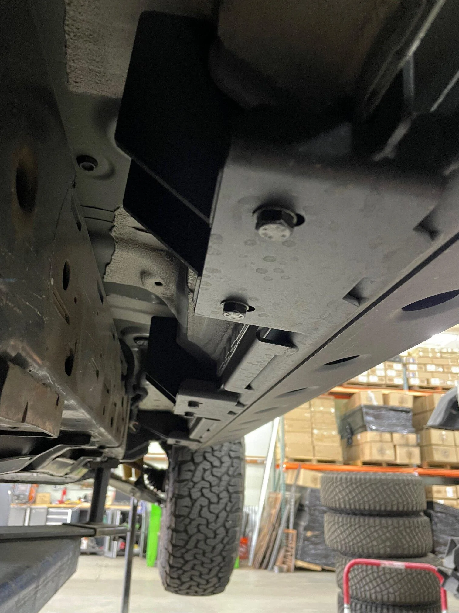

In terms of specifications, our rock sliders boast a tube thickness of .160 wall, ensuring their durability and strength. The brackets are engineered using a combination of 1/4" and 3/16" steel, providing optimal support and reliability.
If you're considering our step slider option, we're pleased to inform you that we've invested significant time and effort into research and development. Our primary focus was to create a body-mounted slider that not only excels in functionality but also boasts exceptional strength. We achieved this by utilizing 1/4" steel mounts to support the slider. Once we had established a rock-solid foundation, we incorporated the step component, ensuring the perfect balance between practicality and durability.
Ford Bronco Turn Off-road sliders - reviews / feedback? IMG_8383

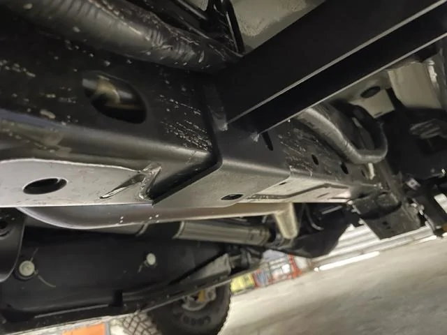

For our frame-mounted sliders, we took a unique approach by designing them to bolt both to the body mount and the center of the frame. Our extensive testing revealed that when mounted solely to the body mounts on a 4-door Bronco, the sliders tended to twist more than our standards allowed. To address this concern, we introduced a center support that resolves the issue and enhances the rigidity of the sliders. Due to the shorter wheelbase of the 2-door Bronco, the body mounts alone function effectively since they are positioned much closer together.
No bolt in it but you get the idea
